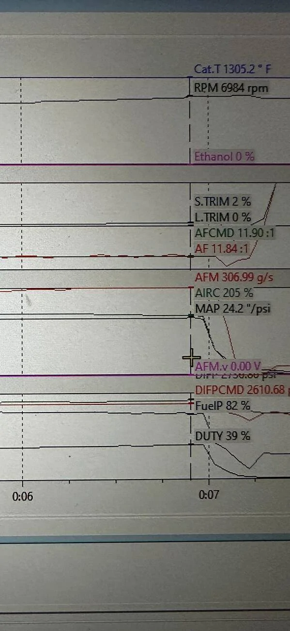

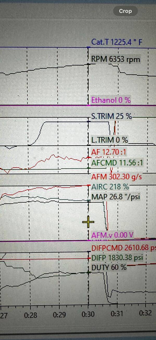

This is just to give a clear picture of the issues his car was having after a dyno tune by one of his local tuners. I gave him some recommendations on mods to do fuel system wise.
11th Gen Honda Civic Jester’s Hondata thread IMG_5039
And after a quick basemap to determine the limitations of his fuel system on a RV6 turbo.
11th Gen Honda Civic Jester’s Hondata thread IMG_5038
If you get a tune make sure it is from someone that knows what they are doing. It would be extremely frustrating for you to spend your good hard earned money to have your engine at risk like his car had. Maxed out fuel pump, fuel trims sky high, and injectors well over their limit.
