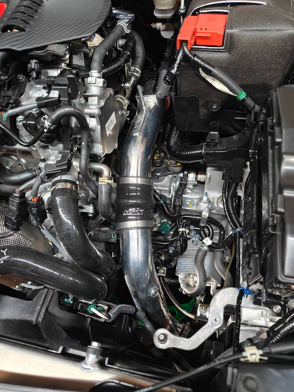

Just want to start by saying “I don’t like anyone on this thread” 🤣, for convincing me purchase the HKS intercooler last night. Now to source out the best price for the pipings. I managed to strike an awesome deal on the HKS IC for $803. Couldn’t pass on that.

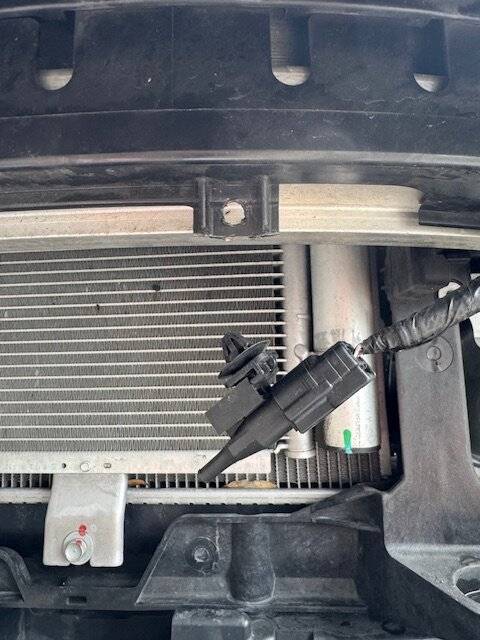

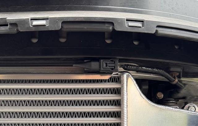

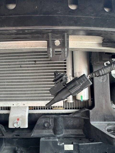

So the stupidly simple one page installation for the J's Racing intercooler was 100% accurate. As described, the only trimming necessary is to modify and move the air temperature sensor higher up on the existing stock tab. Here is a PIC of where ribs were cut off of the stock tab and a hole drilled higher for relocating the connection point itself:
Bottom section removed:
PIC of the sensor after intercooler installation:
PIC with the front bumper on:

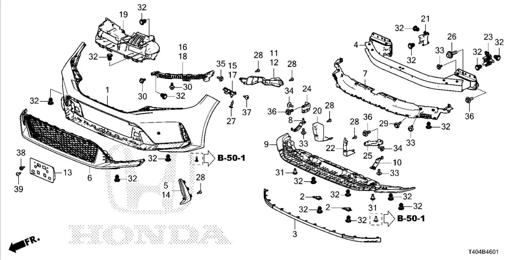

what is that stock tab connected to? Is the entire part replaceable or available separately should we choose to go back to stock location? amazing thread, btw.
Thanks...The tab appears to be on the lower section of Part #7 in the below diagram.
11th Gen Honda Civic J's Racing Hyper Intercooler Front_Bumper
Part #7:
  • Plate Assy., Fr. Bumper Safety
  • Part Number: 71170-T20-A00
  • MSRP : $52.30

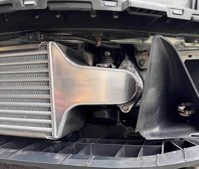

They ask you to remove the front bumper air guide plastic pieces which is letter A in the instructions my question is remove those air guide completely or do you relocation else where thanks
Remove them completely.

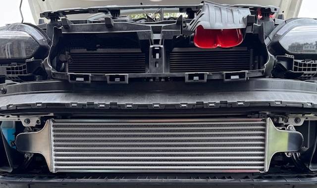

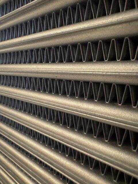

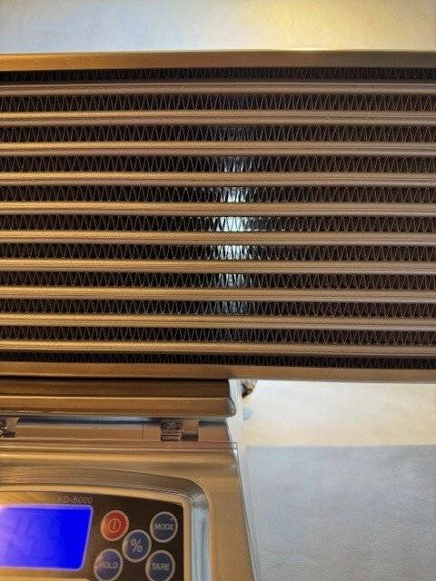

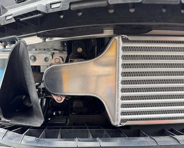

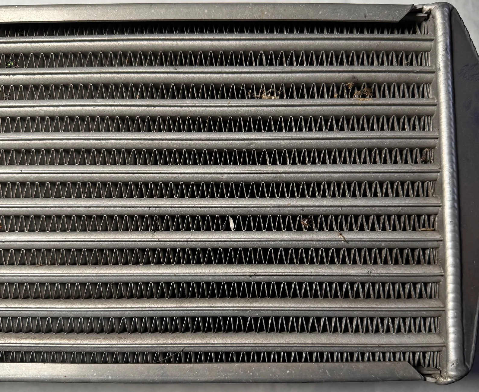

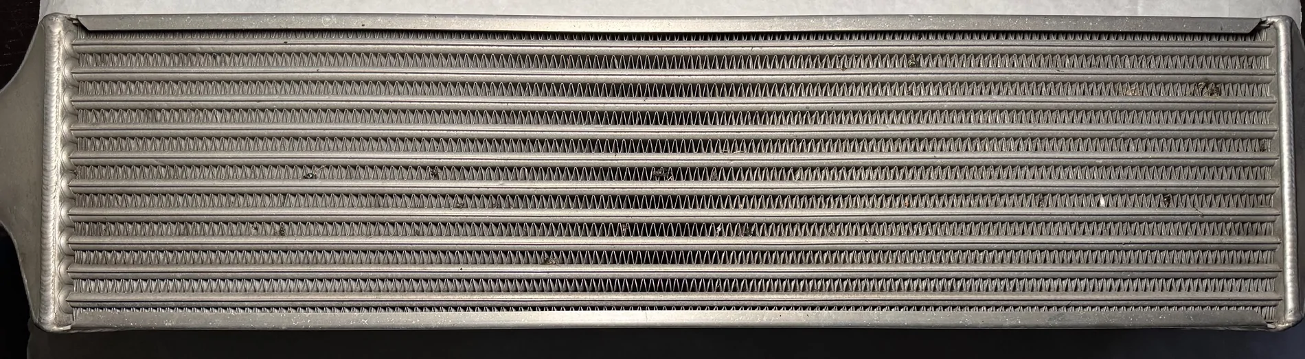

I am in the process of returning my 24 CTR to stock to trade in for a new 26/27 CTR. Here is a PIC of the J’s Racing intercooler after removal while being installed for ~25k miles:
11th Gen Honda Civic J's Racing Hyper Intercooler IMG_3198
Overall, there was only minor bending of the fins:
11th Gen Honda Civic J's Racing Hyper Intercooler IMG_3199
Performance and durability have been proven so this one is a keeper. After reinstalling the OEM intercooler, I remembered and quickly realized how much it actually sucks.
