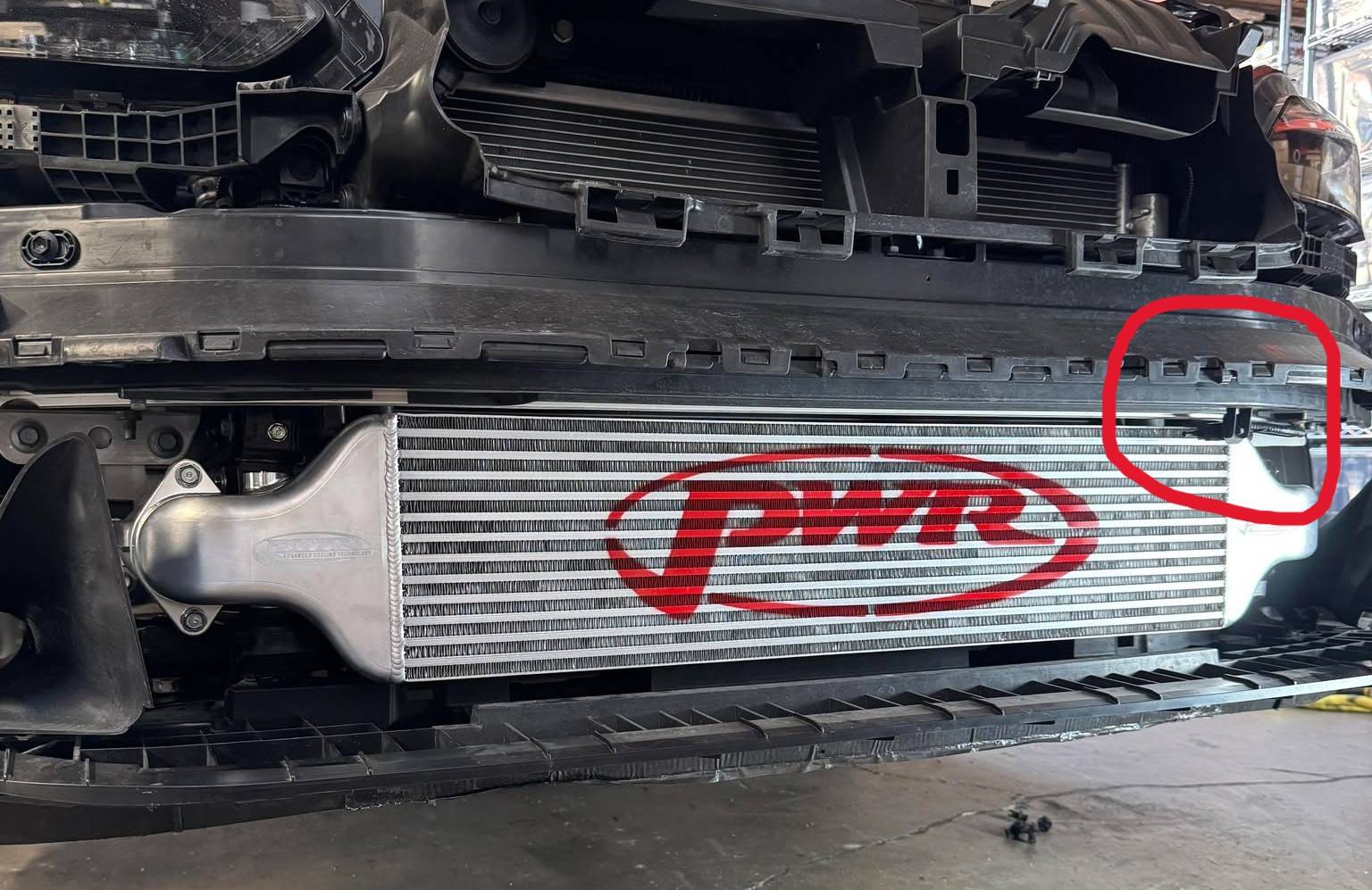

FYSA, @simpleisbest posted this informative thread detailing SCCA Solo Street Touring Rules including a PIC of the PWR intercooler:
11th Gen Honda Civic J's Racing Hyper Intercooler pwr1-
The J's Racing and HKS intercoolers sit further forward and require minor trimming to the temp sensor mount which is not allowed by the ST rules.
