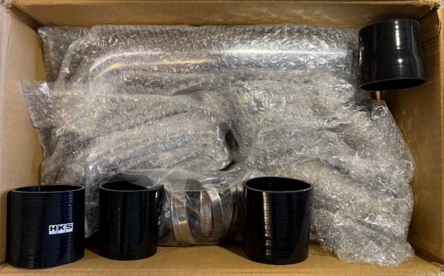

HKS Intercooler Pipe Kit arrived. There was no customs fee charged I guess because the box is not large or heavy. Let me know if there are an questions about measurements or something else before I install the kit.

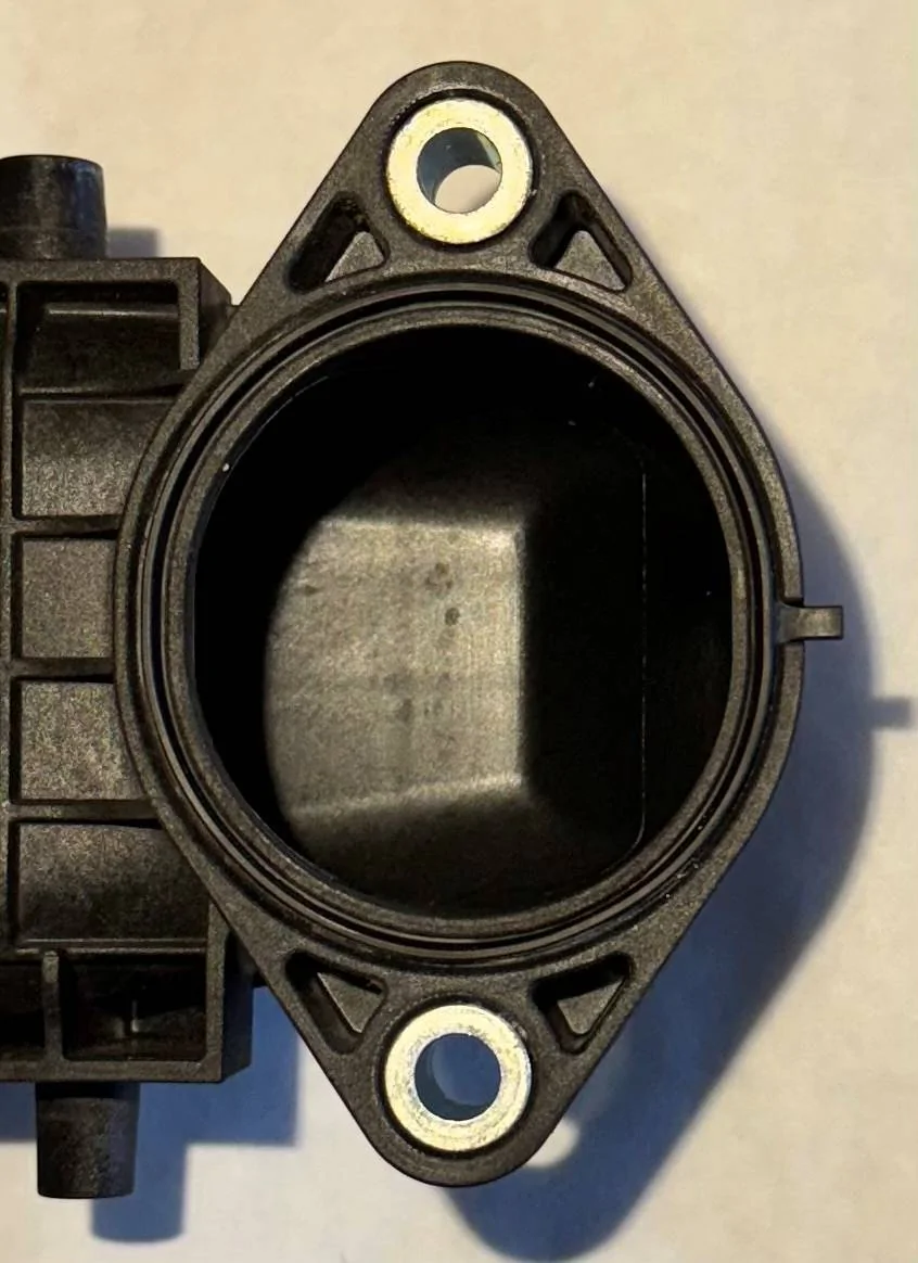

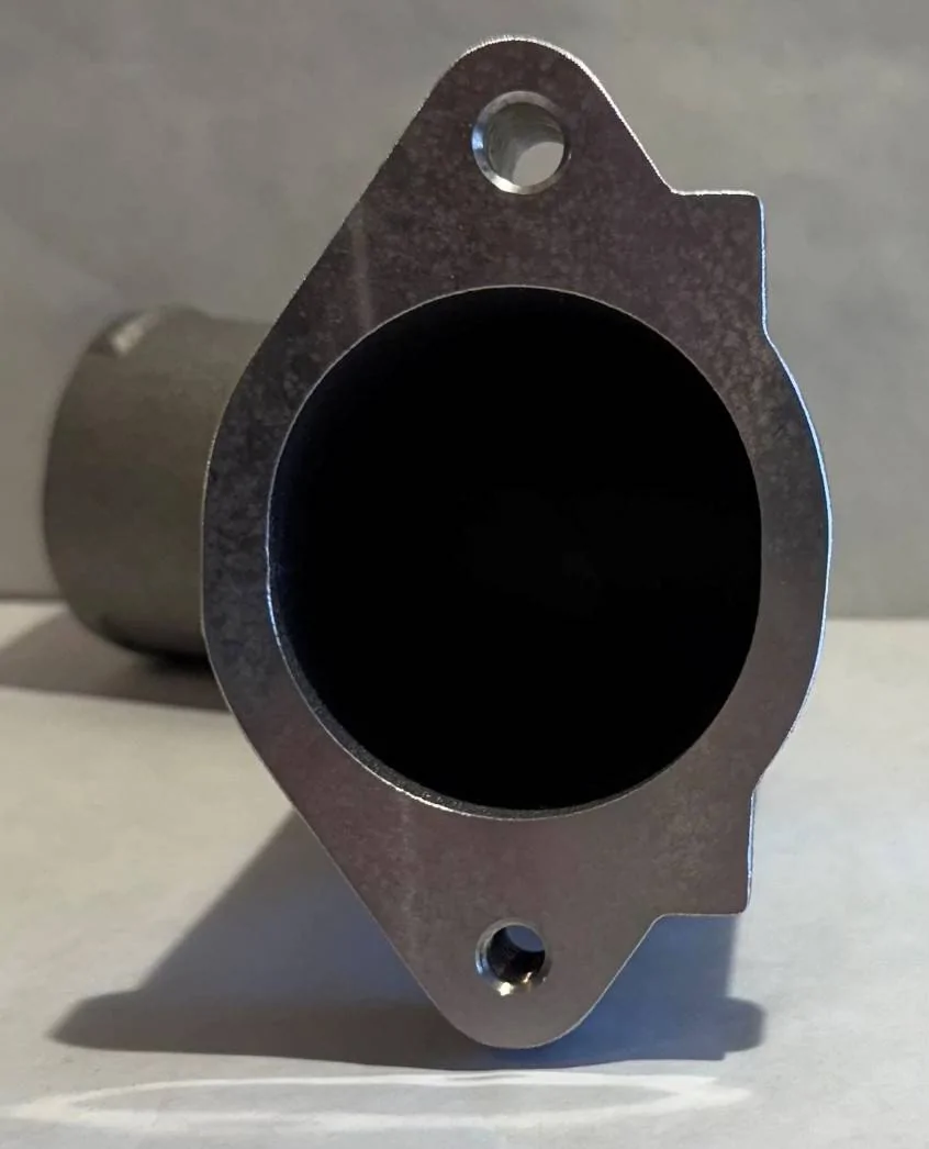

FYSA for those curious. Here is a PIC of the OEM intercooler port where the shape is elliptical (internal port measurements are 59.75mm height x 55.5mm width (same on both sides)):
11th Gen Honda Civic J's Racing Hyper Intercooler 1744833050487-uk

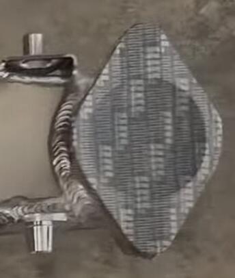

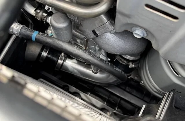

The HKS and J's Racing Intercoolers maintain the same elliptical shape (PICs from video in first post):
11th Gen Honda Civic J's Racing Hyper Intercooler 1744833828646-u9
11th Gen Honda Civic J's Racing Hyper Intercooler 1744833755053-d5

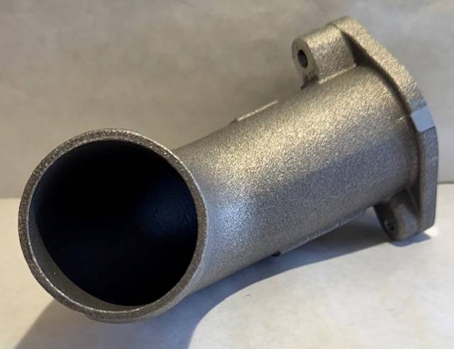

As for the HKS Intercooler Piping Kit, the ports on the cast aluminum elbow connections are also elliptical on the ends connecting to the intercooler. The hot side internal port measurement was 60.00mm height x 55.75mm width. The cold side internal port measurement was slightly smaller measuring 58.35mm height x 52.5mm width:
11th Gen Honda Civic J's Racing Hyper Intercooler 1744834221982-io
The other sides of the cast aluminum elbow connections both have an internal circular diameter of 54.00mm:
11th Gen Honda Civic J's Racing Hyper Intercooler 1744834964762-bd

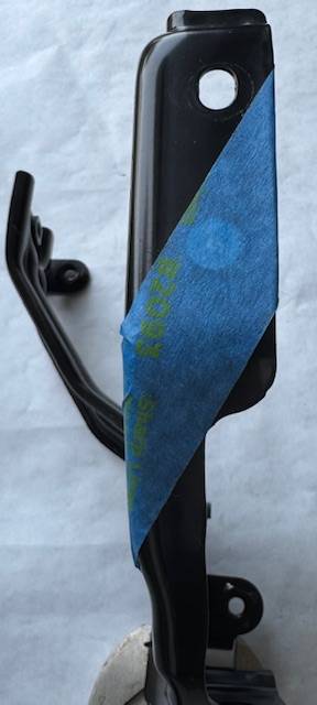

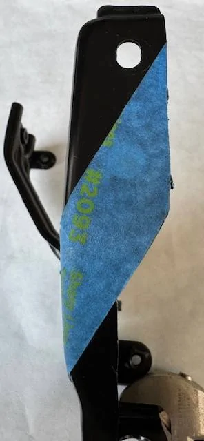

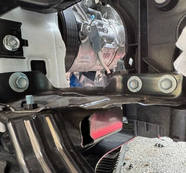

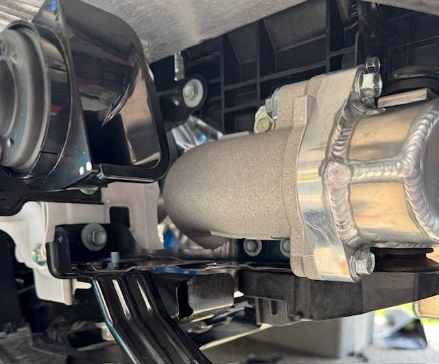

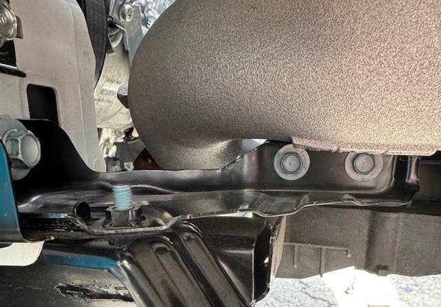

When installing the HKS intercooler piping kit, everything fits like a glove however, minor trimming of the passenger's side brake duct bracket is needed to fit the larger intercooler inlet elbow (cast aluminum). Here are before and after PICs of the bracket showing the required trim area:
11th Gen Honda Civic J's Racing Hyper Intercooler 1745539358692-t2
11th Gen Honda Civic J's Racing Hyper Intercooler 1745539390960-0r
You can use a file or angle grinder to trim. Once trimmed, you can spray some black epoxy paint onto a paper plate and use a Q-tip to dab and apply paint without having to spray. Here is a PIC of the passenger's side brake duct bracket before removing to trim:
11th Gen Honda Civic J's Racing Hyper Intercooler 1745539597325-61

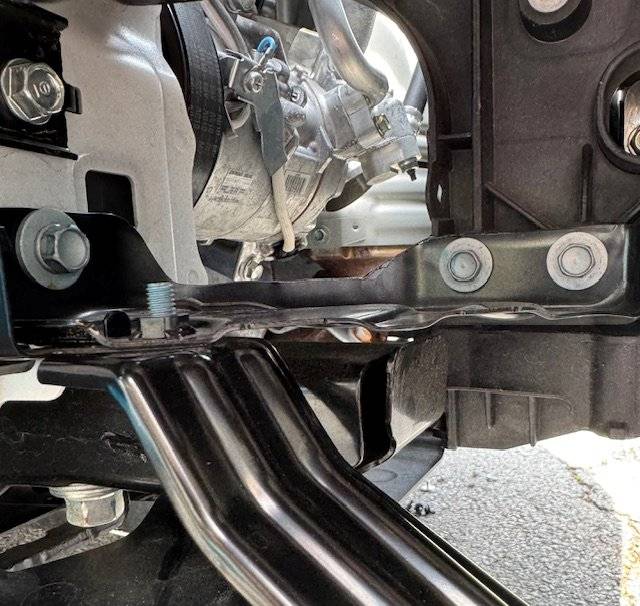

Same PIC after trimming, painting and reinstalling:
11th Gen Honda Civic J's Racing Hyper Intercooler 1745539636853-5

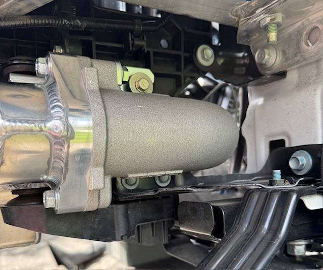

This PIC shows clearance after installing the HKS intercooler inlet elbow:
11th Gen Honda Civic J's Racing Hyper Intercooler 1745539876608-1n

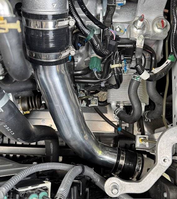

Other random post install PICs:
