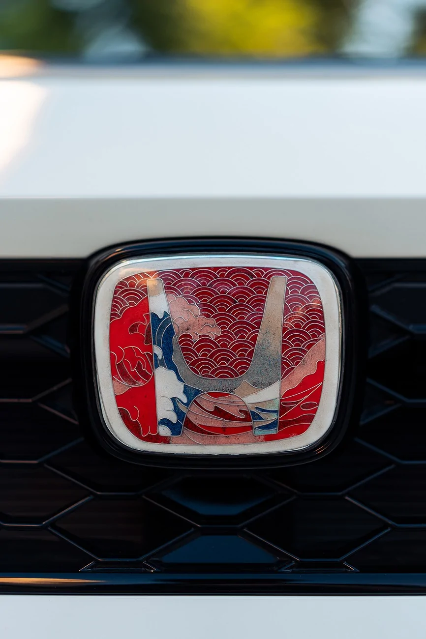

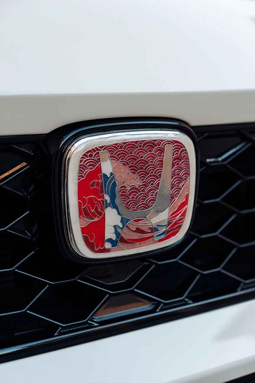

Wow, that logo looks really amazing and has such a personal touch! Thank you for sharing. This store will probably be my next mod stop I’ll likely buy something to protect it, like the front one OE mine is all chipped but for the price of the OE probably pull up a little more and get this amazing looking piece. Did you remove the bumper? If so, I might wait until I get the intercooler to do that 😂!
Yeah the value is definitely there to have something unique. I remember fk8 badge was like $50 after tax too so definitely not cheap for what it is.
You can access and pry off the metal clips reinforcing the badge if you take off the small bracket right below the front bumper tabs. 4x 10mm bolts. You might have to pull the bumper towards you to get more room to work in. Definitely easier than removing the whole bumper still.

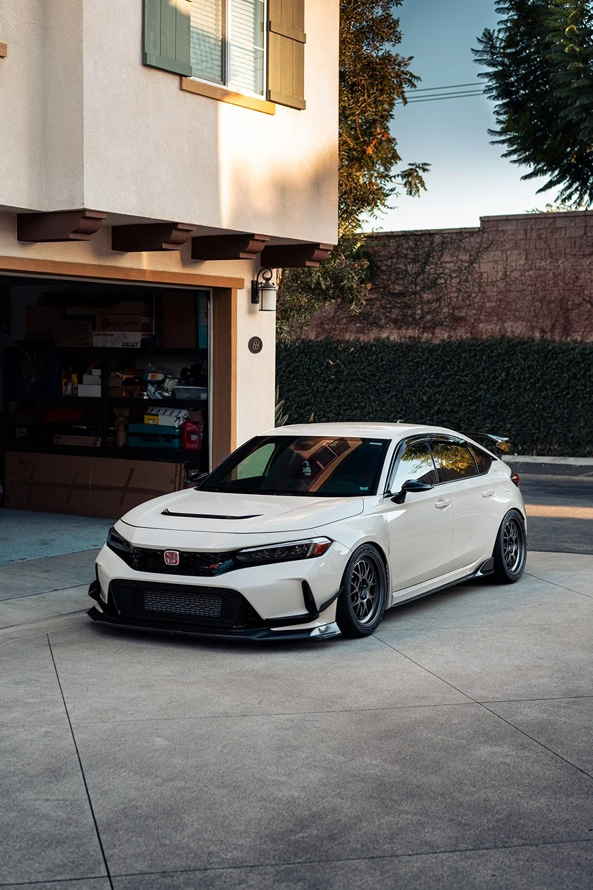

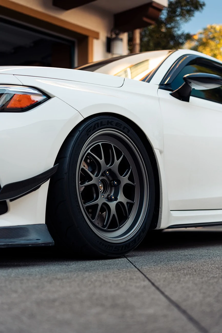

Took some stills with the new badge. 😆 Feels weird typing that since my entire professional career has been only photography and a sprinkle of graphic design. Also did more filming but that shit takes an entire afternoon to do a minute clip. 😮‍💨

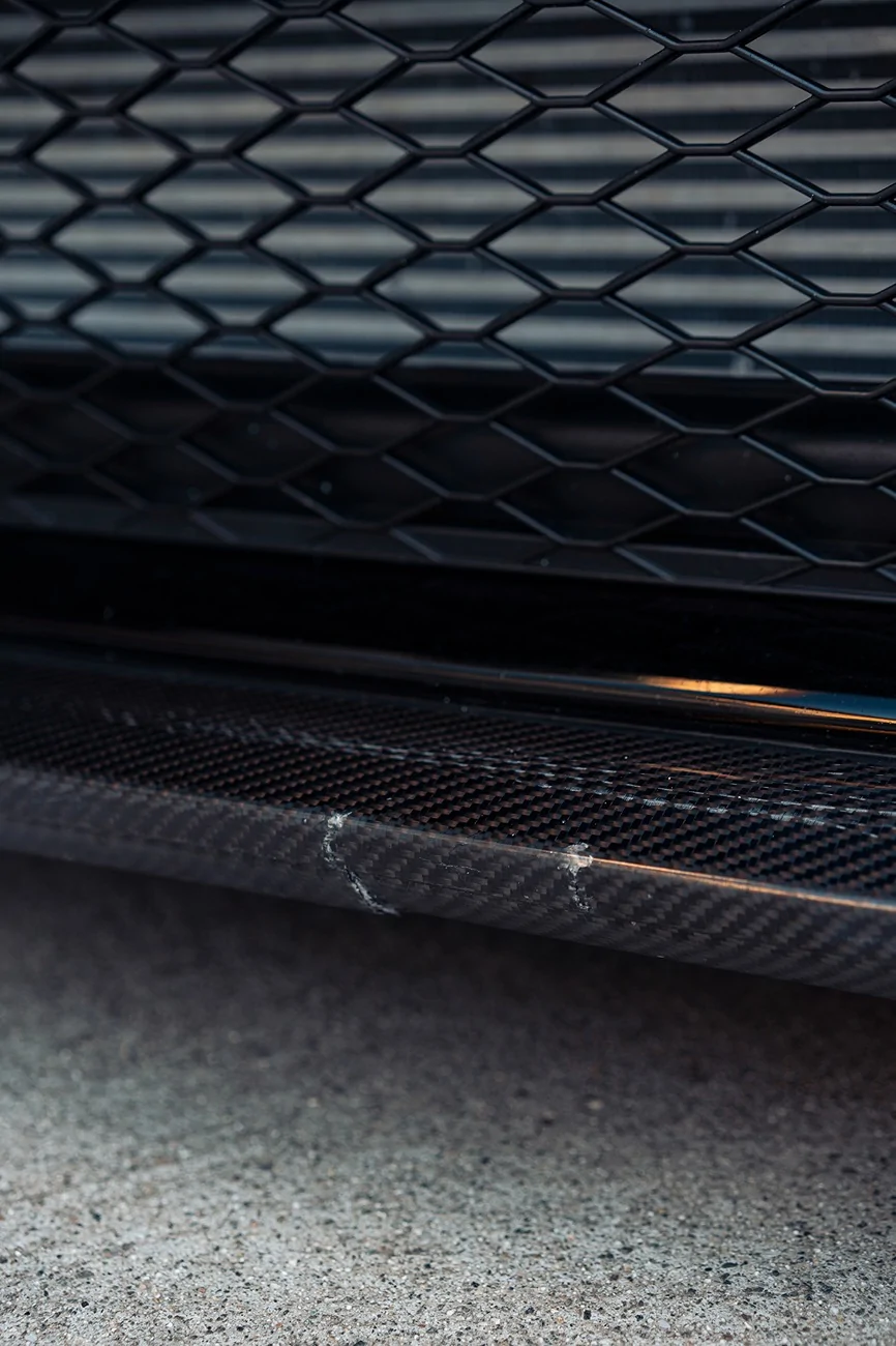

And now some bad news. Big wheeler blown tire on the highway slapped my front lip while going 65 (slowed down to 65 😭) Shit cracked all the way underneath. Already hit up a mobile cf repair guy but we'll see if they get back to me.

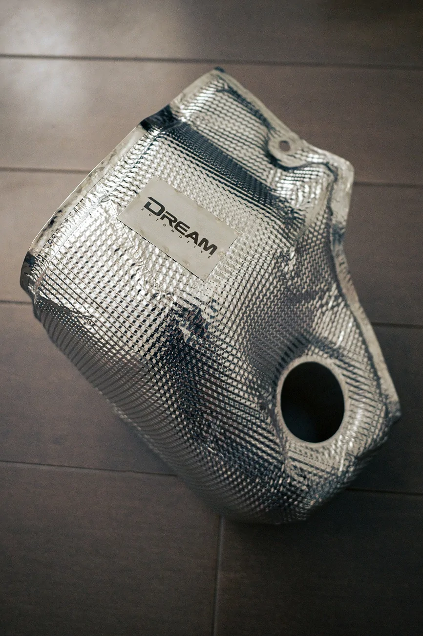

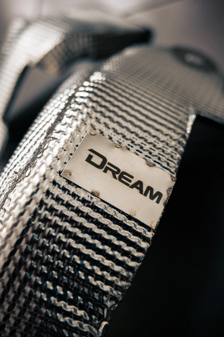

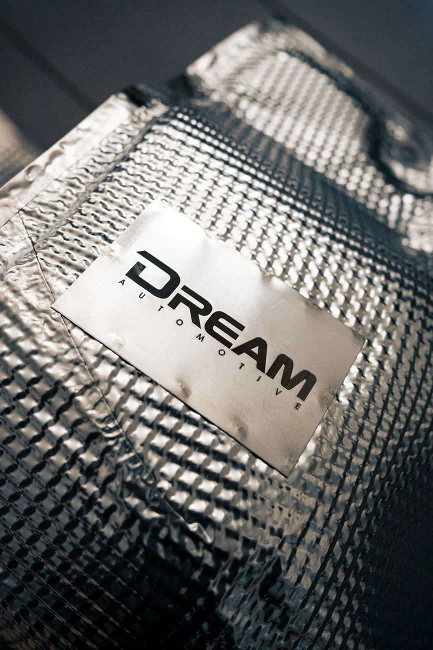

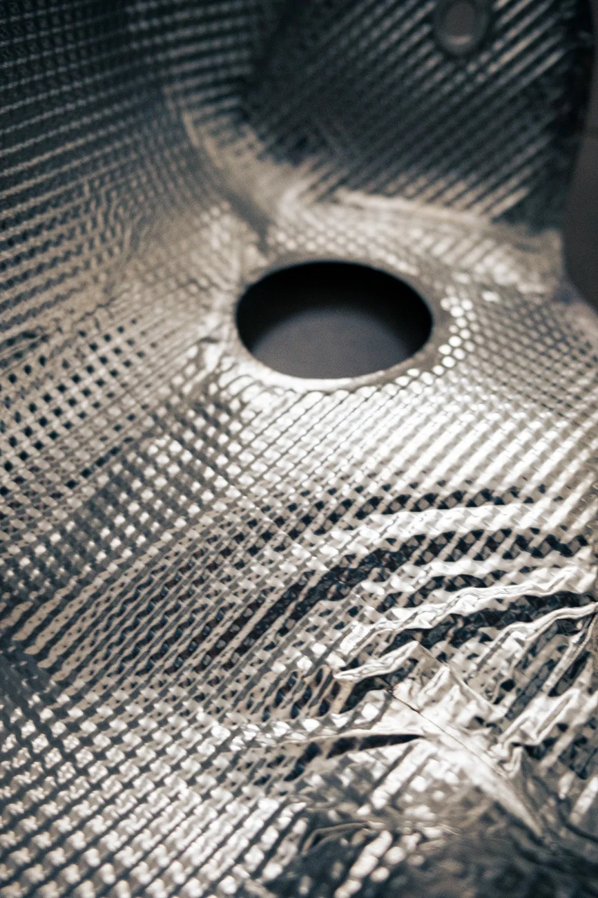

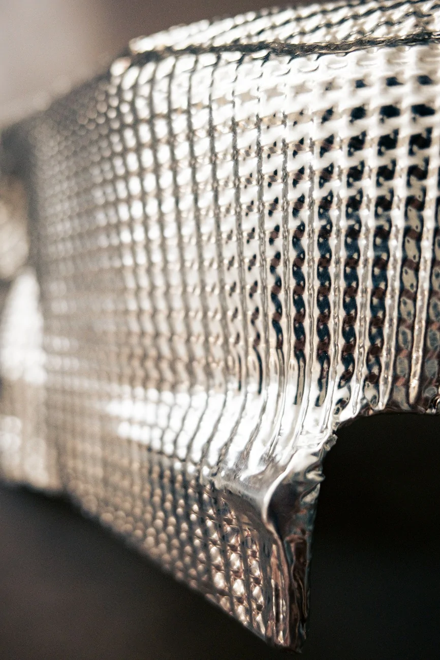

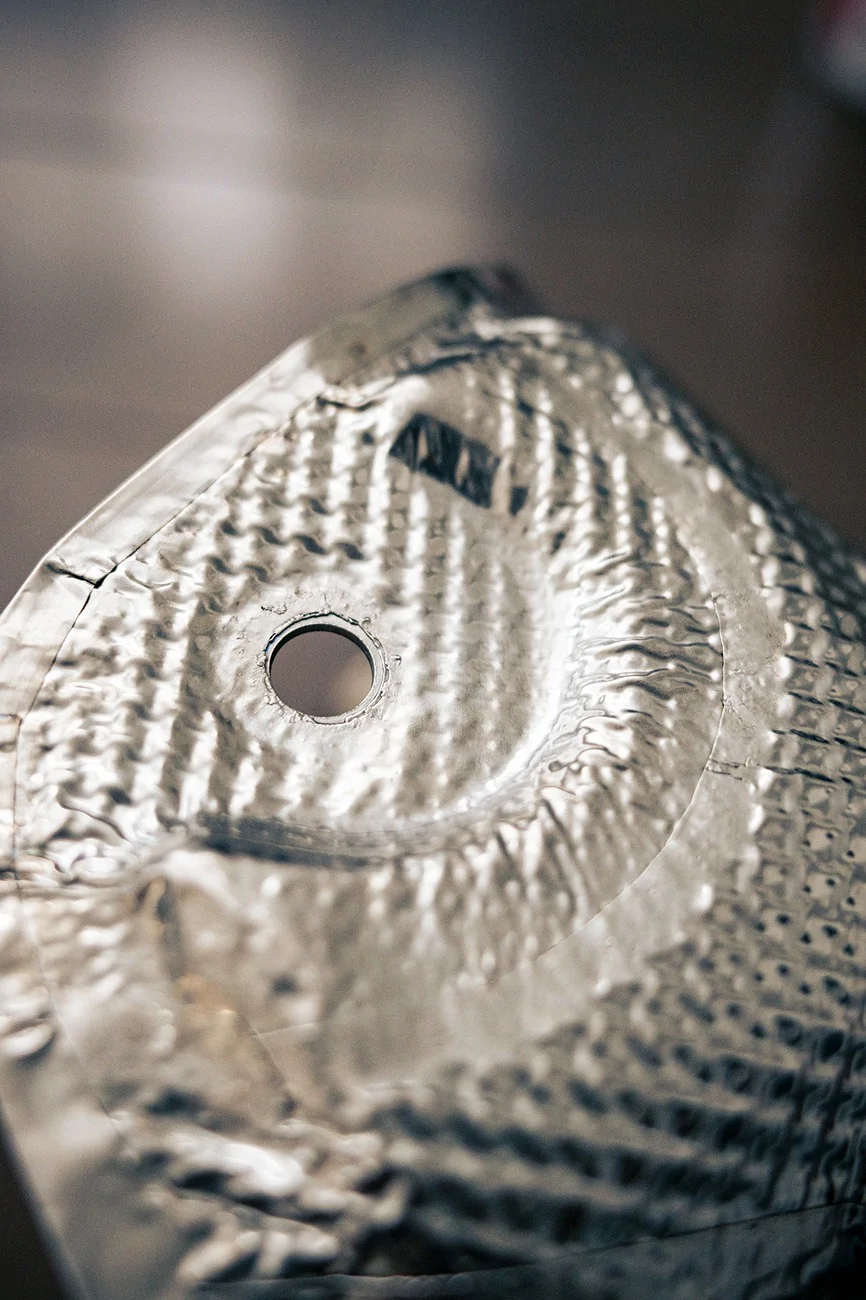

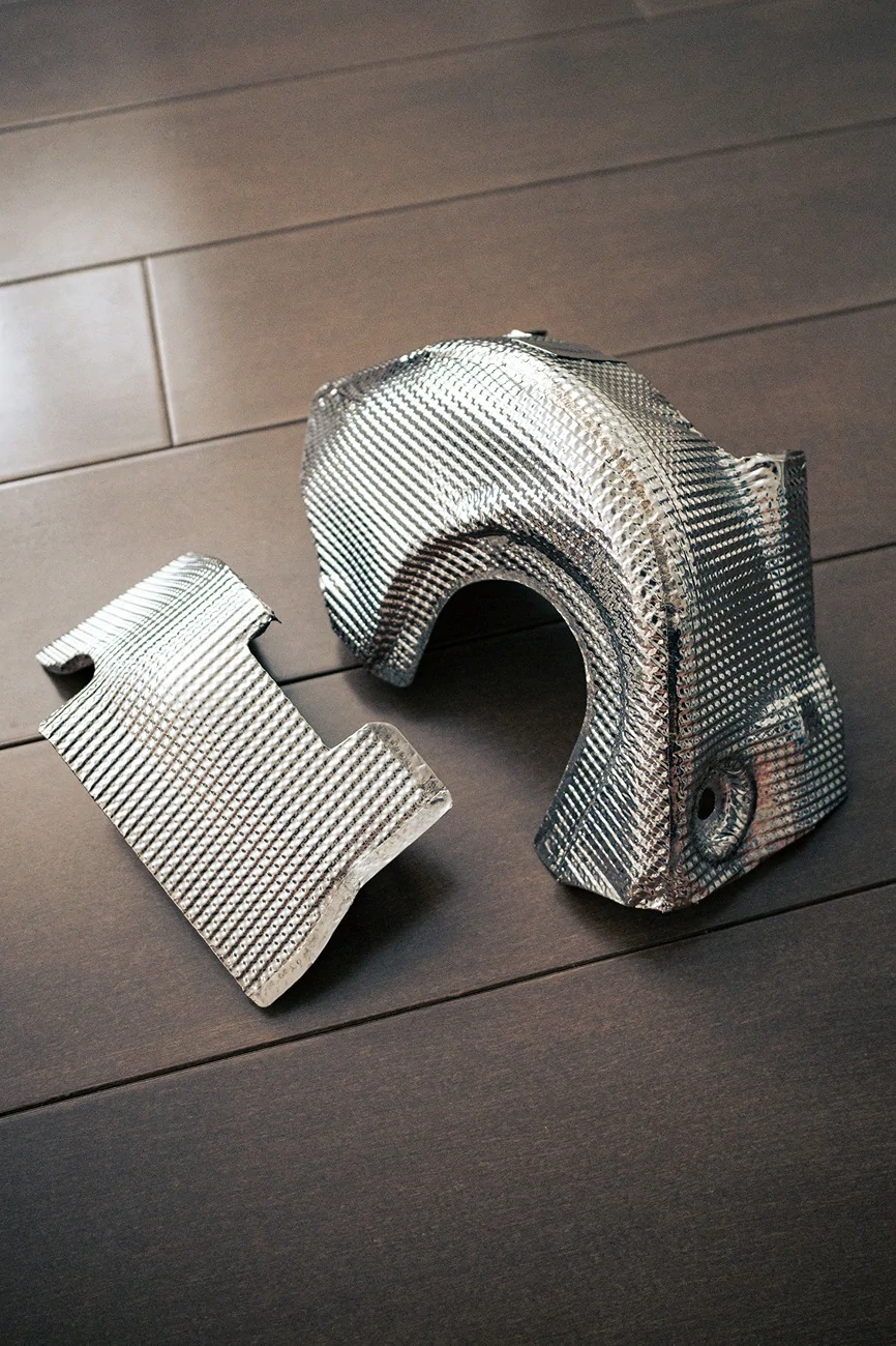

Dream Automotive OEM style Hard Lagged Turbo Heat Shield + the other Dream Automotive Hard Lagged Turbo Heat Shield. Got them both from Unity Performance (referral link) I had no clue they were running $50 off $500 purchase.
Pretty sure this is overkill but I was curious to run both...pretty sure you can run both even though I haven't seen any photos. Going to wait until I get my downpipe arrives to knock these out with it.
11th Gen Honda Civic Kazuo_WFC 2025 Civic Type R build 1787871124000_R0001603
Underside of the OEM one.
11th Gen Honda Civic Kazuo_WFC 2025 Civic Type R build 1787872341000_R0001604
Steamy Dreamy

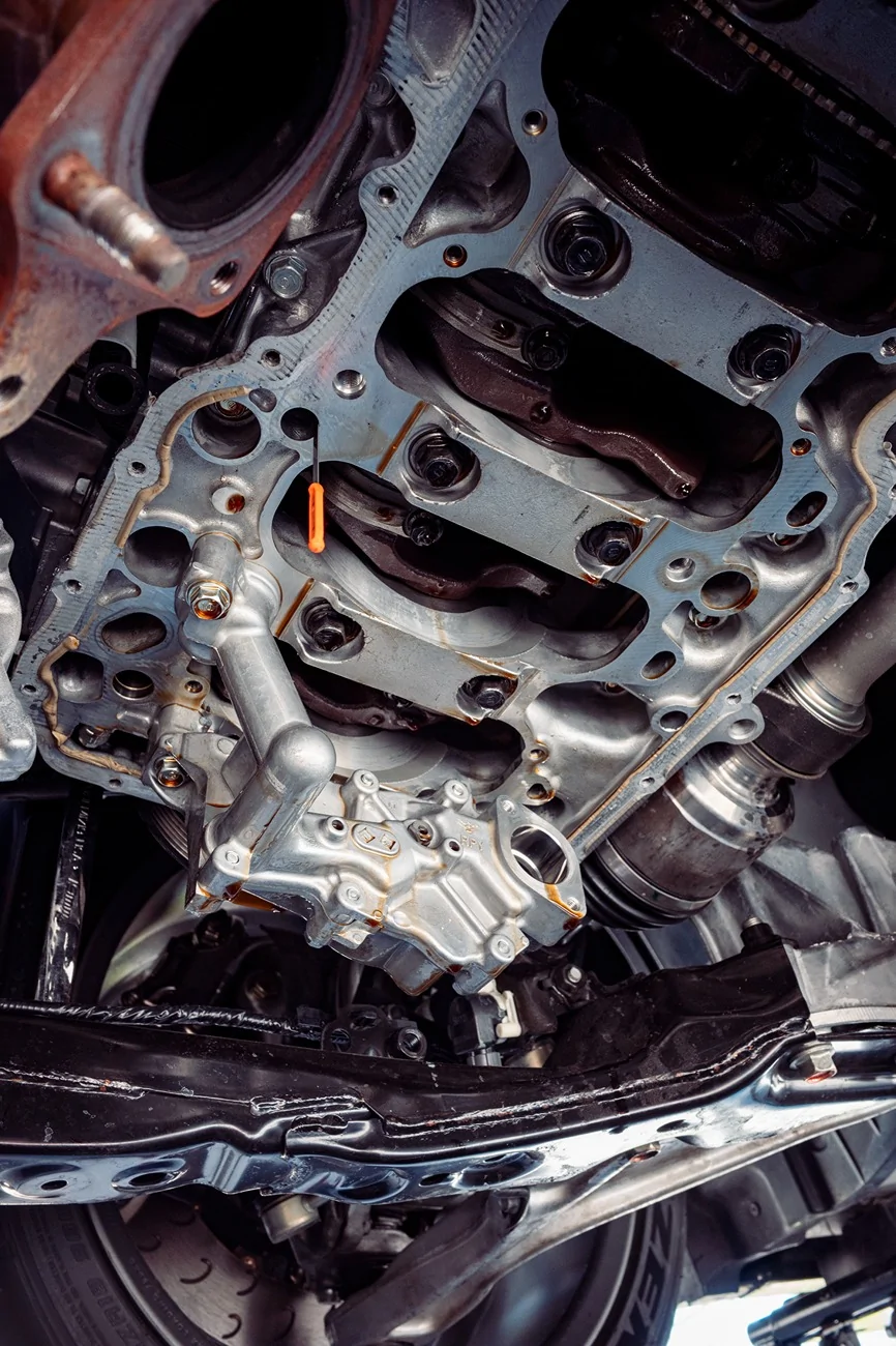

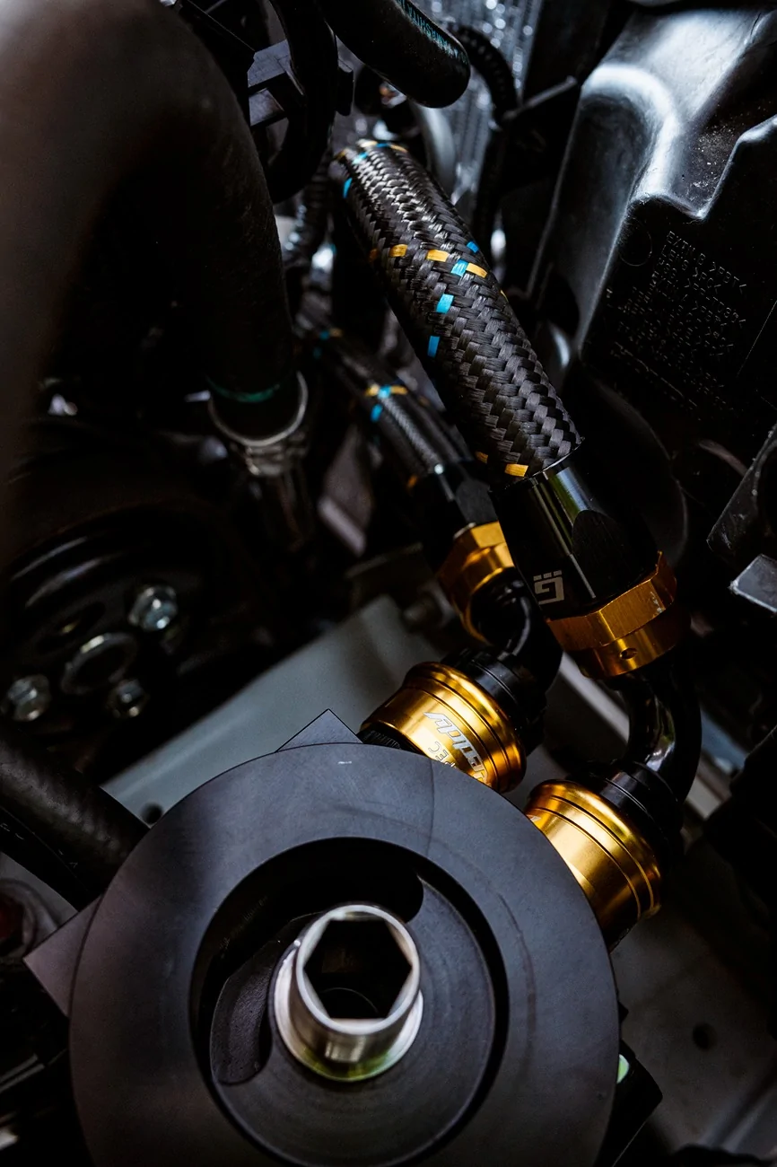

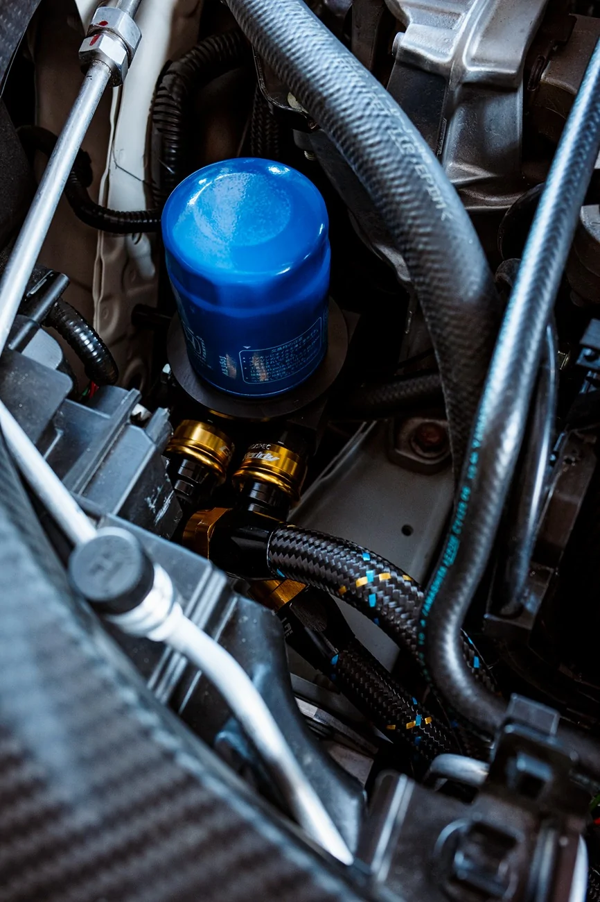

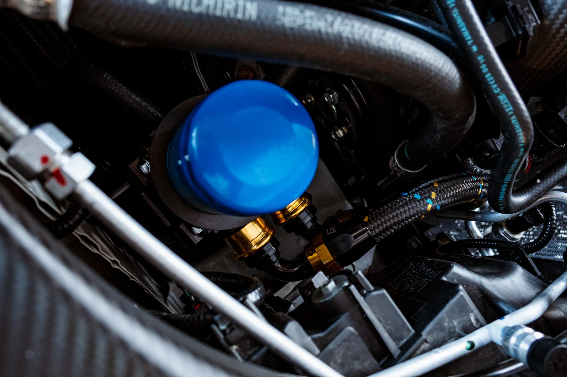

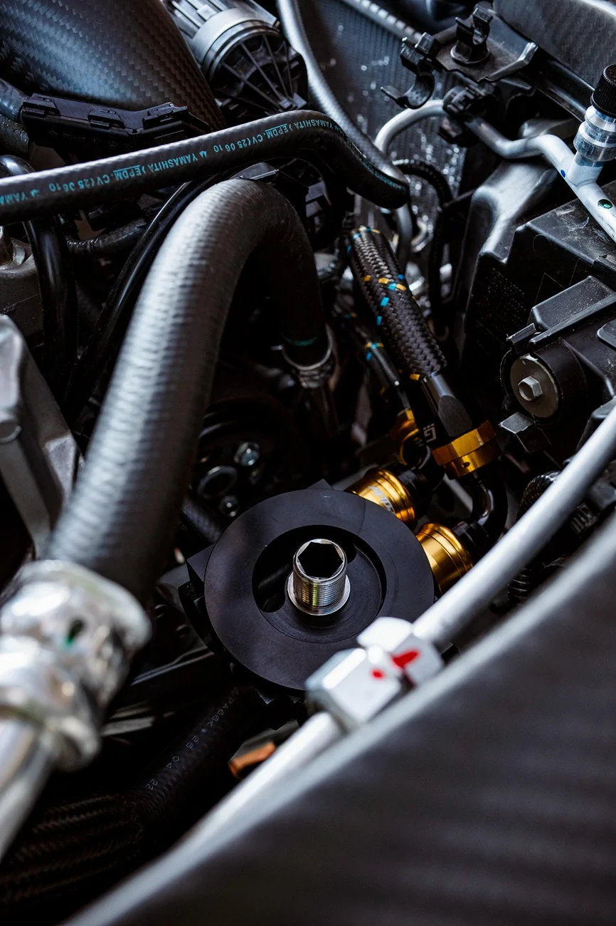

Finally installed my oil filter relocation kit that I pieced together. (Parts list) With the help of Santos we measured out and built the 2 AN hoses. Forgot to take a photo of the oil plate installed. Now I can show off all the bling oil filters. No more Fran filters for this idiot.

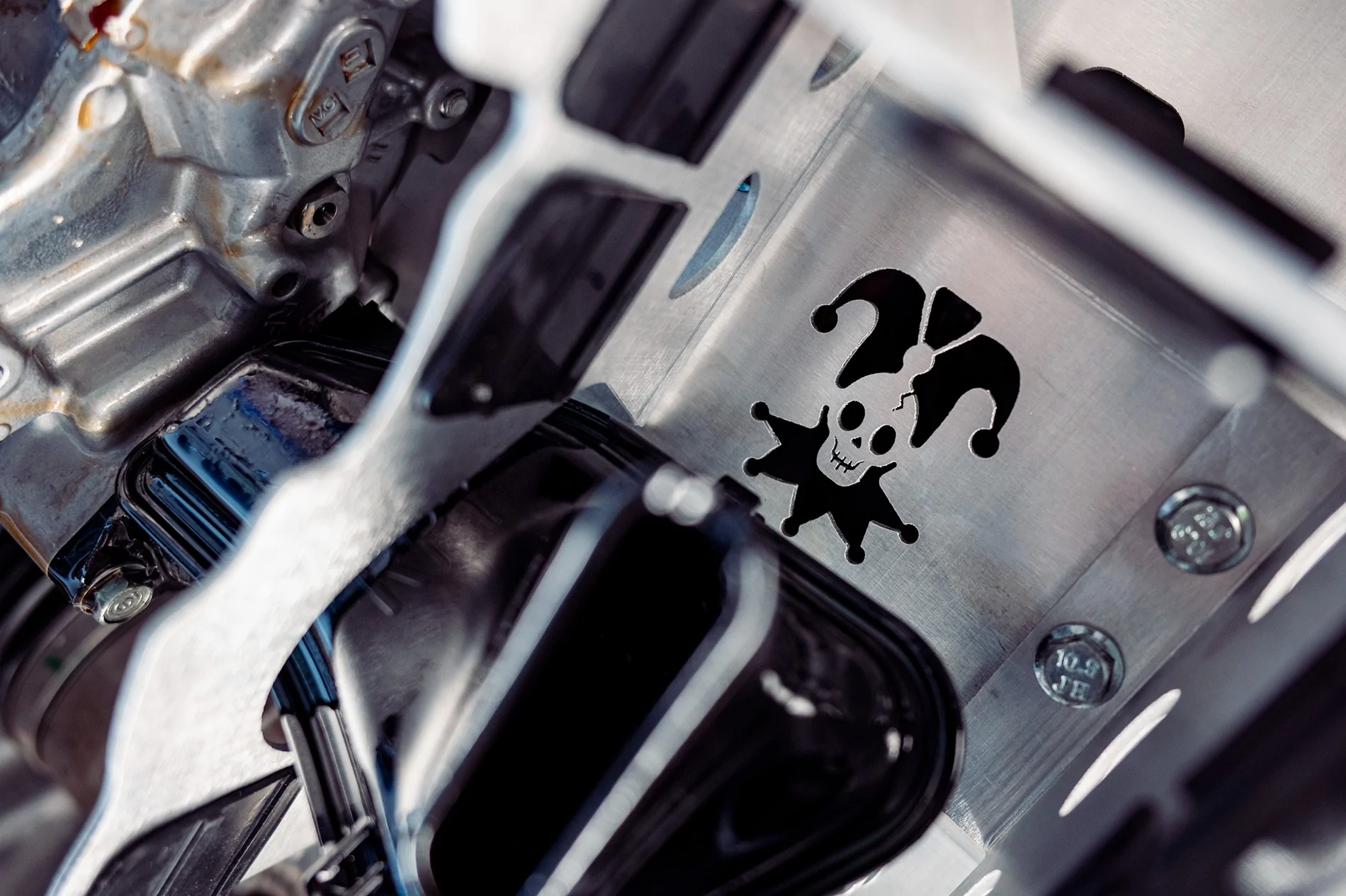

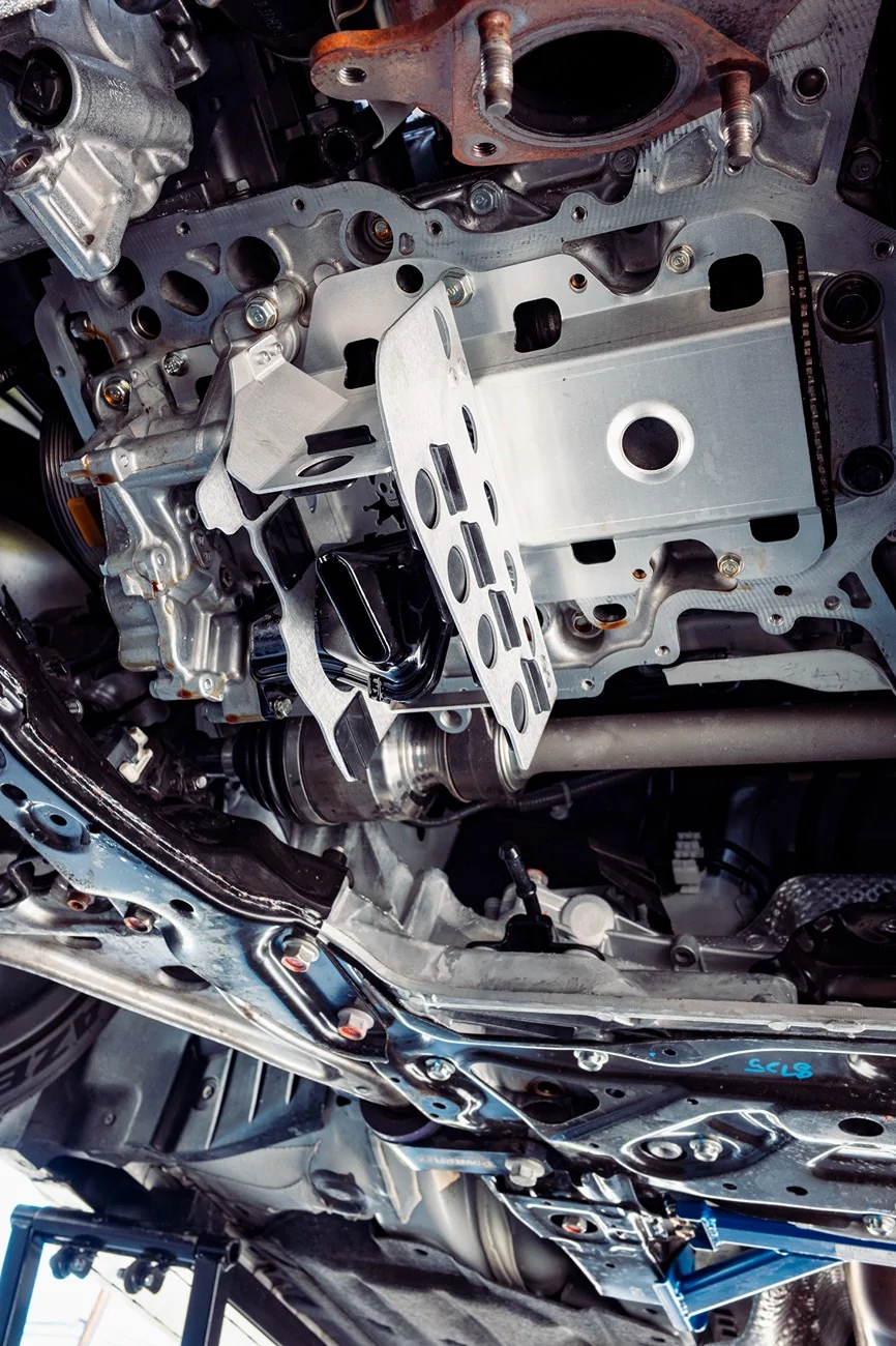

Also installed the Wunderladen oil baffle plate! Was excited to get this on as the data Austin posted was great to see while on the track.

So I got a quote of 1k to fix the Cleib lip and yeah I just bought a cf repair kit on Amazon and patched it. Sanded down the top coat till the spidering went away and then just chipped off the cracked resin on the bottom part and added a patch of cf. Going to sand it then 2k clear it after. It seems dry already (4 hrs) but I'll wait till tomorrow after work.

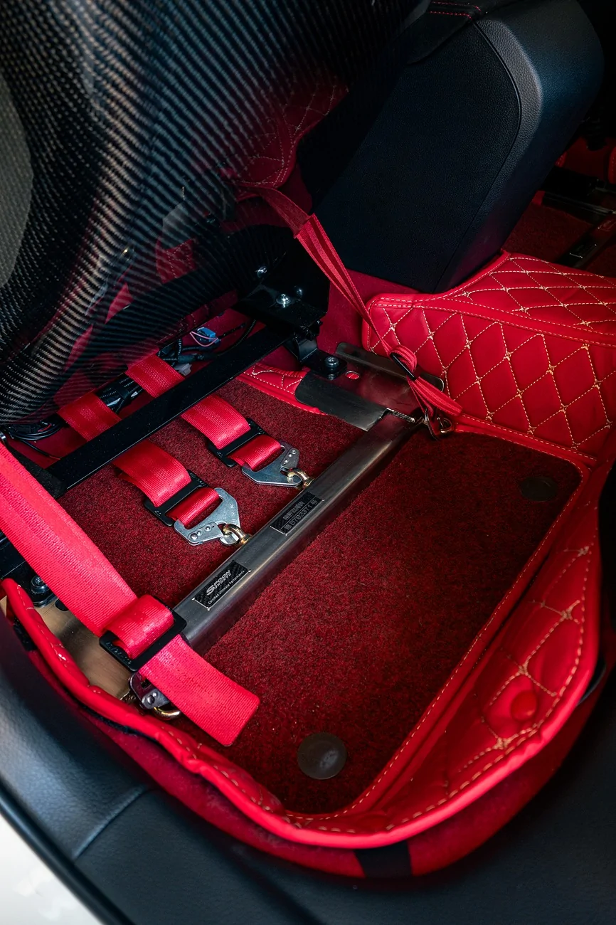

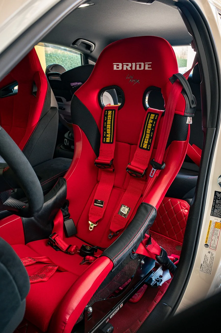

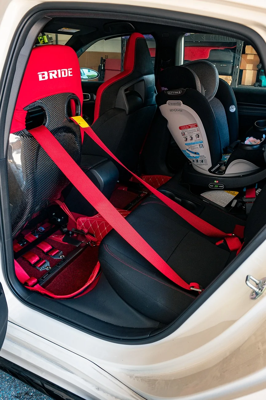

Finally added in the Schroth 6 point harness with the snap in fittings. Bolted their snap fitting kit to the rear seat belt mounting points and the rest went to the Spoon harness bar. If you see anyone using the harness bar in a different way is asking to get chopped. 😅
Wanted it to be a semi-permanent setup so the wife could still sit in the backseat with our daughter. I tested it after and it doesn't get in the way of using the seat belt. Unfortunately I'm sure my wife will not see it in the same way. Hahaha.
3 point seat belt for daily use then 6 point to give myself a few octaves higher of screaming when I code brown on the track.

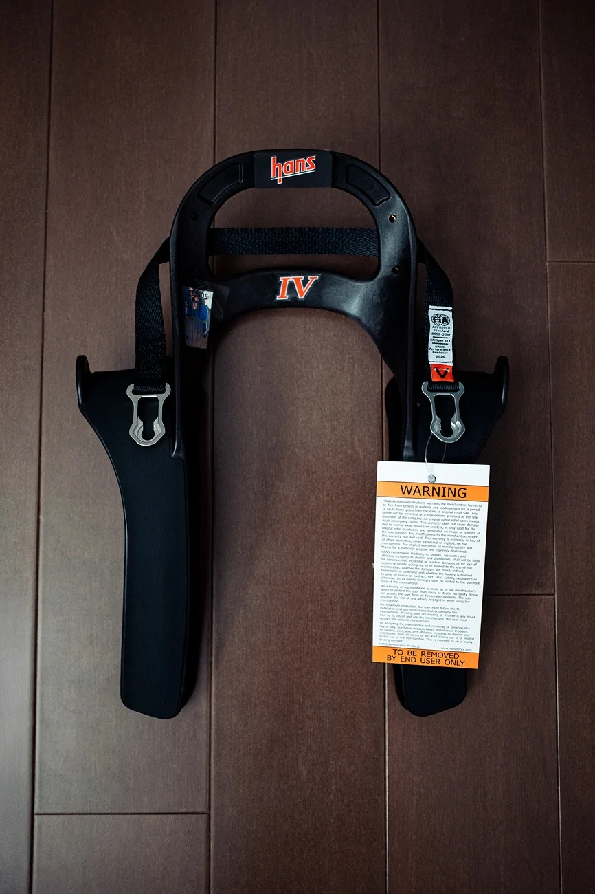

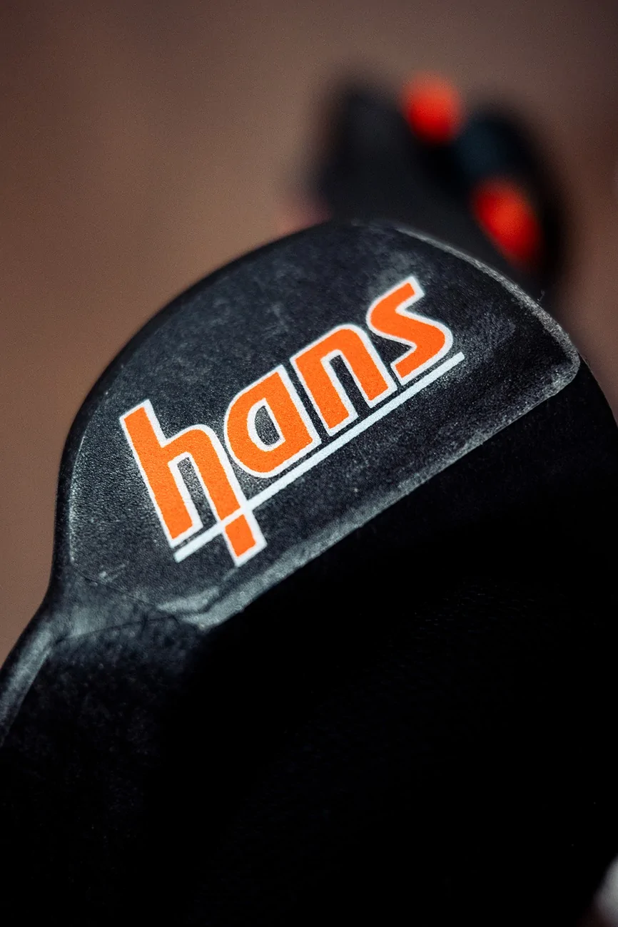

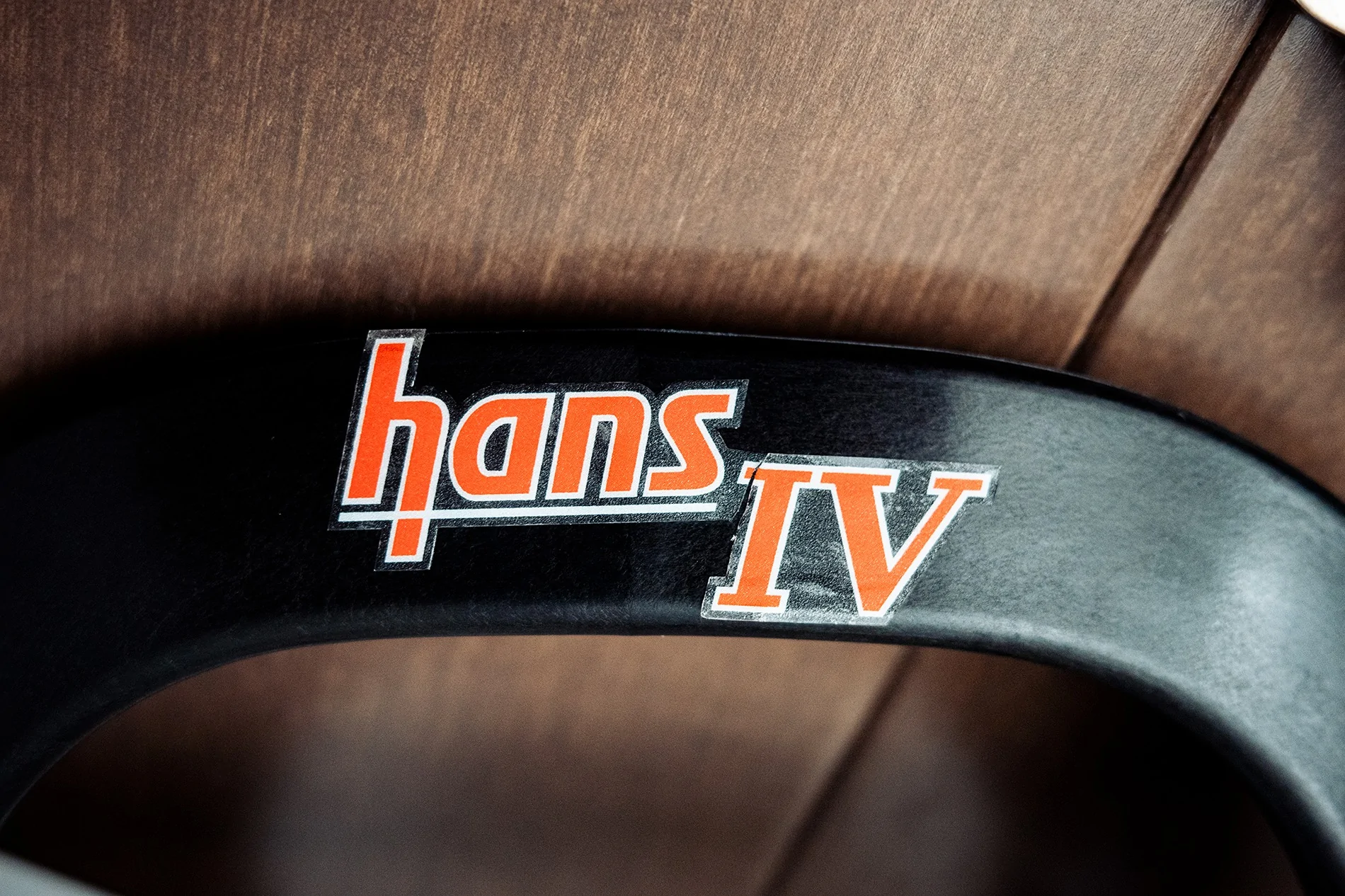

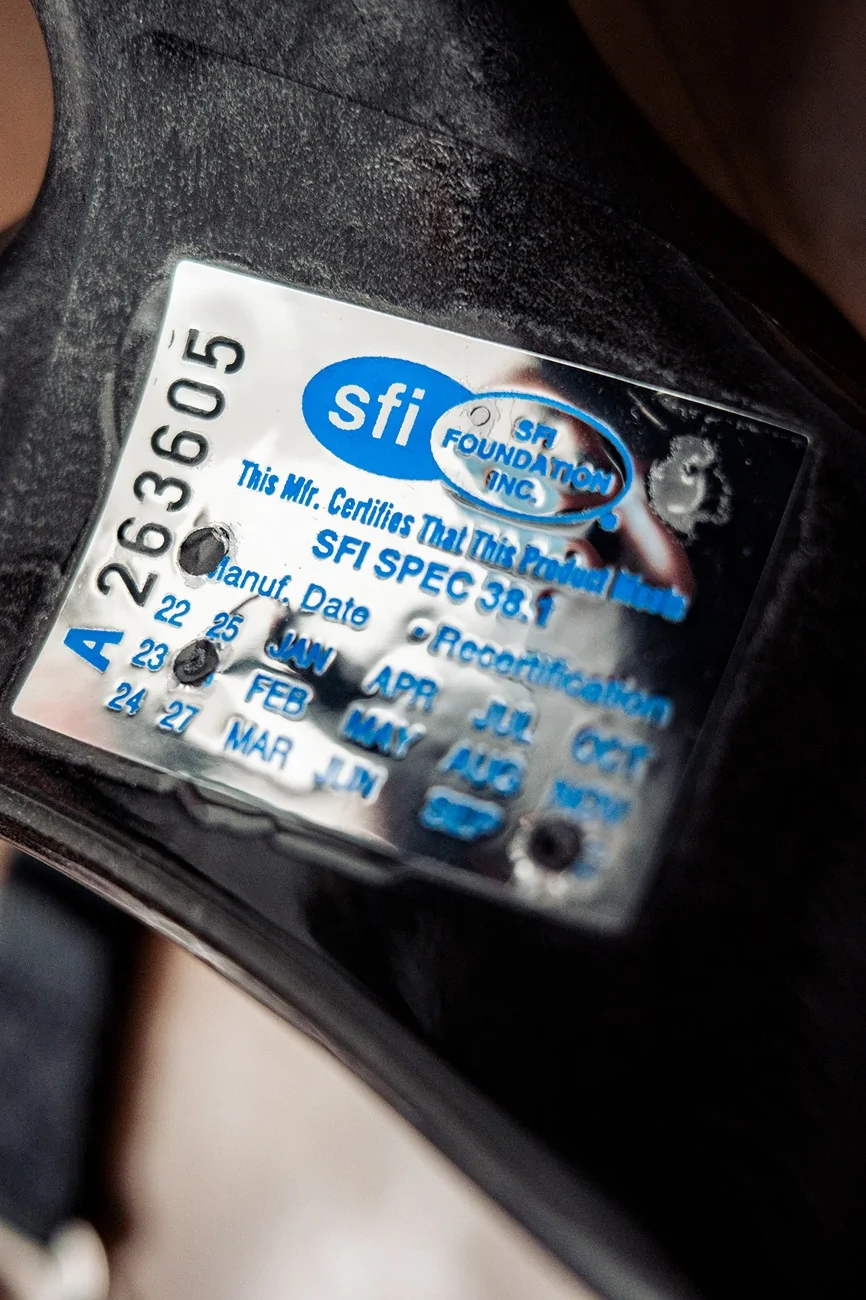

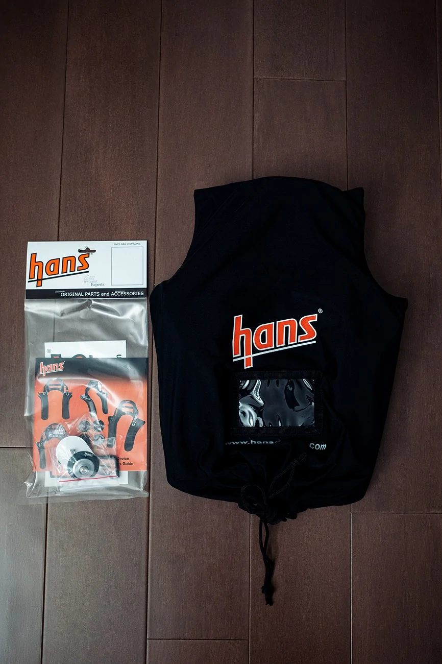

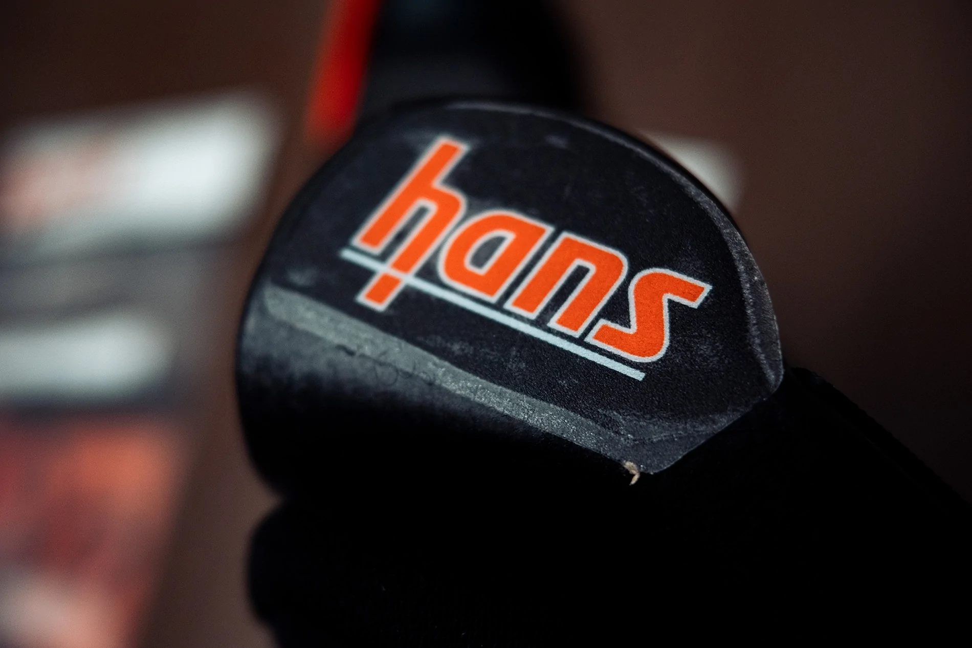

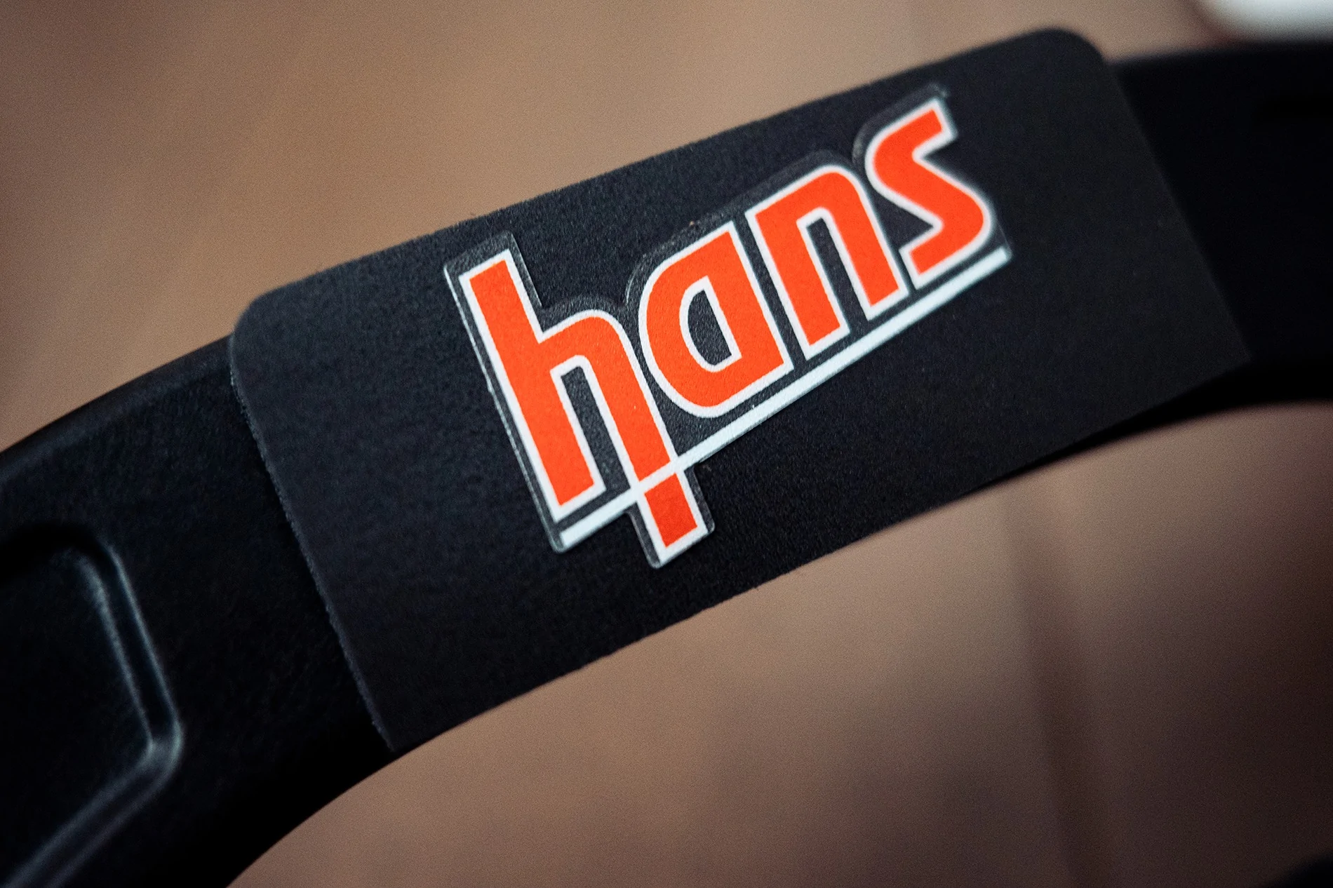

Received my Hans IV FHR. I appreciate the packaging and included dust bag for it but placement of the shoulder rubber grips is placed off on the right where it looks like it'll eventually start to lift. Even more so all the decals are just slapped on with zero thought as I had to remove the "IV" cause it was really crooked haha. I mean yeah sure doesn't harm the performance in any way but for $440 w/ tax and shipping I'd expect the logos to be printed on or at least applied properly.
11th Gen Honda Civic Kazuo_WFC 2025 Civic Type R build 1790285461000_R0001684
11th Gen Honda Civic Kazuo_WFC 2025 Civic Type R build 1790285538000_R0001685
The "IV" was originally hanging at the bottom of where it should be placed and wasn't even pressed down.
11th Gen Honda Civic Kazuo_WFC 2025 Civic Type R build 1790285775000_R0001686
Am I reading this right? Manufactured from the future?! Dec 2026.
11th Gen Honda Civic Kazuo_WFC 2025 Civic Type R build 1790285841000_R0001687
Lifting stickers are the bane of all car enthusiasts.
11th Gen Honda Civic Kazuo_WFC 2025 Civic Type R build 1790285943000_R0001690
When you check the product photos it used to be a die-cut decal like the one below but they decided to make it the shape of the area....which clearly looks worse based on whoever applied these.
11th Gen Honda Civic Kazuo_WFC 2025 Civic Type R build 1790285881000_R0001688
This is placed on soft foam. 😑
11th Gen Honda Civic Kazuo_WFC 2025 Civic Type R build 1790285915000_R0001689
I tried to place it centered but I didn't notice it was a one piece decal. FML. Long as this shit saves me from neck pain and injury. I used to use a K-1 foam neck pad to help with neck fatigue. At least that had screen printed logos. 😅
