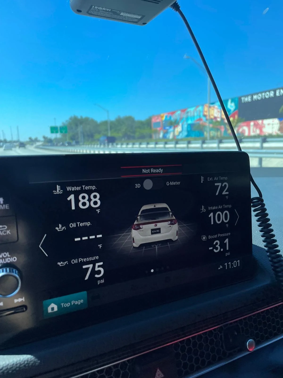

LogR oil temp not reading!!!

Took the car around my neighborhood And the burbles Came back on and thankfully no trouble code. So I'm going to assume I'm good. Thank you for responding And being helpful.
If it happens again just clear codes and restart. It’s more prominent in Cold starts.

Greetings fellow Type R enthusiasts and owners.
I want to share that my FL5 has done this twice. Purchased new, 1st occurrence at 300 miles +\- no MIL, tried cycling ignition no luck.
Disconnected the battery, oil temp came back.
2nd time at 1k miles, same thing no MIL, no oil temp.
Taking Jester04’s advice, put a scanner on and it showed random misfire codes.
Cleared and oil temp came back.
On both occasions, it happened after a 20+ minute drive then a 15 minute stop at a store. Start it up and the oil temp doesn’t show.
Might it be something associated with the stratified start?
