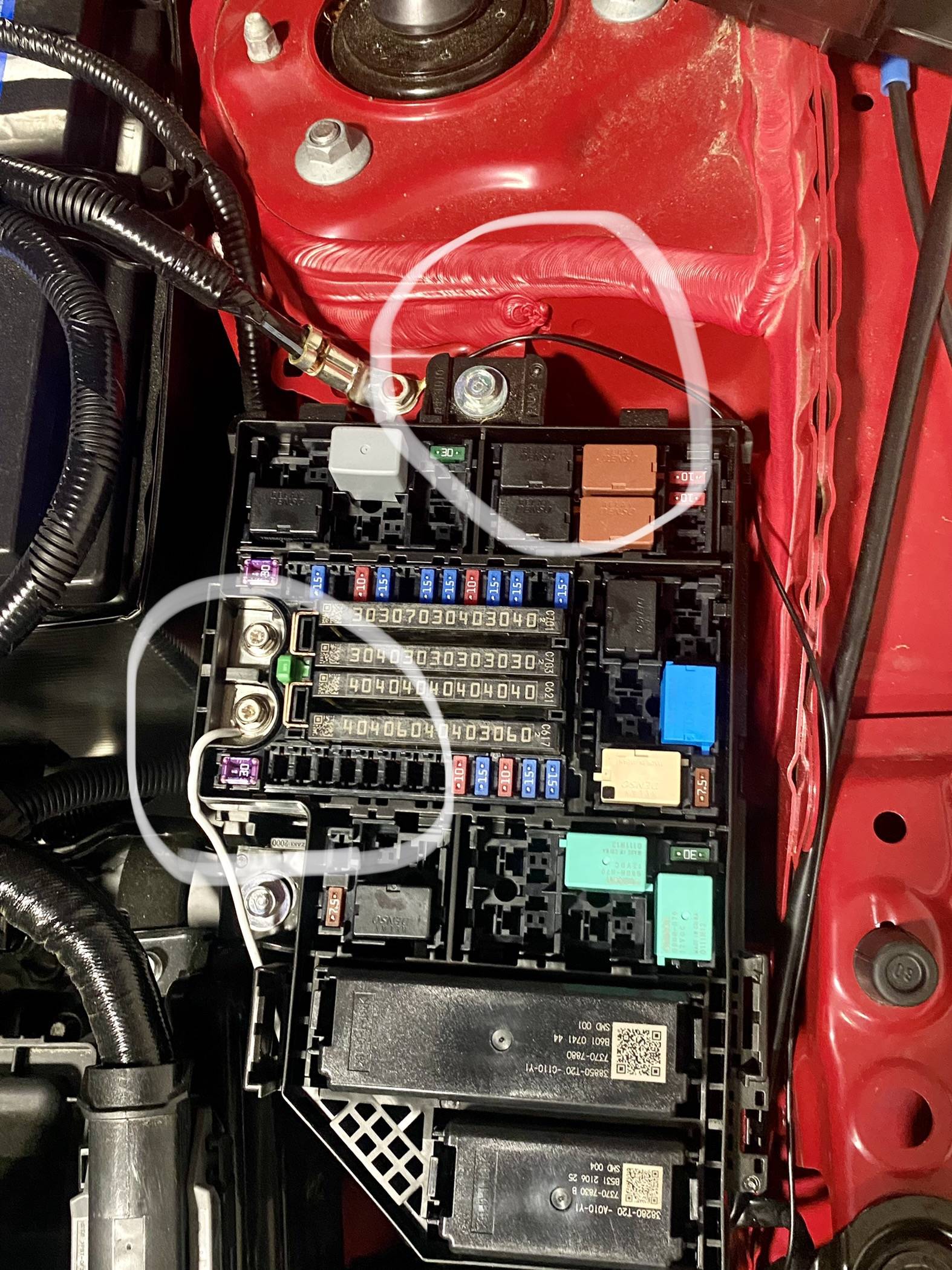

Anyway you could provide a parts list for your install and a brief description? Is a new wire harness necessary for the installation? Looks great!
11th Gen Honda Civic Looking for 2022+ Civic Si OEM Fog Light Installation Help C17223CB-2185-4D99-913A-4FD2BFD0D8C9
comes with wire harness
Also used these to tap it to the cable for the head lights

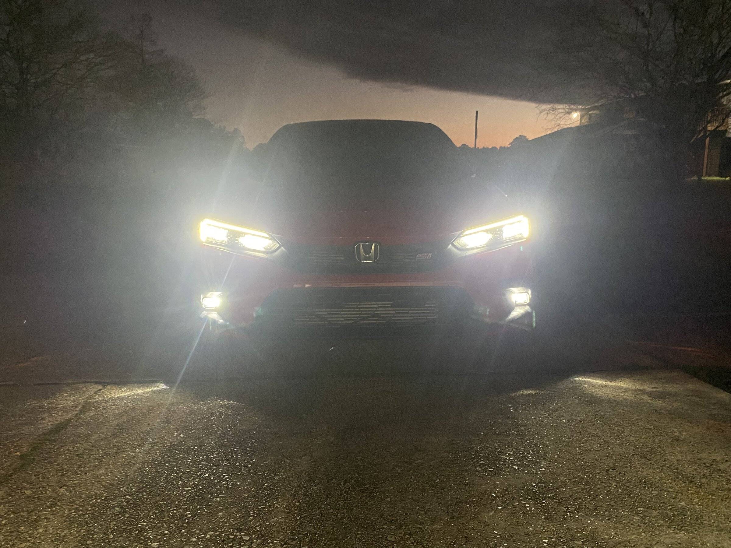

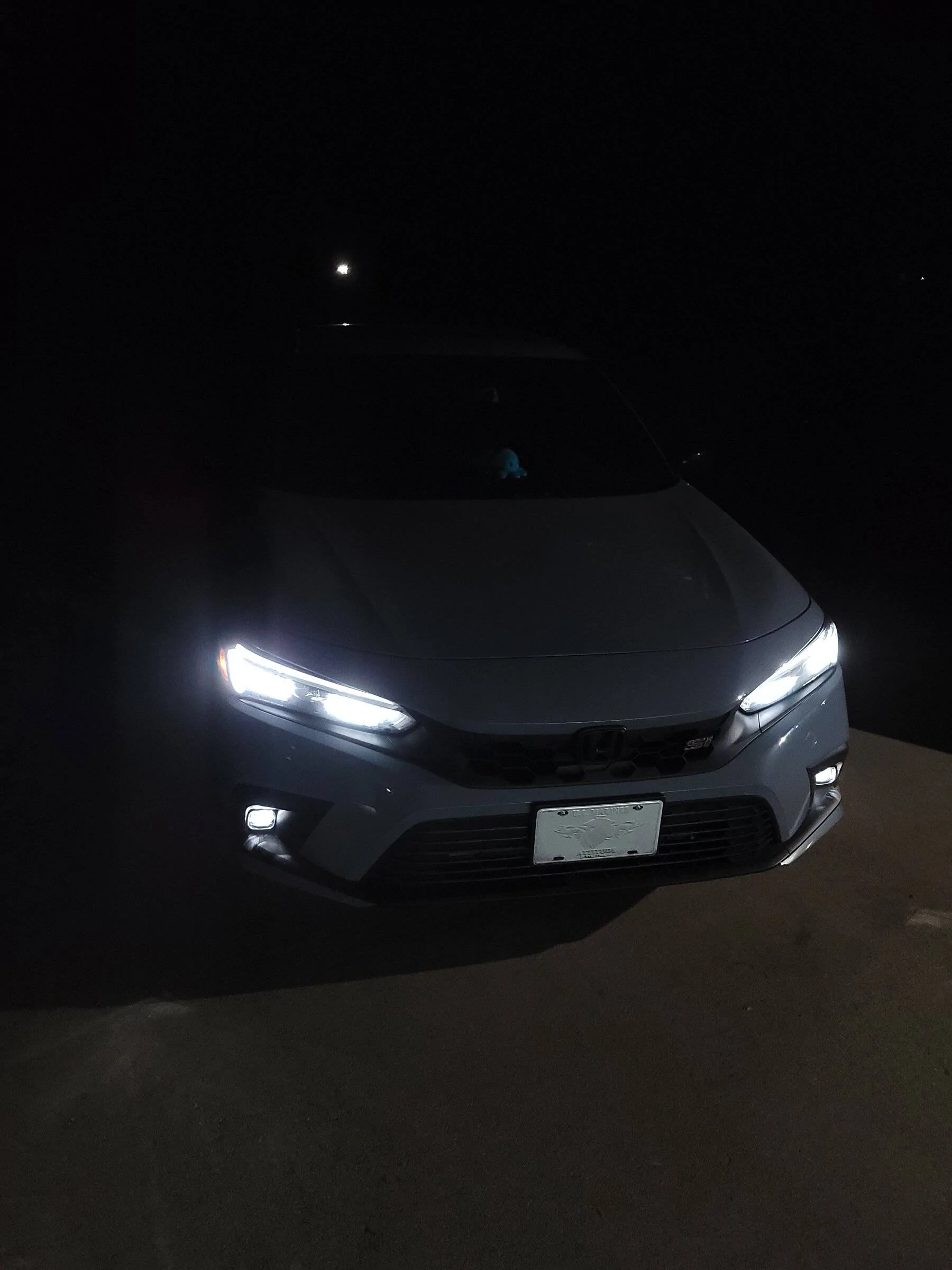

I can also say you’ll notice a huge difference with these fogs on

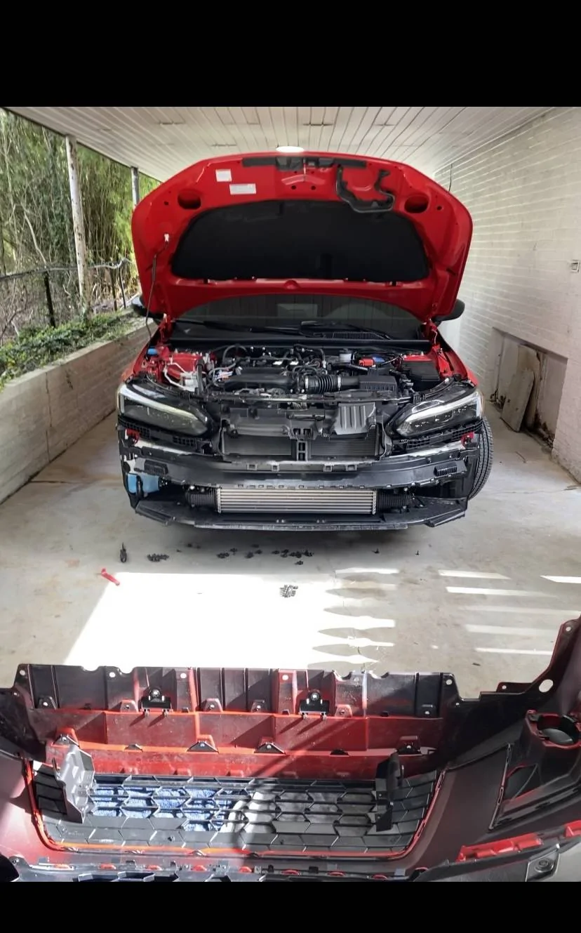

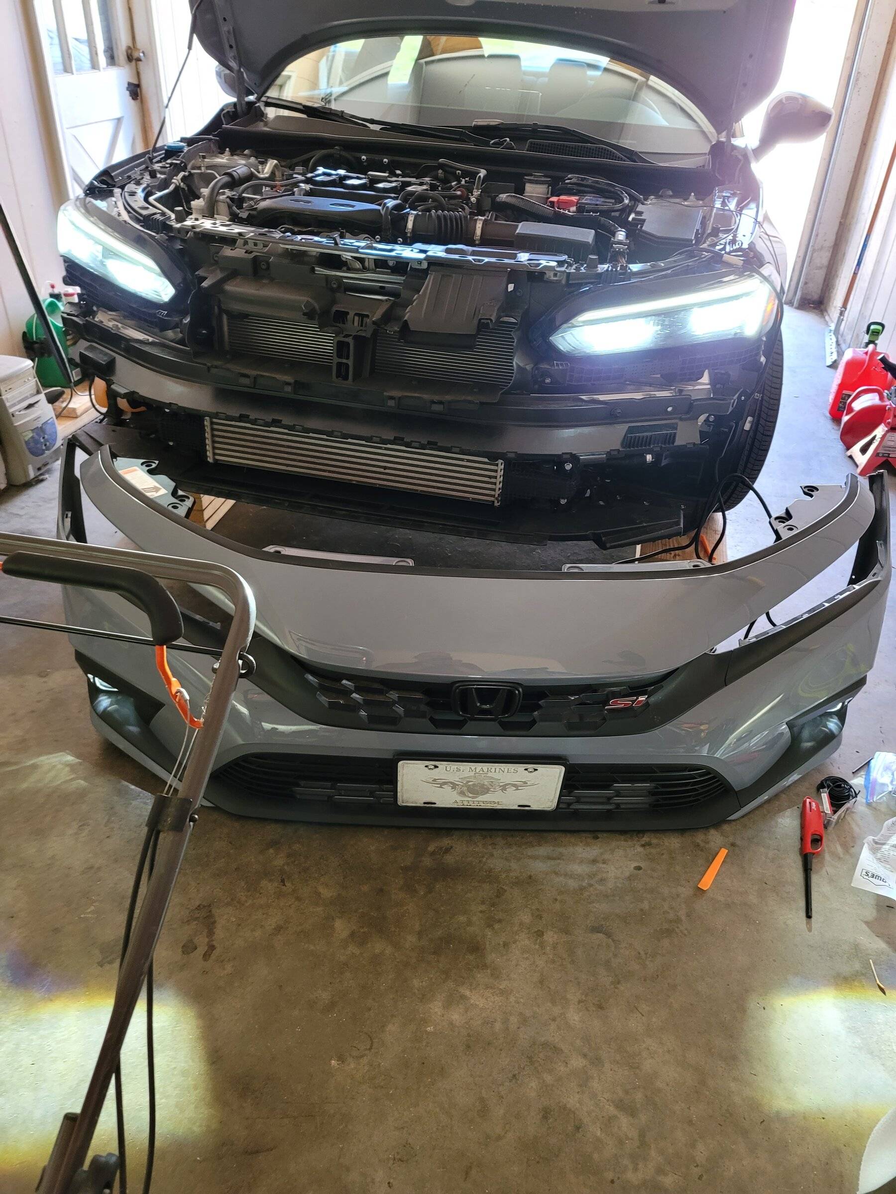

I recently got my fog light kit, and I did install it! Here are the results!

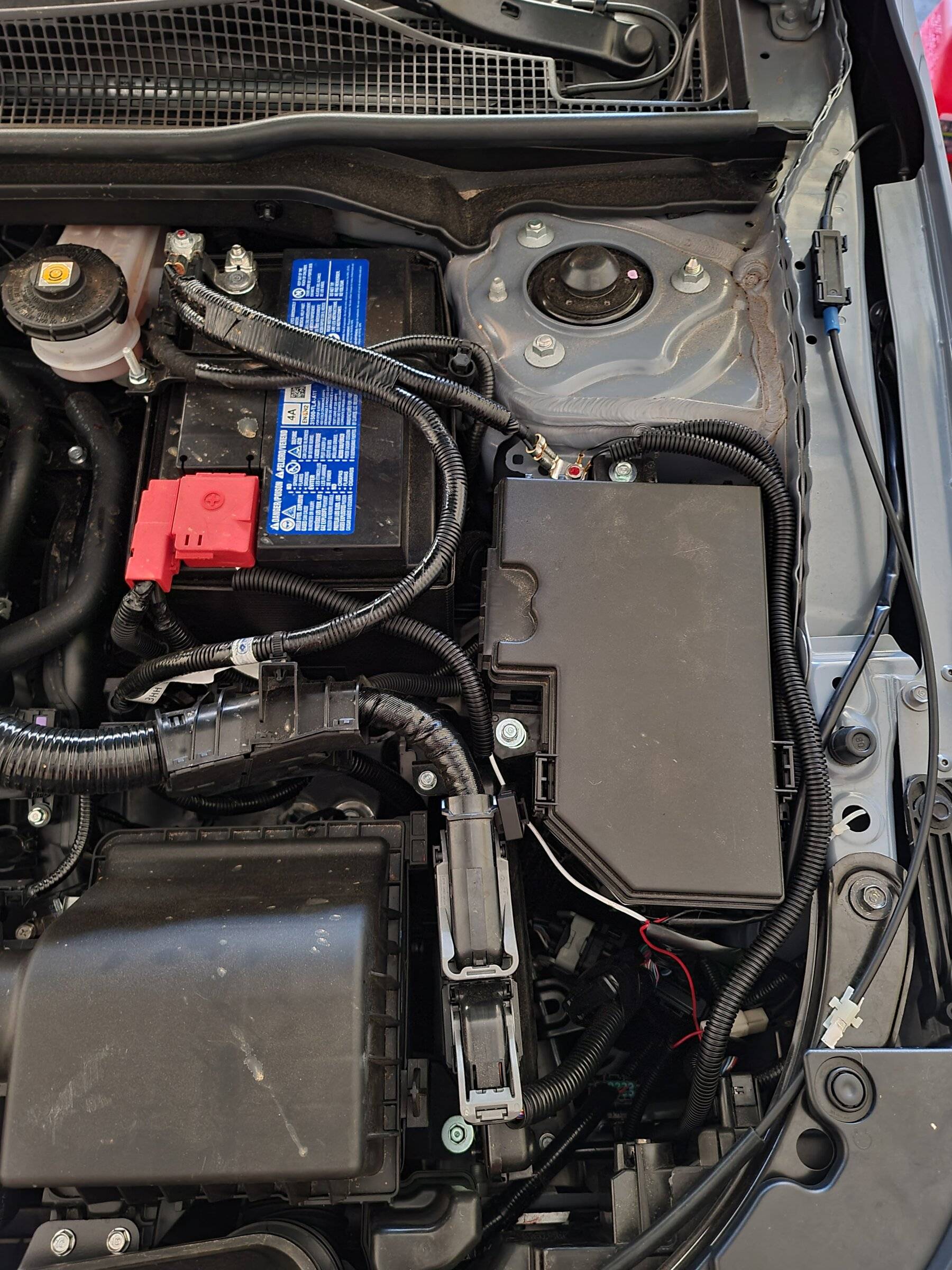

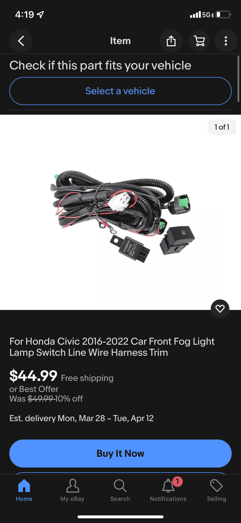

I did purchase the kit that SucubaSteve bought of ebay from ' yzhu0077 ' . It comes with the needed wires, lights and switch needed to install them. However I did need to extend one of the grounding wires so it'd reach the ground that I used. I also opted to purchase the OEM honda fog lights, to replace the lights that came with the kit.

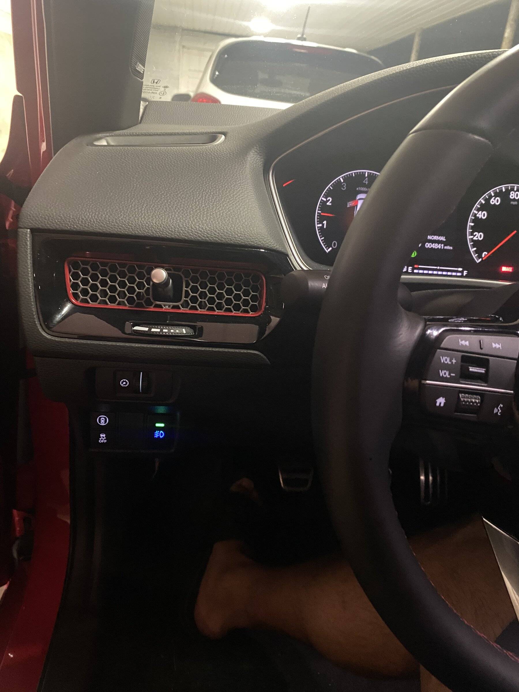

Note: I ran the switch wire though the side driver fender, and through a rubber grommet on the side into the cabin.
11th Gen Honda Civic Looking for 2022+ Civic Si OEM Fog Light Installation Help 20220326_155531
11th Gen Honda Civic Looking for 2022+ Civic Si OEM Fog Light Installation Help 20220326_152116

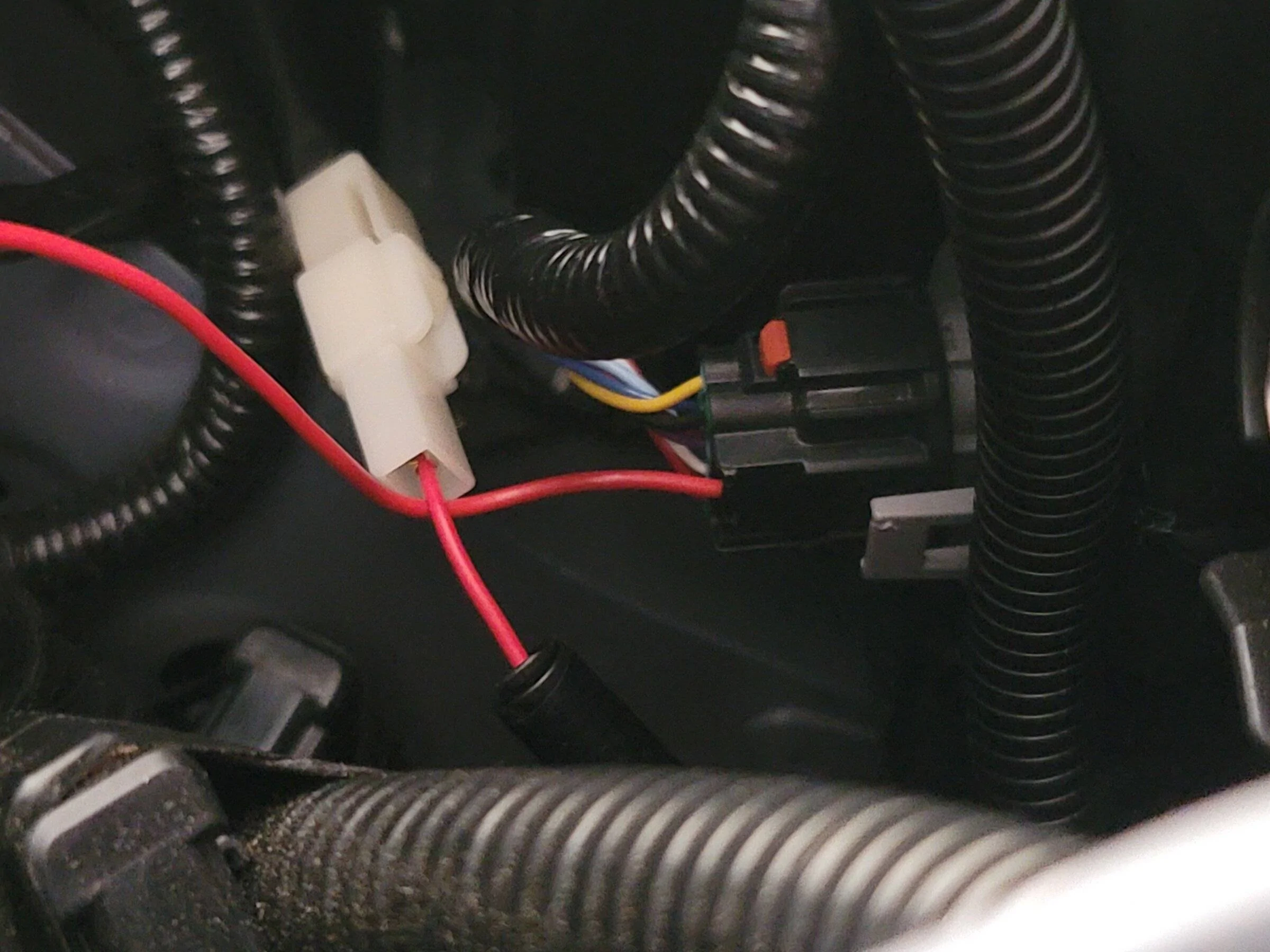

This kit does have a postion light wire, I just finessed the wire under the locking clip and seated it ontop of the oring that helps seal the connection, into the left driver's side headlight; directly to the DARK BLUE wire, however the connection for the headlight doesn't lock but it is snug enough that vibrations won't effect it.
11th Gen Honda Civic Looking for 2022+ Civic Si OEM Fog Light Installation Help 20220326_155555

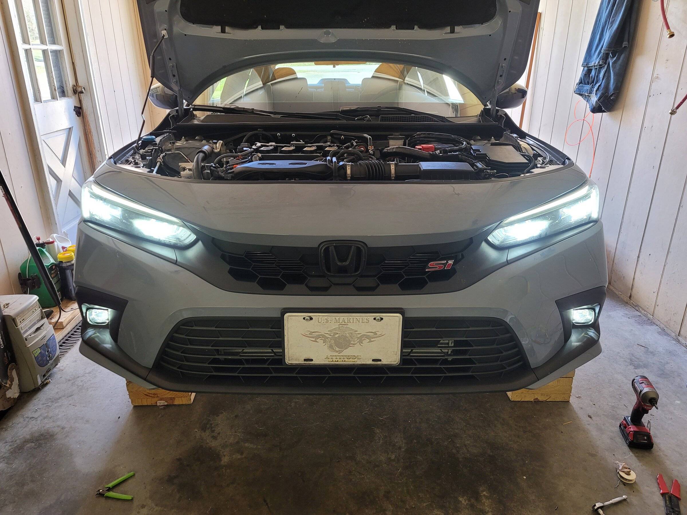

For those that managed to get the fog lights working, what fuse number did you guys tap the red ignition wire into? Myself and a buddy of mine tapped it into a 10v with a 10v fuse adapter, but the fog lights wont turn on. I bought the fog lights off of eBay, from some seller named Dong_Auto, and the branding of the lights is Winjet Auto.
