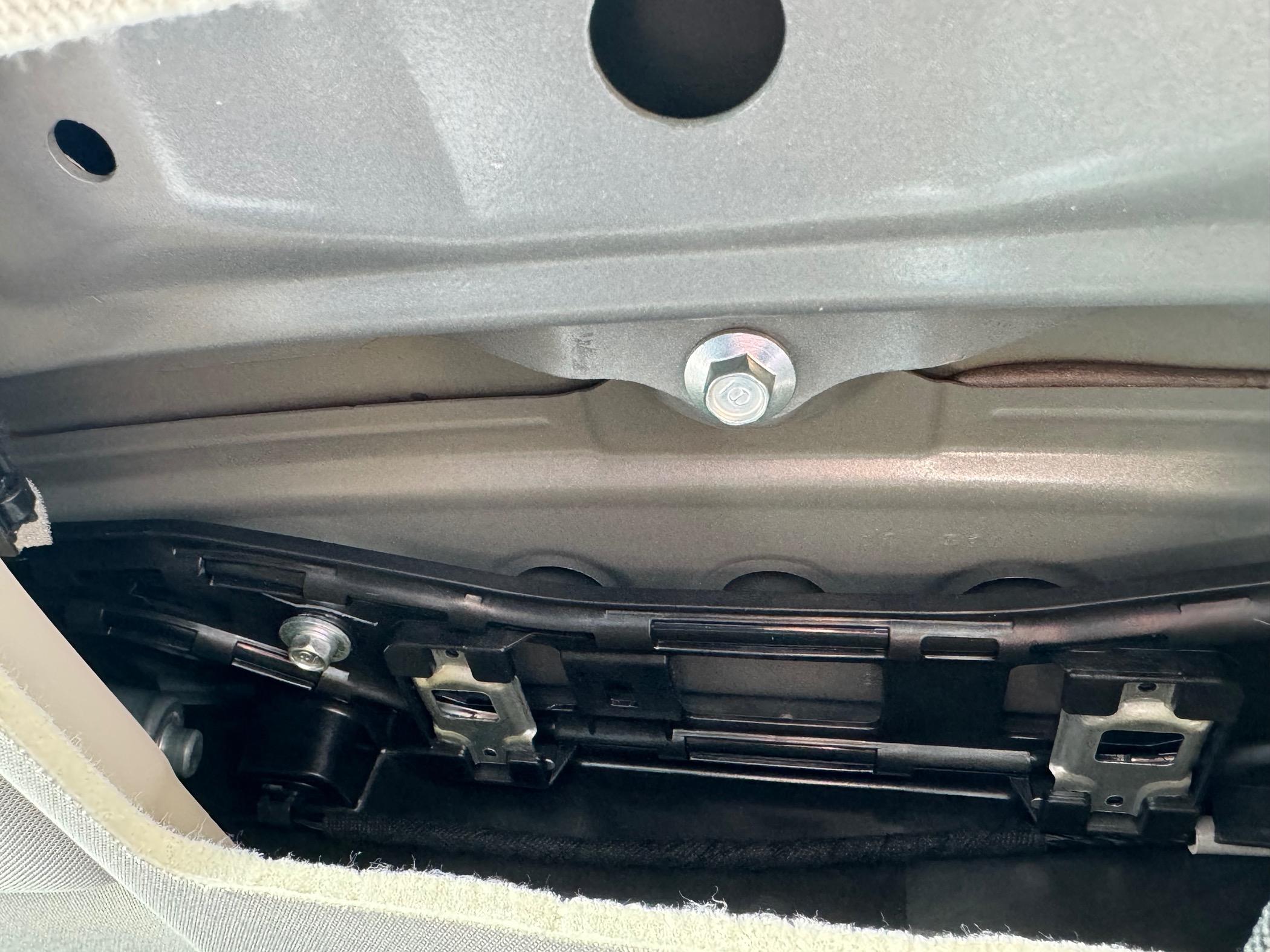

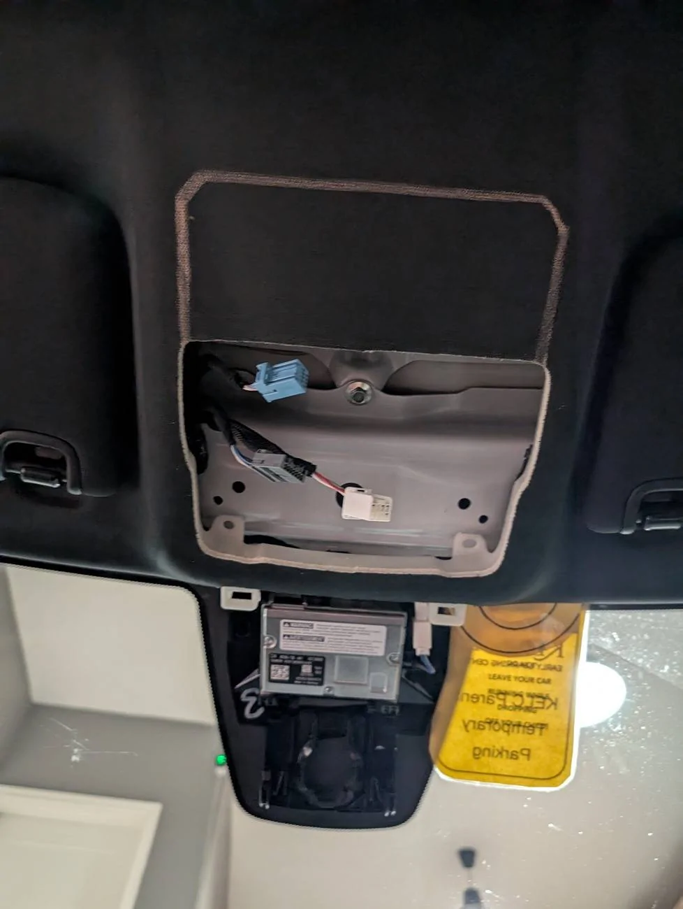

Looking to do this in my 2024 EX Civic while I'm swapping out the rear view mirror. Looks like the mounting structure is present and matches what I'm seeing in the SI pictures from the original post.
Anyone see anything different in the mounting structure on the EX based on my photos? Reading above it wasn't compatible for the sport and just wanted to get a second opinon in this before I start cutting.
Thanks!

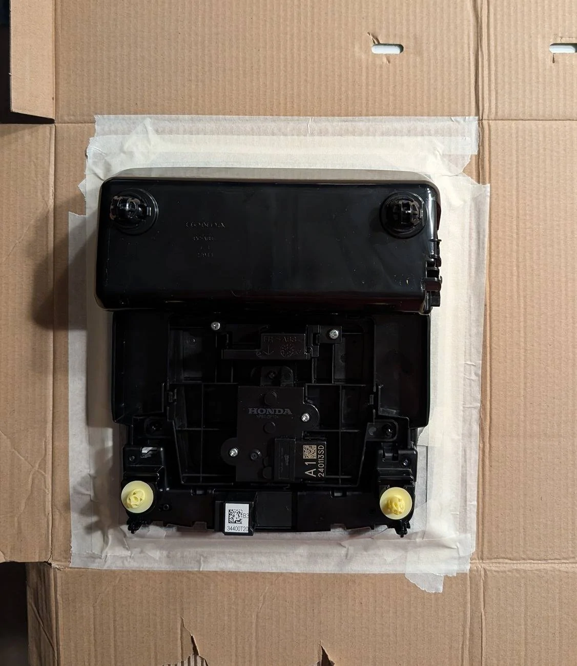

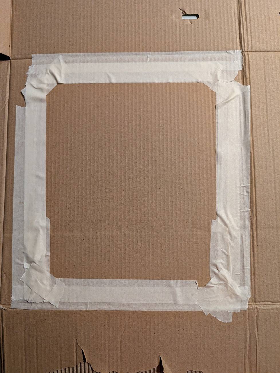

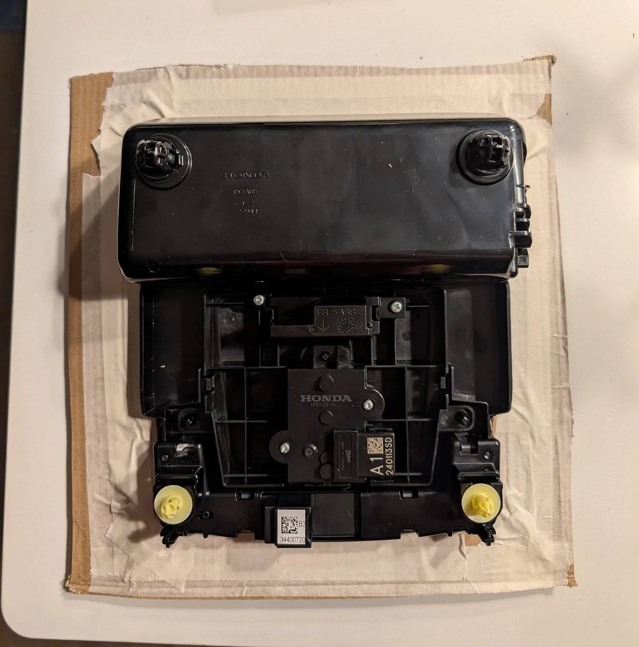

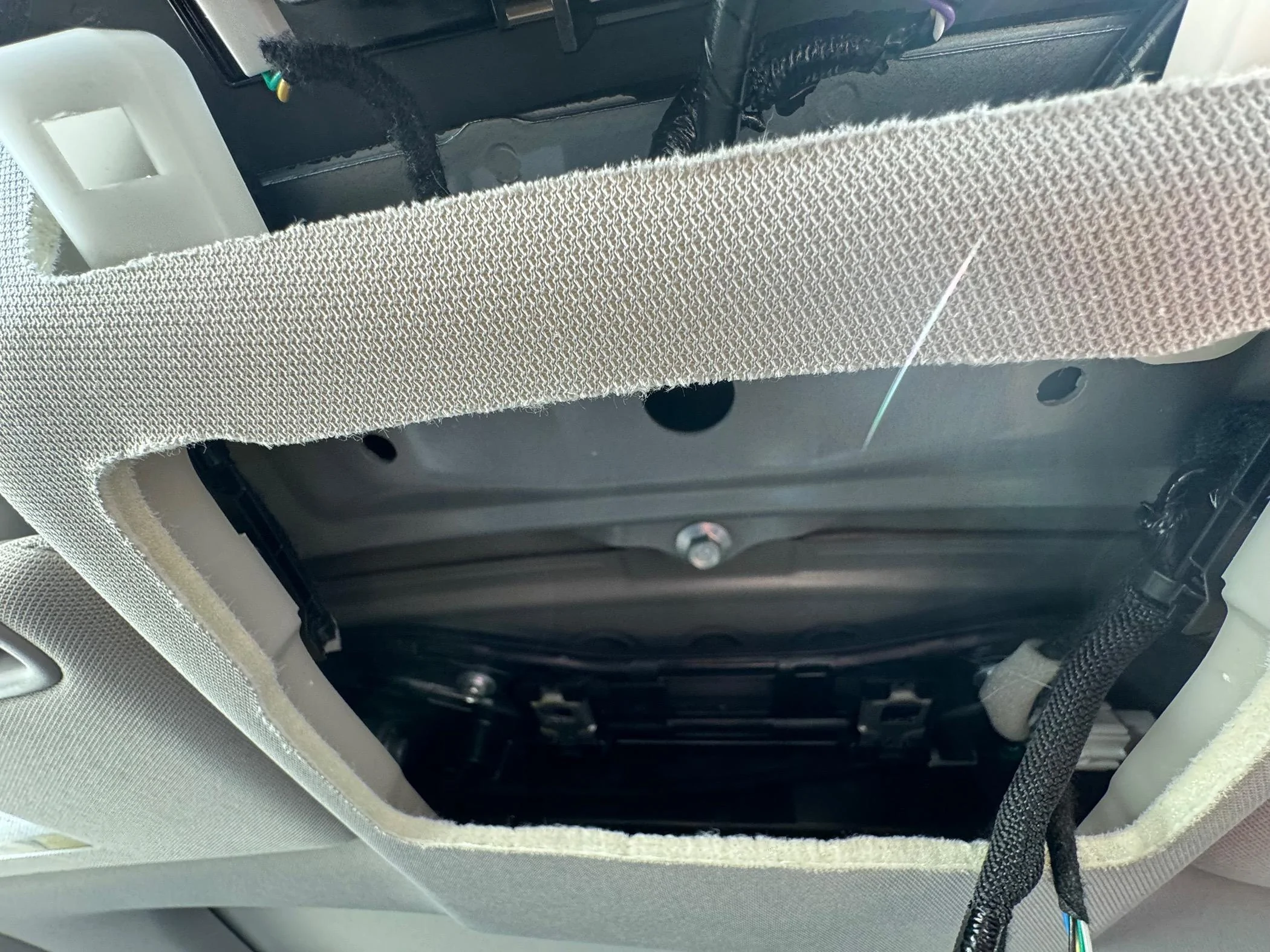

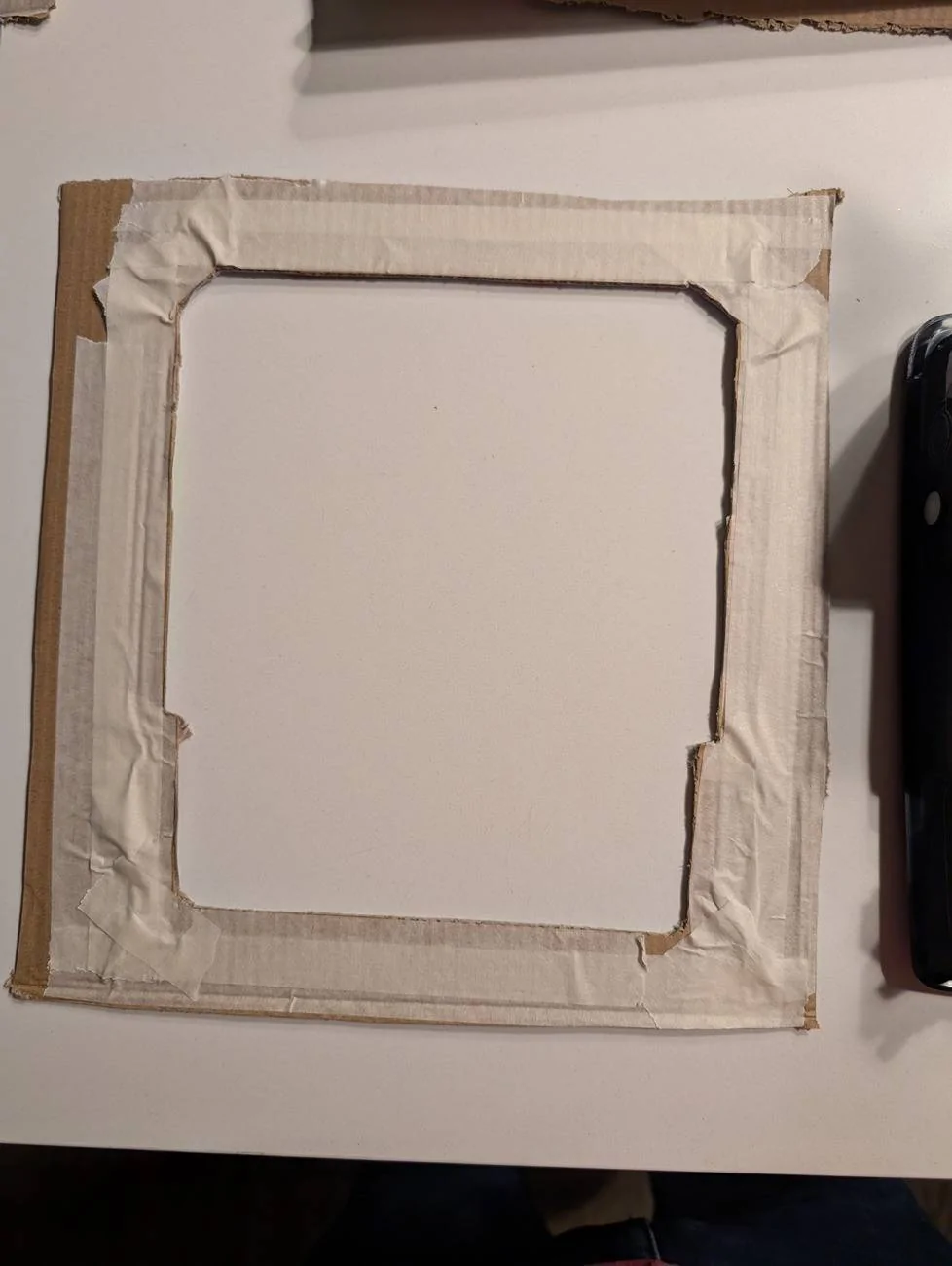

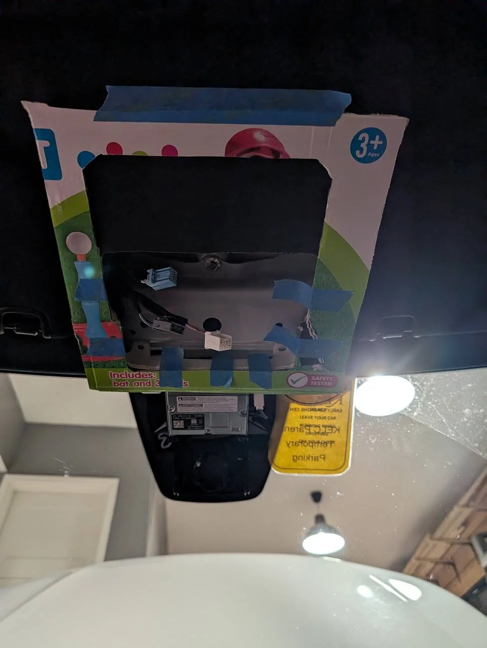

I just did this last night, along with the mirror swap. It went very easily. In case anyone needs a tip on how to make a template, below are pictures from my template creation; I put masking tape down on the flanges, taped it to a sheet of cardboard, then slipped out (pulled very hard) the new unit.
One bit of advice: if you don't cut the hole long enough, the headliner will push against the plastic and the sunglass holder will rub on the shell. You'll know it's too tight if the holes for the screws don't line up centered in the mounting area.
