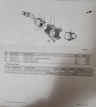

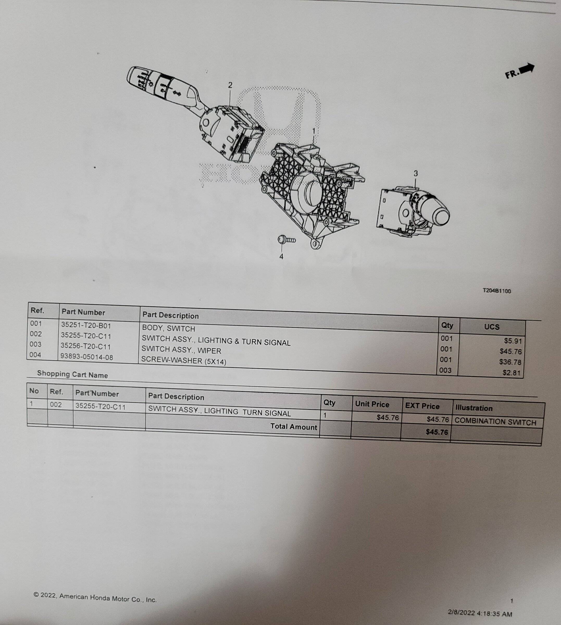

My local dealer helped me find the part numbers today.
FOGLIGHT LEFT FR. - 33950-T20-A01
FOGLIGHT RIGHT FR. - 33900-T20-A01
SWITCH ASSY. - 35255-T20-C11
Does the switch assembly come with wiring as well like the fog light kit on ebay? OR is it just the switch?

Tomorrow I'll ask my dealer about it. And will report back. If it ends up not including the wiring harness, I'll see if I can get a part number for that.
As far as I know I think it's just the headlight stalk switch

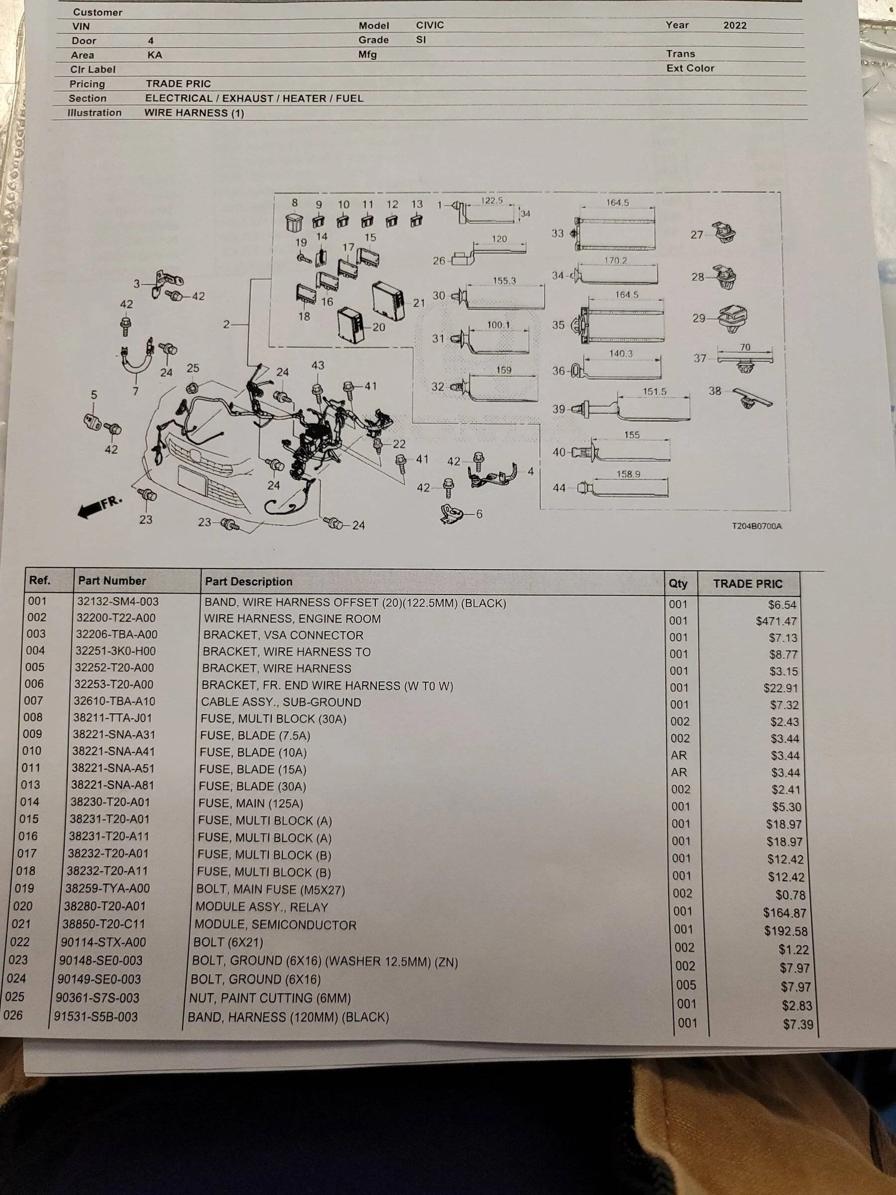

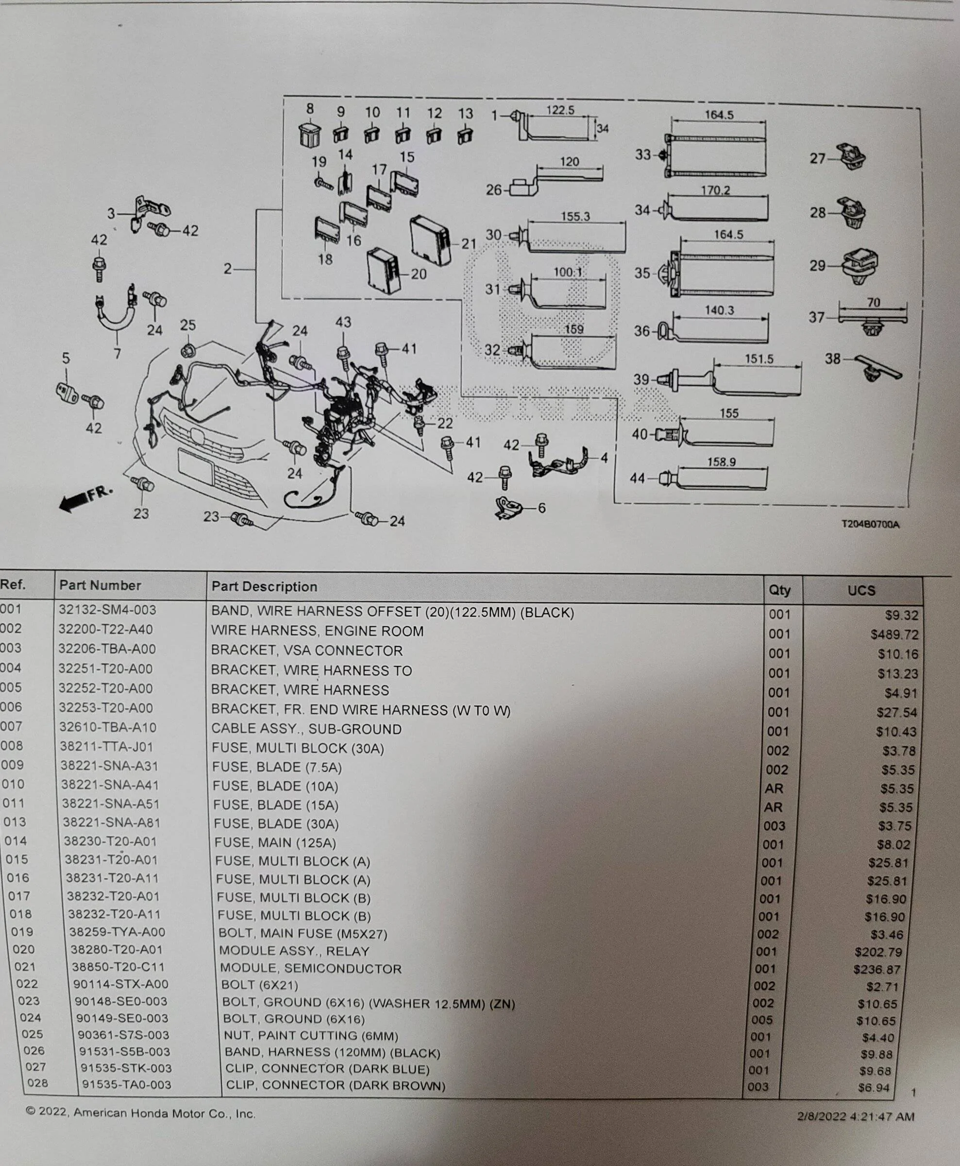

Dealer informed formed me that the wiring harness would be built into the engine's wiring. As seen in this image for a 2022 Civic Touring. I asked if they could look up parts for Canadian 2022 Si model vehicle; unfortunately said they couldn't.
32200-T22-A40 WIRING HARNESS, ENGINE ROOM, part is $489.72
Hondapartsnow sells the same wire harness for $296.36 as of 2/08/2022
However I did reach out to OpenRoad Honda Richmond in Canada about a fog light kit for a 2022 Civic Si. Hoping to get at least more info. We might be stuck with going third party for instance sellers on ebay. But if you want OEM factory install. We'd be looking at a very expensive setup.

Today I happened to go to another dealer nearby. And got the parts list for a USA 2022 Civic Si. This dealer informed that the wires are probably on the harness themselves. But I'd have to look to verify that. They said that Honda like to interchange parts inbetween different vehicals.
32200-T22-A00 WIRE HARNESS, ENGINE ROOM, part is $471.47
Hondapartsnow lists it for $330.97 as of 2/08/2022
When I get time sometime next week hopefully, I'll take a look inside to my engine bay to see if I can find the wires for the fog lights. Though I am expecting to not see any connections for the fog lights.
