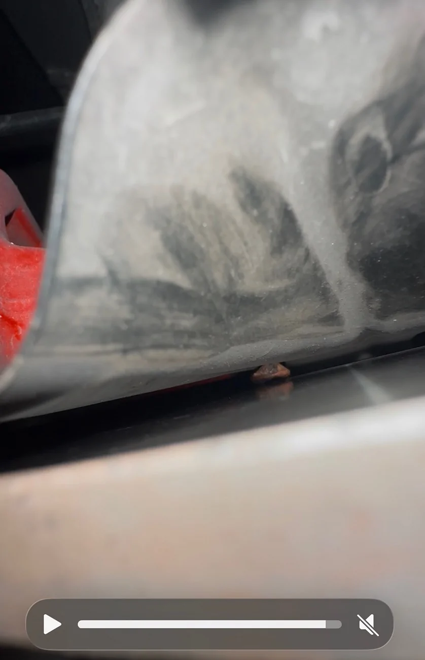

Yes this is almost certainly the issue. It happens to me constantly. Where I live the roads are full of small rocks that are the perfect size to get stuck between the rotor and the brake dust shield. Usually they fall out on their own. Putting the car in reverse usually does the trick for me. Sometimes though nothing works and I have the pull the wheel off and use a thin tool to dislodge the rock.
This one I had to remove myself last week.

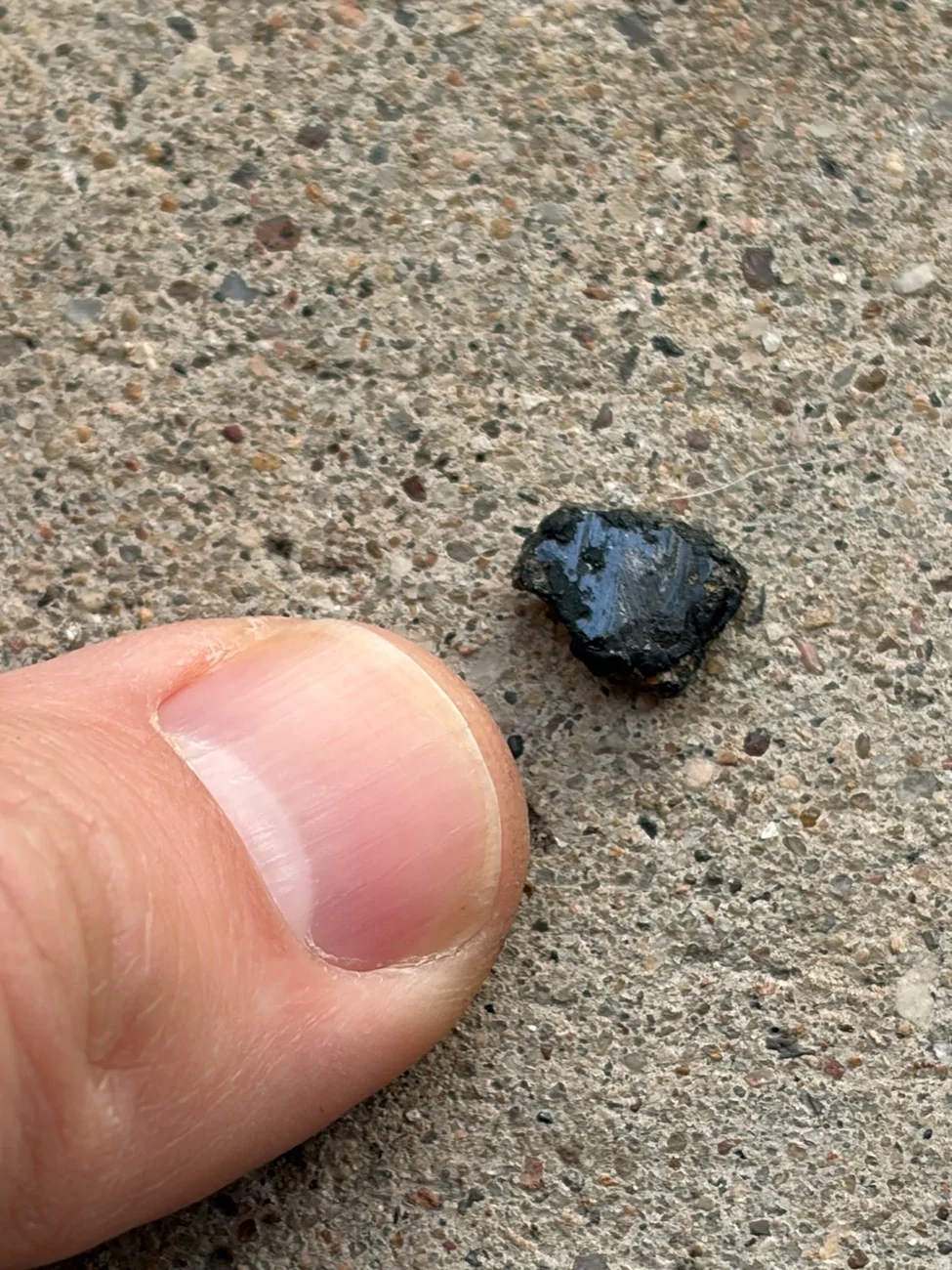

Thanks! Looks like I’ll have to take the wheel off too!
11th Gen Honda Civic Loud squealing metal on metal noise when moving! IMG_4596

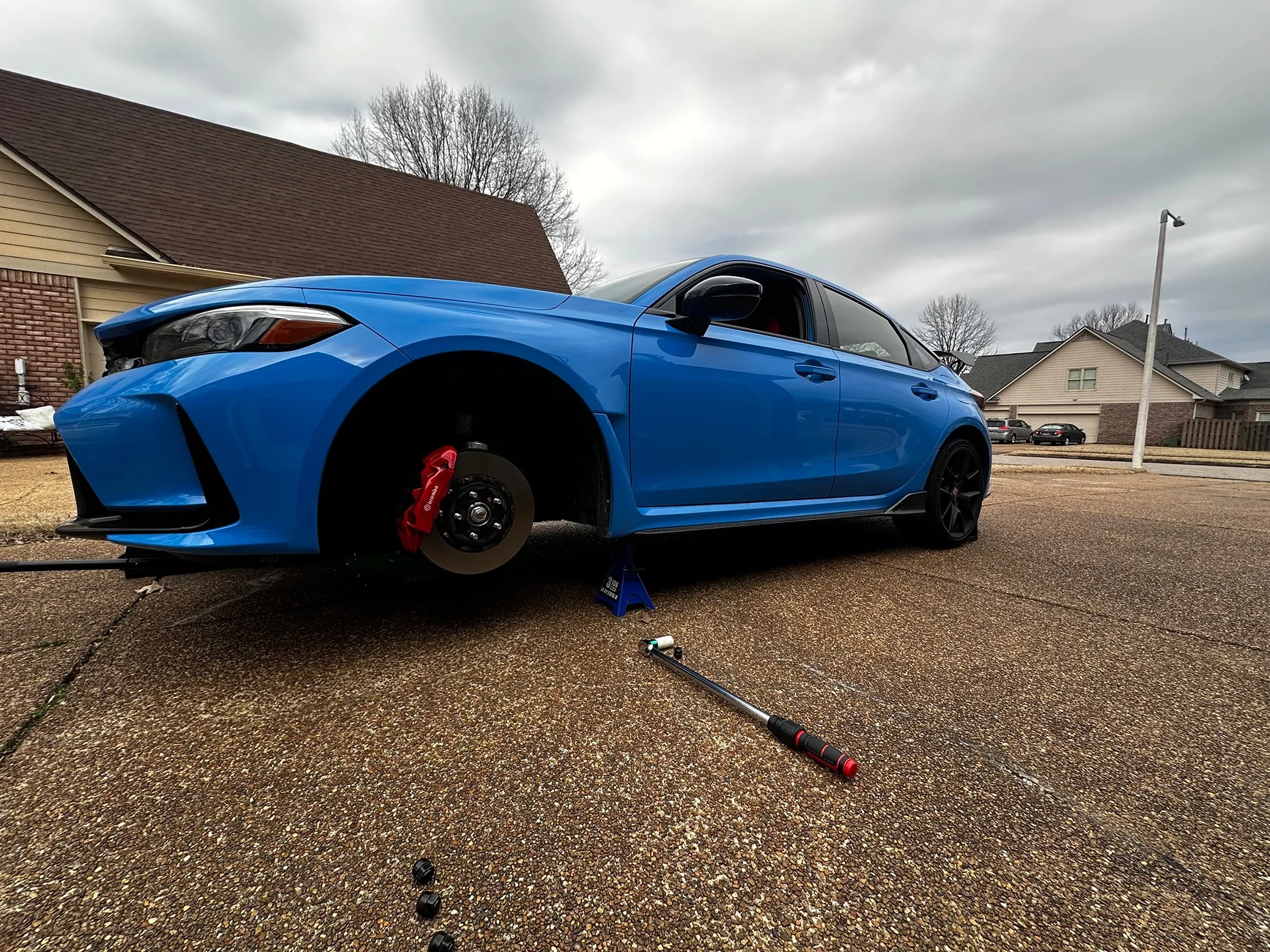

11th Gen Honda Civic Loud squealing metal on metal noise when moving! IMG_4716
Had to take the wheel off. Drive it on ramps, jack it up from front and then put the stand under it. Don’t trust sticking my head in there with just the jack!
