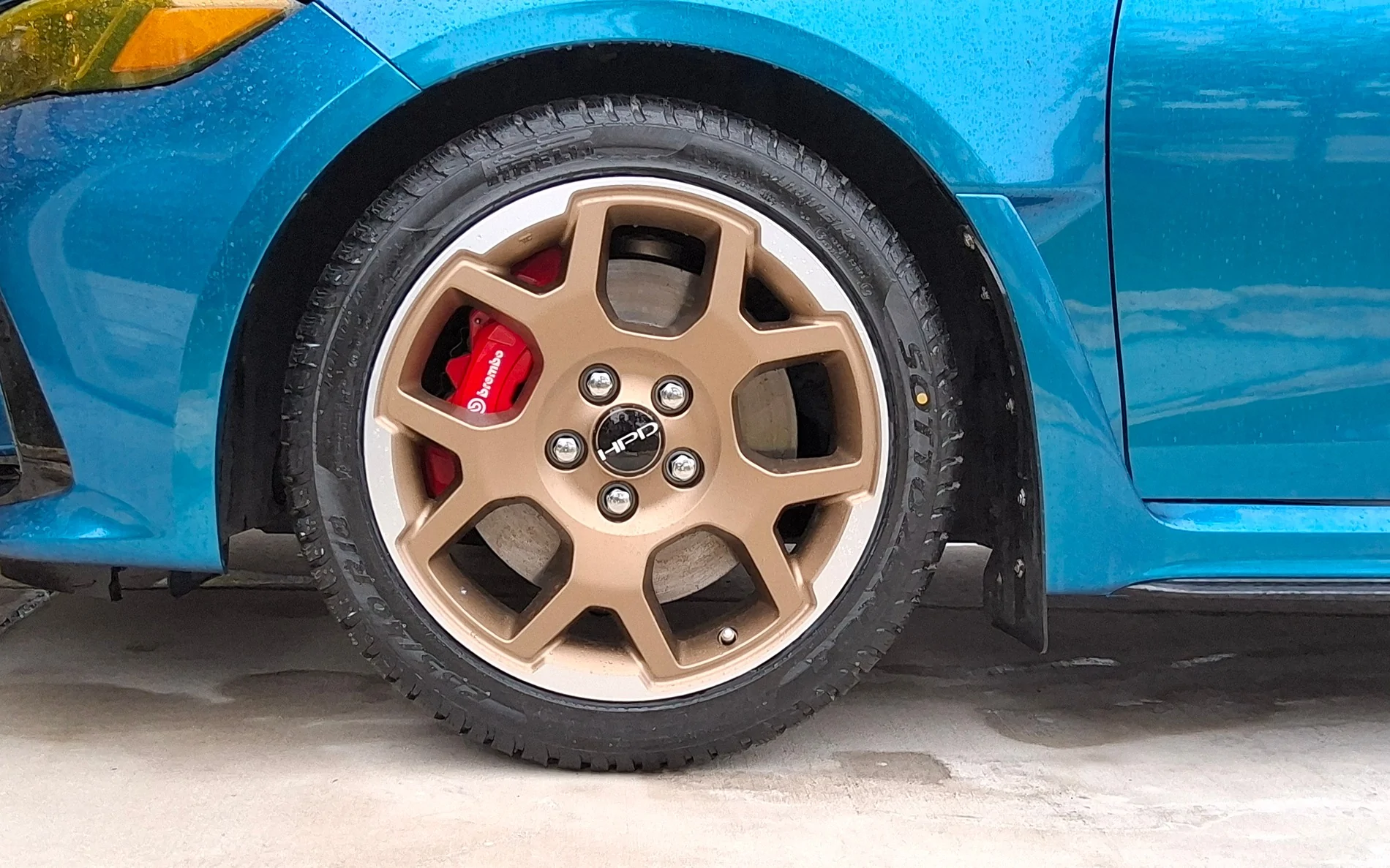

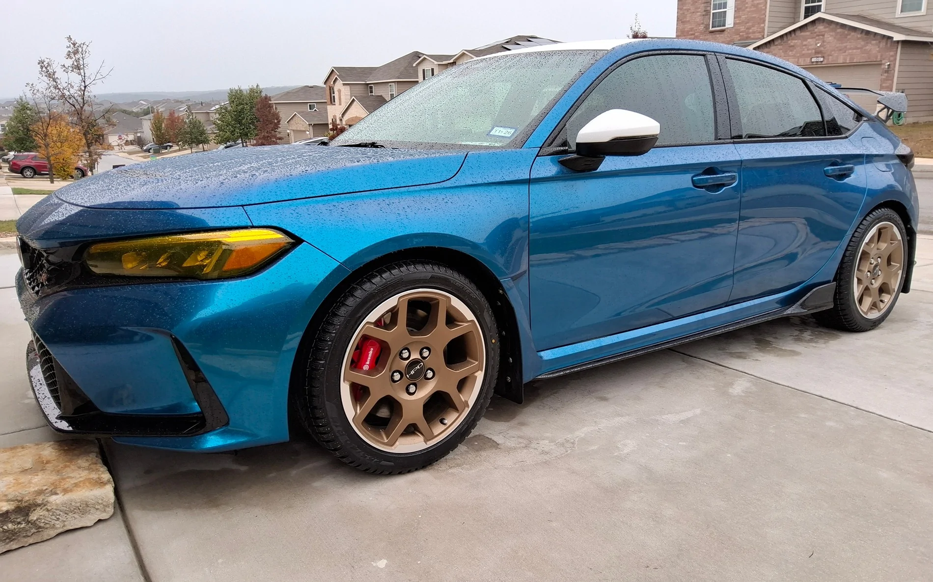

Well, I finally did it. I got some Honda Plilot Matte Bronze HPD wheels, wrapped them in Pirelli Winter Sottozero 3 tires, and had to use 20mm spacers in order to get the wheels around the front Brembo brake calipers.
Wheels: Enkei Honda Pilot Matte Bronze HPD. 18X8.0 , ET +50 .
Tires : Pirelli Winter Sottozero 3. 255/40 R18 .
Spacers: Eibach . 5X120, 20mm .
Thanks again Sean for the inspiration to complete this project.

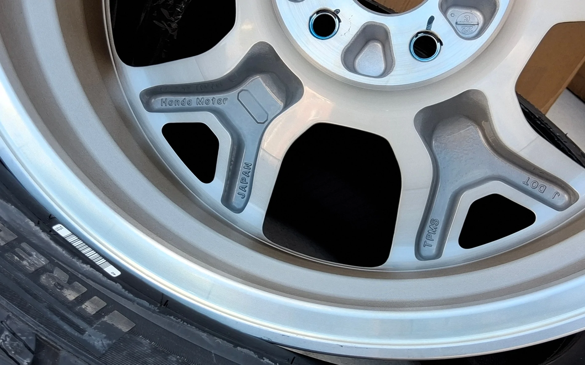

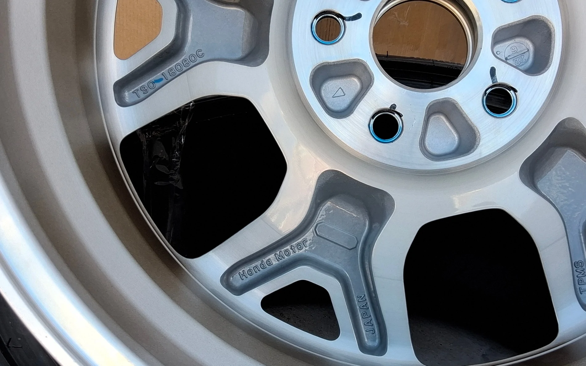

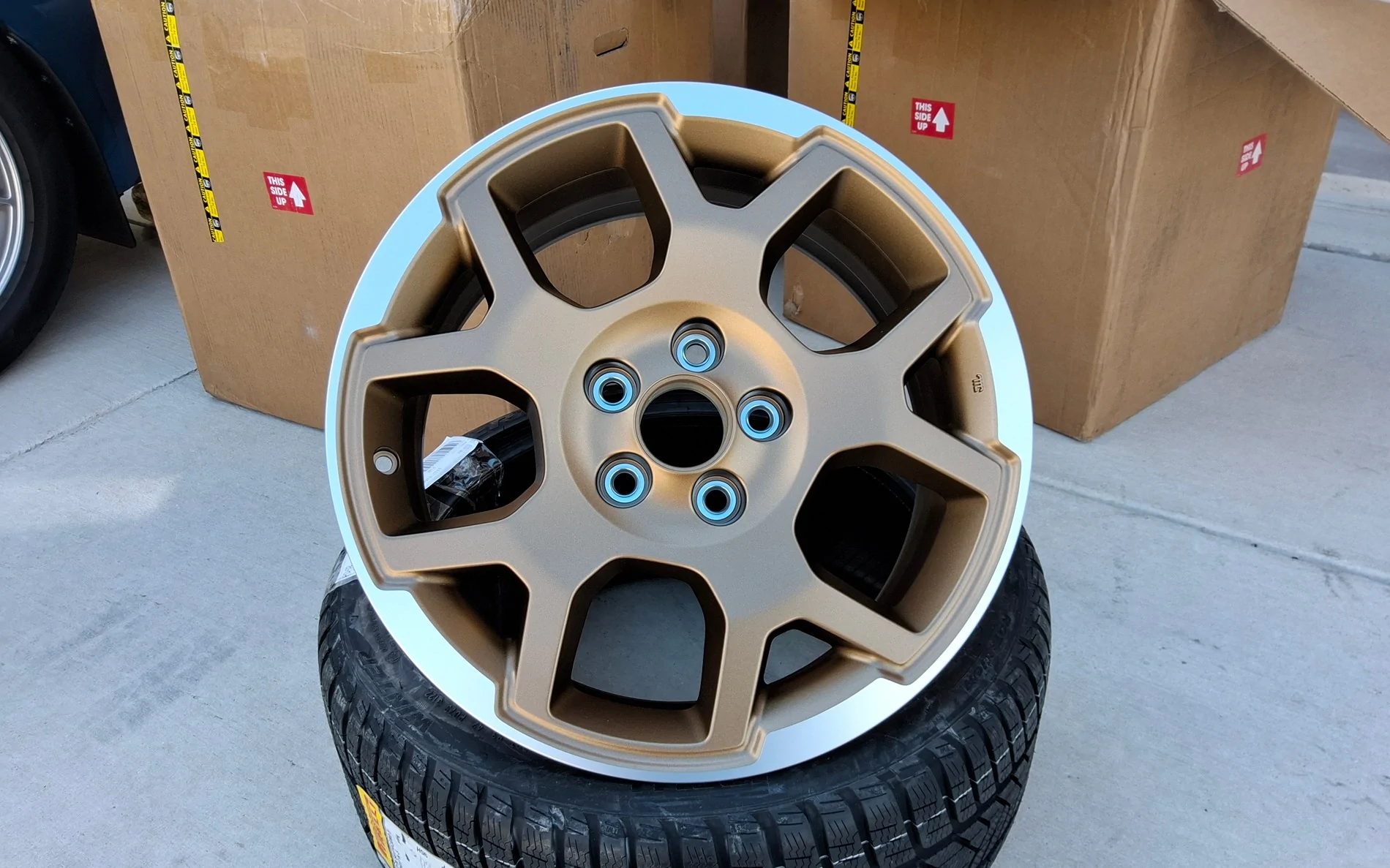

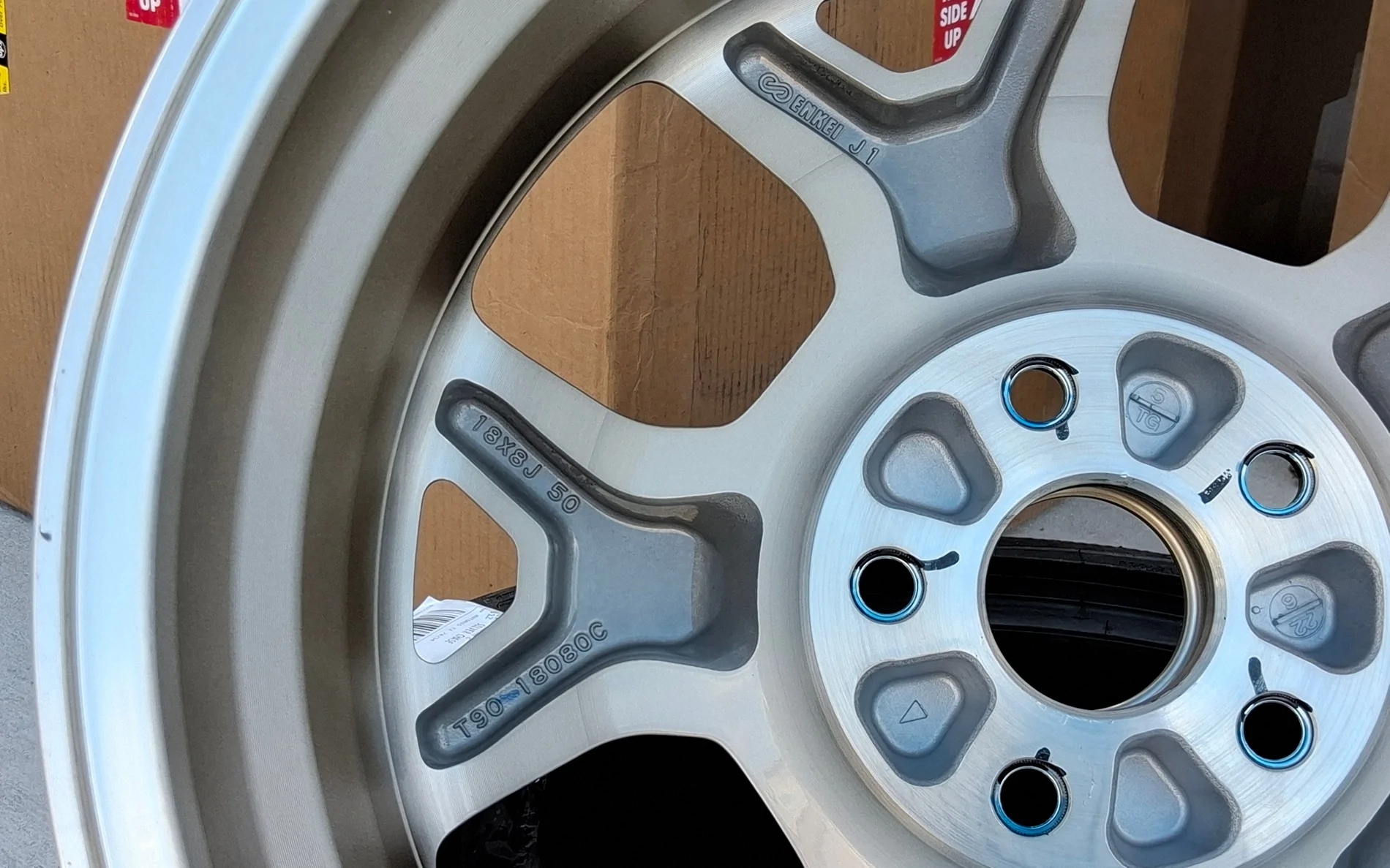

The wheels are actually made by Enkei.
11th Gen Honda Civic Maximum overall tire + wheel diameter on stock suspension 20251114_114447
11th Gen Honda Civic Maximum overall tire + wheel diameter on stock suspension 20251114_114545
11th Gen Honda Civic Maximum overall tire + wheel diameter on stock suspension 20251114_114600
11th Gen Honda Civic Maximum overall tire + wheel diameter on stock suspension 20251114_114549
Not mounted yet? cant wait to see how they look with tires! I borrowed a set of bronze enkei wheels during a time trial event, and it kinda made me want to get some bronze wheels but i ended up getting my track and autocross wheels powdercoated bright red. dont have them back yet, but patiently waiting!

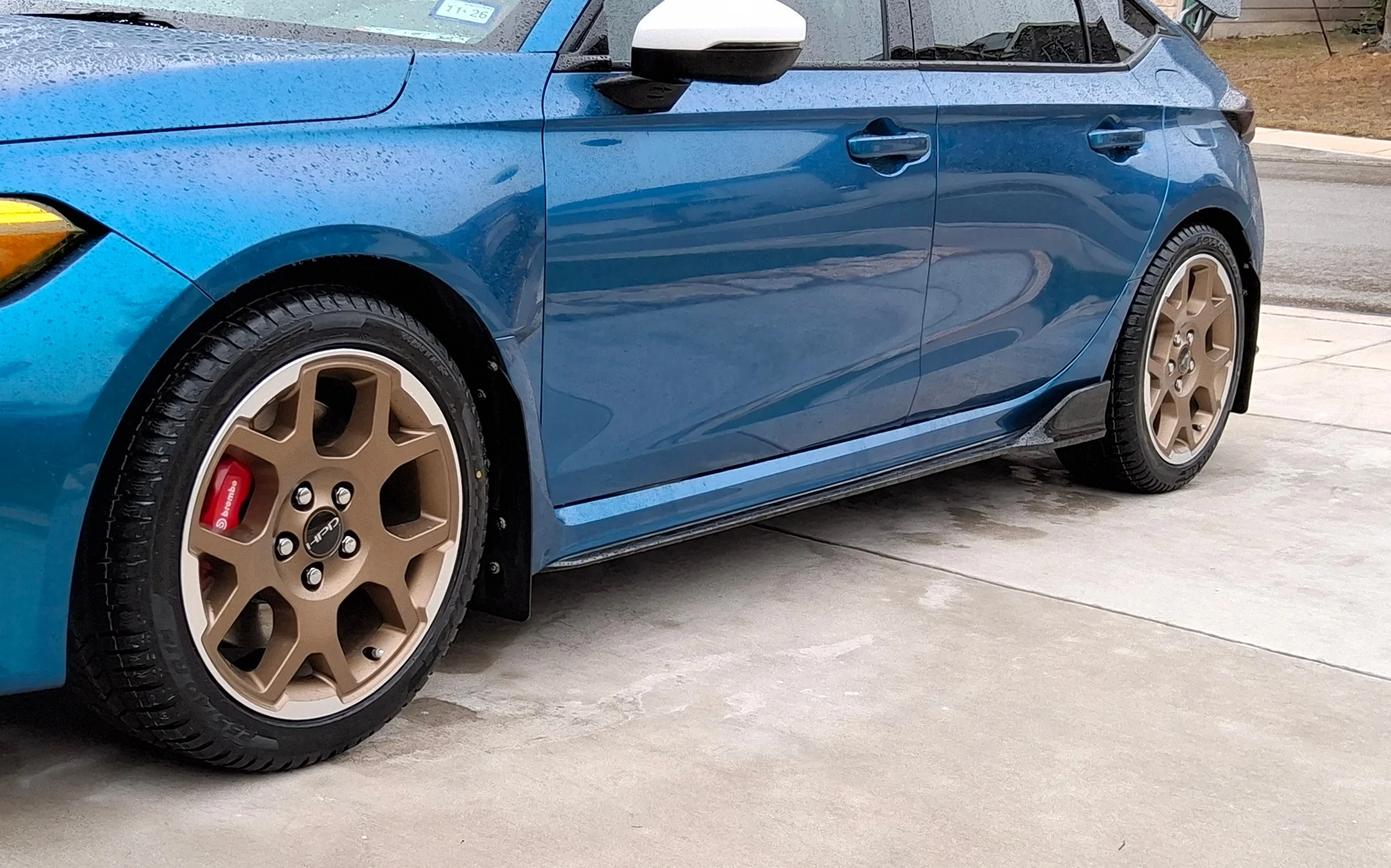

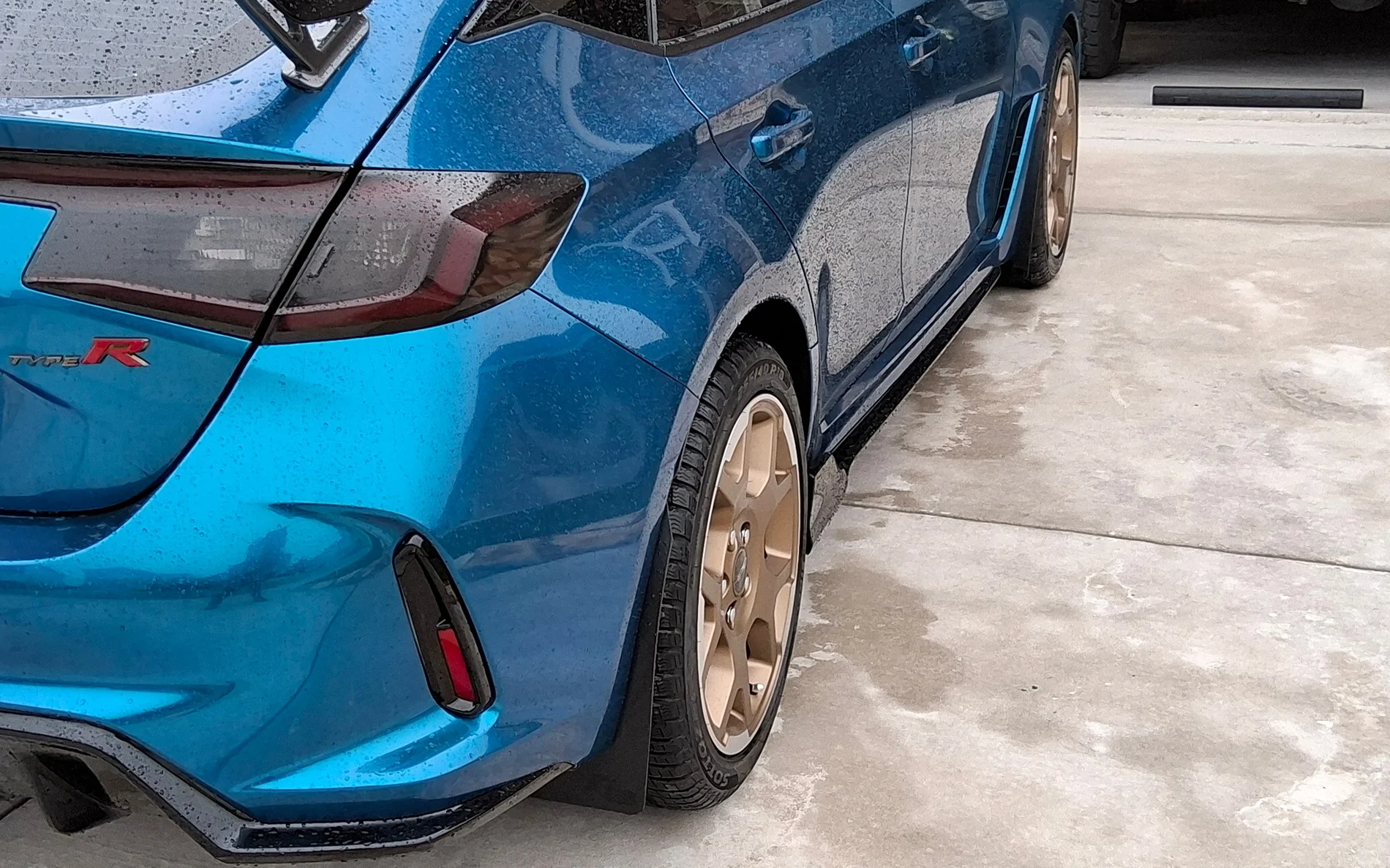

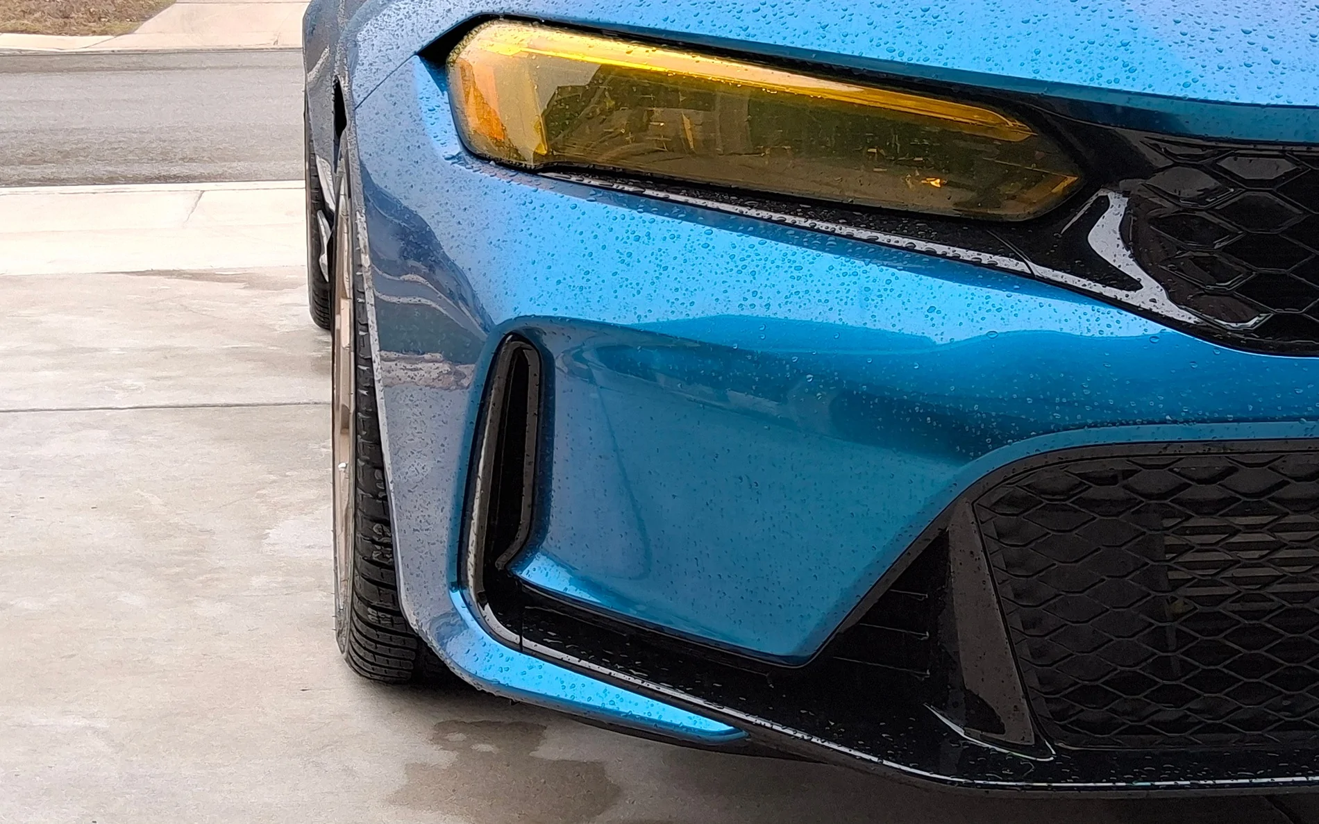

Enkei Honda Pilot Matte Bronze HPD wheels on the FL5.
11th Gen Honda Civic Maximum overall tire + wheel diameter on stock suspension 20251216_160955
11th Gen Honda Civic Maximum overall tire + wheel diameter on stock suspension 20251216_160852
11th Gen Honda Civic Maximum overall tire + wheel diameter on stock suspension 20251216_160915
11th Gen Honda Civic Maximum overall tire + wheel diameter on stock suspension 20251216_161727
11th Gen Honda Civic Maximum overall tire + wheel diameter on stock suspension 20251216_161722
11th Gen Honda Civic Maximum overall tire + wheel diameter on stock suspension 20251216_161618

"Texas Winter" setup, haha!
Yeah, right.
Naw, I just really like these wheels and wanted to see them on my car. I already have a set of wheels with All Season and another set with Summer tires, so, why not put Winter tires on the Pilot HPD wheels?
This way I can actually drive in the Winter outside of Texas when I get the itch.
