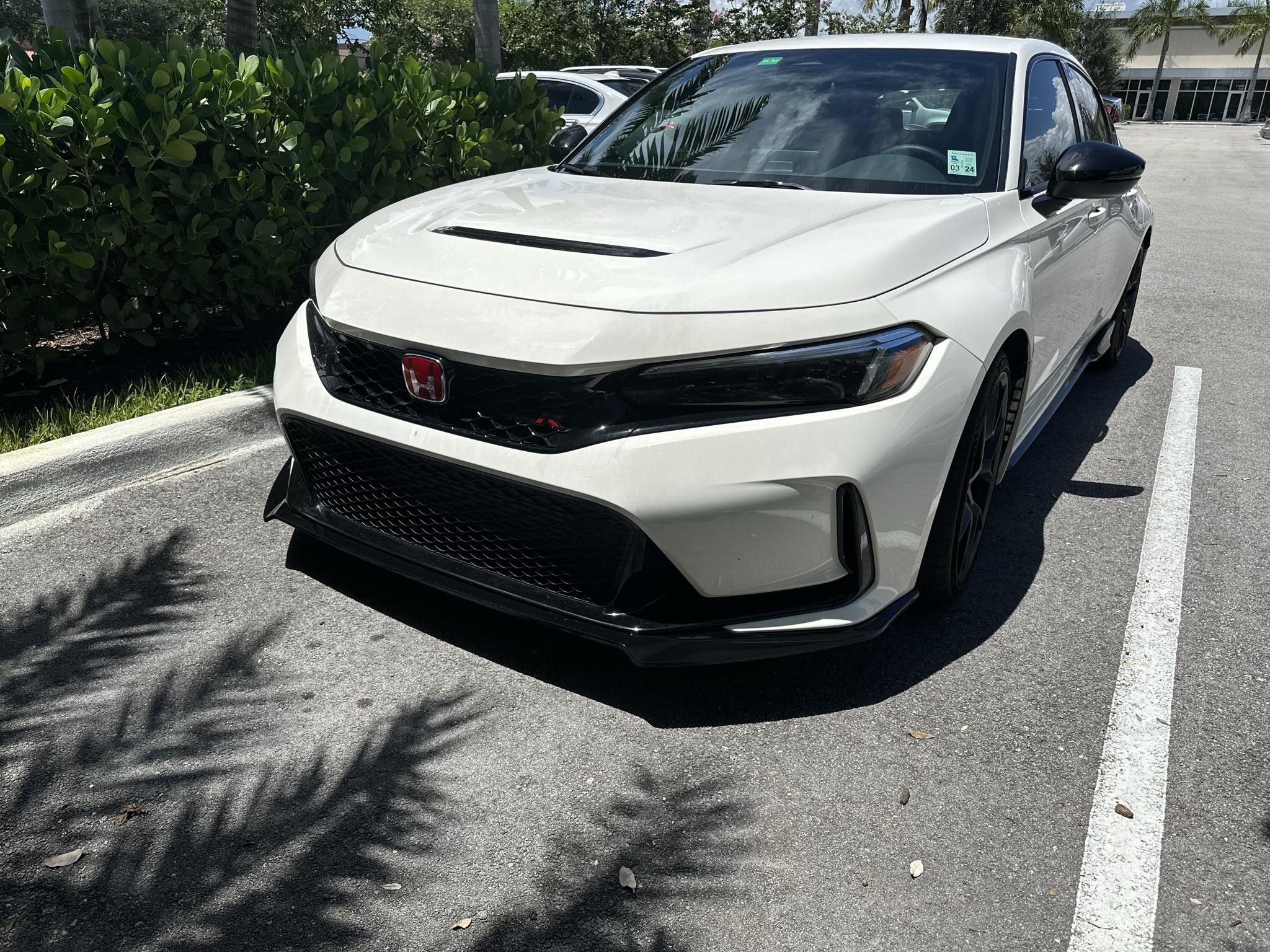

Ok, got mine on today - I need to get decent pics, the quick snaps I took are not worth posting. We all agree it looks good and like it should have just been OEM. If it was a one piece design I'd rate it even better but for about $250 or so it looks good, was pretty easy to install, and doesn't go so low that I need to entirely recalibrate what I can pull in/out of.
How did you guys attach the center section to the bumper? The way the bumper is designed in the center there was nowhere for the bolts to live let alone get to them and they are way too short to even consider just drilling through everything you encounter. The inner body color shell was the issue. Maybe pulling the whole bumper off isn't the worst idea.
We used high end 3M "spoiler" tape on that area and it *should* be fine but... how on earth did they expect it to get bolted in the middle? A better design with some long tabs would fix the issue.
How did you guys attach the center section to the bumper? The way the bumper is designed in the center there was nowhere for the bolts to live let alone get to them and they are way to oshort to even consider just drilling through everything you encounter. The inner body color shell was the issue. Maybe pulling the whole bumper off isn't the worst idea.

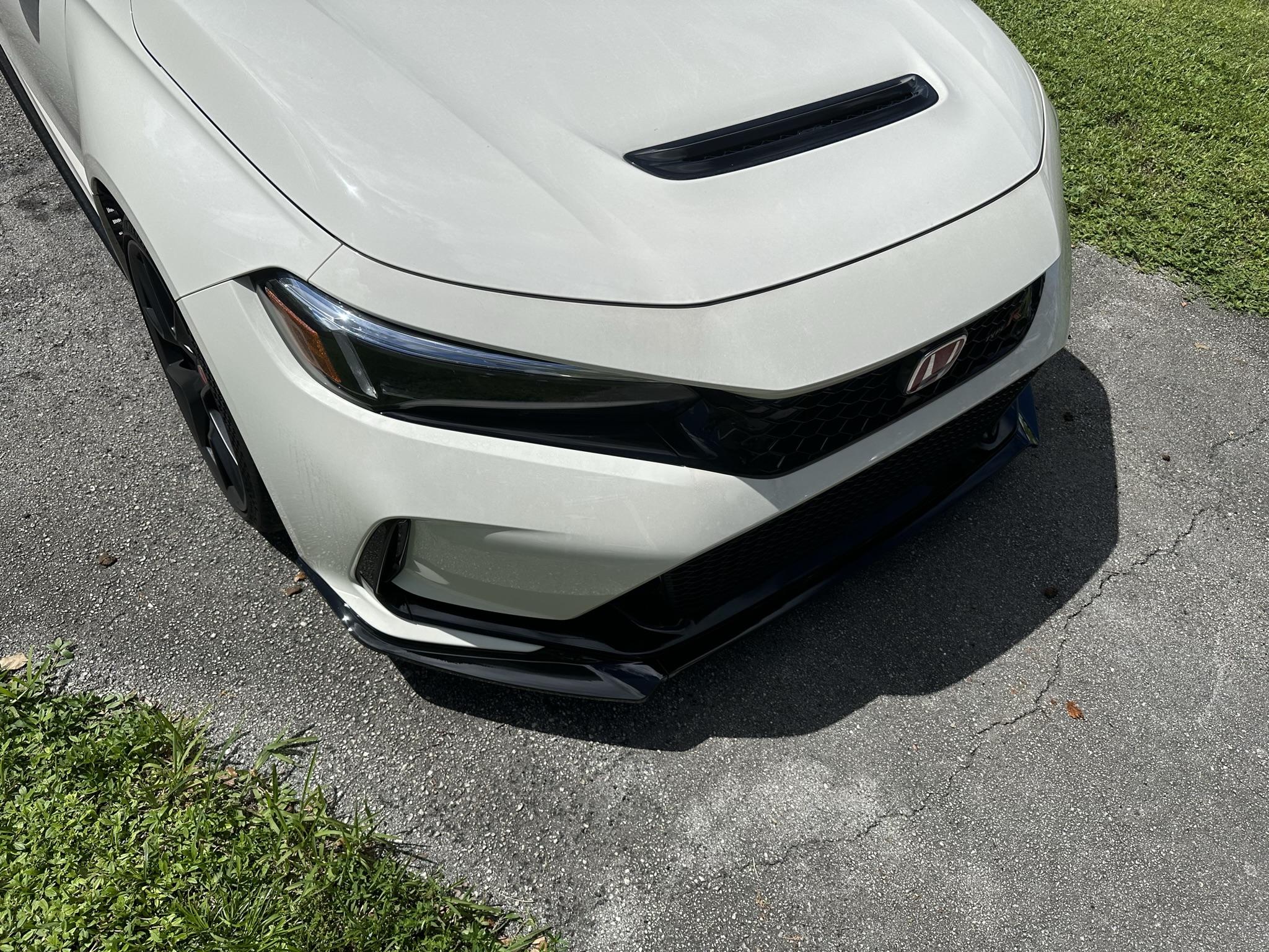

So sounds like you didn’t have to take bumper off then to install? How did you reach the backside to get the nuts on?
Lip looks good btw.
If you scroll back in the thread to post #13 there is a pic of the black, plastic, panel you remove to get access. I think maybe if you do the full bumper removal then you could figure out a way to use bolts across the entire lip - but it sure seems like there just isn't enough room, there is also a bend there that means it's extremely tight space even if the inner bumper wasn't in the way. This could be alleviated by extending the lip farther back/using tabs - in fact doing that across the board would make the lip a bit easier to install, not that it was hard. My only complaint really is that they didn't do it like that.

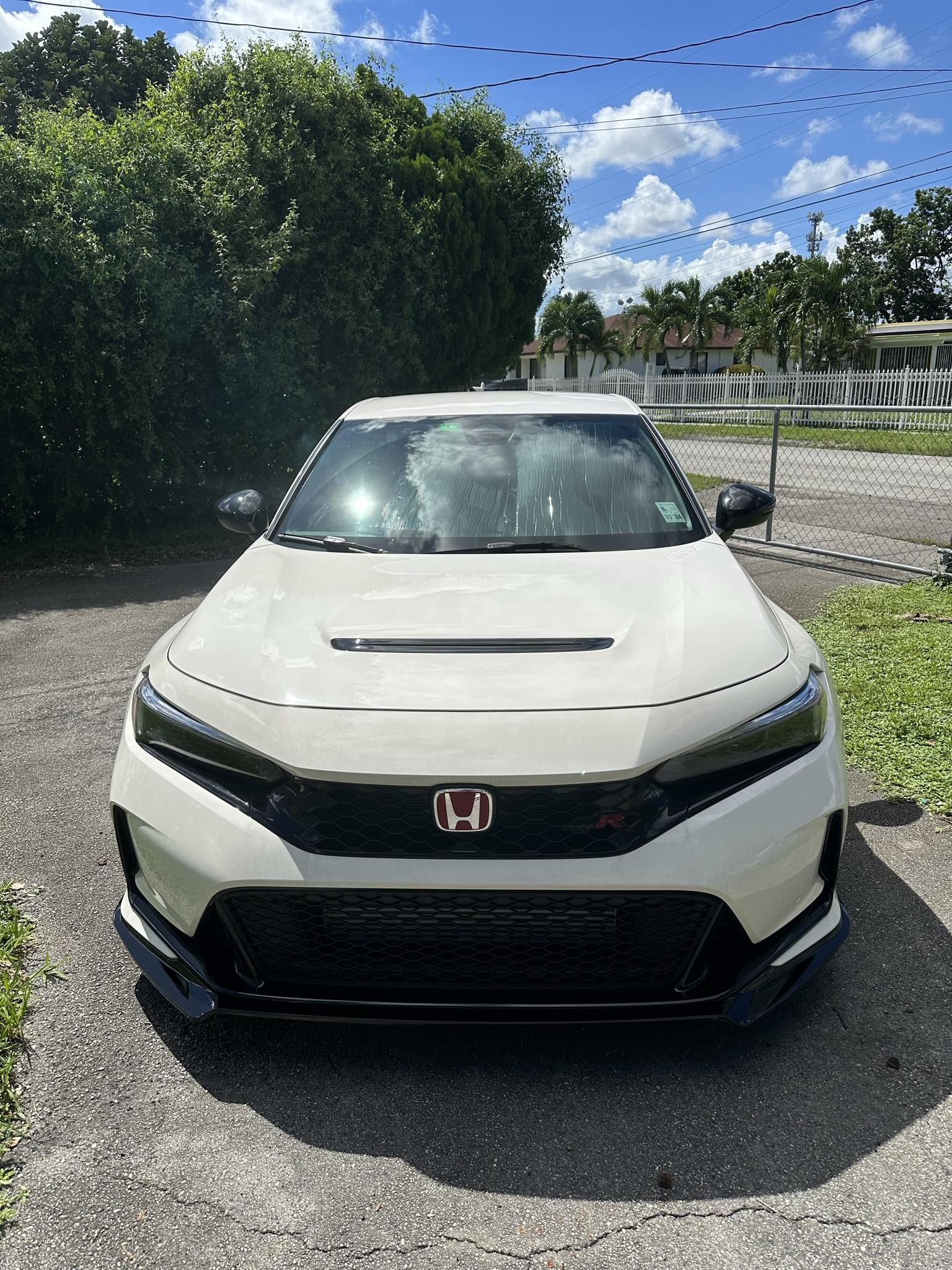

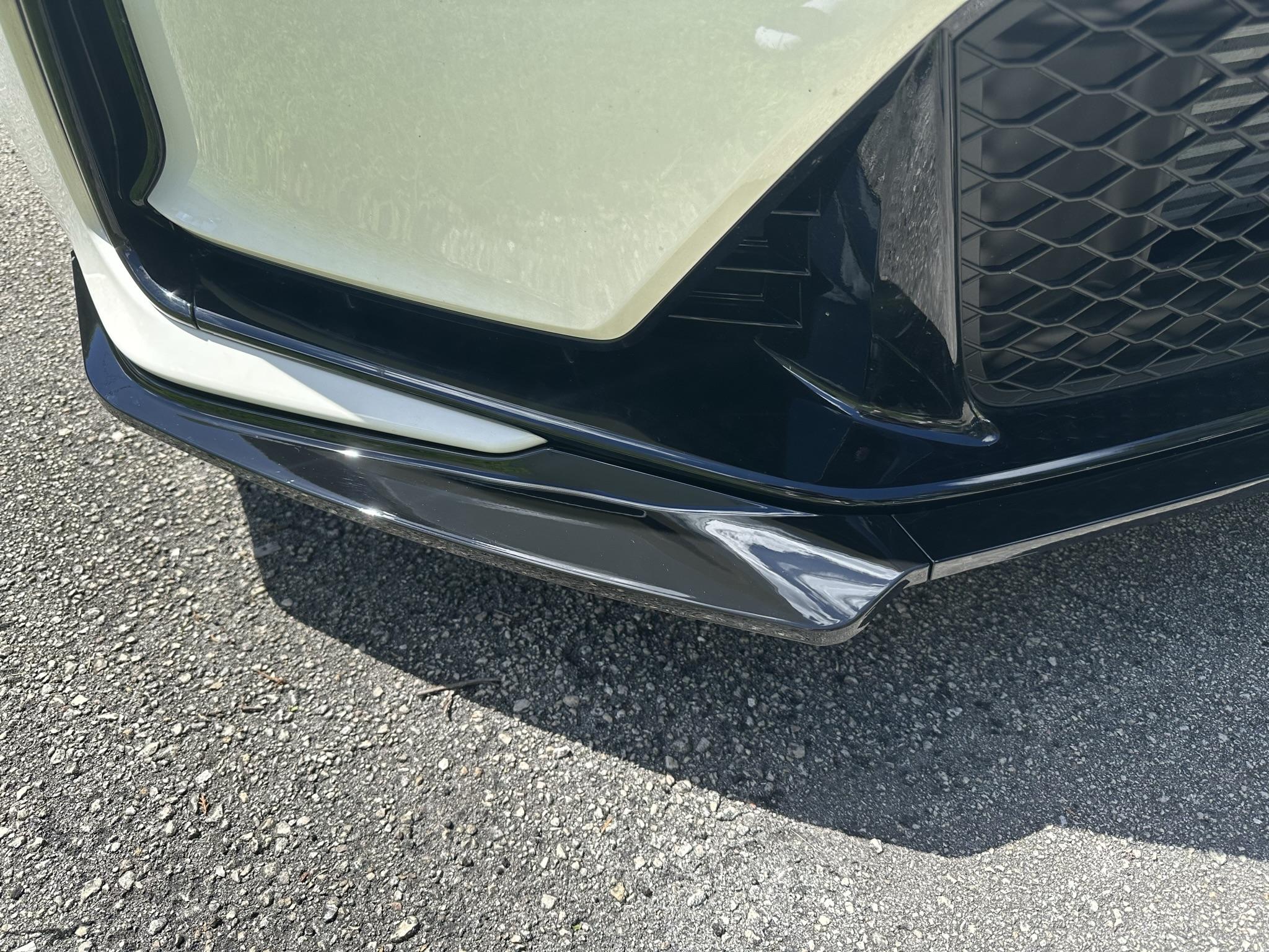

Fitment is great, lines up perfectly and no visible gaps. With a light under the car you can see a tiny bit of light shine at the area where the lip cuts in and fills the gap in the bumper on either corner. I just looked again outside in daylight and you cannot see this at all as seen in the below pic:
