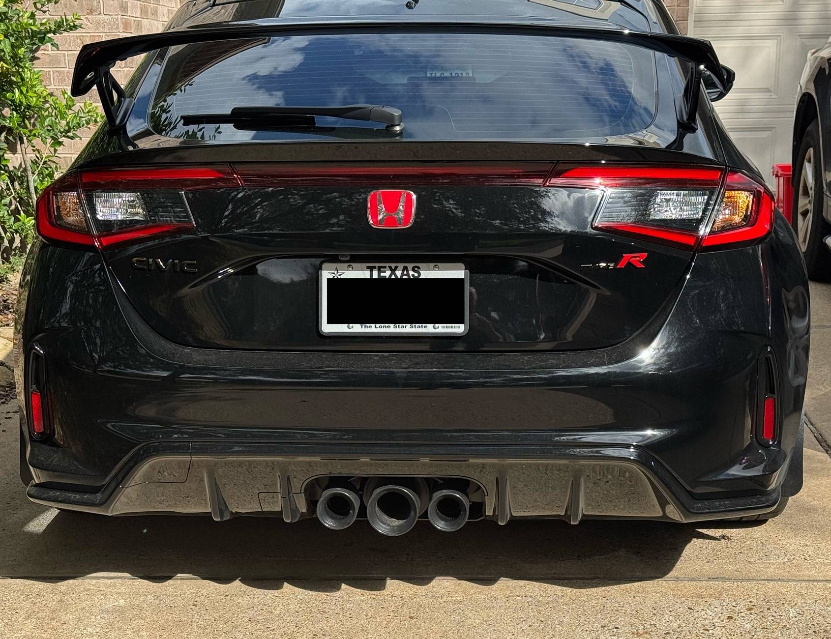

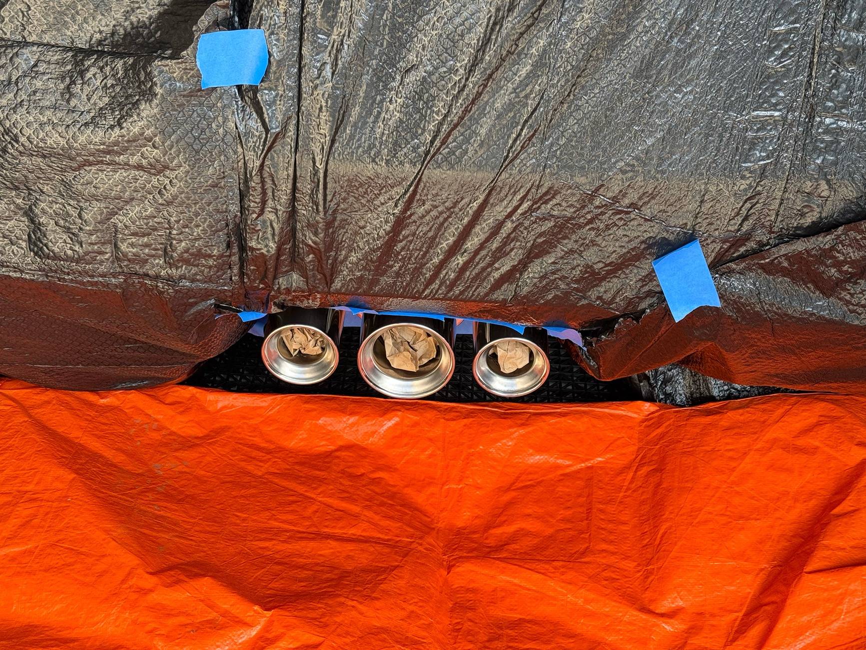

One of my least favorite design elements on the FL5 is the exhaust tips (at least/especially on a black FL5). The combination of chrome and the unequally-sized tips is off-putting. Unfortunately, the only way to address this is a full aftermarket exhaust replacement or axle-back replacement. Most of these are expensive, beyond my skillset/workspace (no car lift in the foreseeable future), and increase the dB—none of which I want to commit to at this time. After watching a few YT videos on painting exhaust tips I decided to paint them black myself while keeping everything bolted on the car. Below is my approach based on those videos, instructions on the cans, and some guesswork. I am hypothesizing that header paint with high heat tolerance (1300-2000 F) would be best to be in contact with the pipes while the glossy engine paint (<550 F) can sit on the header paint. Overall, I am happy with the results so far, but I did overspray the left tip on the last day. I will definitely follow up in a few months or if it cracks off.
Materials:
1. VHT Header Paint (flat black)
2. VHT Engine Paint (gloss black)
3. VHT Engine Enamel (gloss clear)
Prep:
  1. Clean tips
  2. Sand/scuff tips
  3. Clean with alcohol
  4. Tape in and around tips

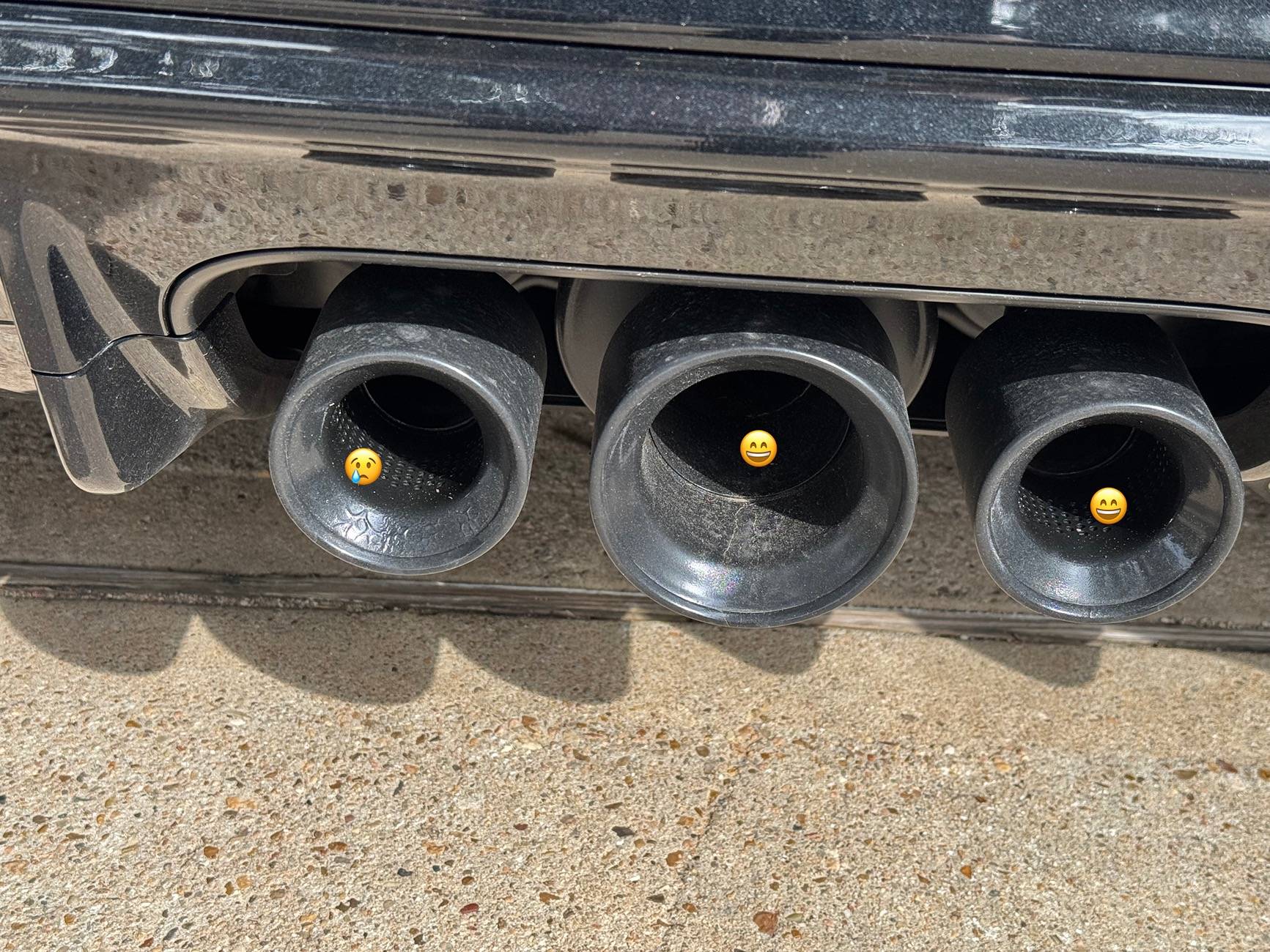

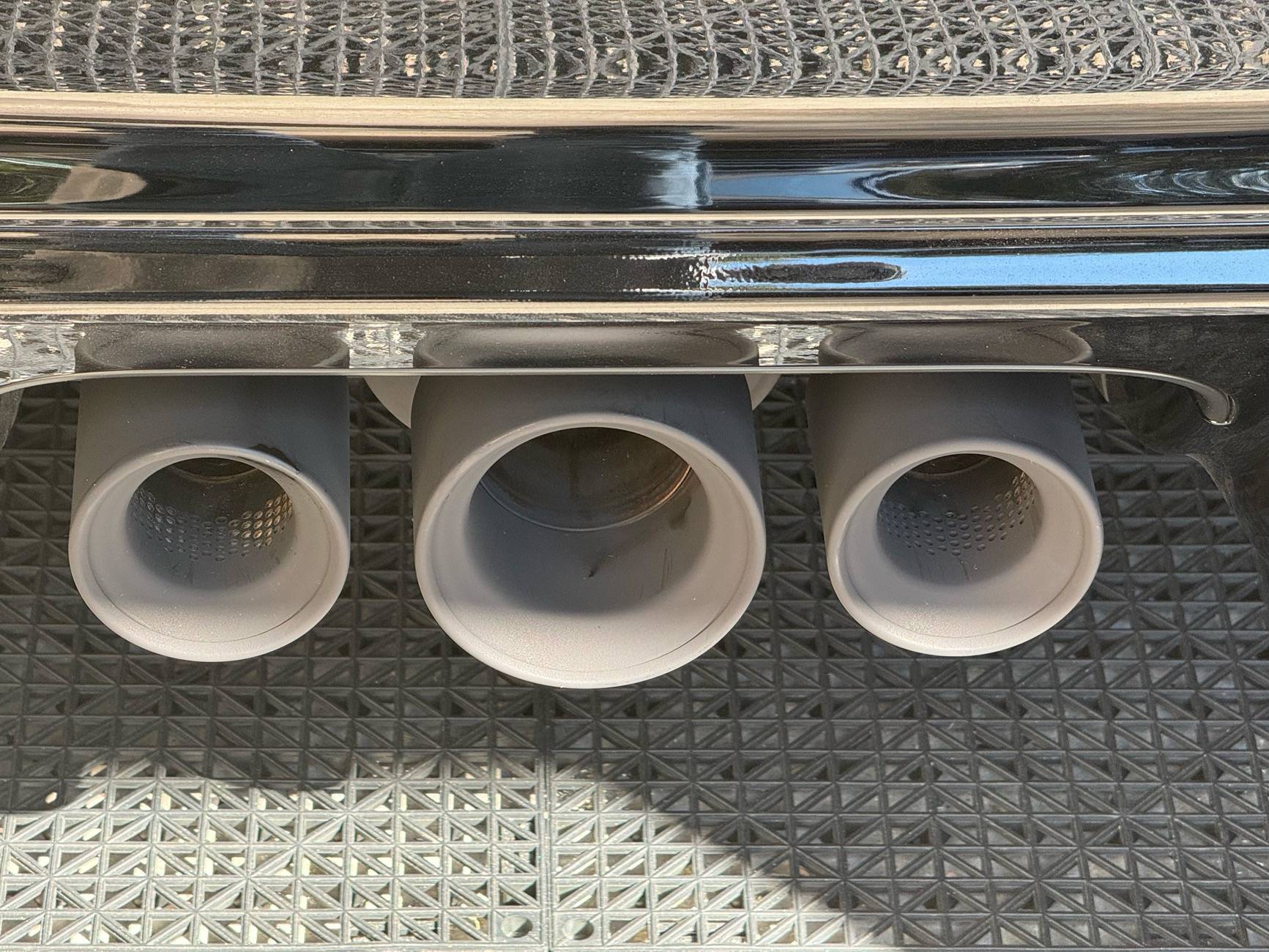

Phase 1 (Header Paint):
  1. Light coat
  2. Wait 10 min
  3. Light coat
  4. Wait 10 min
  5. Wet coat
  6. Wait 1 h and remove tape and fillers
  7. Wait 2 h more before curing
  8. Idle car 10 min
  9. Cool 20 min
  10. Idle 20 min
  11. Cool 20 min
  12. Idle 30 min (required restart after 25 min)
  13. next day, clean tips gently
  14. Wait 6 more days for paint to cure
Phase 1 Results
11th Gen Honda Civic OEM exhaust with black tips? 1735069601581-wu
Phase 2 (Engine Paint Gloss Black)
  1. Tape in and around tips
  2. Light coat
  3. Wait 10 min
  4. Light coat
  5. Wait 10 min
  6. Wet coat
  7. Wait 3 h
  8. Idle car 20 min
  9. Cool 20 min
  10. Go for light drive to continue baking
  11. Wait 24 h
  12. clean tips gently
  13. Wait ~6 more days
Phase 3 (Gloss)
  2. Add one coat of Engine Paint Gloss Black
  3. Wait 30 min
  4. Light coat of Clear Gloss
  5. Wait 10 min
  6. Light coat of Clear Gloss
  7. Wait 10 min
  8. Wet coat of Clear Gloss
  9. Wait 3 h
  10. Idle car 20 min
  11. Cool 20 min
  12. Go for light drive to continue baking

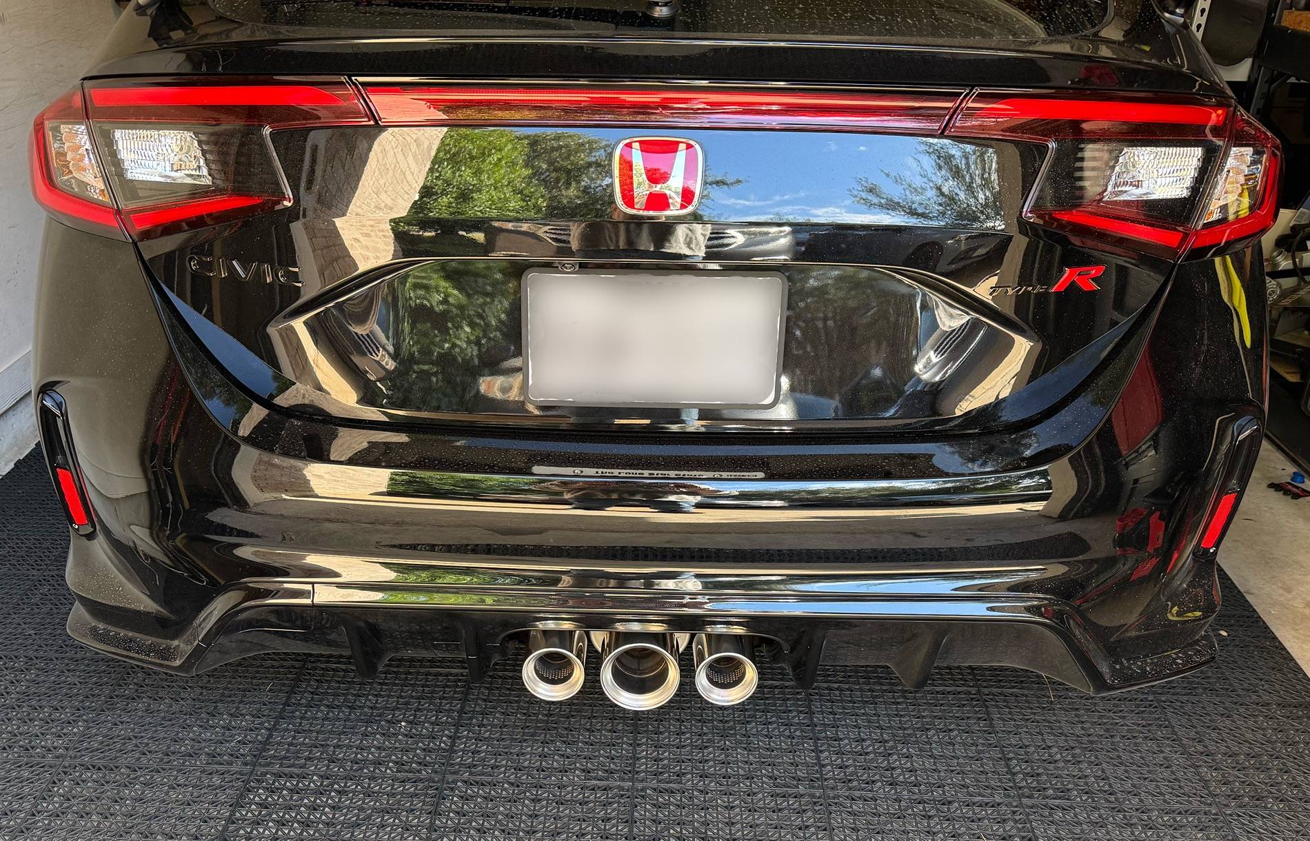

BEFORE
11th Gen Honda Civic OEM exhaust with black tips? 1735069686419-hm

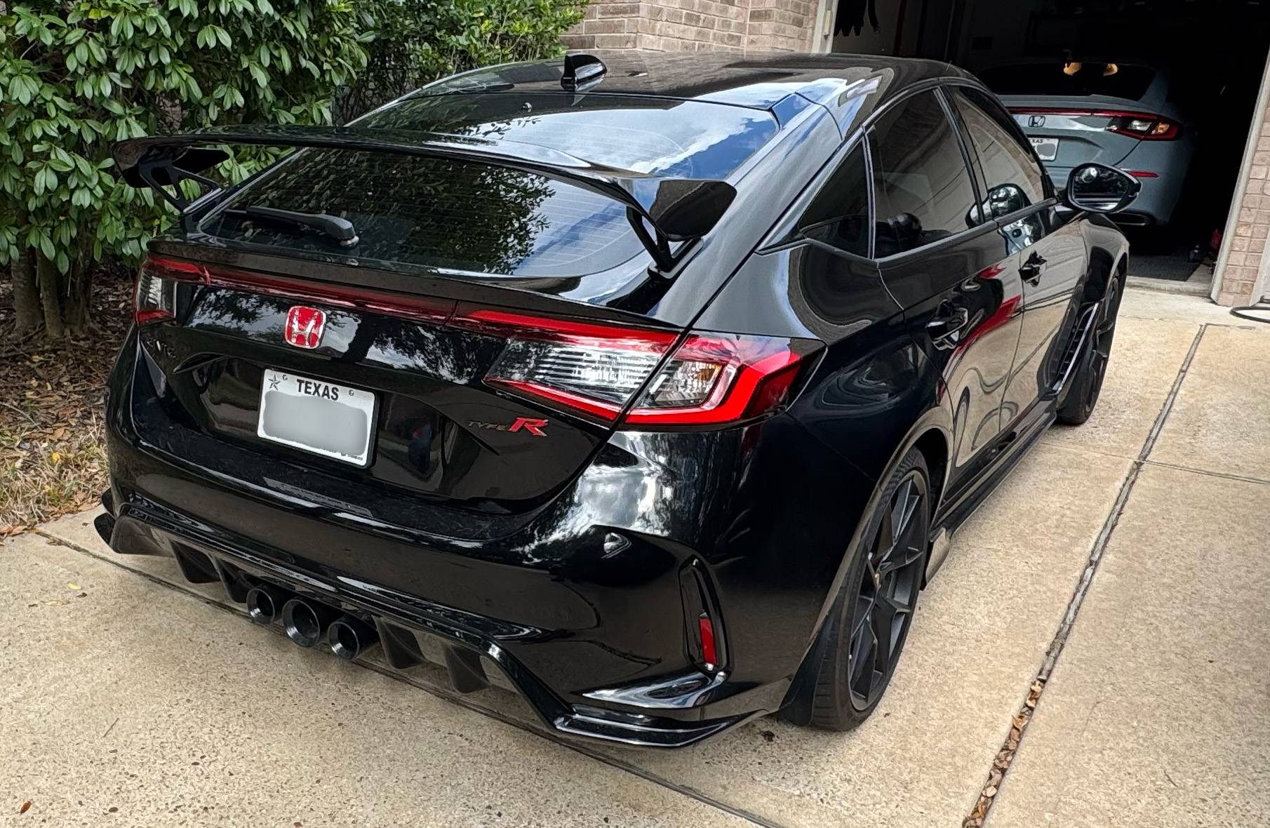

AFTER
11th Gen Honda Civic OEM exhaust with black tips? 1735069786735-sx
AFTER (I should have cleaned the tips (and car) before shooting)
11th Gen Honda Civic OEM exhaust with black tips? 1735069845333-px
AFTER (2/3 turned out ok; left tip was sprayed too heavy at Phase 3)
11th Gen Honda Civic OEM exhaust with black tips? 1735069960516-0c
