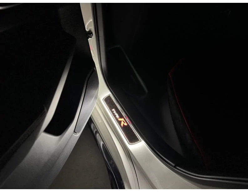

When I traded my DE5 for the FL5, I immediately missed the DE5's illuminated door sills--bright, glossy, and located at the front and back doors. I had my dealership install the FL5 OEM door sills, but they're just sad--dim, orangeish-red, and only available for the front doors. C'mon, Honda!

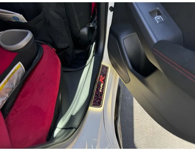

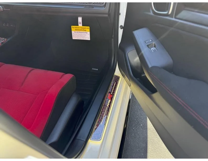

I looked at some of the sills offered by other manufacturers, learned a bit about how they're constructed, put together a design, and hunted down a manufacturer willing to make a set of prototypes to my specs (in China, of all places, can you believe that?). They arrived about 6 weeks later, and I installed them last weekend using my OEM wiring harness and a few soldering heat shrink connections. I'm very pleased with the outcome, and I've been getting a surprising number of questions about selling them... so I'm here to gauge interest.

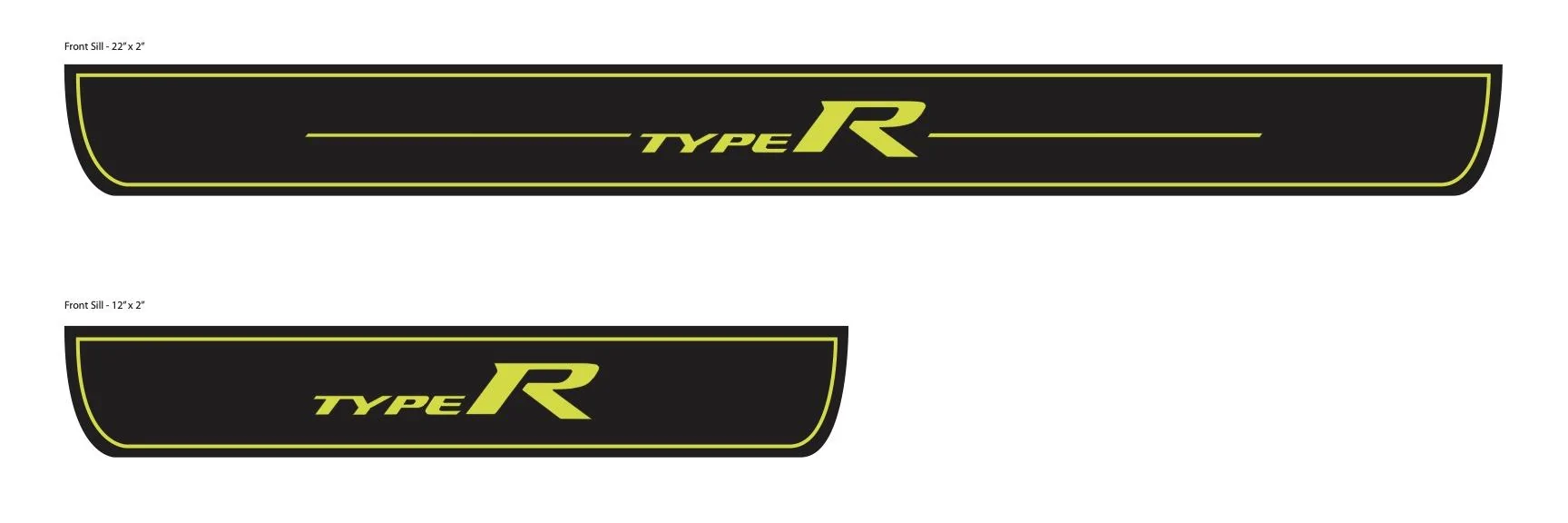

A few disclaimers: A future run will be the same size/shape/layout but will have the Type R logo on a black background, not the FL5 camo--it will give the Type R logo more pop when it's dark, similar to the Integra illuminated sills. Install will require running Honda's illuminated sill wiring harness (~$30) behind the dash, and will also require (very basic) wiring skills--ie snip the OEM sill plugs, and wire in the sills using your choice of connection type (heat shrink solder sleeves or Wago connectors, for example). This will be for all 4 doors, not just the front doors--running the harness behind the dash is the tedious job (in my opinion), and placing the for both doors sills only requires removing ~4 pieces of trim on each side, loosening the weather stripping, and a little body tape.
I'm expecting the cost with freight and duty to come in around $300/set + Shipping, but I'd need about 25 orders to justify the work. If it seems like there's enough interest, I'll share a mockup of the sills in black, I'm sure you already get the idea.

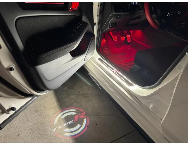

Did you also install the JDM interior lights in the door handles and door pockets? Does that mean you also did the additional footwell lighting? Is that why it looks so bright?

I've confirmed the manufacturer will ship an order as small as 10 sets, so here's a mockup of the sills without camo for reference. Maybe 7 more folks are interested?
The mockup in green shows the elements that illuminate (along with the outer perimeter of the sill to give a nice puddle light effect).
Feel free to reach out with any questions!
