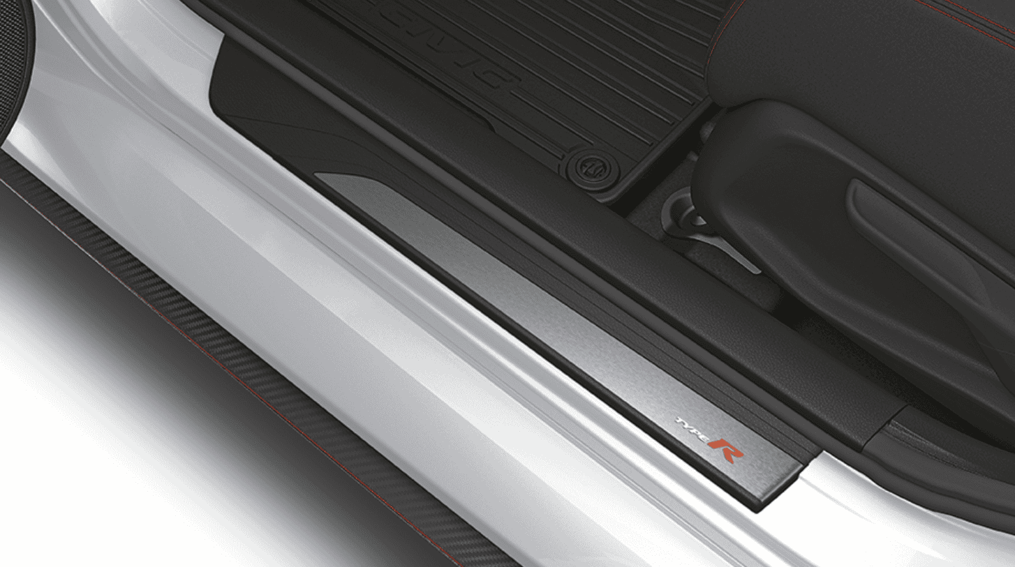

Two questions...
1. The FK8 one has a slanted forward edge and a straight rear edge. Your black ones have slanted edges on both ends yet are the same overall length (and also width), so therefore should fit, yes?

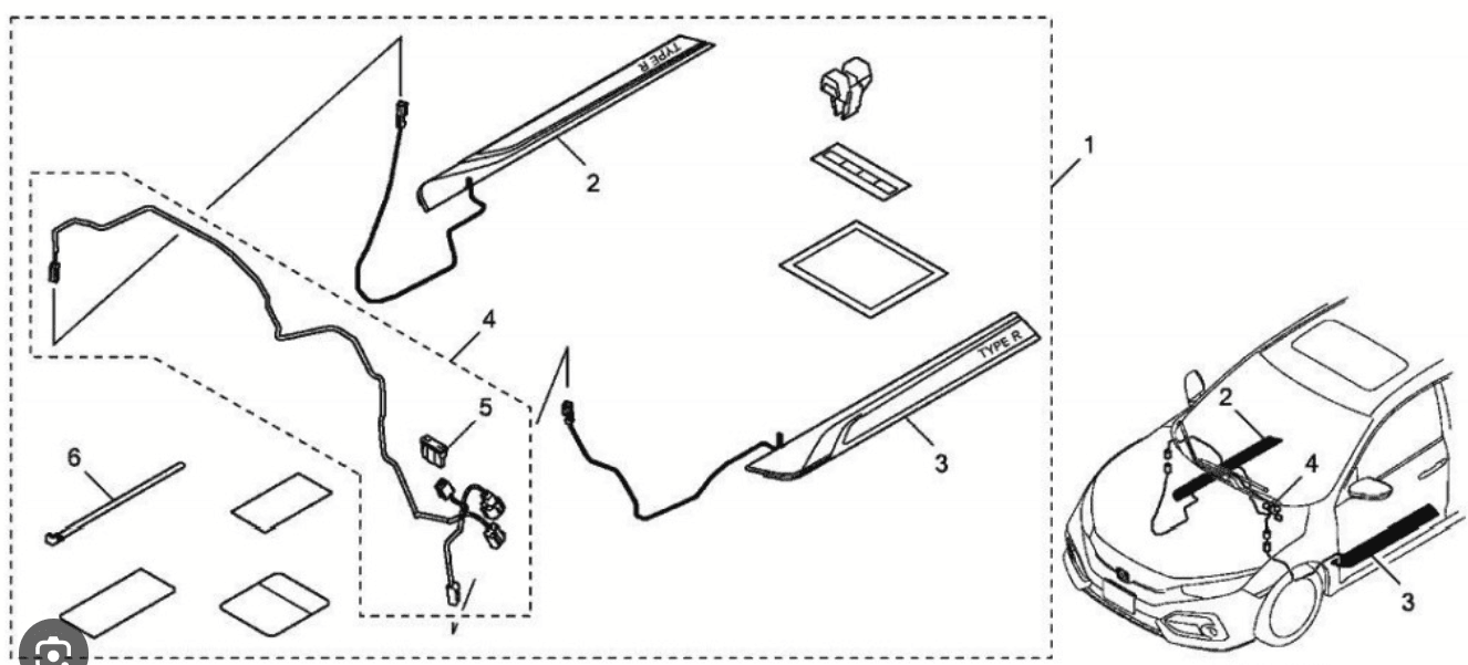

2. The connector port for the FK8 ones is toward the front of the strip, as seen in the pic. I'm assuming yours is at the same location? Or, since you mentioned using the wire that comes with your kit and soldering, this whole #2 question is a moot issue?

Mine measure 12x2 (rear) and 22x2 (front). The angled edges on the OEM sills (and the curved edges on mine) are decorative, not necessary for door closure or sealing.
The wires in each of mine exit from the center/top of the sill, which help with production (and install, frankly)—instead of having 4 different sills in one order with each specific to one door install, there are only 2 fronts and 2 backs. They’re interchangeable from left door to right.
The point where the wire enters the car isn’t necessarily important, as there’s not a “channel” for the wire to enter, it’s fed up and over the body line and into the car. The OEM kit contains 2 “clips” that hold the sill wire on each side to keep it from shifting (which could rub the wire casing over time), but they’re not essential to the job as any number of things can be used to cushion and hold the wire at your chosen entry point. On the FL5 (likely the FK8 too) there are a handful of sawtooth-like notches (smooth indentations) intermittently spaced along the door line which might be there to help the door seal make a seal, or may serve a manufacturing purpose (not completely sure, honestly, possibly for panel alignment now that I’m thinking) but I put a small bit of foam tape over one of those grooves, ran my wire across it, and put another piece of foam tape across the top. I’m happier with this entry method, personally, as the wire now sits lower than the door line and should (in theory) face less risk of getting chopped off like a guillotine should someone step on the door sill plastic trim right where the wire enters Not likely, but I suppose anything is possible.
These ship with 5’ of 20 or 22 awg wire (think speaker wire). It’s flexible, and way more than enough wire to attach both sills how/where you want them. I recommend soldering the connections (or Wago butt connectors, am I the only one who knows about these? They’re brilliant!) because I’ve had no success in finding the male/female plug ends Honda uses (there are countless variations out there, all available rom overseas, but only in bulk). OEM-type plugs aren’t critical, as you’re just connecting positive to positive and negative to negative in a way that’ll hold satisfactorily, but part of me would’ve loved to have found Honda clips. Ultimately, not important.

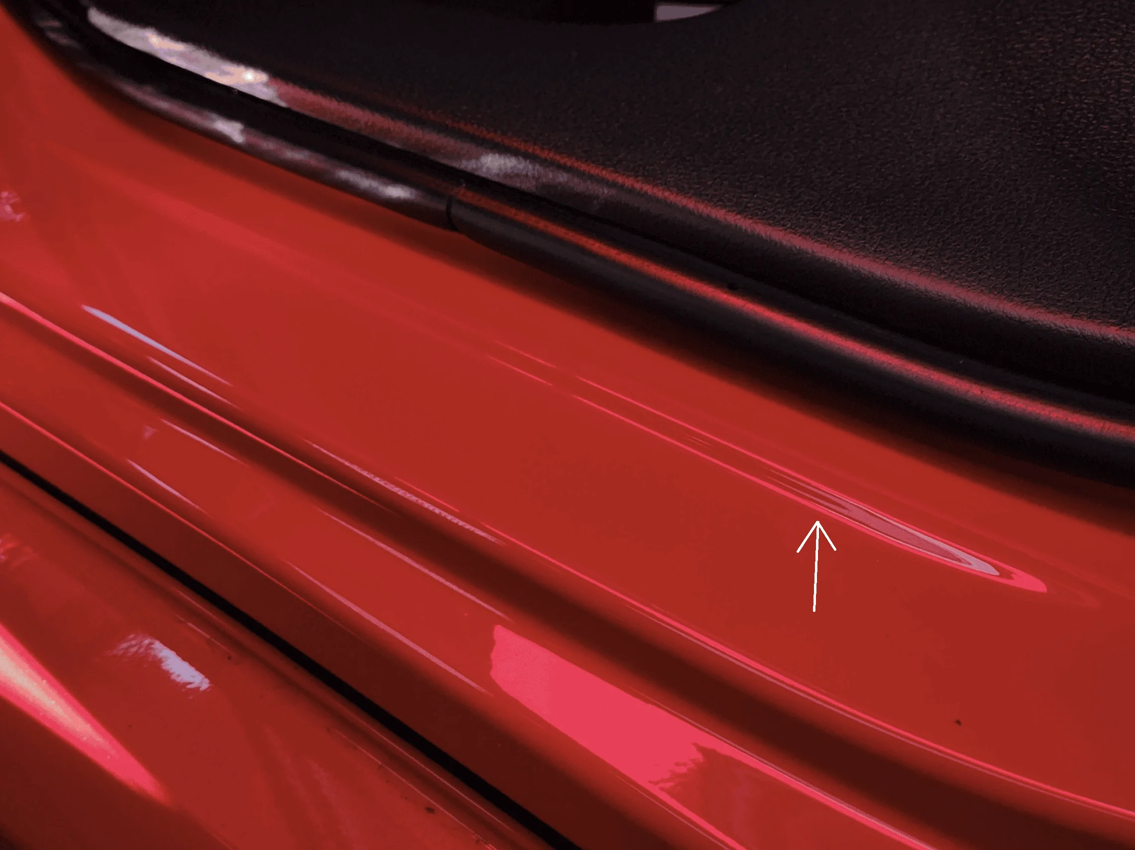

The FK8 front sills are 22 inches long as well, and a hair over 2 inches wide. However, note there is that raised ridge on the sheetmetal that the accessory sill contours over. Do your sills have the same contour (e.g. does the FL5 sheetmetal also have this ridge)?

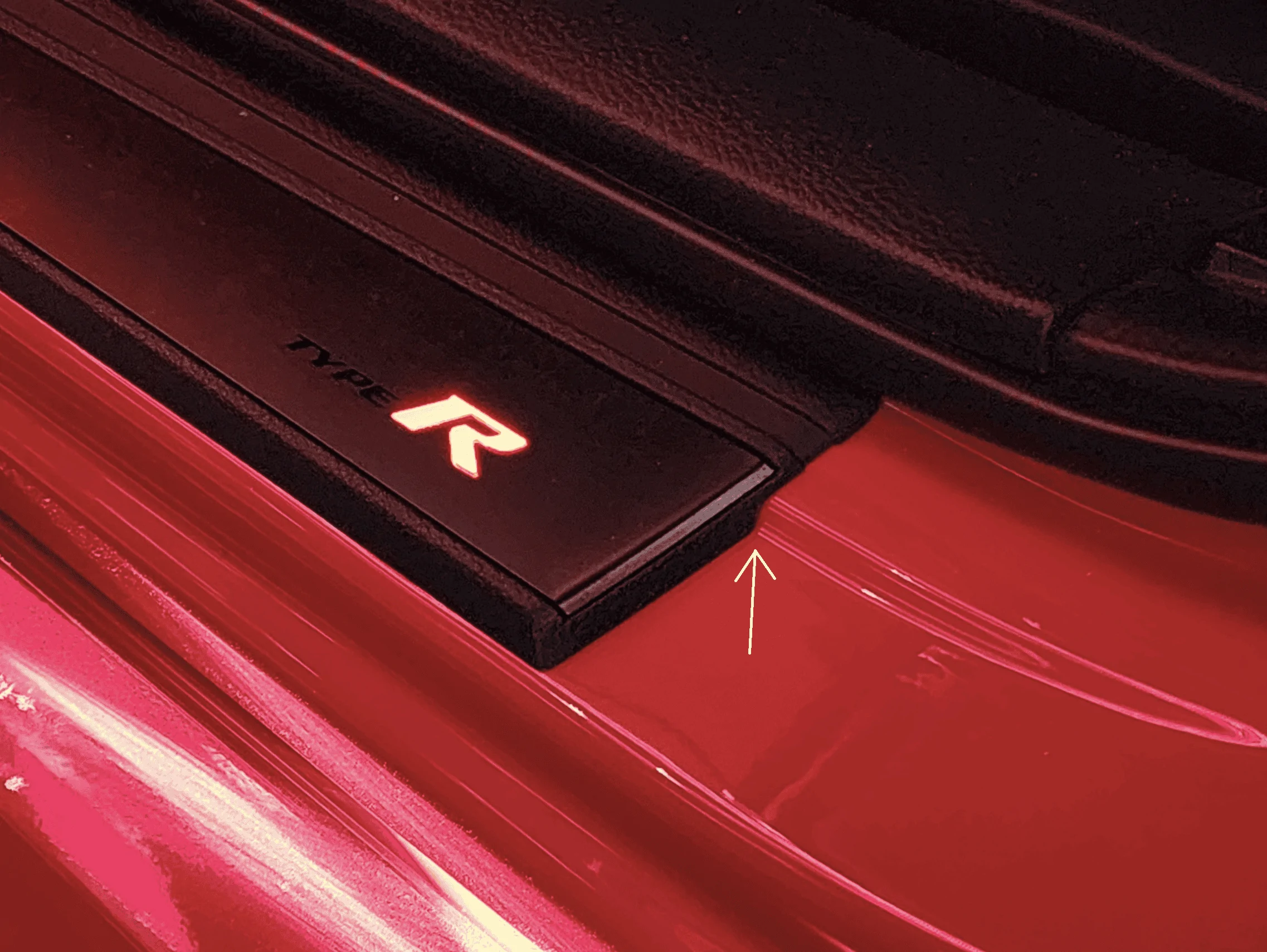

The FK8 rear sheetmetal also has a raised ridge. Also, you mentioned your rear sill was 12 inches long. There is about 10 inches of completely flat sheetmetal, but a 12-inch sill might need to be ever so slightly curved up on either end (~1 inch on each end). If the sill material is flexible and the adhesive is strong enough, it may work, I don't know.

Ah—good to know. I wasn’t aware of that contour and my sills are flat on the back (as is the FL5 sill area).
I believe a 3D printed shim could solve that problem, but I’m just hocking sills—shims are a different department.
