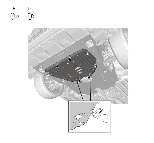

Since these are super simple, here's the Honda service docs for the oil change process and refill amounts for the 1.5L and 2.0L
First, take off the splash shield.
You'll need a #3 Phillips (Yes a #3) and a flathead.
11th Gen Honda Civic Oil Change Service Official DIY Instructions for 2022 Civic 1.5L and 2.0L 1641581849010

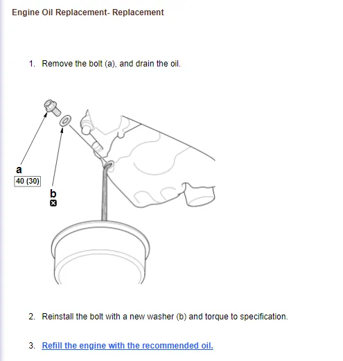

Then use a 17mm wrench or socket for the drain plug.
Please use a new crush washer with each oil change.
Honda requires drain bolt to be torqued to 30 foot pounds.
11th Gen Honda Civic Oil Change Service Official DIY Instructions for 2022 Civic 1.5L and 2.0L 1641581971376

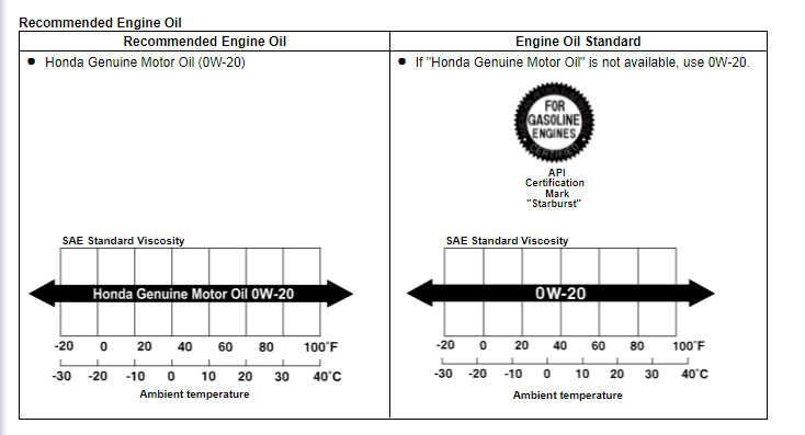

Honda says 0W-20 for both 2.0L and 1.5L
11th Gen Honda Civic Oil Change Service Official DIY Instructions for 2022 Civic 1.5L and 2.0L 1641582216961

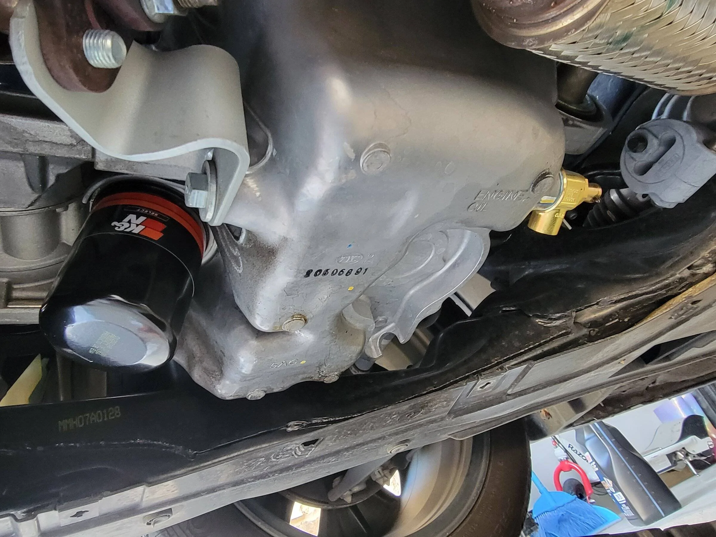

你推薦使用 Fumoto 排水閥嗎?
11th Gen Honda Civic Oil Change Service Official DIY Instructions for 2022 Civic 1.5L and 2.0L 20211124_090416

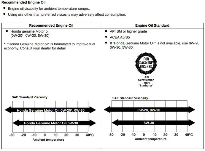

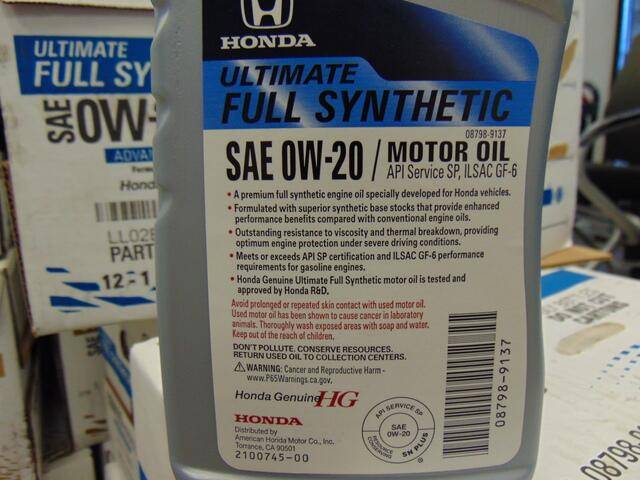

What is the best oil for the Type R 2.0L motor?
I see 0w20 is the preferred viscosity with an API standard of SM or higher
11th Gen Honda Civic Oil Change Service Official DIY Instructions for 2022 Civic 1.5L and 2.0L 1725911629856-4h
I use Mobil 1 in some of my cars, wondering what others are using?
I found this Honda Full Synthetic but I would like to put the best oil I can in my FL5 and I don't know if this is it or not >>>
Genuine HONDA Ultimate Full Synthetic (0W 20) motor oil - Honda (08798-9137)
11th Gen Honda Civic Oil Change Service Official DIY Instructions for 2022 Civic 1.5L and 2.0L 1725911693817-24
