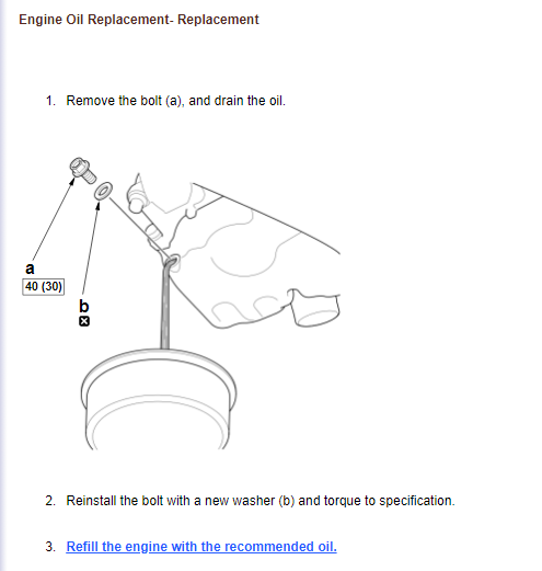

Then use a 17mm wrench or socket for the drain plug.
Please use a new crush washer with each oil change.
Honda requires drain bolt to be torqued to 30 foot pounds.

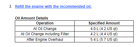

For the 2.0L, you'll fill 4.4 US quarts:

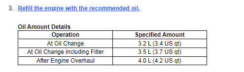

For the 1.5L, you'll fill 3.7 US quarts.

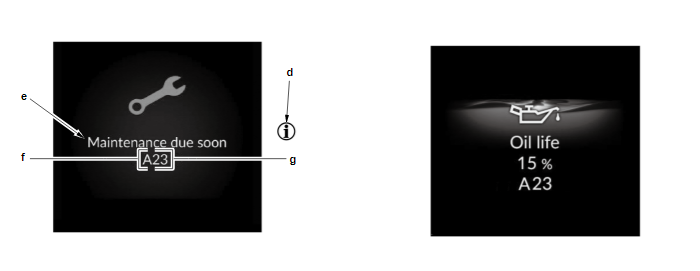

Then clean it all up, and reset your maintenance minder, and you're all set! Good luck!
