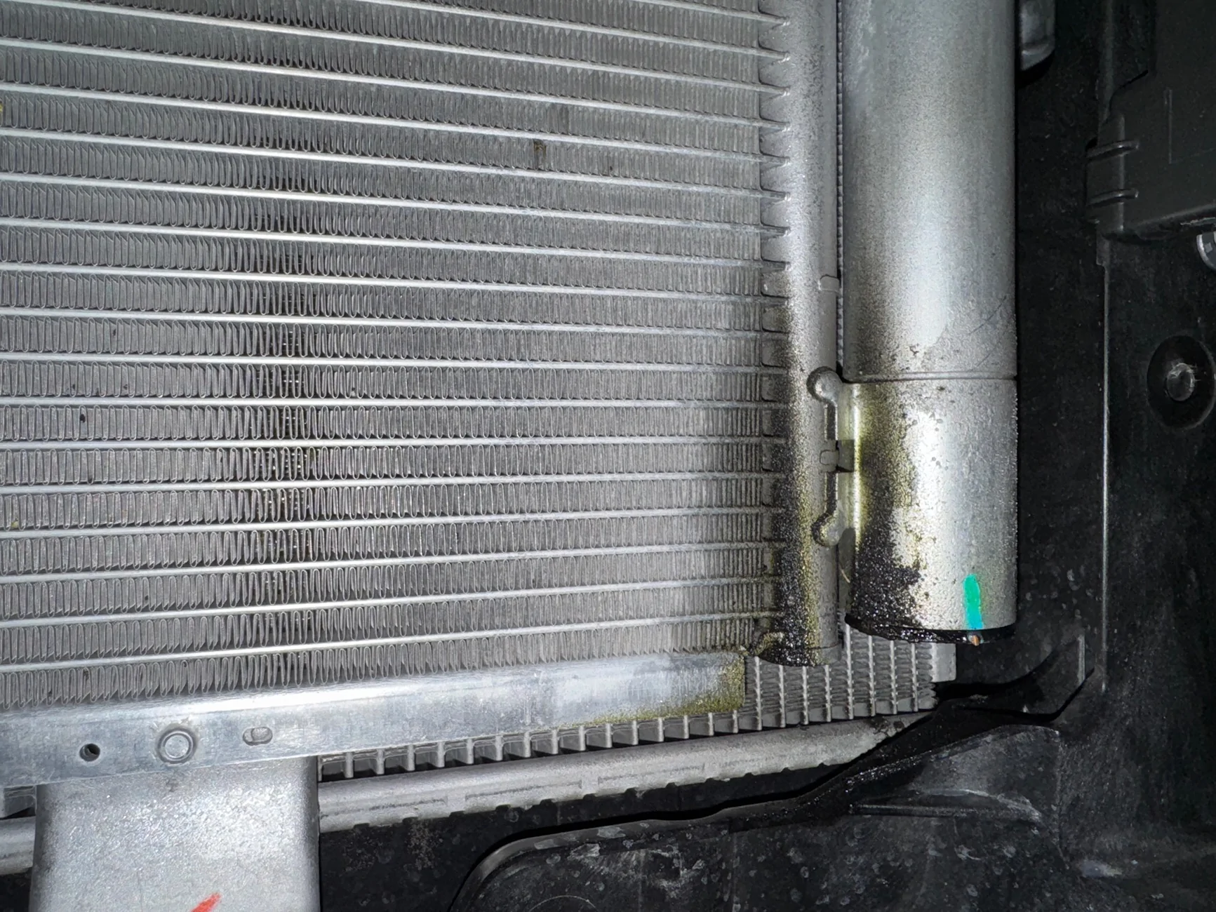

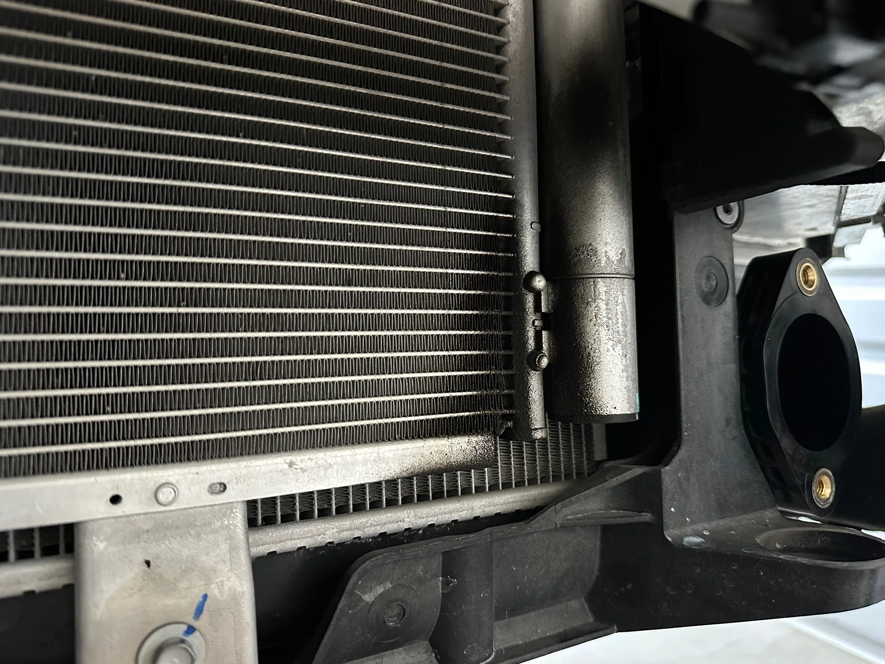

Was removing the intercooler, came
across oil in the condenser by the filter. What could be causing the leak.?

Wash it off and see if it reappears. If there's a pinhole leak in the AC, it may take months to reappear.
I've had excellent luck with Honda's, but one of the few problems was a leaking AC sight glass on an '87 CRX Si. The leak started slow and progressed to where I could feel it leaking after recharging. Car was beyond warranty, so I replaced the parts and had a technician vacuum and refill the system.

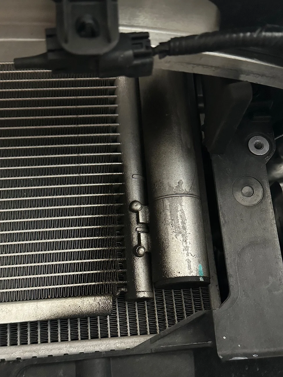

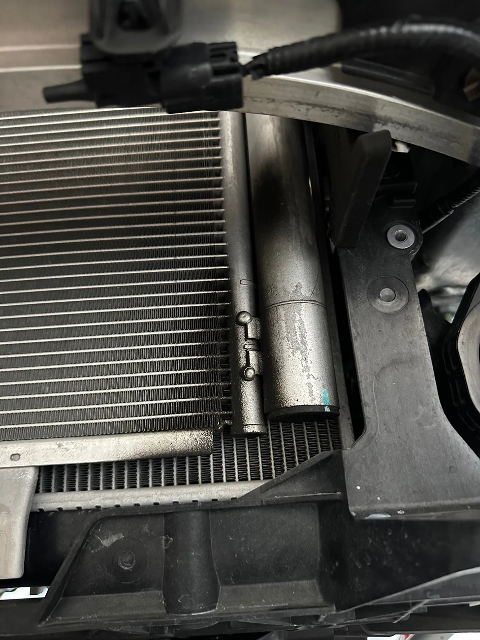

I just dealt with this same issue (picture attached). It’s definitely a condenser leak. Take it to the dealer and have them repair/replace under warranty.

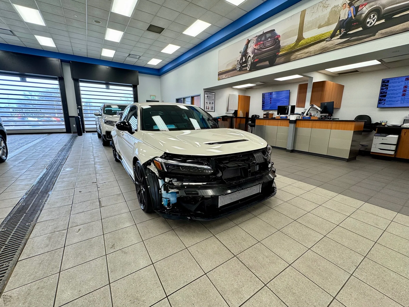

I took it to the dealer with the bumper off to prevent any headaches and put the stock intercooler back on.
What year FL5 do you have?

I hear you. I am very skeptical about the dealers too. Which is why I took the car bare and requested to speak with the tech that would be servicing the car.
It ended up being a good experience and the tech was very knowledgeable. I was able to go into the shop as well while they verified the diagnosis.

Do it. The techs were appreciative with having the bumper off already. Easier to diagnose and less risk of damage to anything else. Made for a faster repair.
