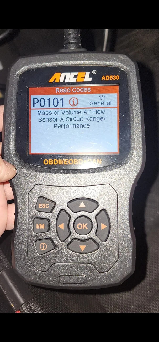

P0101 DTC

Thanks, I'll keep that in mind. So far the code hasn't came back since disconnecting the battery.
Hey, I’m running into the same error code. Did yours ever come back? I noticed every time I do a redline pull, this error code would show up, and the Civic will go into limp mode.
Hi, sorry for the late replay, have been extremely busy. No, the P0101 code hasn't returned, rotating the filter seemed to fixed the issue. My P0101 issue was random, it can pop up today, tomorrow, next week or month. Most of the time if not all, just normal cruising. I don't remember P0101 popping up on any of pulls. Sounds like you got a big leak if it happen everytime. Try the pressurized smoke test.

I pulled my battery connector like you did, and it seems to be working. I can’t explain it. It isn’t exactly a specific pull, but it pops up randomly. Could be redlining from 3rd to 4th gear. I’m going to try to rotate my filter to see if that helps. I did install my charge pipe, and I tightened everything I can from the top of the engine. I need to find some free time to take off my bumper and check the intercooler end.
