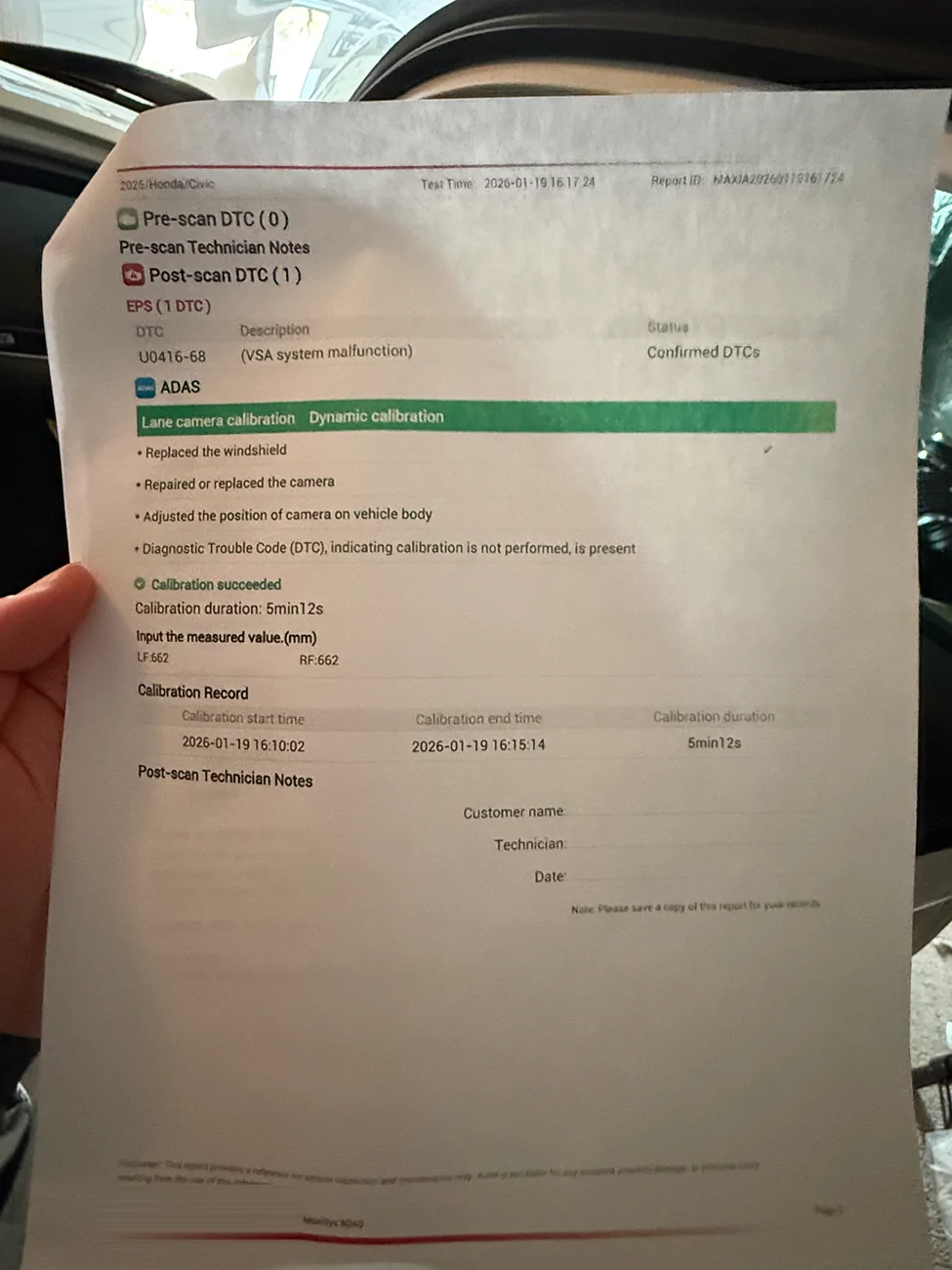

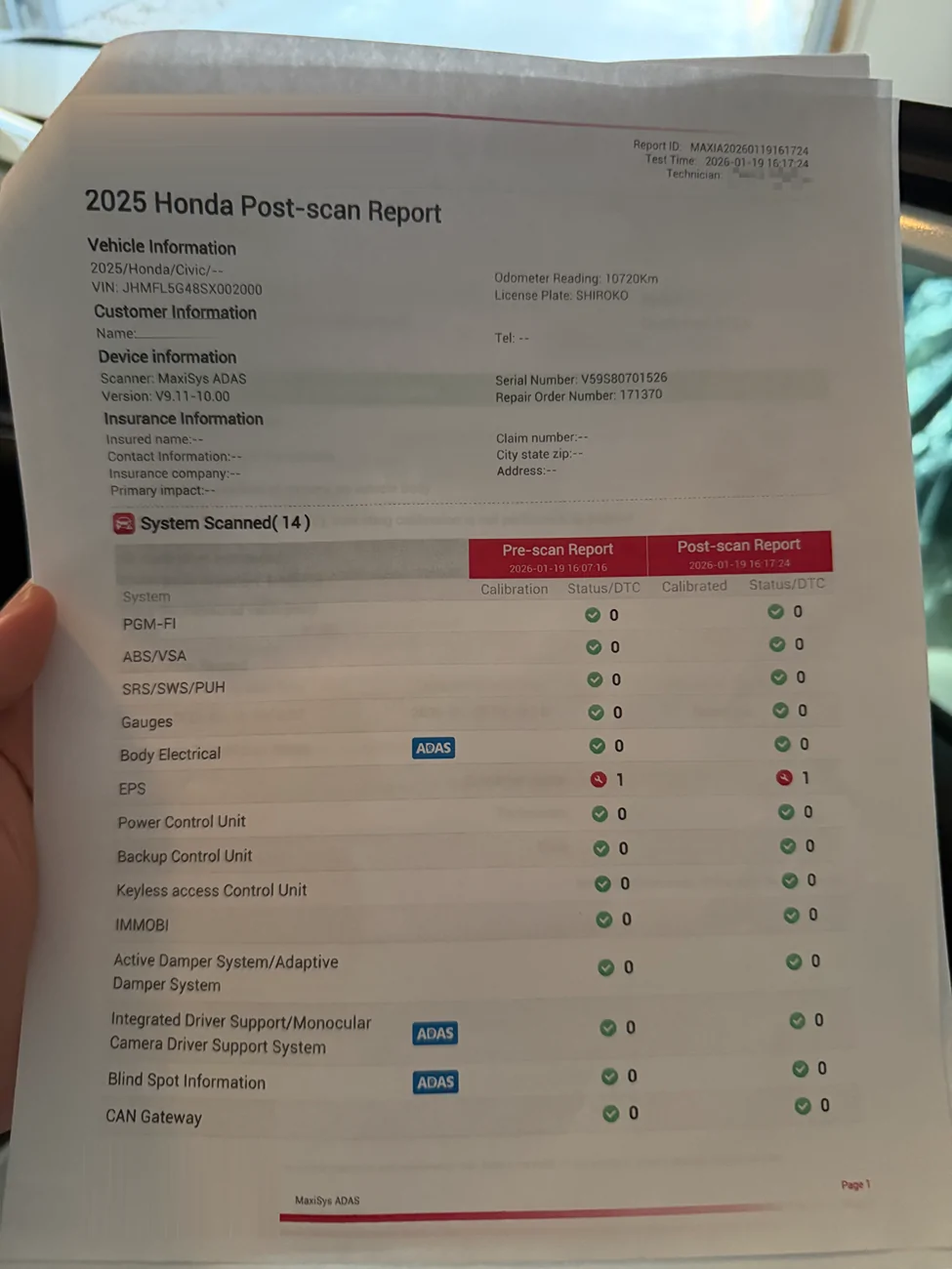

Thank you again for the help so far. That makes a lot of sense now. I do remember I pushed it up to 22 PSI for a short moment. It's probably unrelated then.
I did call the shop just now and spoke with the shop owner. They assured me that if the camera has any issue they would not be able to complete the calibration. They also described the code as "frozen" (not sure what that means). They basically suggested that I should find a mechanic to troubleshoot the cause of this problem, and they are willing to fix the issue if the cause is indeed related to the new windshield. They also said they are just a glass shop so they don't necessarily have the know-hows to troubleshoot electrical/mechanical problems. I attached the calibration report they gave me in case it is of any help. (I blurred out the shop and technician names because I don't want to point any fingers before I know the actual cause of this DTC.)
Not trying to discredit their work, but I think I got the "go kick a can" treatment on this particular issue. I hate being "that customer", guess I'd go elsewhere to figure out what's wrong then. I don't really know any mechanics locally in ATX who works on Type Rs, and with dealerships the water is always kind of murky. If you've got any connections, that would be much appreciated. Worst case, a trip to DFW won't be too bad.

It’s been two weeks so I figure I’d give an update. The same code has not cleared itself, and any attempt to clear it using my scanner didn’t work. The code comes back immediately after a restart.
One thing I didnā€˜t put much thought into earlier: the shop that installed my anti-theft system seems to have piggybacked some cables onto my OBD II port. The connector has been dangling instead of being properly mounted to the bracket. Not sure if they accidentally messed up any EPS wiring down there. Also, the system I installed requires me to input code using steering wheel buttons. Not sure if or how it would affect EPS.
Were you able to find any information regarding the code and its connection to EPS?
