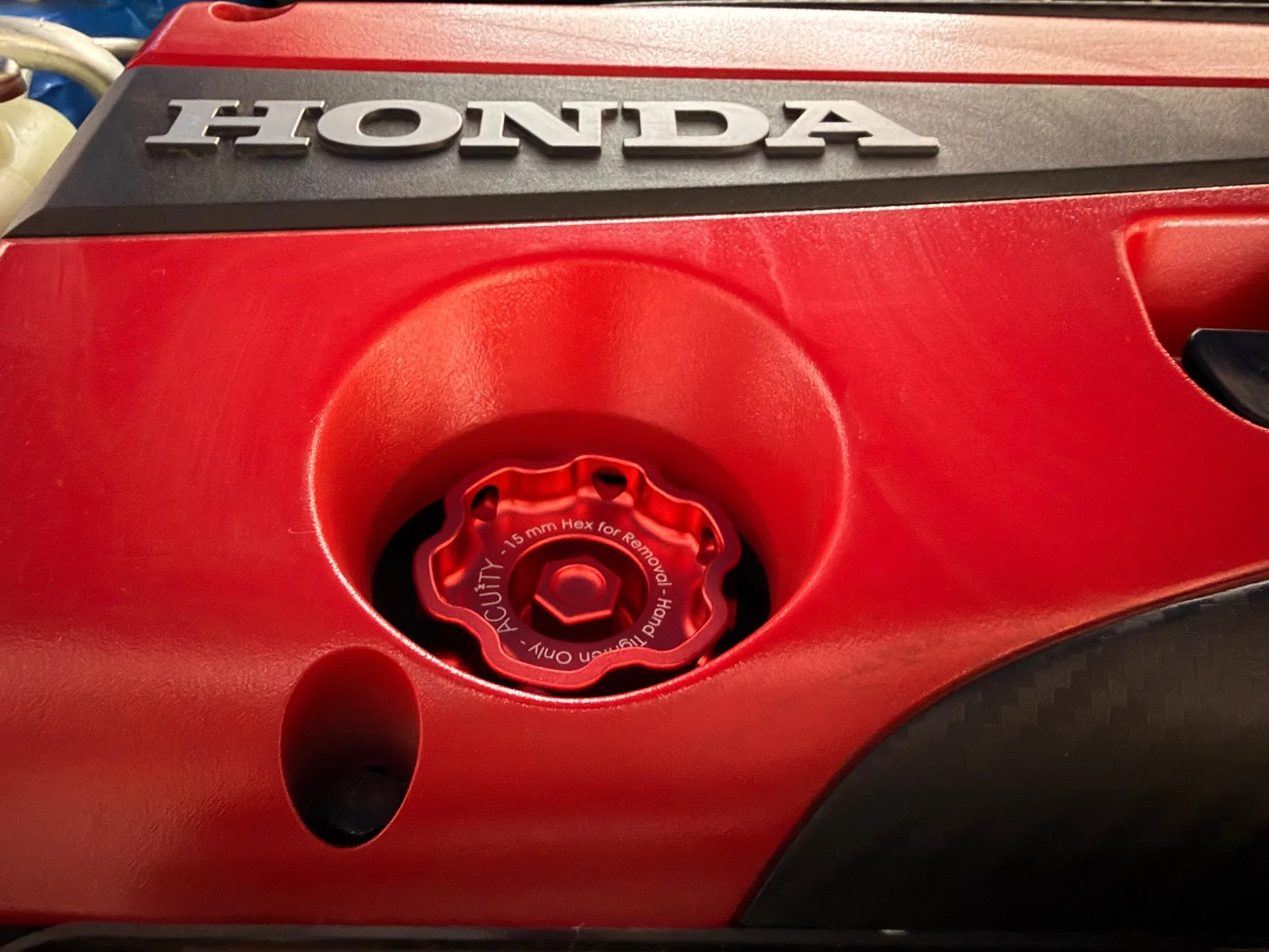

Also picked up a Podium oil cap in satin red. Wanted to match the cover.

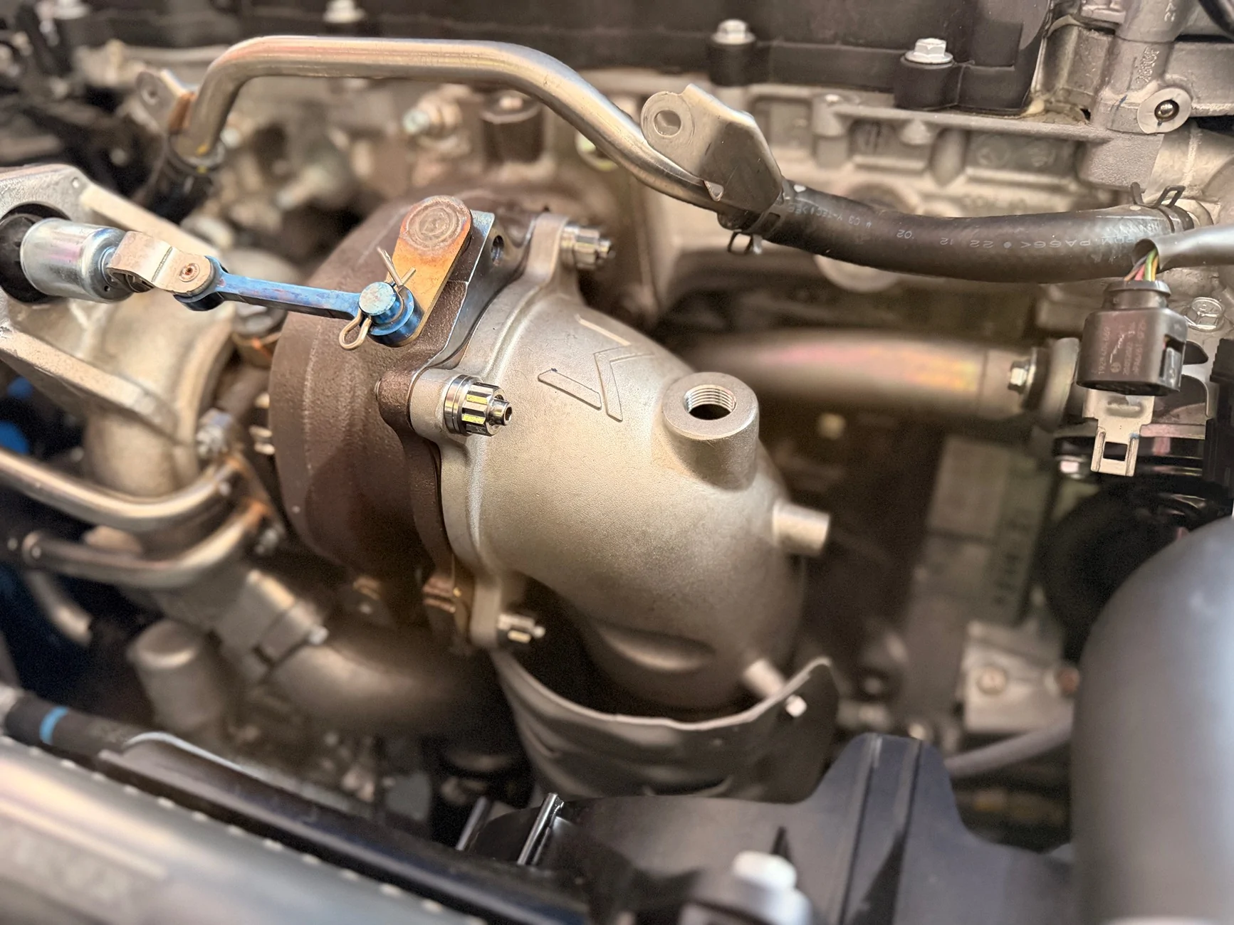

And lastly, this wasn’t a Black Friday purchase but more an impulse buy and BF regret-not-buying purchase. Used my Two Step GovX military discount and a nice credit card offer for statement credit to get the PRL titanium turbo inlet pipe kit.
Initially wasn’t going to go deep on parts but after buying all the exhaust stuff (downpipe, front pipe, and exhaust), went down the rabbit hole and thought might as well do all the stuff on the intake side too. lol. Also found out PRL discontinued the inlet pipe kit for the stock airbox but caught wind here on the forums that Two Step had a number of them left. I don’t plan on getting an intake since I have the Spoon filter and didn’t want the FOMO on the remaining inlet pipe kits Two Step had so I had to get it right? 😂
Installed it with Two Steps titanium inlet pipe stud kit.
11th Gen Honda Civic Phenom3030’s Boost Blue Pearl CTR #22333 IMG_3805

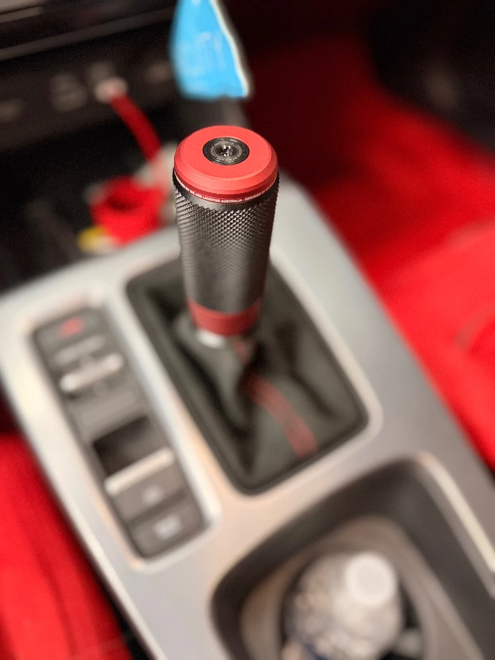

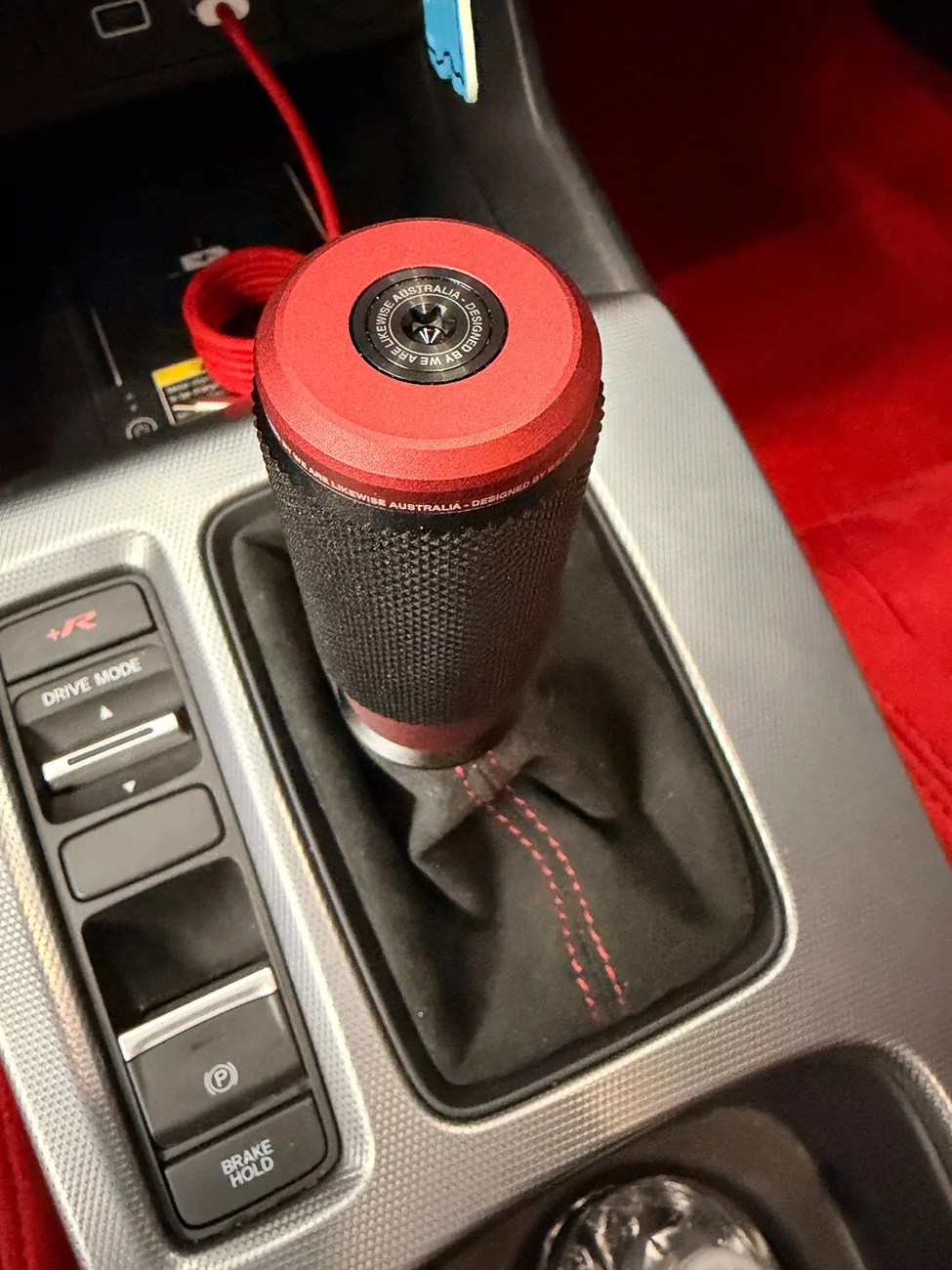

Kinda started a shift knob collection. Just received this We Are Likewise build your own shift knob today.

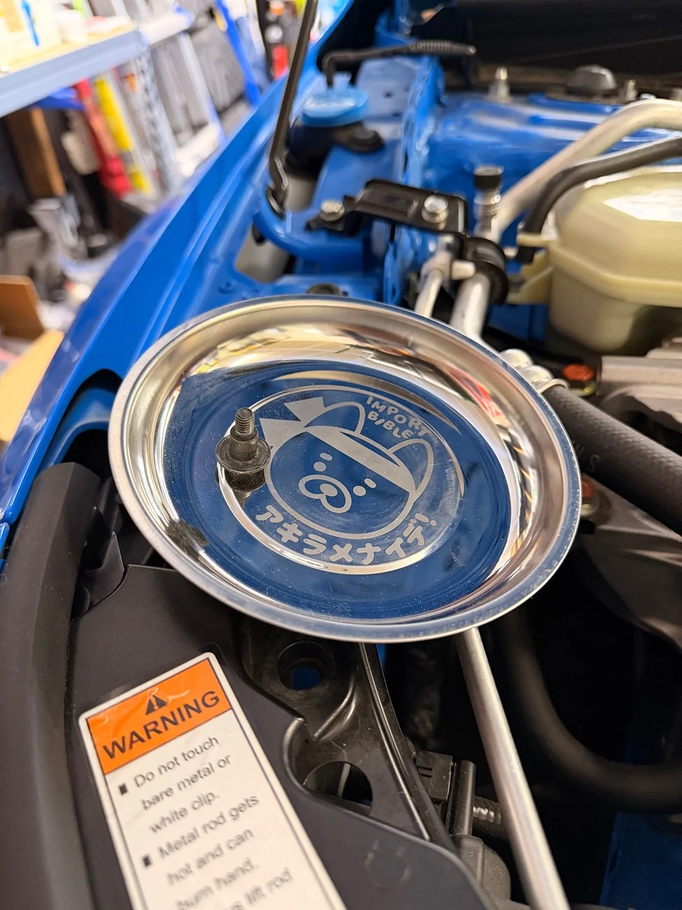

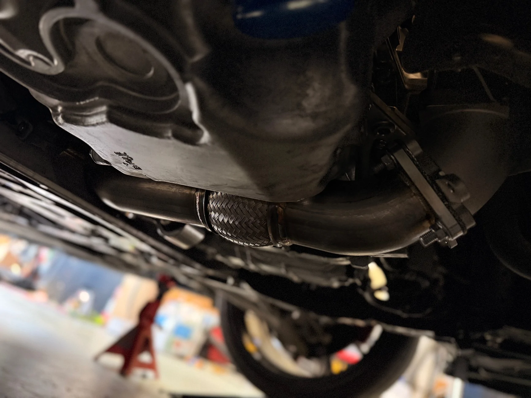

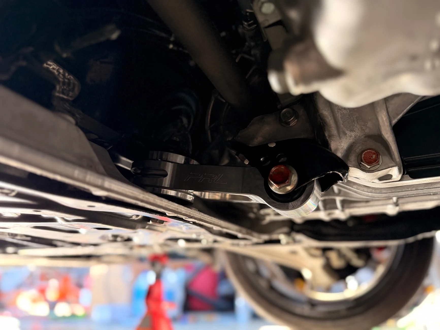

Started my full exhaust install this morning. Got the 27Won downpipe, titanium exhaust studs kit from turbo to downpipe, and PRL front pipe installed. As well as a PRL RMM I’ve had for a long time and just now getting around to putting it in. Hybrid Racing Formula exhaust is supposed to be delivered today. Still not here yet.
11th Gen Honda Civic Phenom3030’s Boost Blue Pearl CTR #22333 IMG_3905
11th Gen Honda Civic Phenom3030’s Boost Blue Pearl CTR #22333 IMG_3904
11th Gen Honda Civic Phenom3030’s Boost Blue Pearl CTR #22333 IMG_3906
And I’ve got one extra bolt I can’t figure out where it goes! I retraced my steps on the 27Won downpipe install instructions and can’t remember where this one came from. I’ve got the two bolts installed that look like this that mount the harness to the inlet pipe. Can someone please point me in the right direction!? 🙏🏽

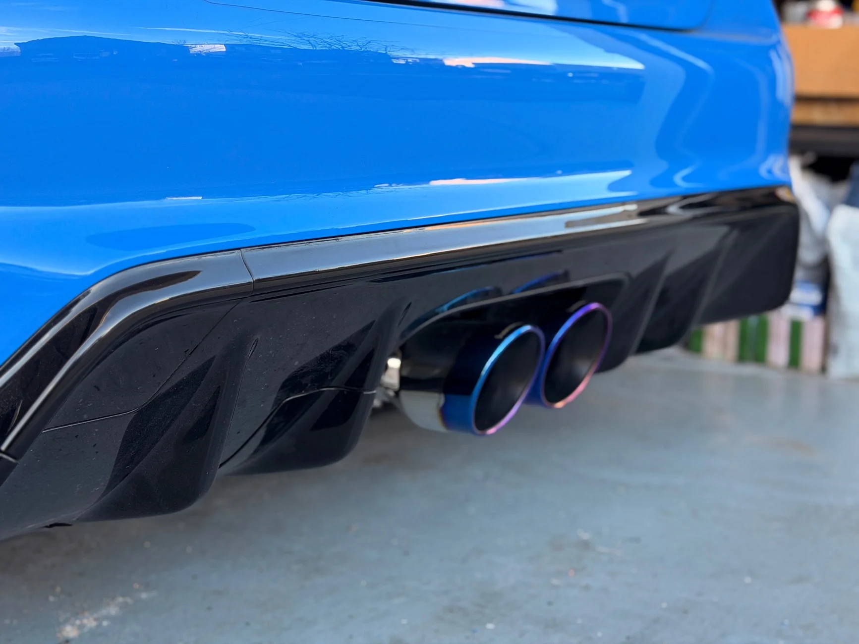

Finally finished installing the exhaust. Rubber hangers are a pain to deal with. I opted to go with Hybrid’s controller for the exhaust valve. Don’t know what it sounds like yet. Afraid to start and run the engine until I get an updated tune.
oh and figured out where that extra bolt went. It was one of the bolts for the under tray. Can proudly say I reinstalled everything without any extra bolts or clips leftover. lol.
That’s what I expected from an exhaust. I don’t know why it’s so hard for companies to make something that can sit flush with the bumper as it should! It looks nice and not ricer at all. Otherwise, you’d expect to pay $2k or more to have the tips of the exhaust protruding three feet from the bumper, and then they get mad when called out.
You’ve convinced me to get the burnt tip. It doesn’t look bad with Boost Blue and is definitely one of the exhausts that looks amazing. I hope to hear your honest opinion on how it sounds. I know you installed the downpipe and the whole nine yards, but I’ll be going with just the exhaust. It definitely looks pretty nice, and you’ve convinced me about the route I’m taking with mine.
I wanted the burnt tip to go with the boost blue. It's interesting when I was getting ready to reinstall the rear undertray, I was looking at the tips directly and the left one was definitely blue ringed, while the right one looked purple. Kinda cool, maybe just the way the sun was hitting it.
Jester was so nice as to get me squared away with a base map so that I could drive it today.
Initial impression is it is definitely louder than my stock exhaust with the rear resonator removed. I used the Hybrid fob to quickly test the sound with the valve open and closed while standing at the rear. It does seem to quiet the exhaust a bit with the valve closed. Perfect for when I'm leaving for work early in the morning. Don't want my neighbors to hate me. lol. More to follow on my thoughts after I give it some miles.
And right on man! Glad I could help. Thats what I appreciate about the forums, so much knowledge and experience to share and gain. The good thing about the Hybrid exhaust is it comes with two short pipes that connect the front pipe to the rest of the exhaust. One for the the OEM front pipe and one 3" pipe if you have an aftermarket front pipe. With the appropriate gaskets for each choice.
