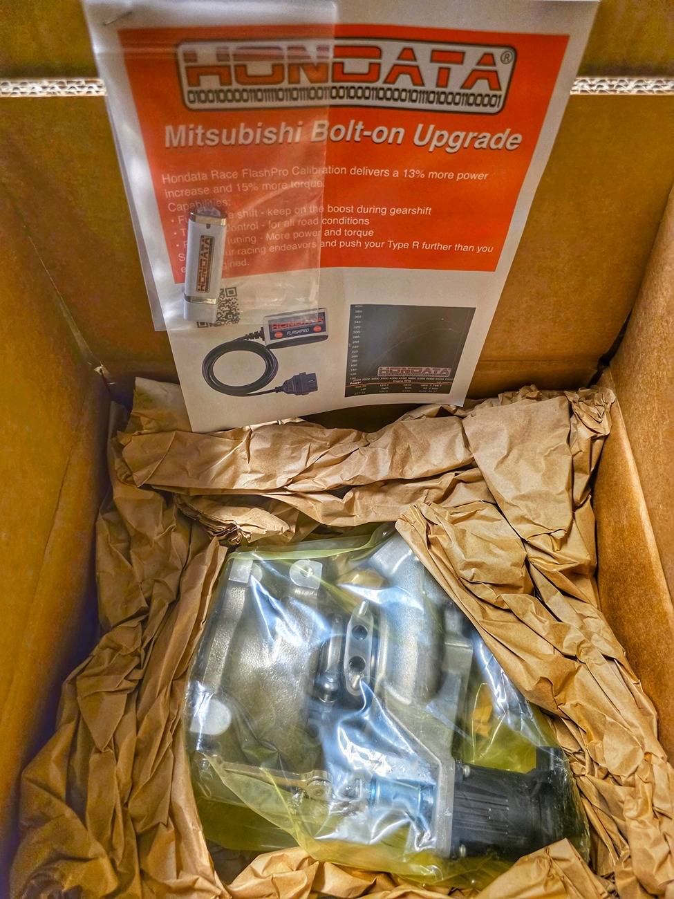

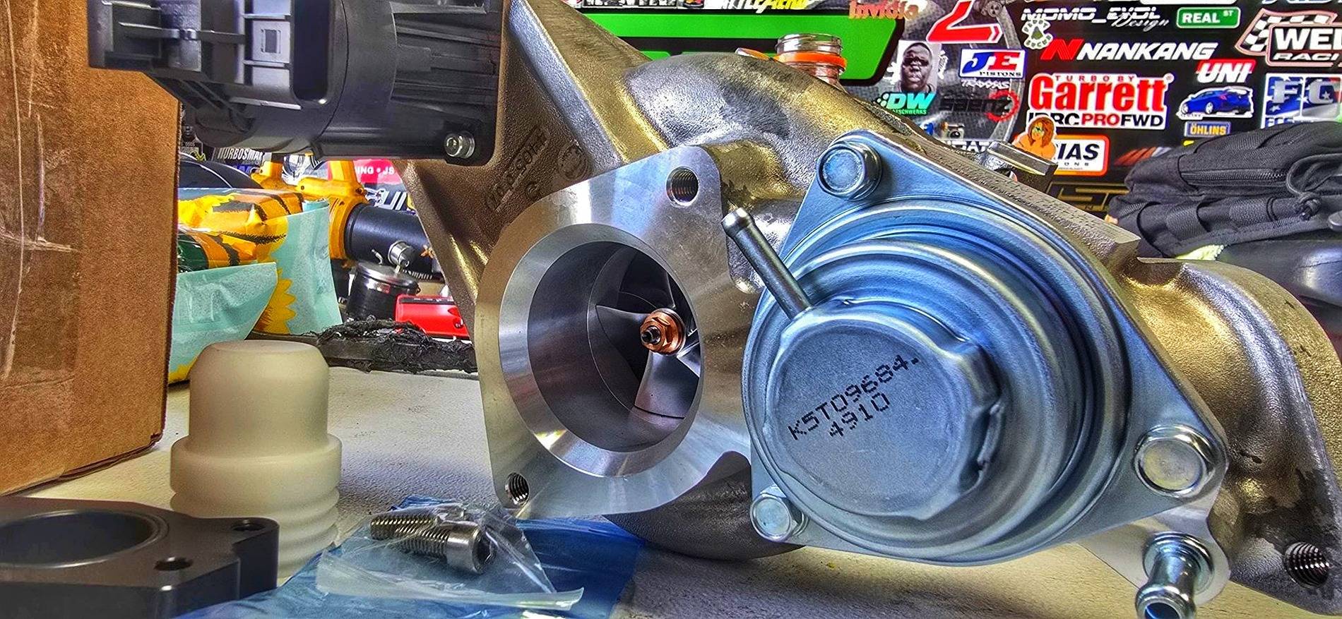

11th Gen Honda Civic BuntaTypeR Boost Blue Build 1000089396
11th Gen Honda Civic BuntaTypeR Boost Blue Build 1000089397
11th Gen Honda Civic BuntaTypeR Boost Blue Build 1000089398
11th Gen Honda Civic BuntaTypeR Boost Blue Build 1000089399
11th Gen Honda Civic BuntaTypeR Boost Blue Build 1000089401
11th Gen Honda Civic BuntaTypeR Boost Blue Build 1000089400
11th Gen Honda Civic BuntaTypeR Boost Blue Build 1000089402
11th Gen Honda Civic BuntaTypeR Boost Blue Build 1000089412
11th Gen Honda Civic BuntaTypeR Boost Blue Build 1000089413
11th Gen Honda Civic BuntaTypeR Boost Blue Build 1000089414
11th Gen Honda Civic BuntaTypeR Boost Blue Build 1000089415
11th Gen Honda Civic BuntaTypeR Boost Blue Build 1000089416
11th Gen Honda Civic BuntaTypeR Boost Blue Build 1000089429
11th Gen Honda Civic BuntaTypeR Boost Blue Build 1000089428

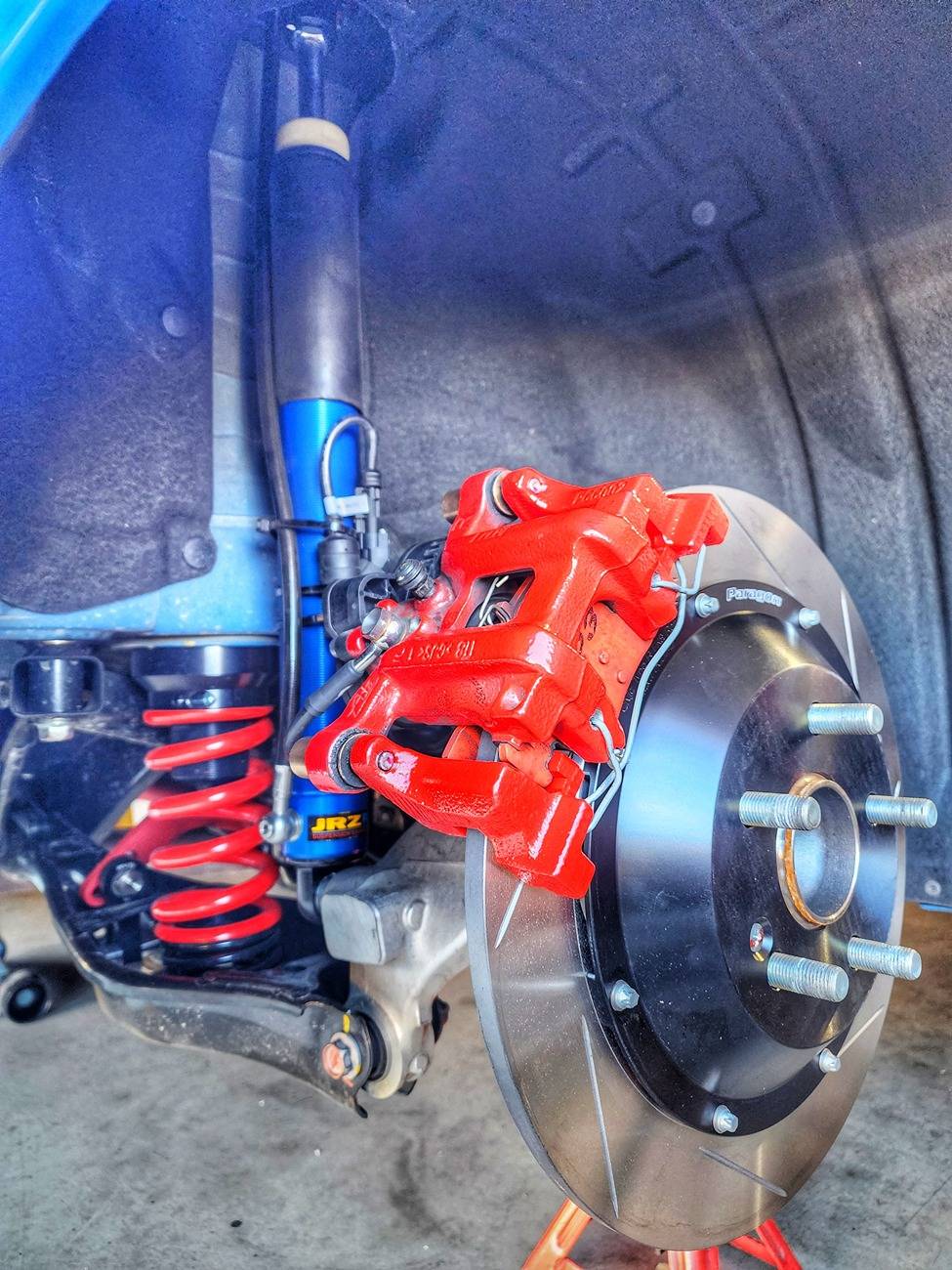

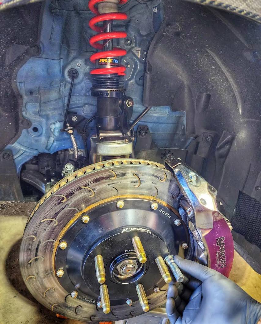

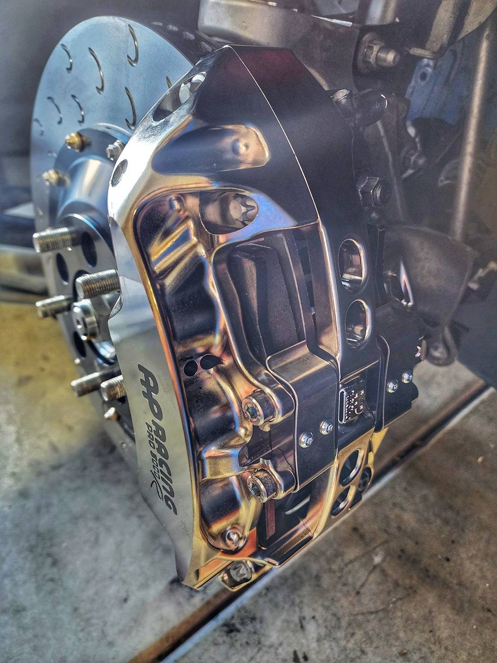

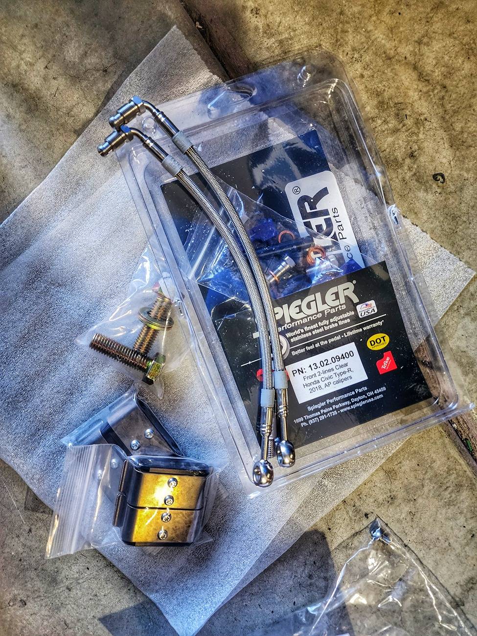

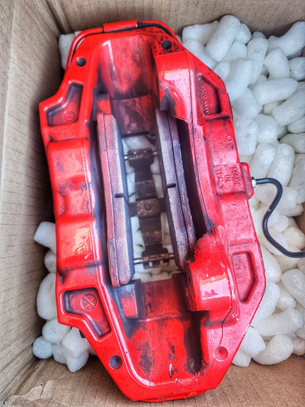

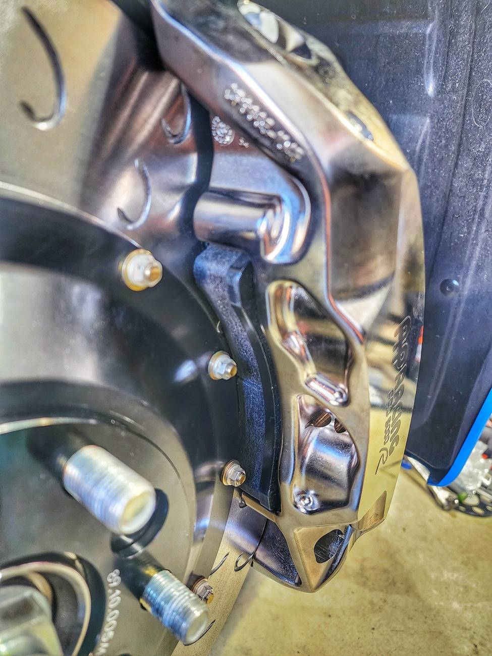

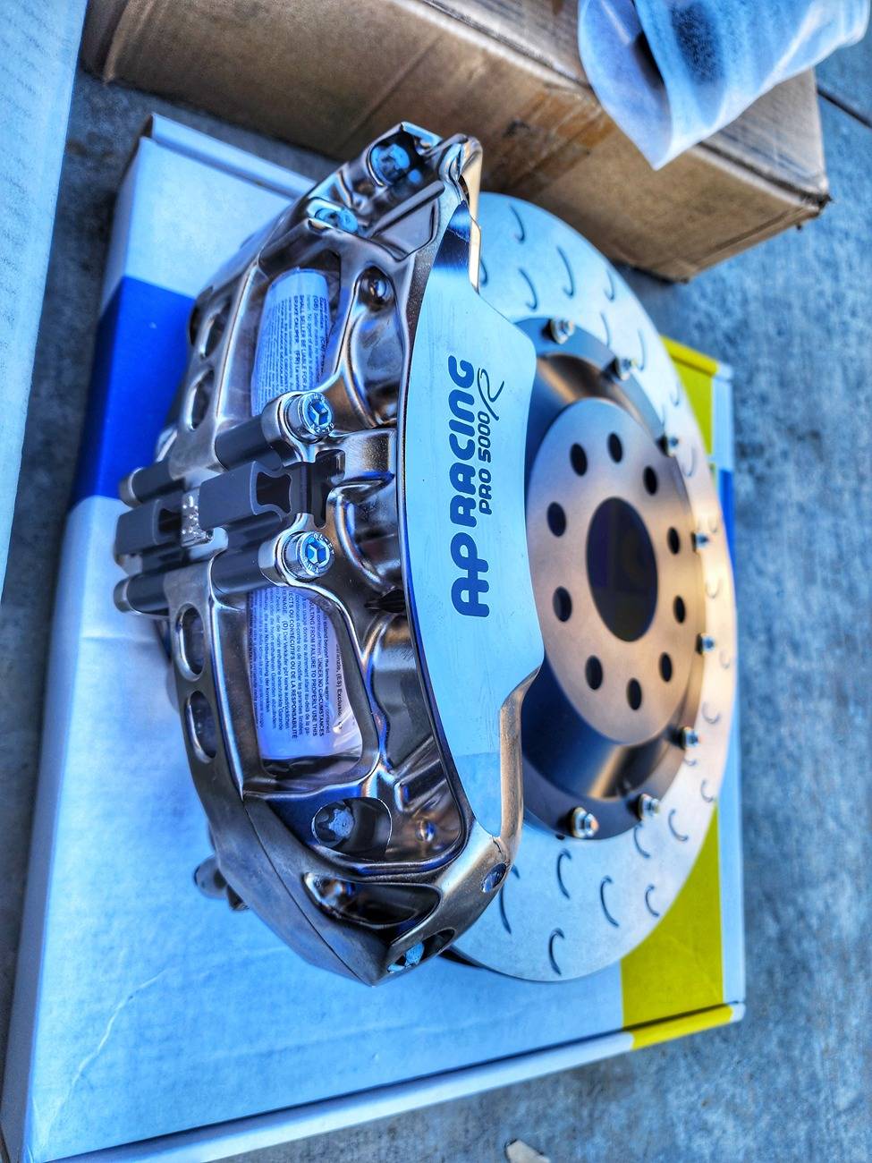

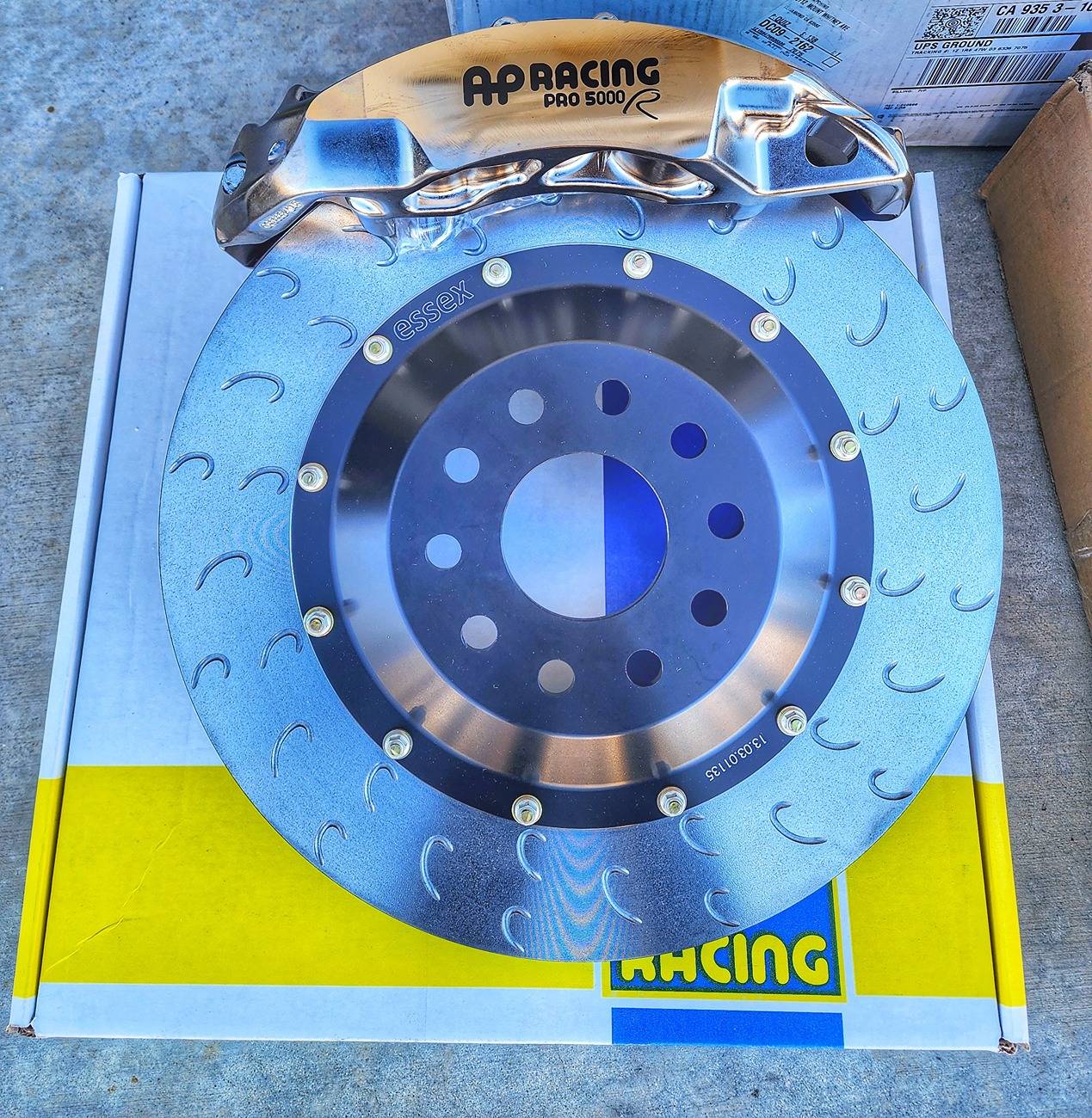

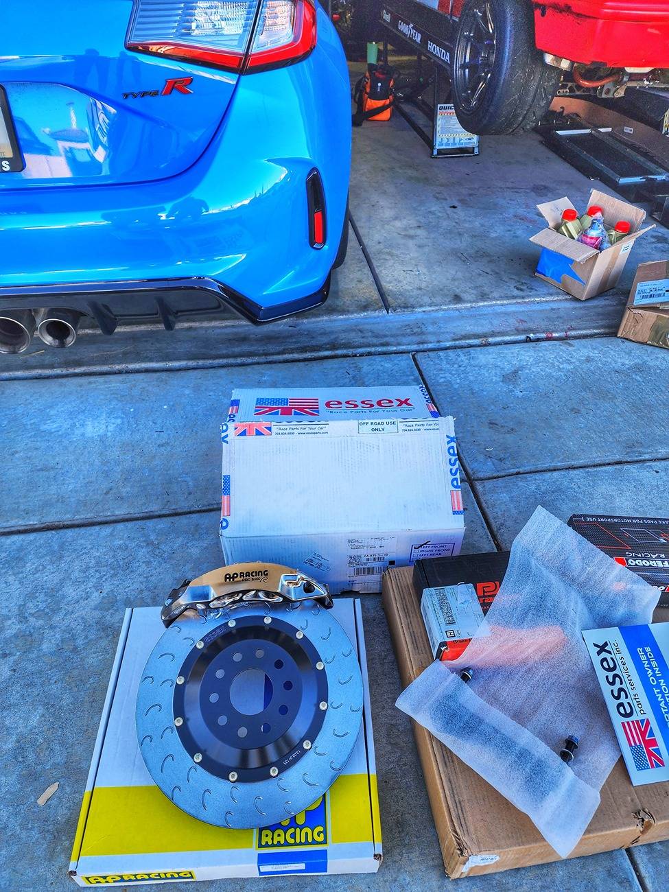

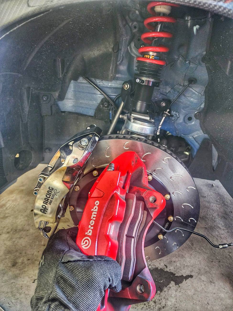

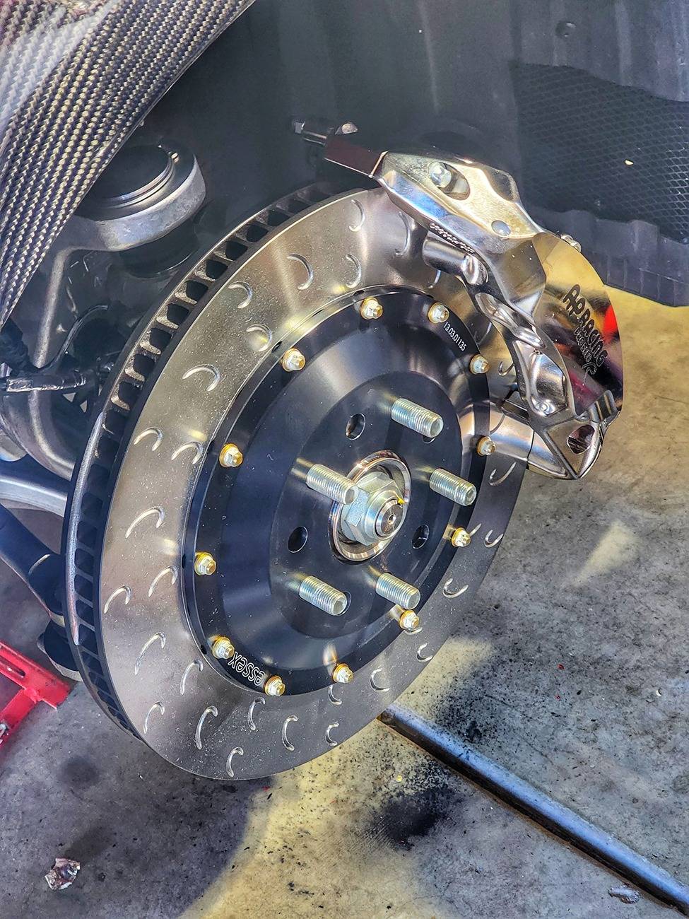

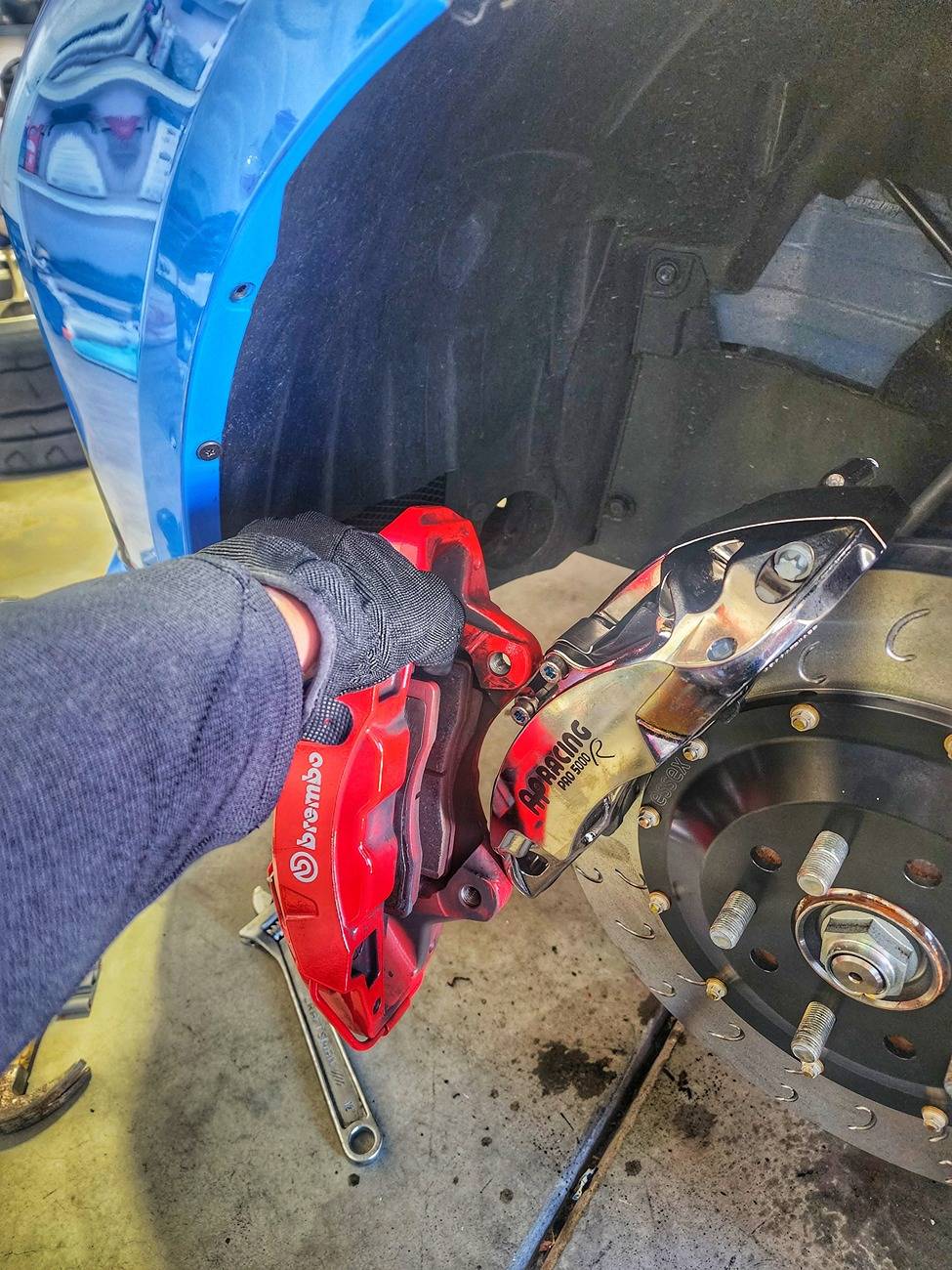

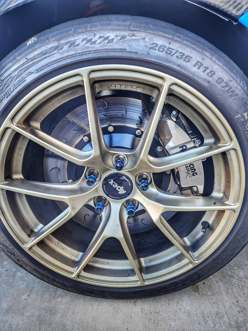

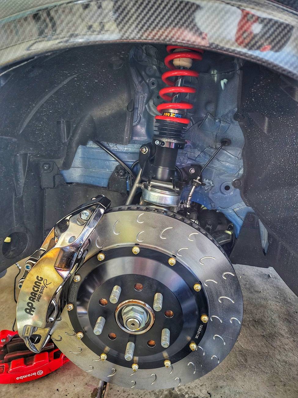

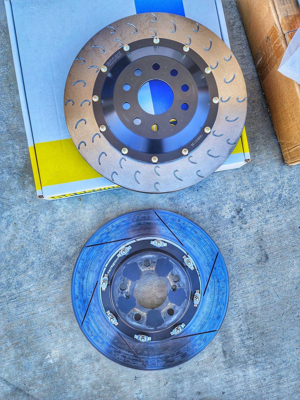

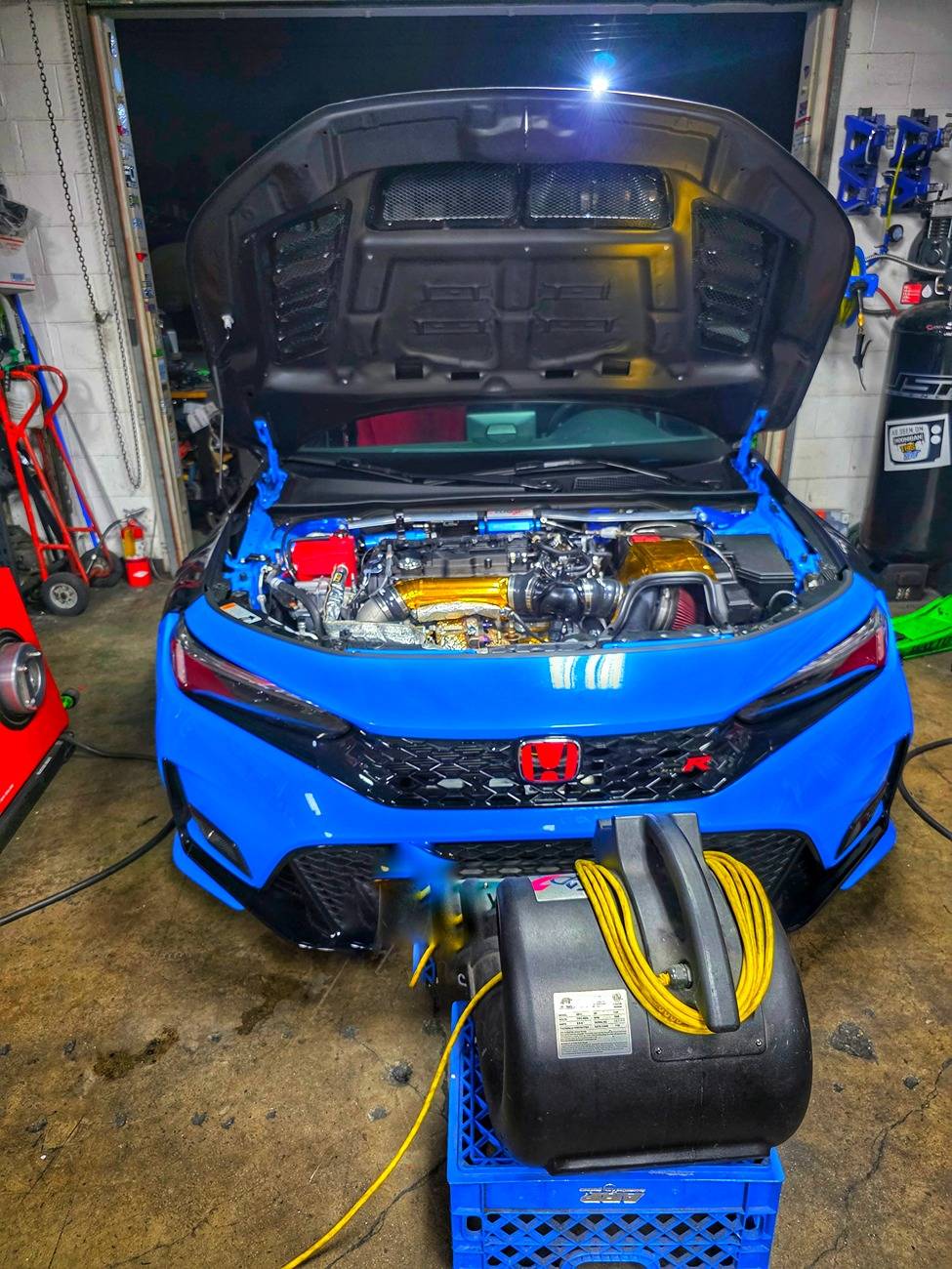

Finally installed AP racing bbk with ferodo ds1.11 brake pads. I needed wheel spacer for it to fit!
Also, installed paragon rear rotors.
Note: I've noticed that the Paragon P2 rear brake pads have the same thickness as my new R5 brake pads, even after 3-4 track days of use. During three of those days, the VSA was active. This indicates that the Paragon P2 rear pads are holding up well and aren't deteriorating quickly. In contrast, the rear stock brake pads showed uneven wear, which I believe is influenced by the Wunderladen Racing rear brake caliper bushings. It also seems that aftermarket pads generally wear more evenly compared to the stock pads.
