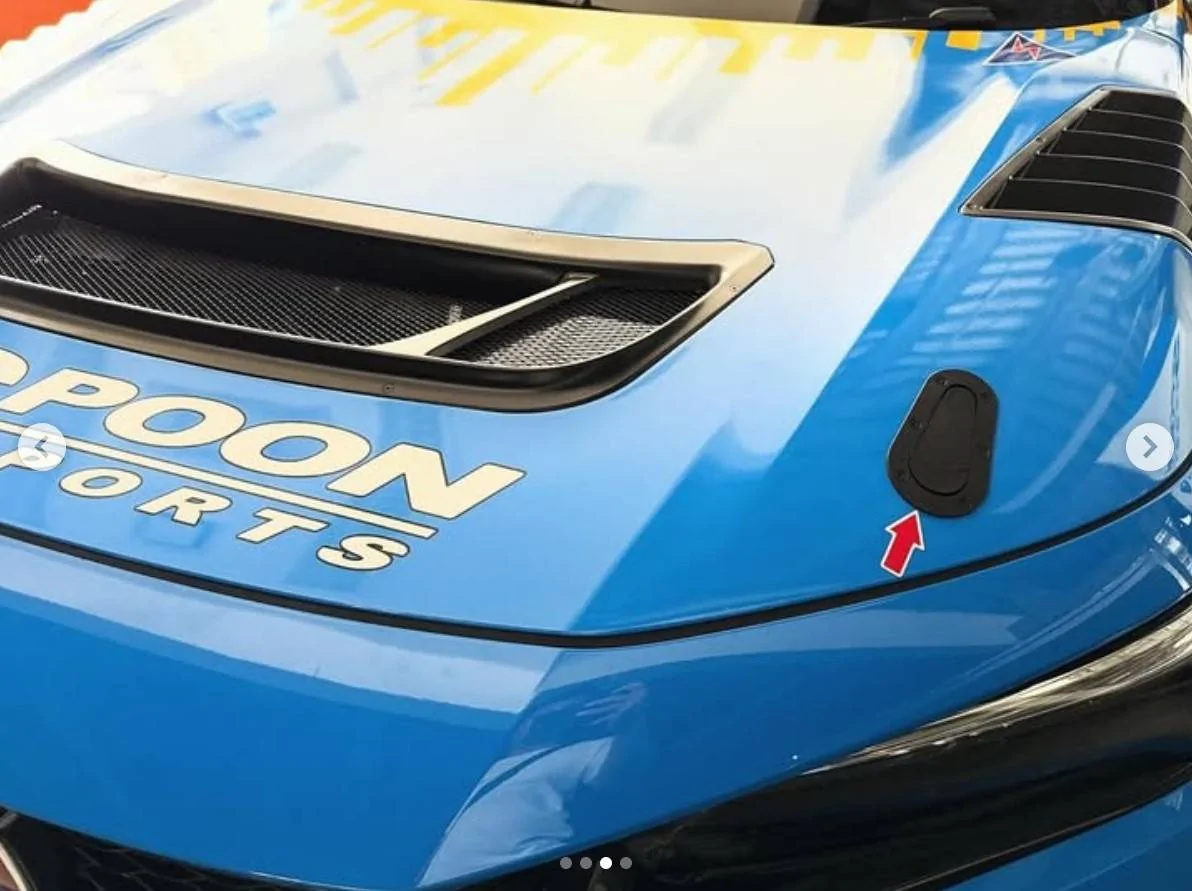

Nice build. Your cooling bonnet/hood. How effective? Do you have any data on reduction in temps? Any info appreciated. Thanks.
BuntaTypeR
BuntaTypeR
Jan 19, 2024
288
409
2024 Civic Type R, Tesla M3P, 08STi, S2k,Rsx-S

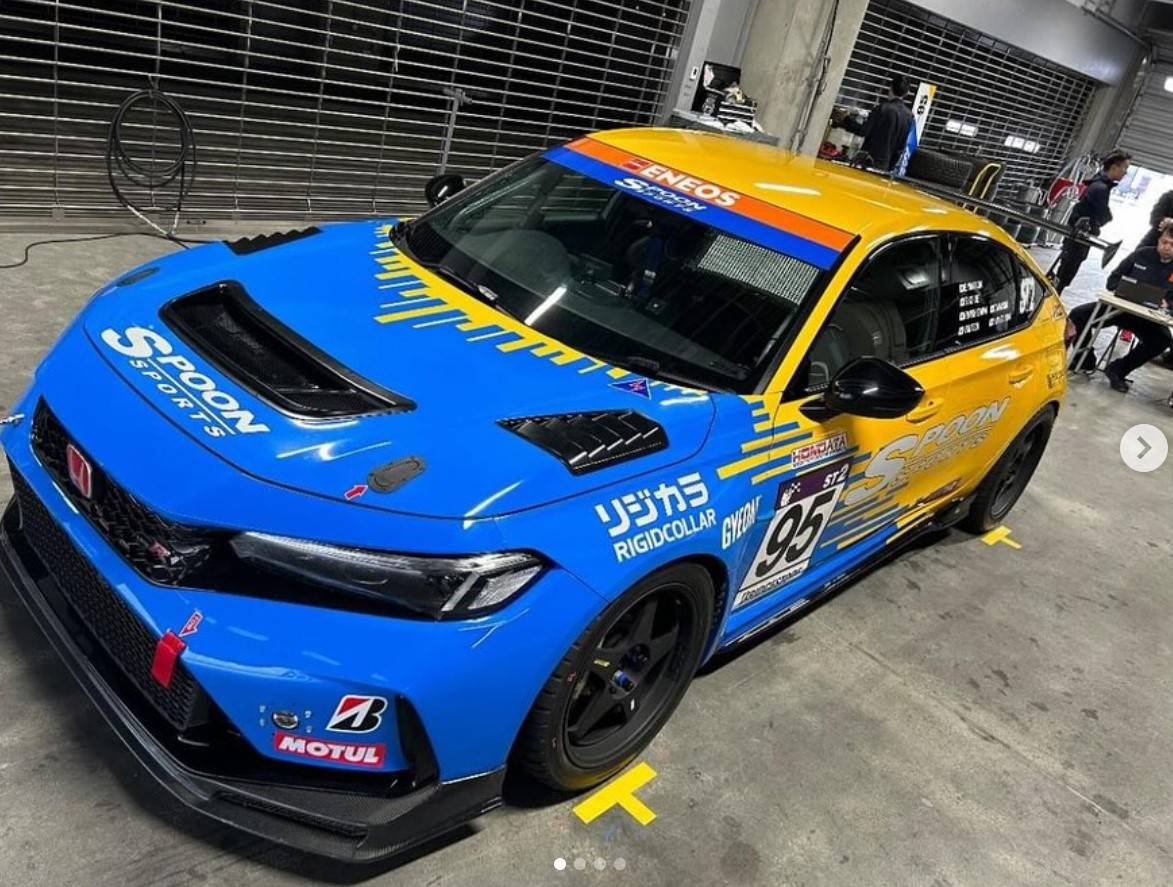

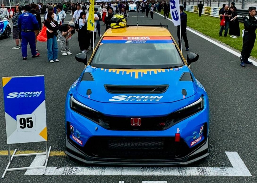

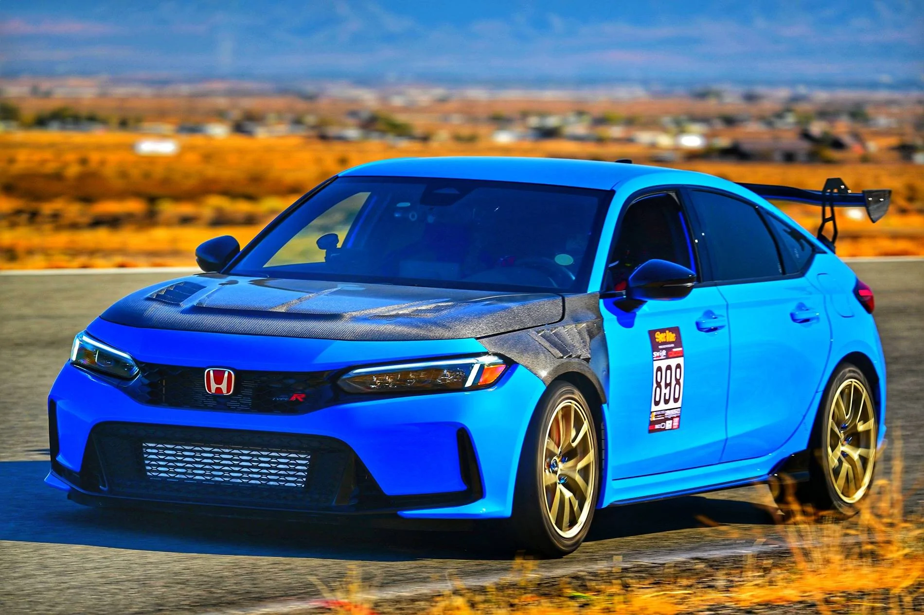

I don’t have specific technical data, but this concept is well-established in the automotive world. After my track sessions, I can feel the heat being released through the vents. Attached are images of the SpoonUSA FL5 hood. Most of my track car friends use a similar setup as well.
Hood Vents Theory:
High-Pressure Zone:
When the car is in motion, air builds up at the front of the vehicle (near the radiator or hood). This creates a high-pressure area, especially in the engine bay, where heat accumulates.
Low-Pressure Zone: Certain areas, such as just above the hood or near the fenders (depending on design), experience lower air pressure due to the aerodynamic flow over the car.
Pressure Differential: Air naturally moves from areas of high pressure to areas of low pressure, creating airflow. This principle is harnessed to extract hot air from the engine bay.
Fender Vents:
Placement:
Positioned on the sides of the front fenders, where high-pressure air inside the wheel well meets low-pressure air outside the car.
Function: Wheel wells can trap hot air and increase aerodynamic drag. Fender vents allow this hot, high-pressure air to escape into the lower-pressure zone outside the car, improving both cooling and airflow.
Additional Benefit: Lowering pressure in the wheel wells helps reduce aerodynamic lift and drag. I want to minimize front-end lift to maximize grip.
How It All Comes Together:
Engine Bay Heat Extraction:
Heat from the radiator, turbocharger, and engine rises into the engine bay. Hood vents capitalize on low-pressure zones to draw this hot air out efficiently.
Wheel Well Venting: Air and heat trapped around the brakes, tires, and suspension are expelled through fender vents, keeping these components cooler.
Aerodynamic Synergy: Both types of vents reduce turbulence and improve overall aerodynamic efficiency, which can lead to better handling and higher speeds.

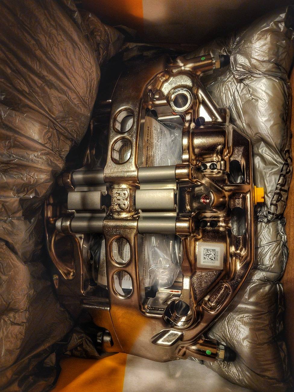

Can you weight the parts that you take off vs what you install ?
Sometimes I do, but other times I forget because I get too excited about installing the parts. If you're referring to the AP Racing brakes, I believe their website includes the weight information.
" When comparing the weight of an AP Racing brake kit on a Honda Civic Type R FL5 to the stock brakes, the AP Racing system will typically be significantly lighter, saving around 2-7 pounds of unsprung weight per axle, depending on the specific AP Racing caliper model and disc size chosen compared to the stock setup. "
