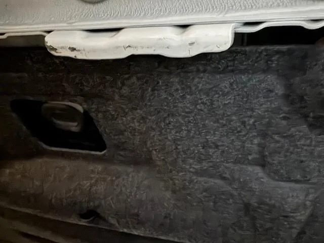

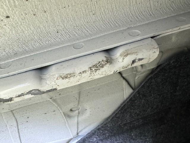

Has any one else looked at their pinch welds and been concerned about missing paint/ just looking awful? I have 400 miles on my FL5 I lifted the car once to put wheels on, and assume the car was lifted for it's inspection at the dealer, but has anyone else noticed paint chipping off of their pinch welds? I'm trying to keep this car mint for as long as possible and this is driving me crazy. Any suggestions on how to keep them from rusting/ keep them nice moving forward?
Thanks!

I'd say this is to be expected here, I've always considered it to be a normal and acceptable wear point since it is by design a tool contact point.

This is standard fare. You're placing metal on metal, there's no other outcome. If you're concerned about it I suggest using pinch weld side frame rail protectors when you jack up the car. They sell them on Amazon. Unless you never take your car to a shop you will run into this issue again when they put it up on a lift.

Ok ok! Just trying to keep it mint.. my 99 EK still has paint on the pinch welds and this thing has 400 miles! Guess its nothing to worry about lol

Yeah, if you take the car to a shop, it’s just going to happen.
If you DIY everything, all you have to so is put something strong, but softer than metal, between the jack and the pinch weld. I’ve heard of people using a small piece of wood. You can even use a folded up rag. They make rubber pucks for this sort of thing too, so obviously some people care about keeping their jack points in nice shape…just not on this forum.???

It looks like you used that weld as a lifting point...it's ok even though you will say that u didn't......lol...I don't have that problem and I've had my fl5 for a year and a half already.
