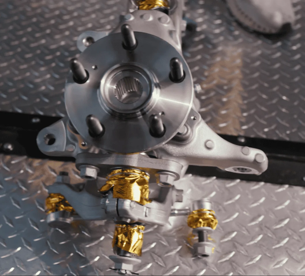

Was watching the Spoon FL5 video of their 25 hours of Thunderhill race, and they showed the front knuckle and control arm, and all exposed rubber wrapped in gold tape and what looks to be metal zip ties (same as what I do). Thought was interesting and thought of you.
I'm gonna do the same thing!
It looks like they may have used mechanics wire to hold the tape on!

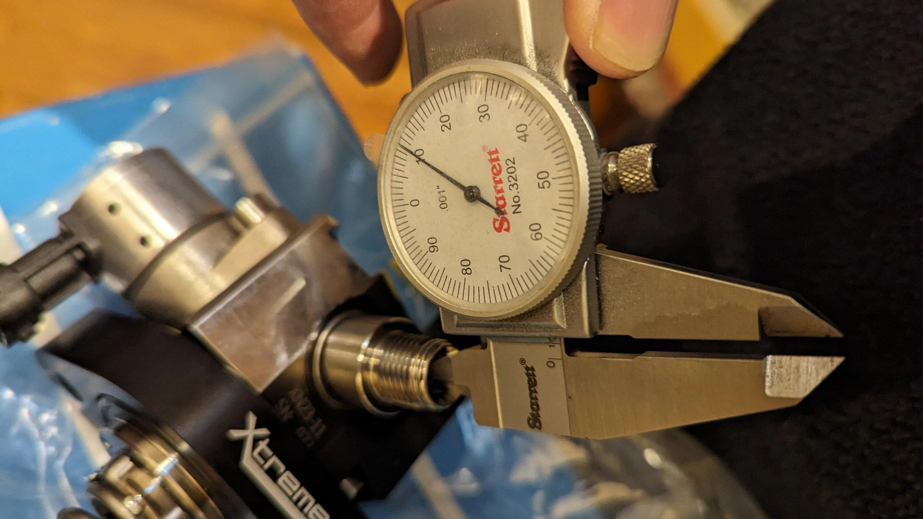

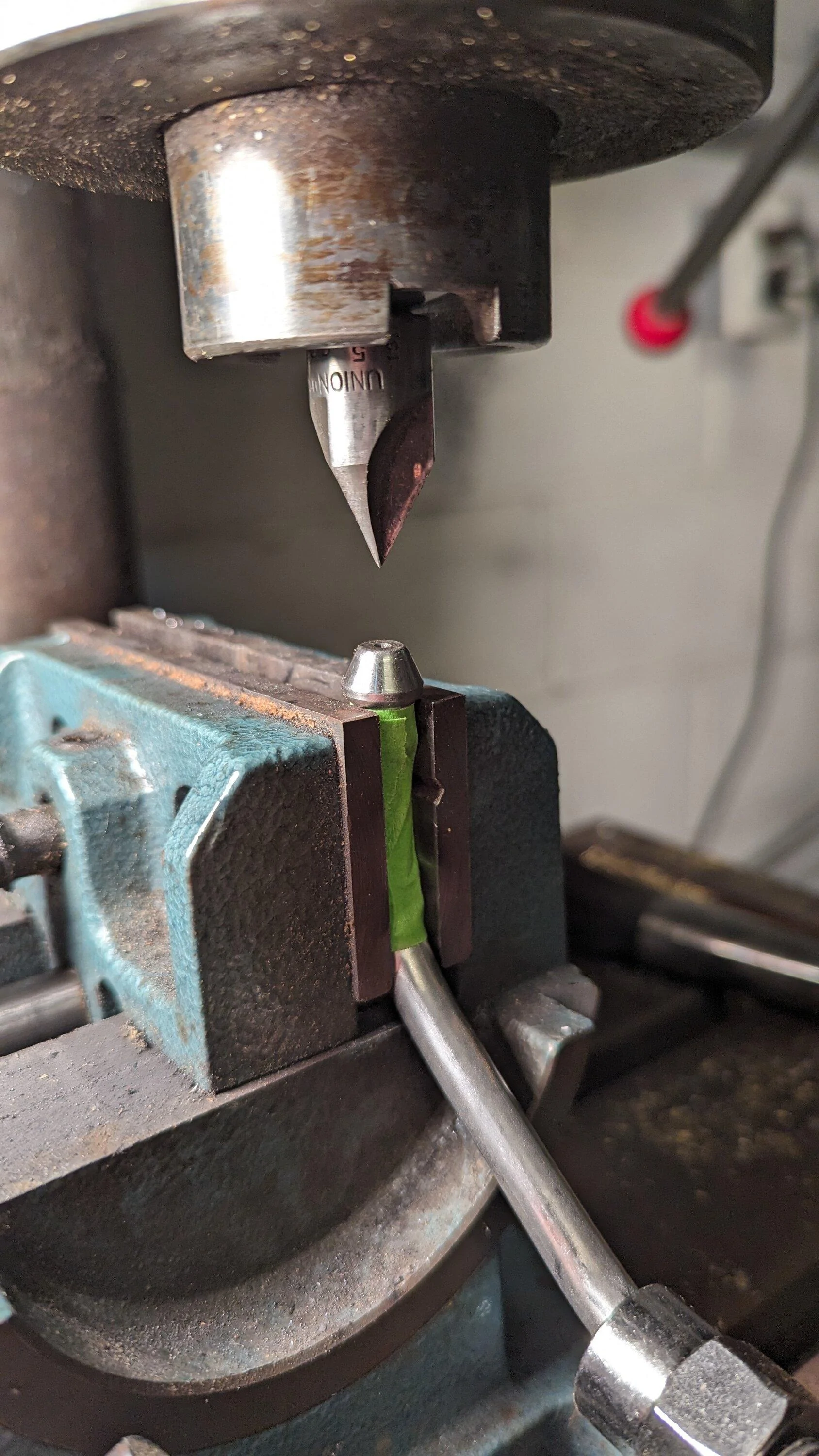

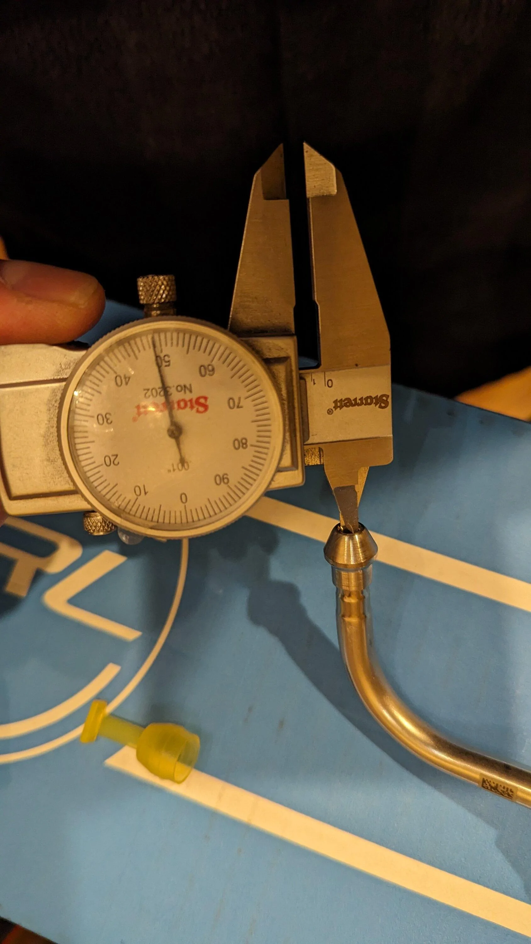

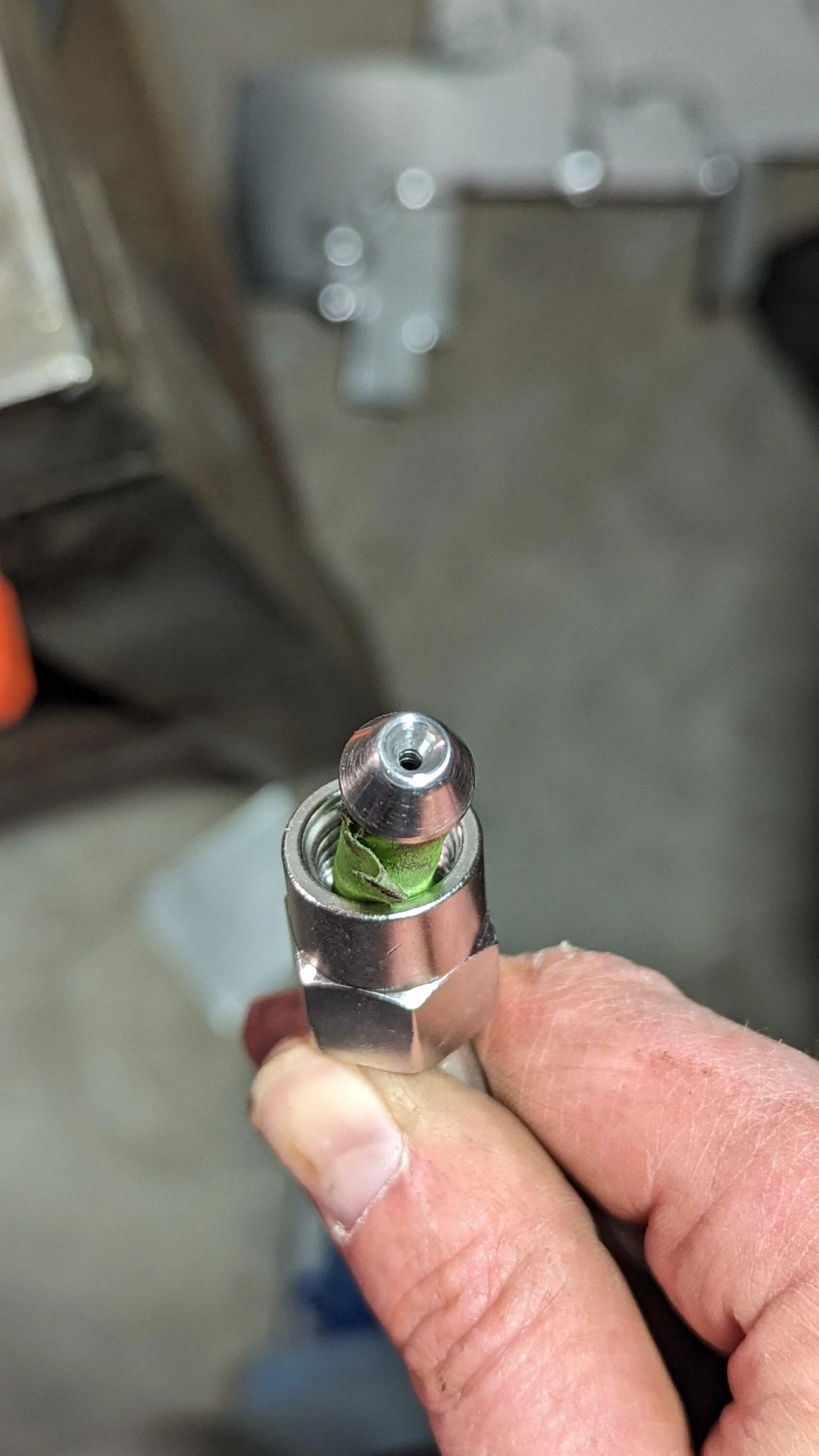

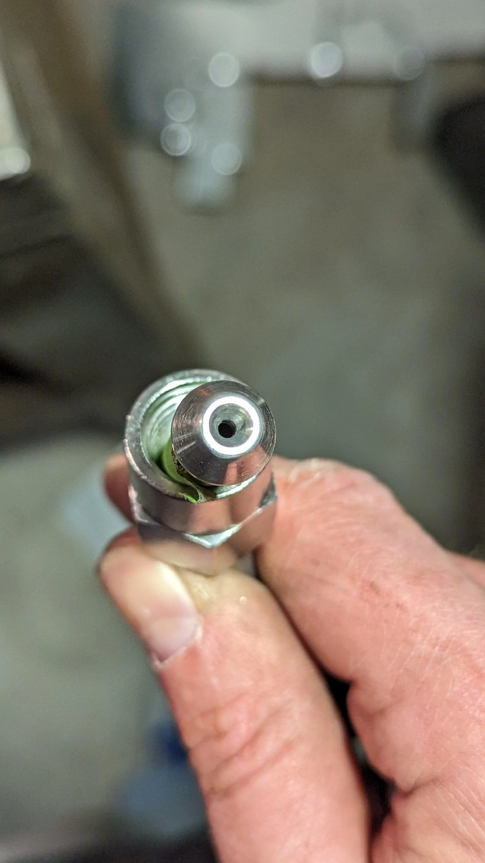

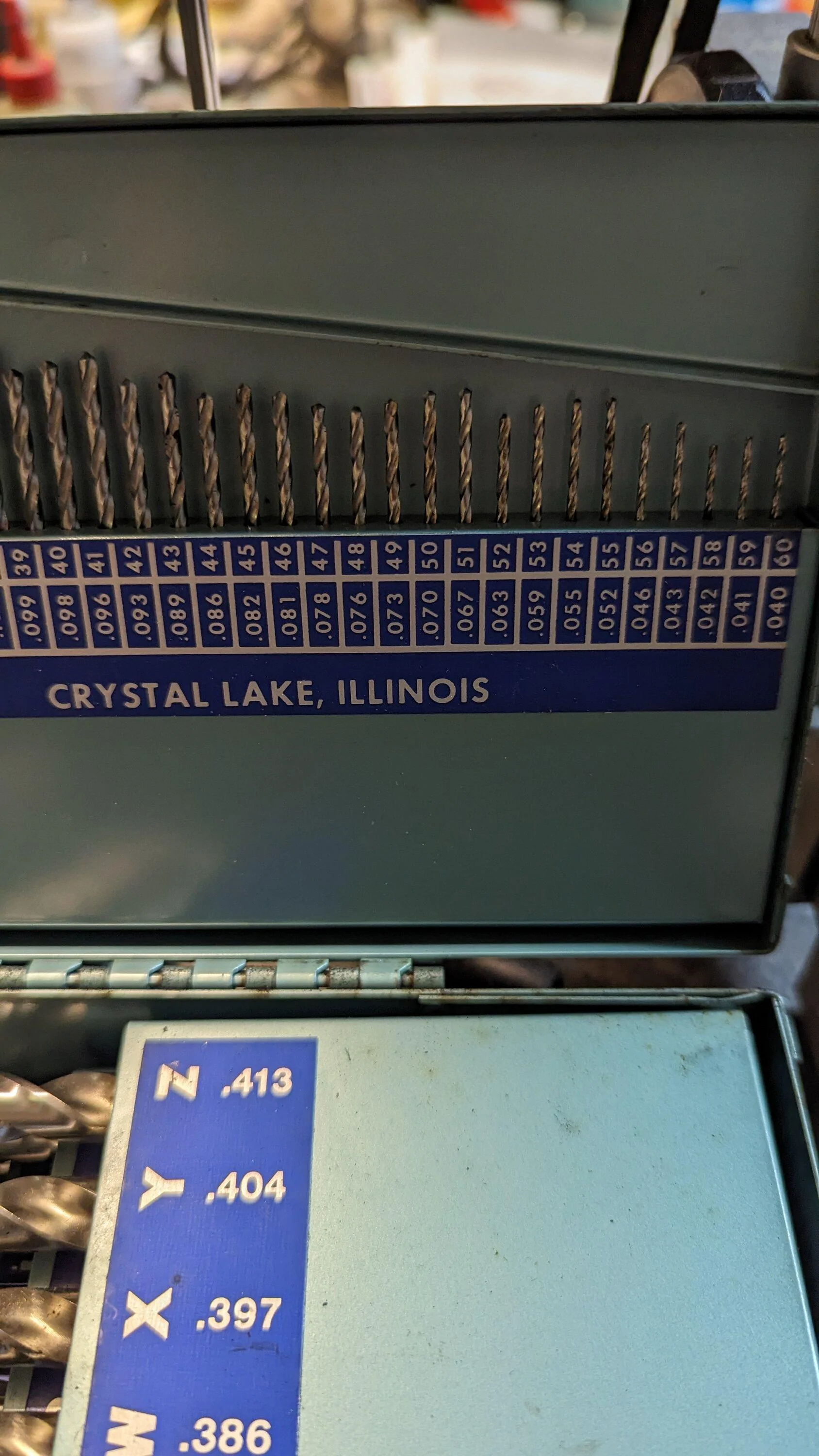

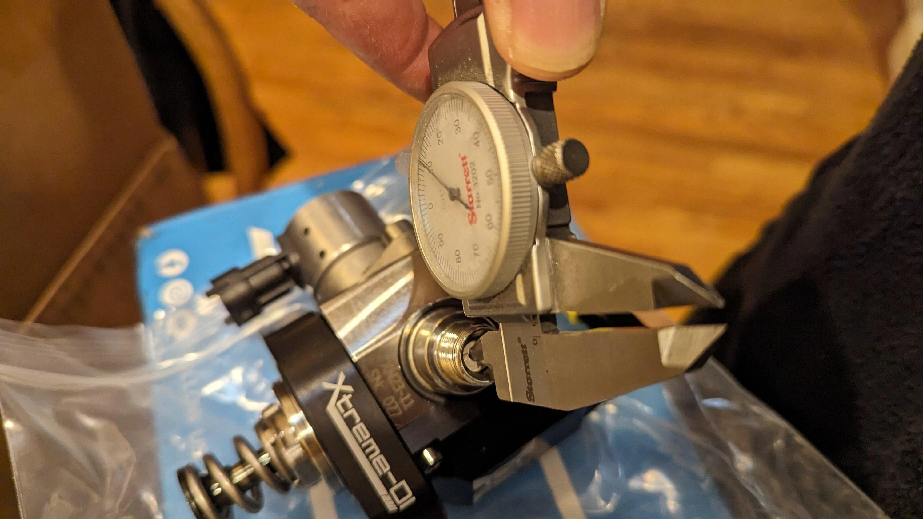

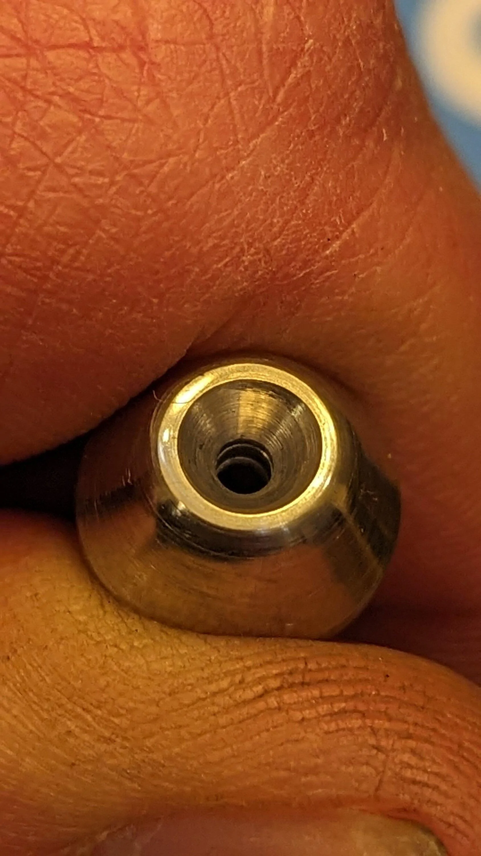

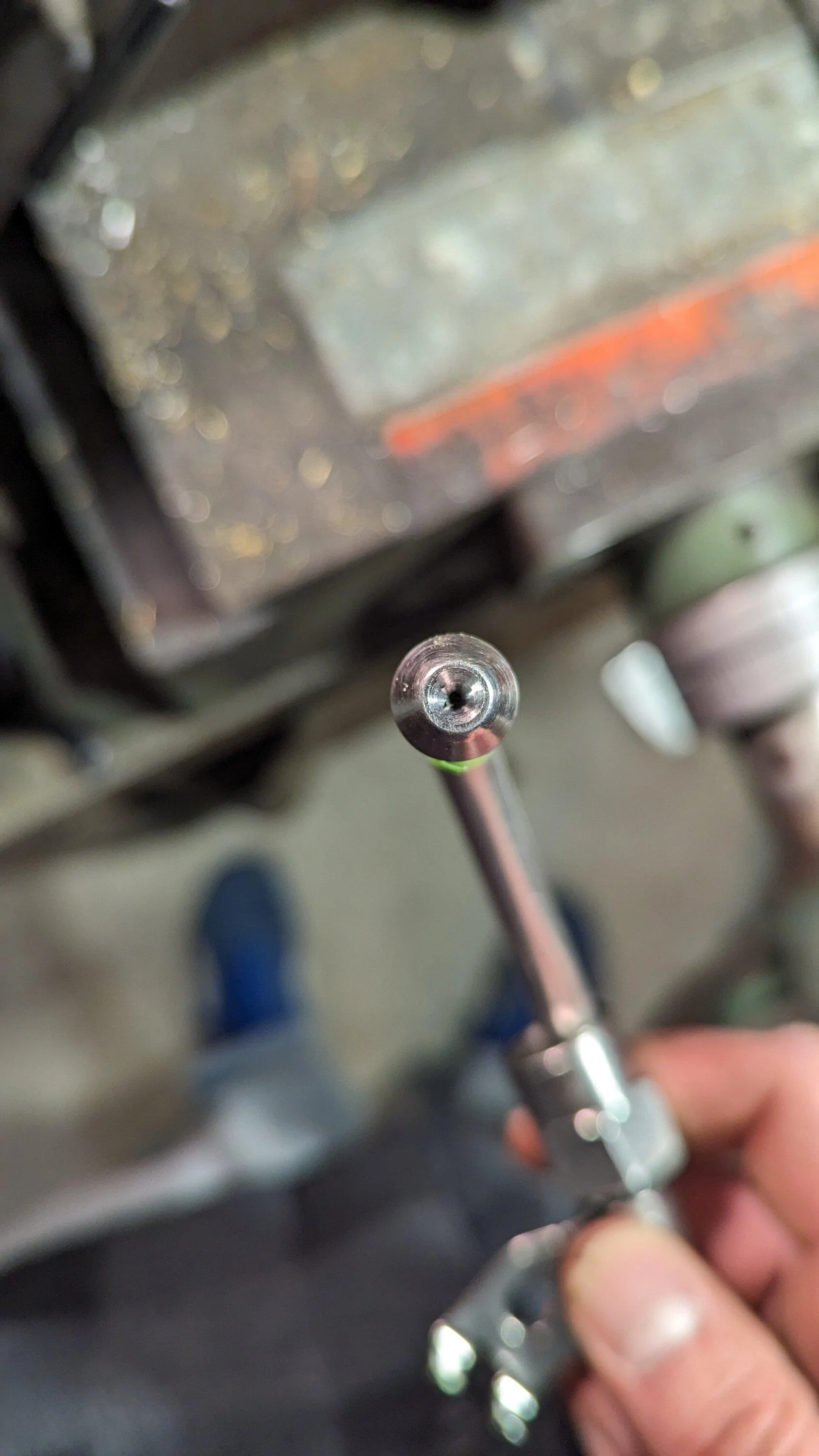

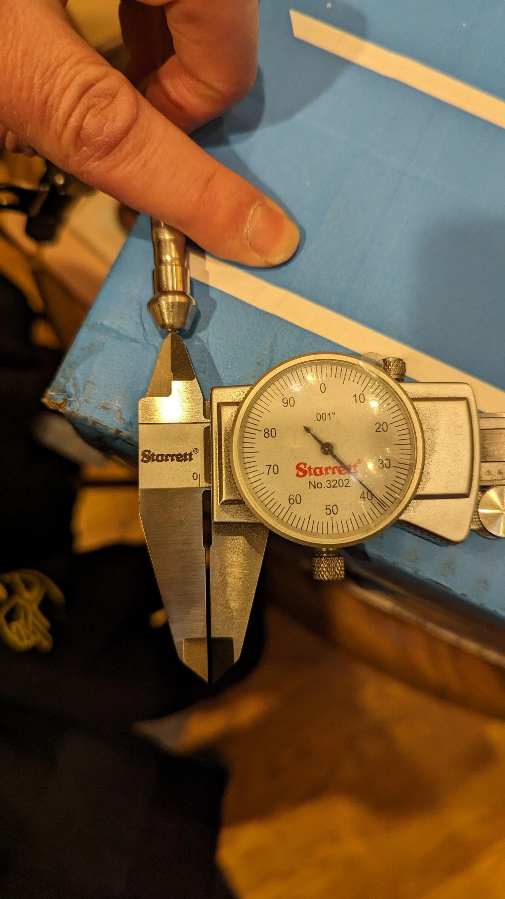

Did a little fuel line mod today! Managed to get a quadruple taper! .073-.076-.078-60° countersink to 82° countersink. Needle file deburr in the smallest sections, then polished the out lip to 1500 grit @Jester04 will be the guinea pig!
11th Gen Honda Civic PointByPatrol #21985 Build Journal! RIP #9243 PXL_20240309_161126606
11th Gen Honda Civic PointByPatrol #21985 Build Journal! RIP #9243 PXL_20240309_161139666
11th Gen Honda Civic PointByPatrol #21985 Build Journal! RIP #9243 PXL_20240309_161247212
11th Gen Honda Civic PointByPatrol #21985 Build Journal! RIP #9243 PXL_20240309_161342382
11th Gen Honda Civic PointByPatrol #21985 Build Journal! RIP #9243 PXL_20240309_162424149
11th Gen Honda Civic PointByPatrol #21985 Build Journal! RIP #9243 PXL_20240309_165808477
11th Gen Honda Civic PointByPatrol #21985 Build Journal! RIP #9243 PXL_20240309_172001587
11th Gen Honda Civic PointByPatrol #21985 Build Journal! RIP #9243 PXL_20240309_175818173
11th Gen Honda Civic PointByPatrol #21985 Build Journal! RIP #9243 PXL_20240309_175828447
I think I’m going to change my username to guinea pig?.
