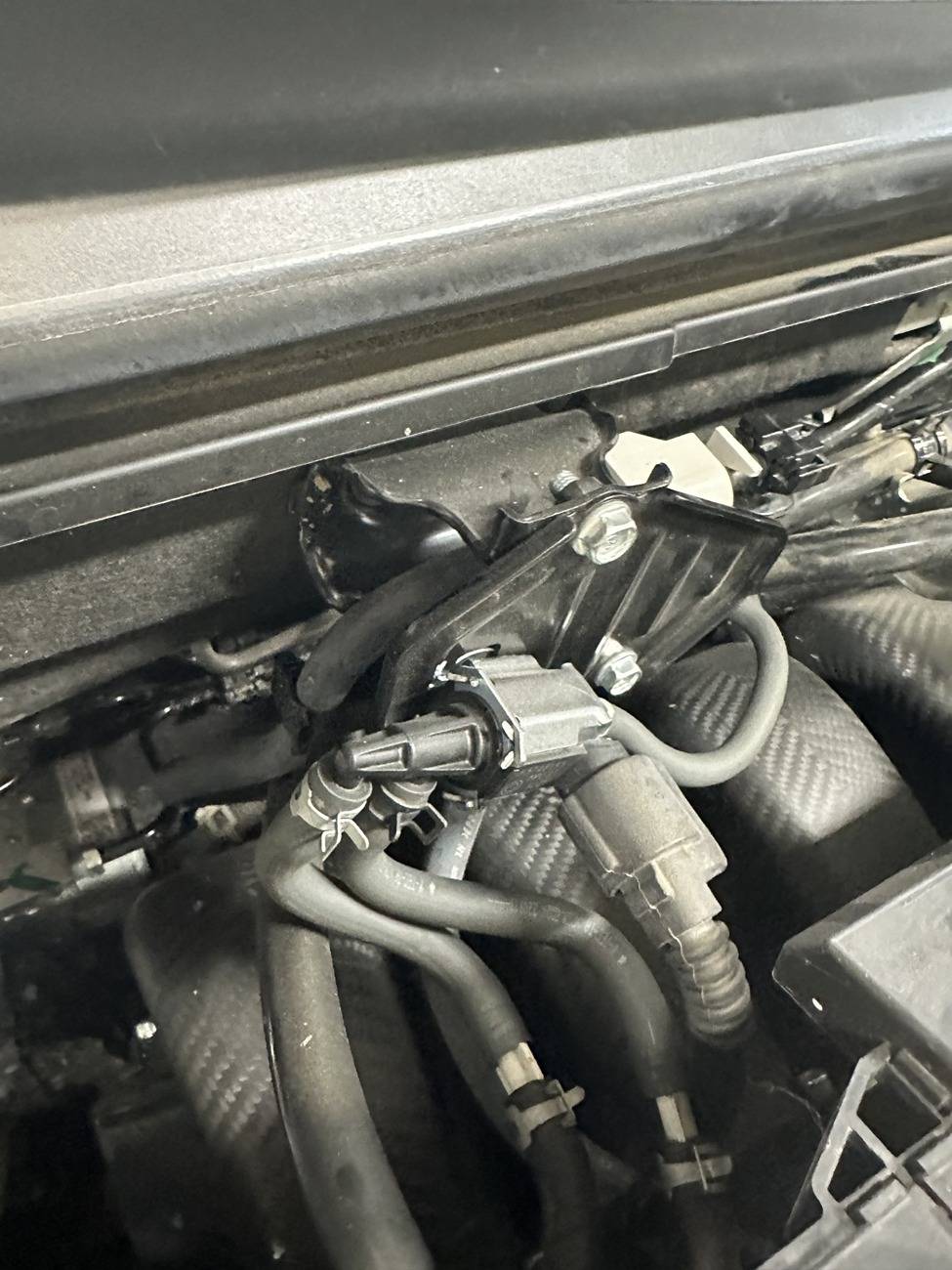

I'll hit you up for a basemap with Canflex activated then finish 91 tuning before the E85. I noticed something that I believe might be different between the FL5 and DE5. I have something attached to my outer fuel bracket and I noticed the new Hondata bracket doesn't have a place to attach it. After viewing pics of the FL5 engine bay, I don't see this piece attached to the outer bracket like it is on mine. Maybe this is something specific to the DE5. I know that description sucked lol so I attached a picture....

Hey, did your outer fuel bracket have this attached to it (see pic)? I have a Type S and I am wondering if my fuel bracket set up is a little different. Not sure where to reattach this thing. I figure worst case scenario I can zip tie it to something.

? You have the Pracworks carbonfiber intake manifold.
That solenoid is not in the factory location on either FL5 or DE5

ahhhhh shit :doh:. Yes sir I do ha ha ha. Time to find a new home for the solenoid. It's just never easy ha ha

Yeah this is just because of the manifold. Just relocate or make a bracket for it.
