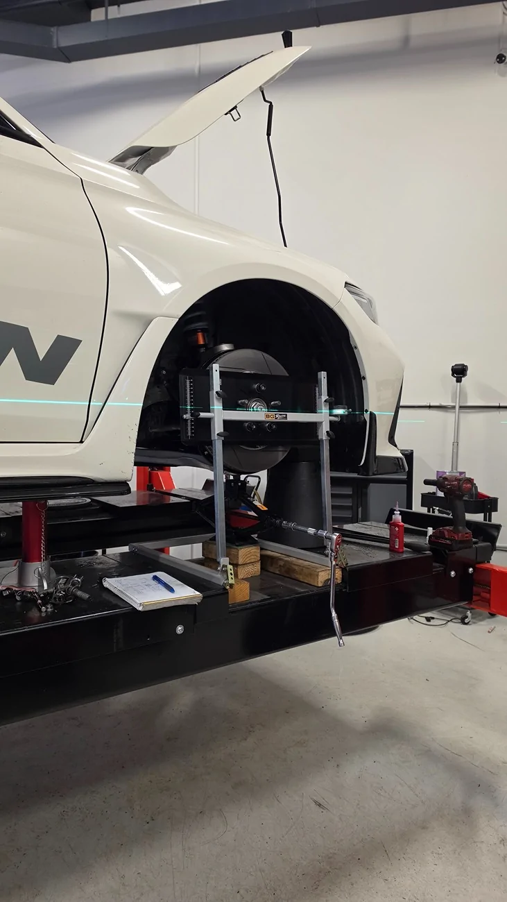

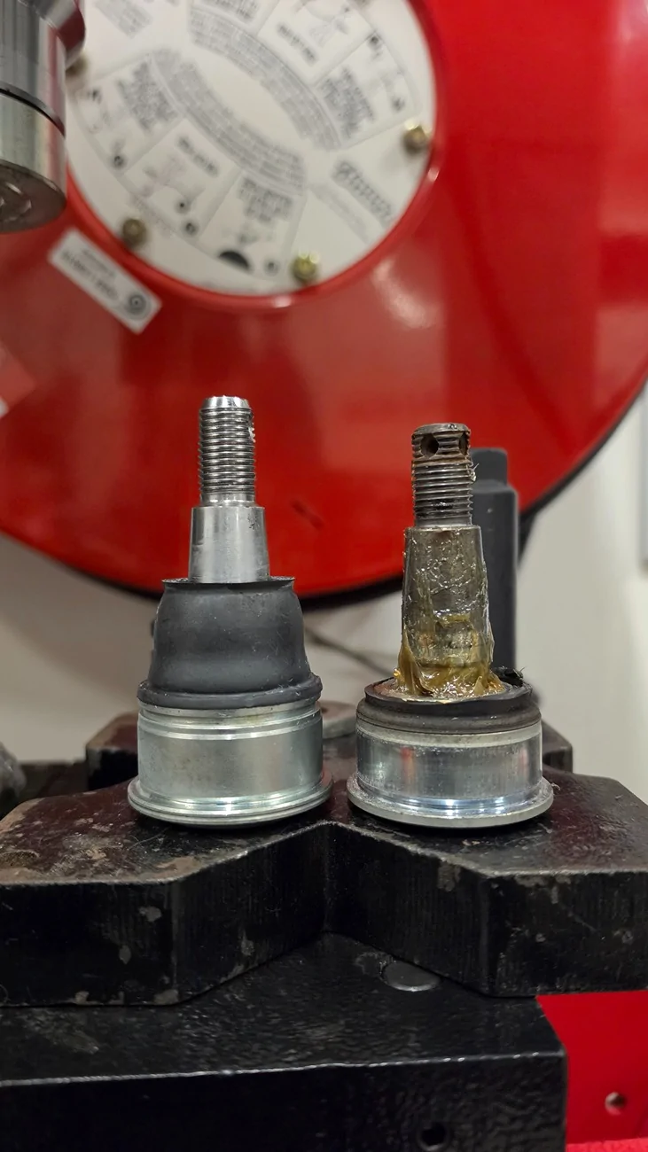

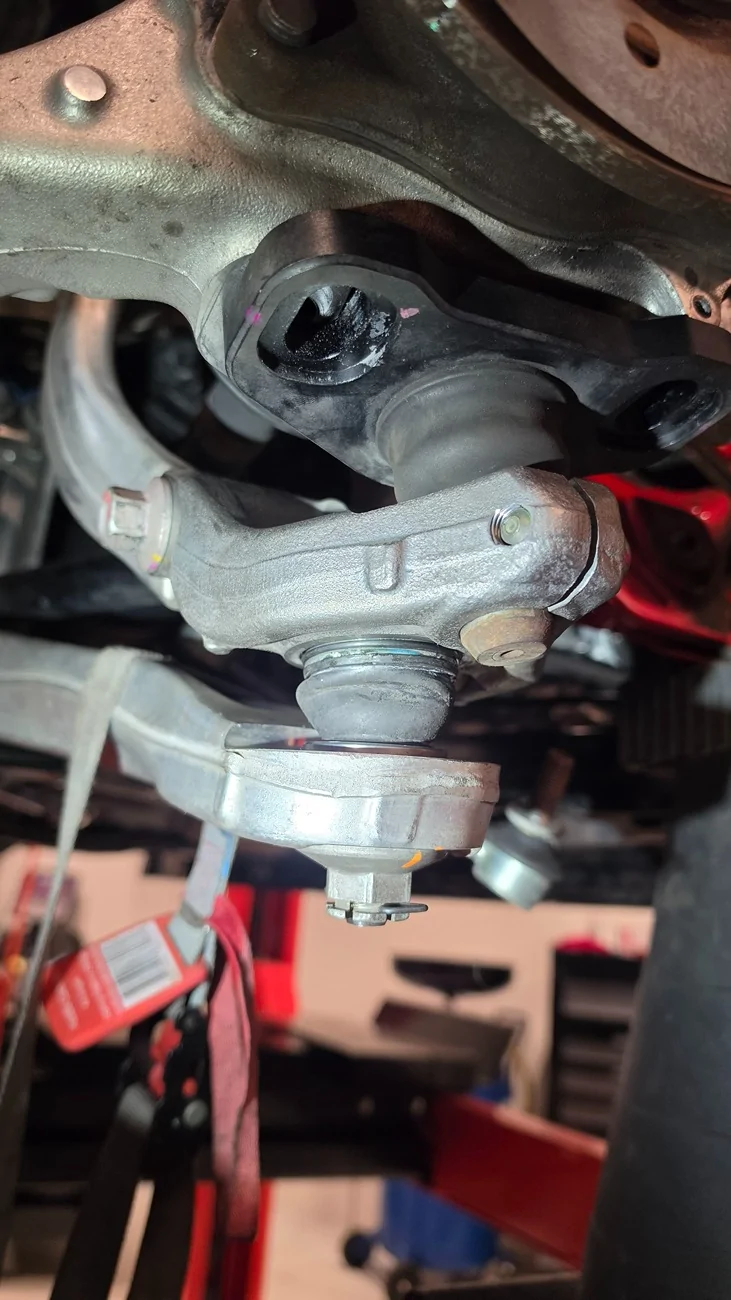

Pretty close to eliminated all the bump steer out of the front axle by maxing out the caster angle afforded by the AST strut tops 👌
Additionally, the Spoon Zero Bump steer ball joint does work for the FL5 (always listed as FK8 on most websites).
From my toe mapping, it reduces toe in from static (-15mm from OEM) ride height to full droop (+50mm from static). From static to full bump (measured up to -30mm from static ride height) I saw very little difference. Does depend on a host of other factors so YMMV.

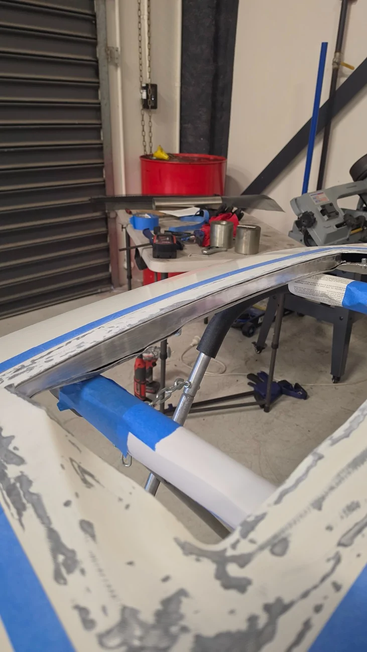

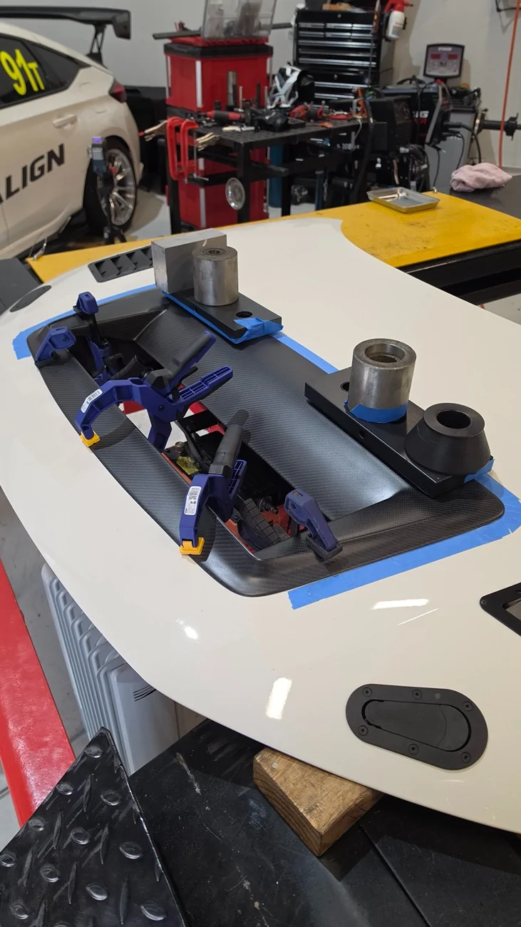

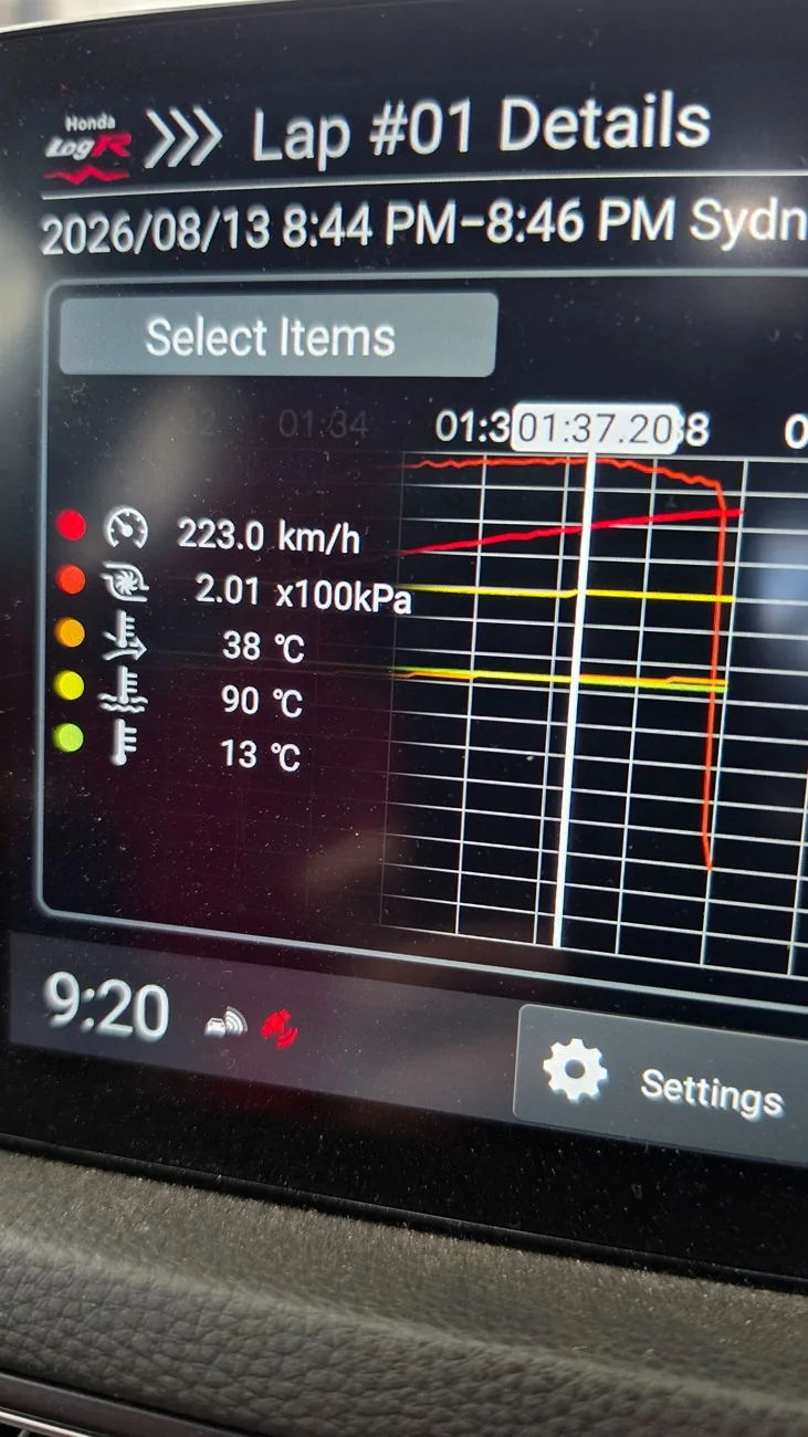

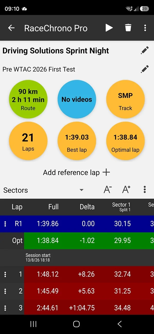

Successful test session completed.
PB posted on old tyres and not full ethanol.
Data showing ECT never exceeding 90°C/194°F even at full noise on the second run of the main straight, hitting 238kph/147mph at around 500hp.
This is with an OEM radiator mind you.
Hope to prove that the cooling mods out on the market are unnecessary if you manage airflow, properly ducting and blocking off the gaps in the grille/radiator support/bumper areas, and providing a clear exit path for the air flow avoid stagnation in the engine bay. Coupled with good tuning, no lean spool etc
Some tweaks to the car taking place for the next two weeks.
Looking forward to WTAC 2026.

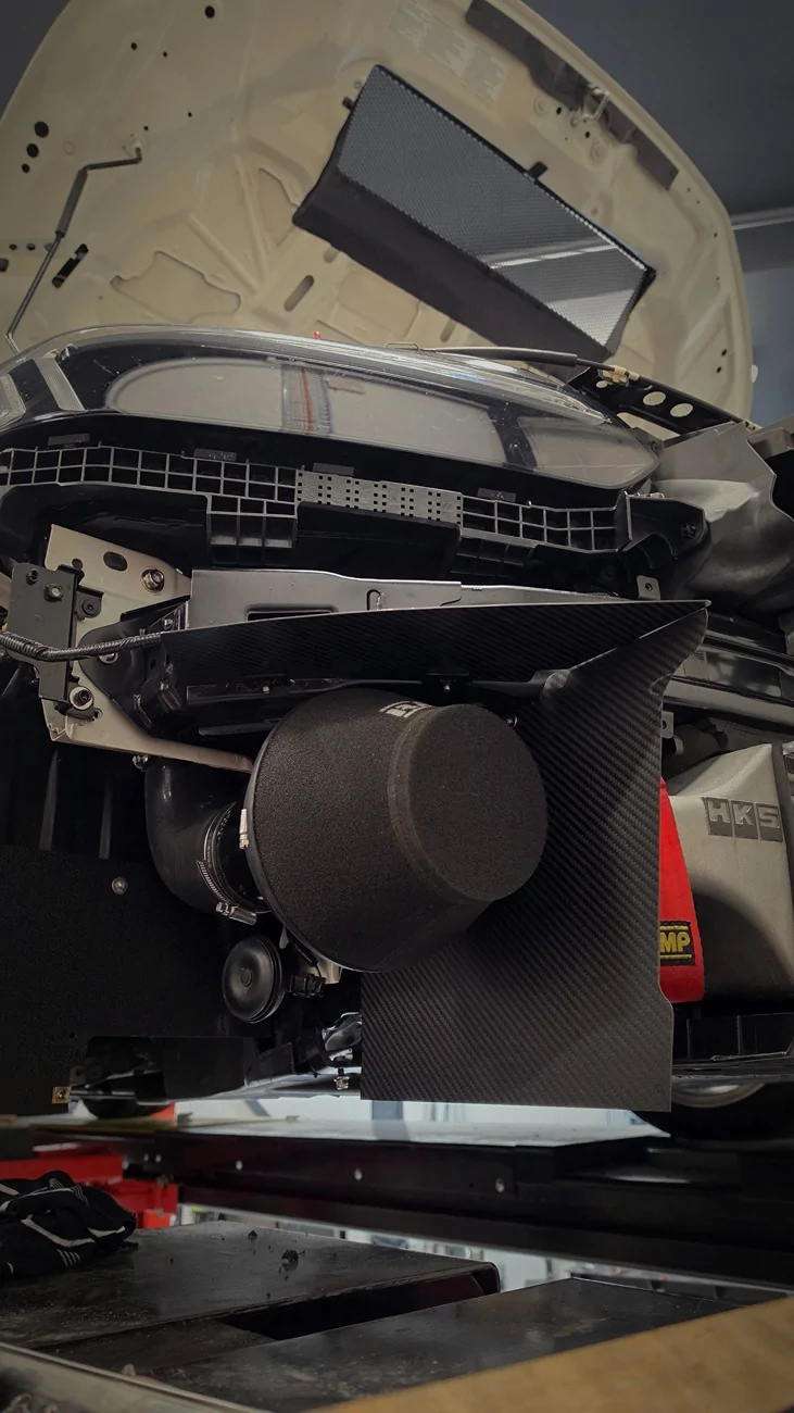

Check out post #71 in this thread where I detail some of it. There are a lot of gaps and inefficiencies in the OEM set up. The main killer is the absolutely huge gap between the side of the radiator and the CFRFP support panel, it's around 20mm either side, which if left uncovered is simply allowing large volume of airflow to do nothing but increase under hood pressures further reducing air volume going through the heat exchangers.
