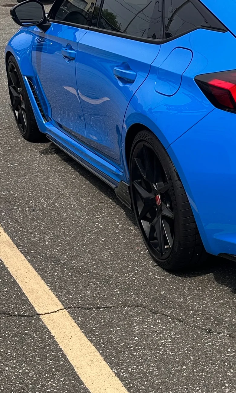

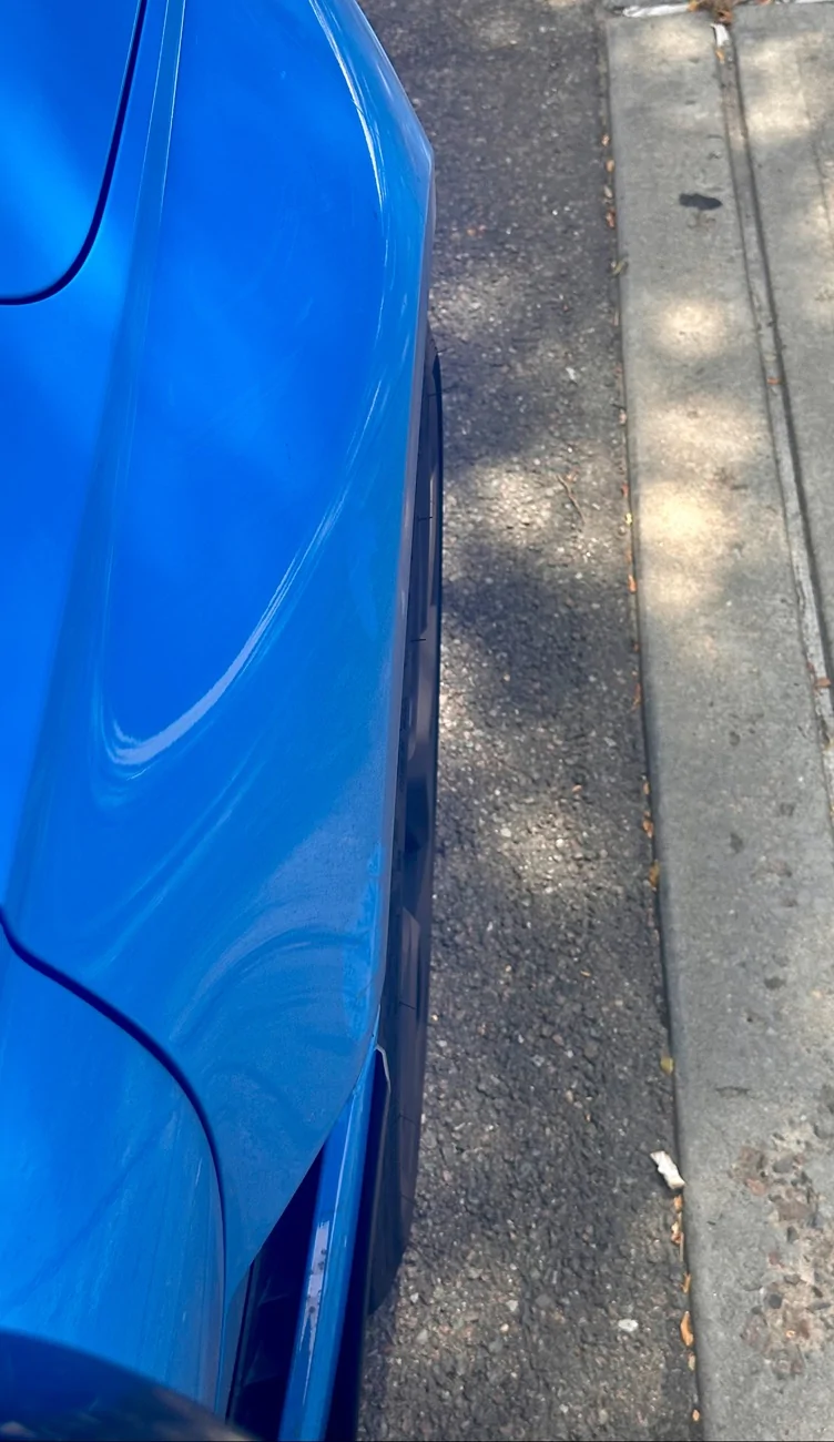

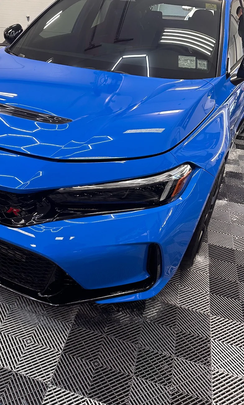

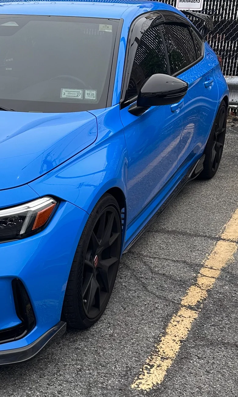

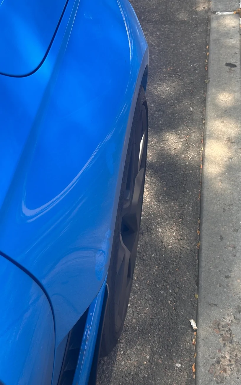

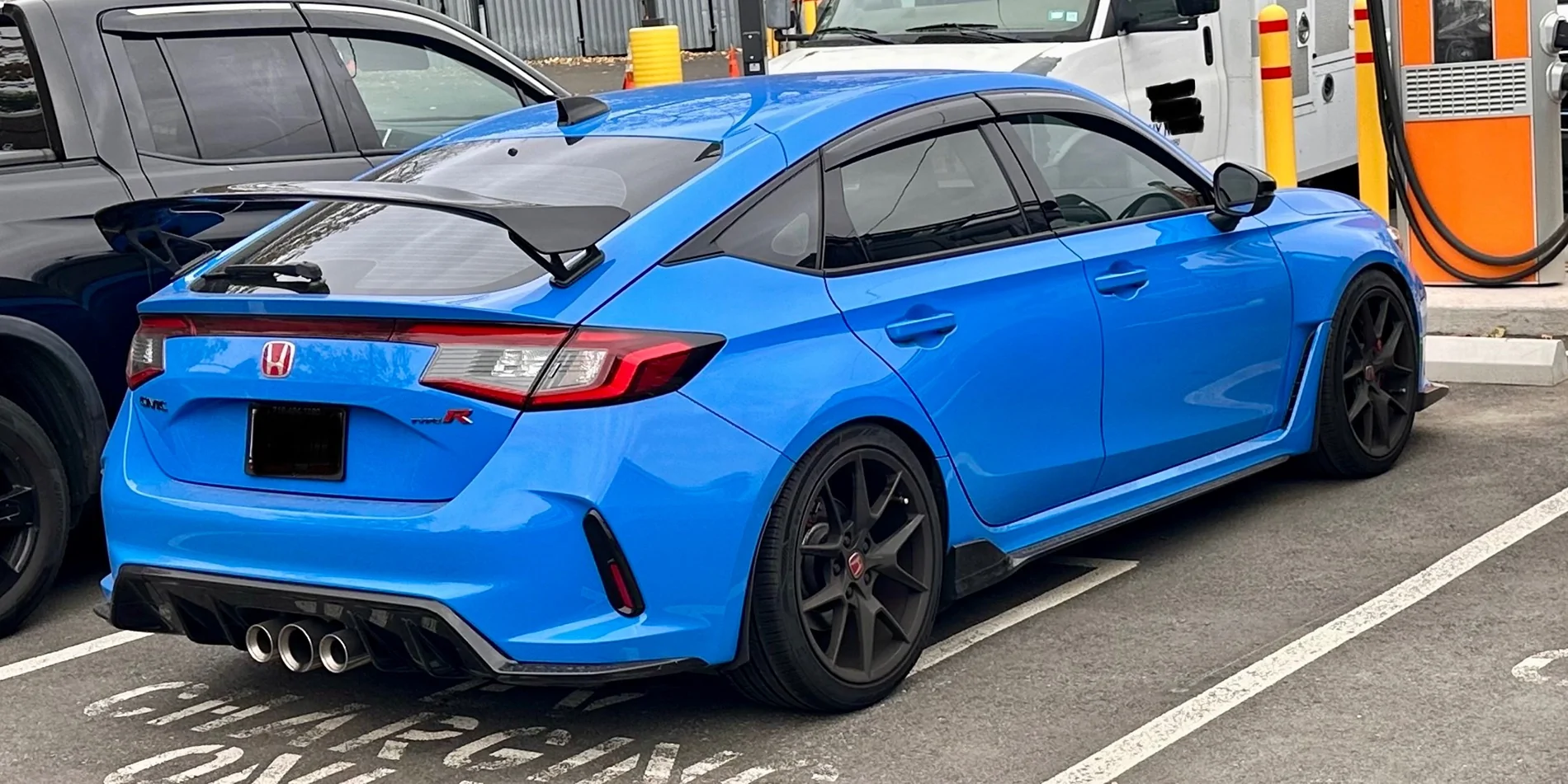

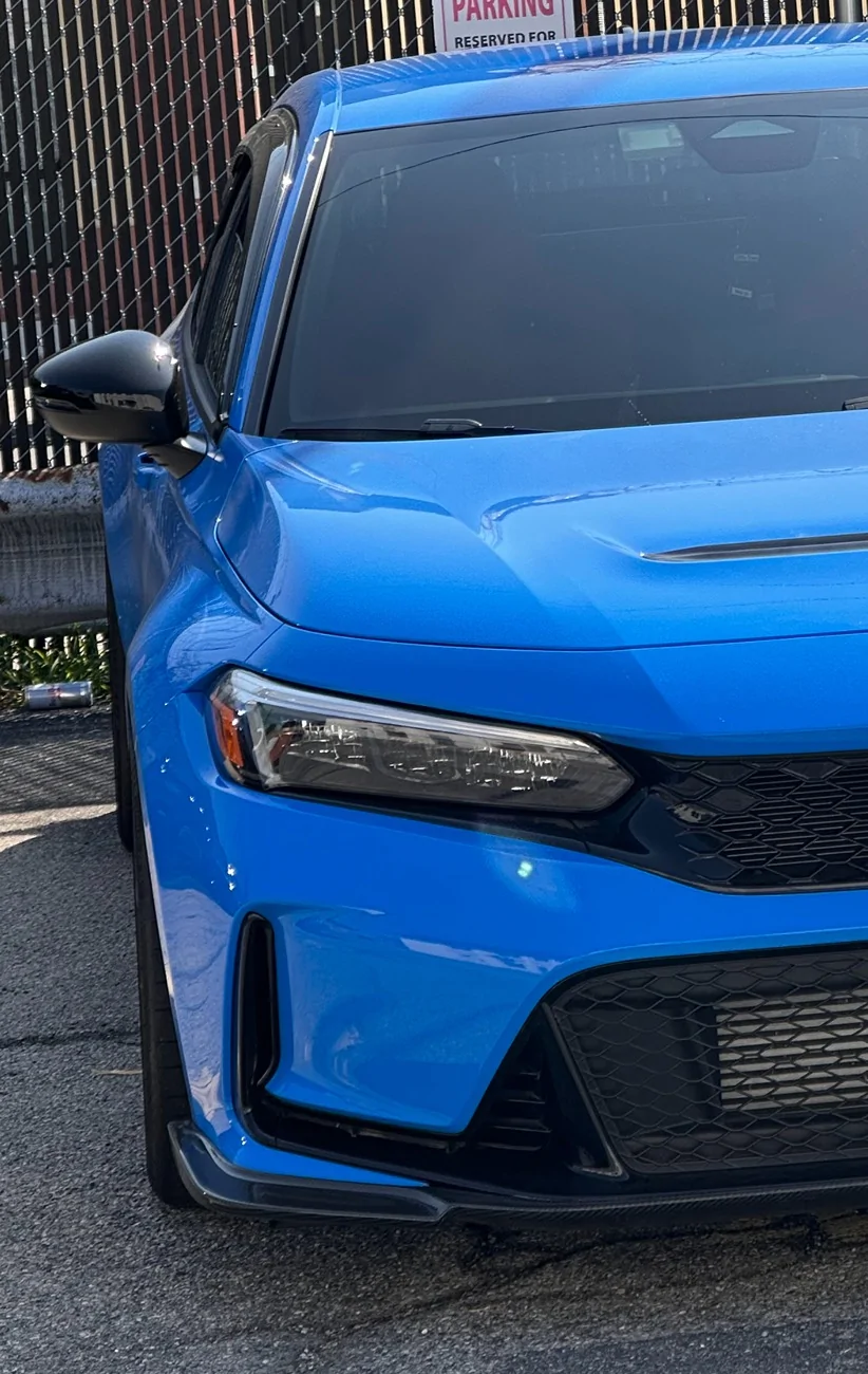

Here i’ll show you what i mean. I’m running Bonos 15mm spaces all around. On a .75” drop in the front and from the top View look how flush my tire and rim sits to the fender. Excuse the dirtiness

Cool. I totally get it but to my eye you are still tucked front and rear. We clearly just have a different ideal level of "flushness". All good man. Car looks great enjoy it ! Go pinstripes !

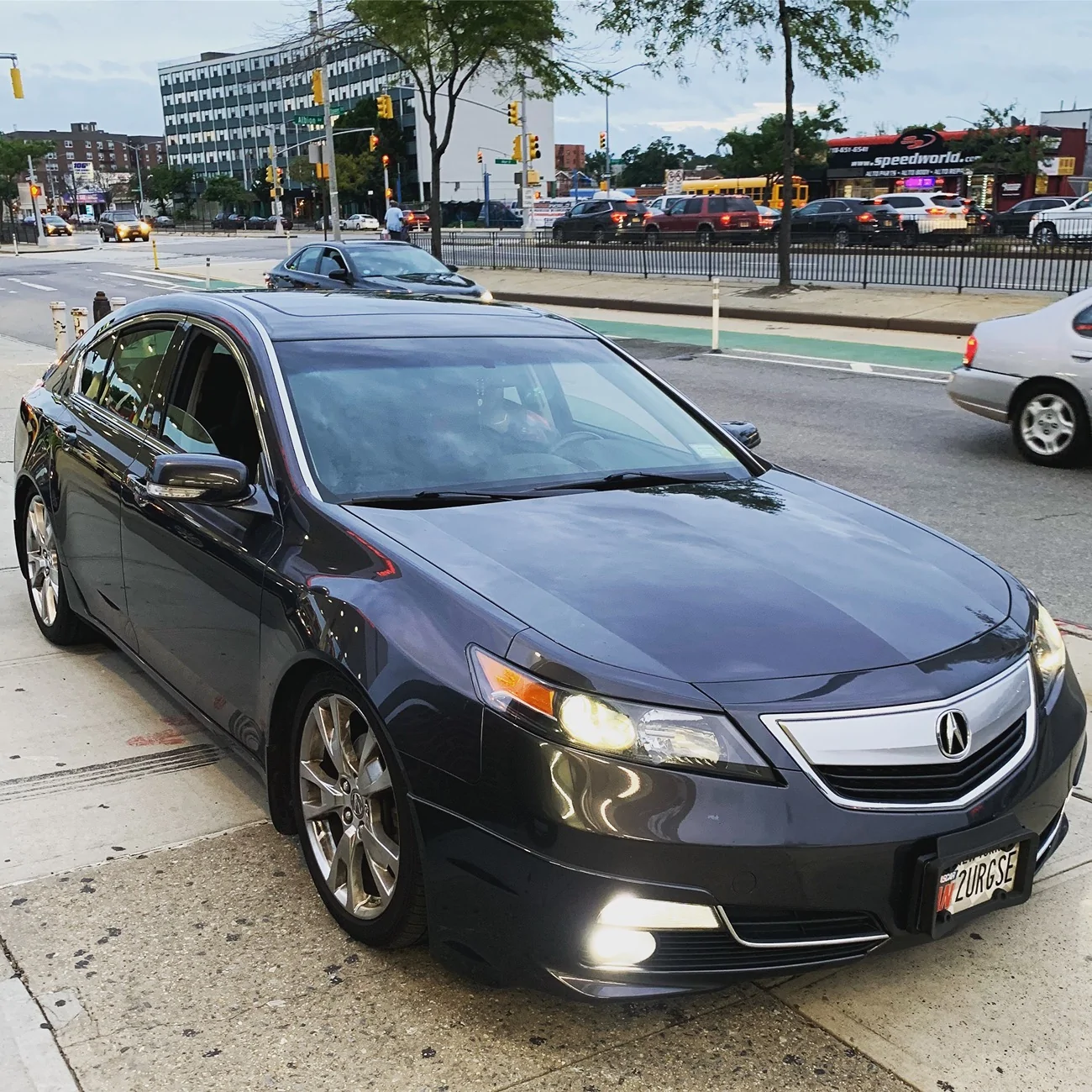

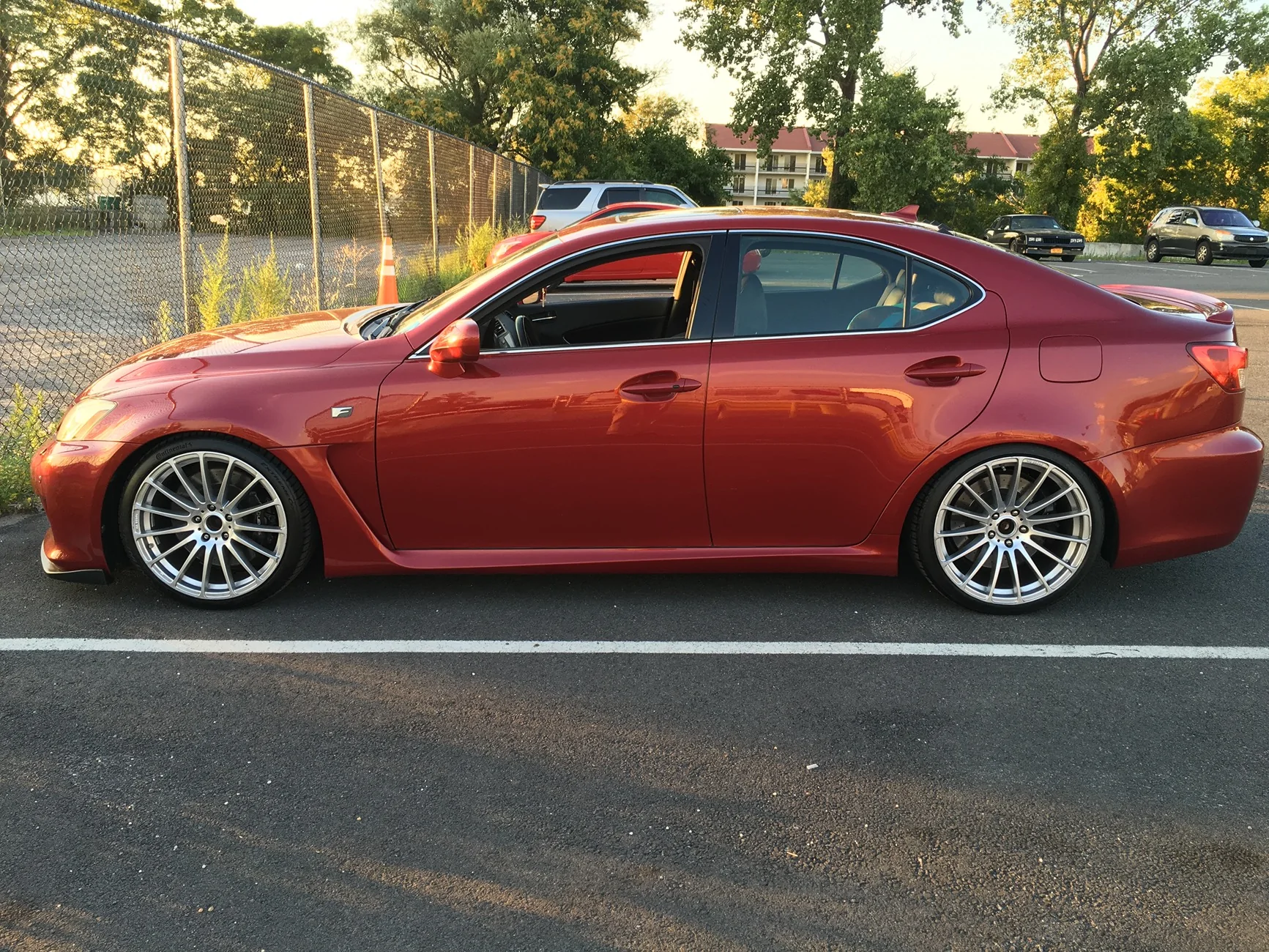

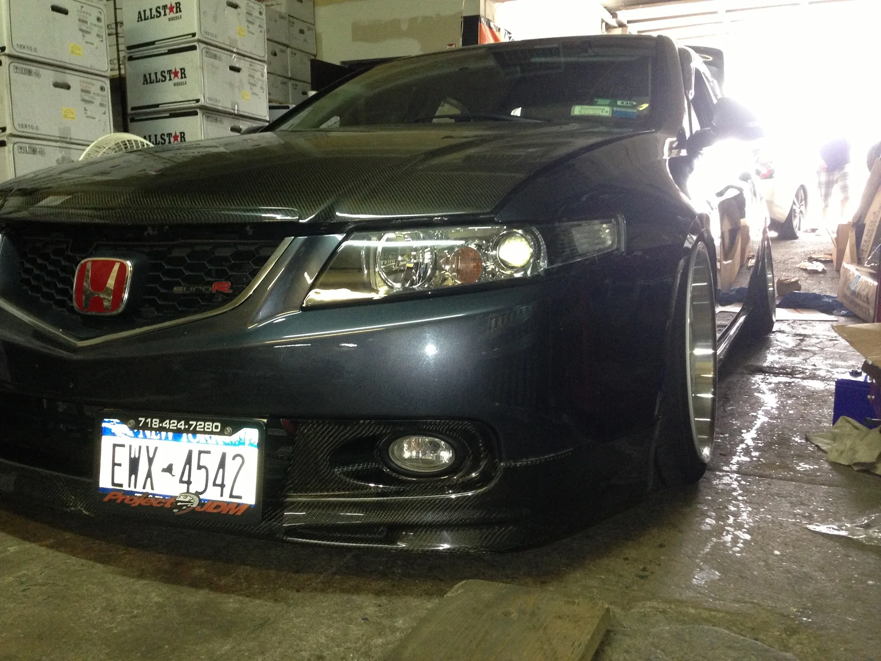

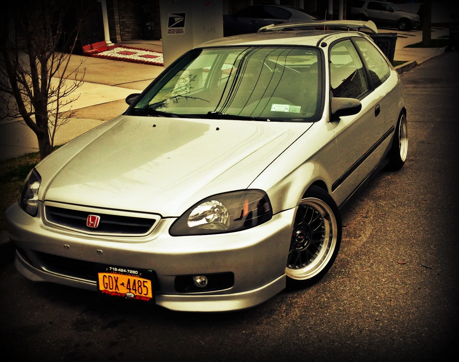

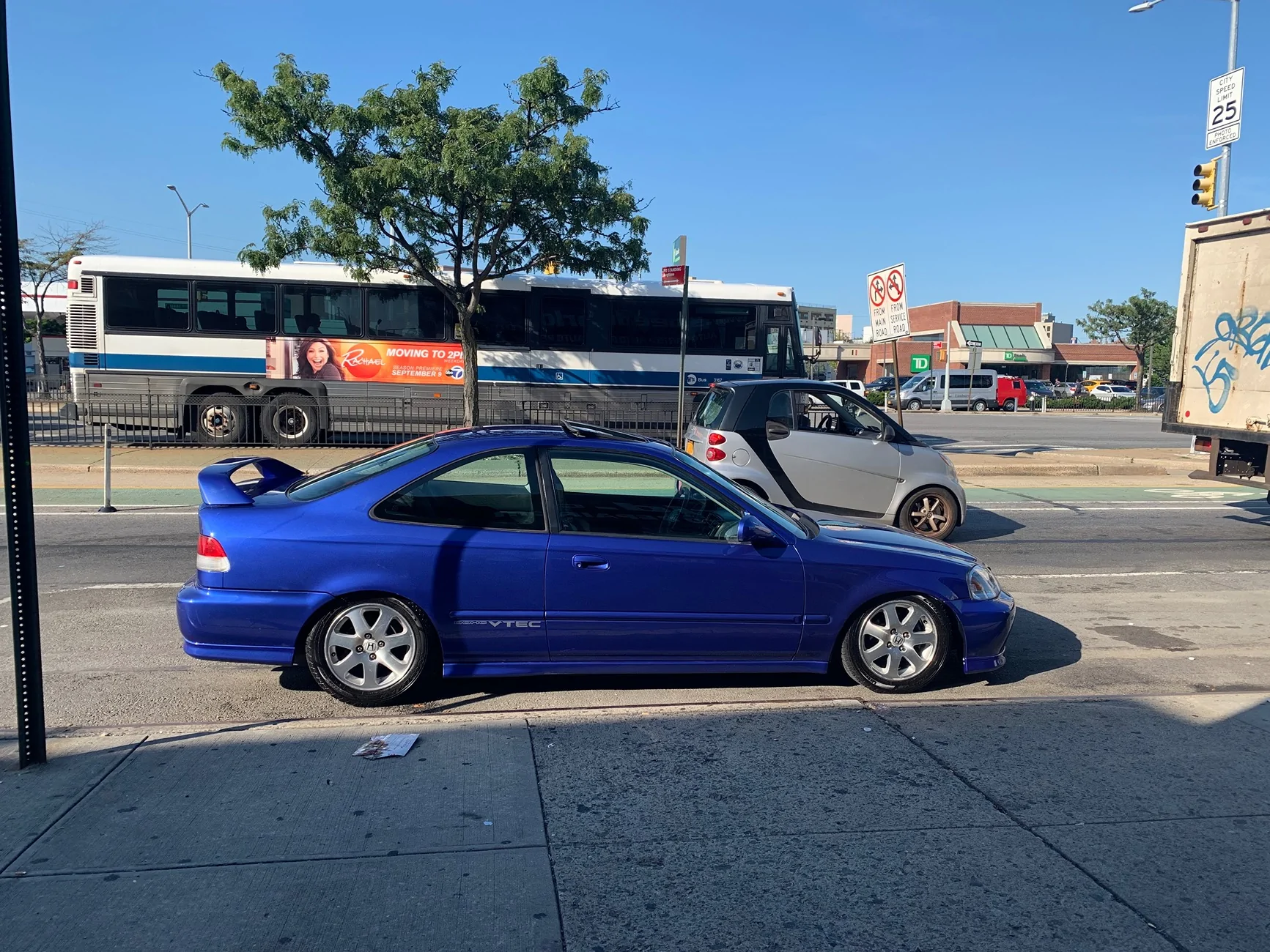

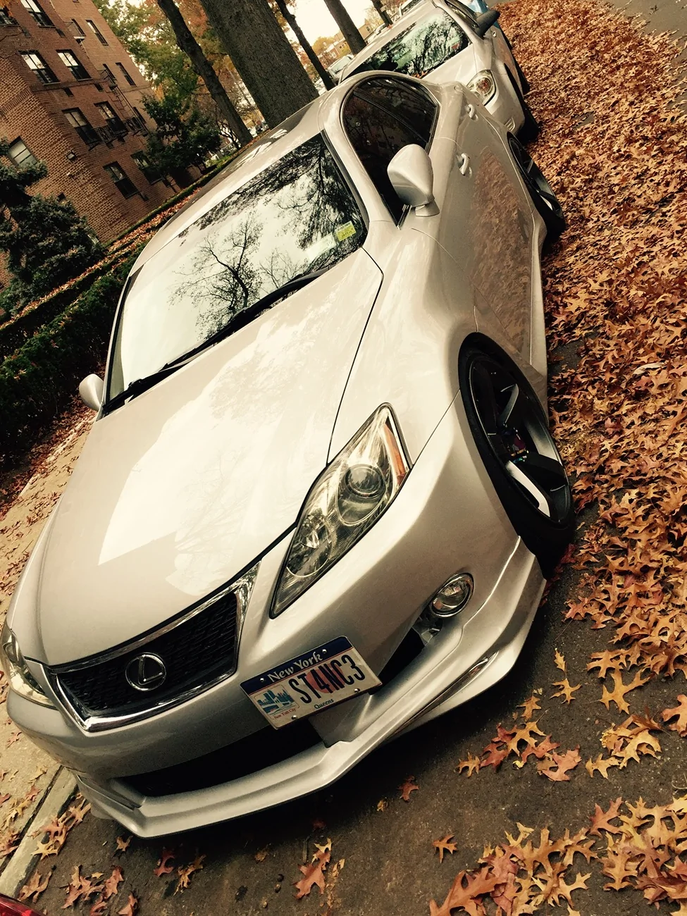

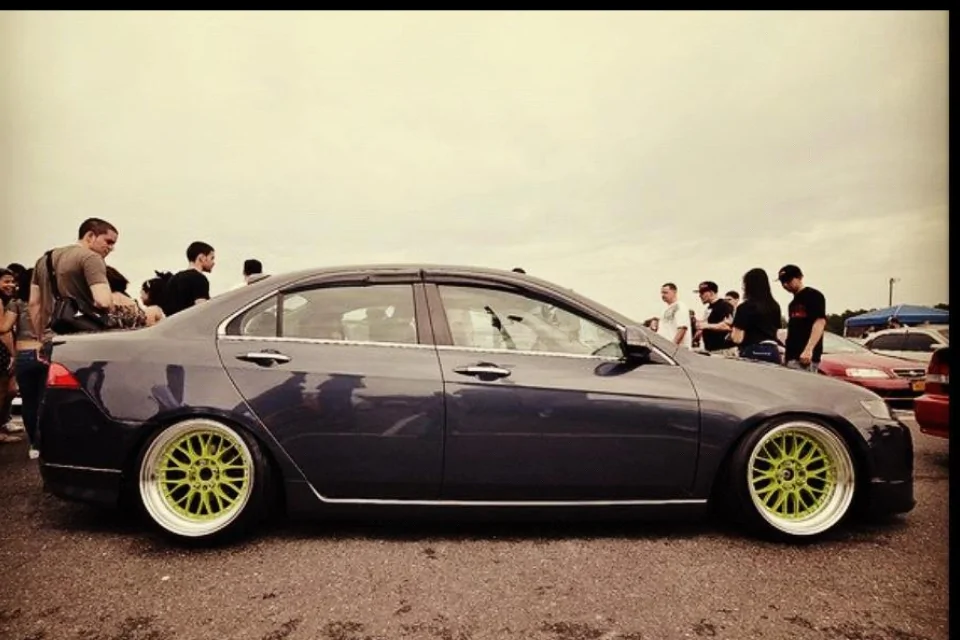

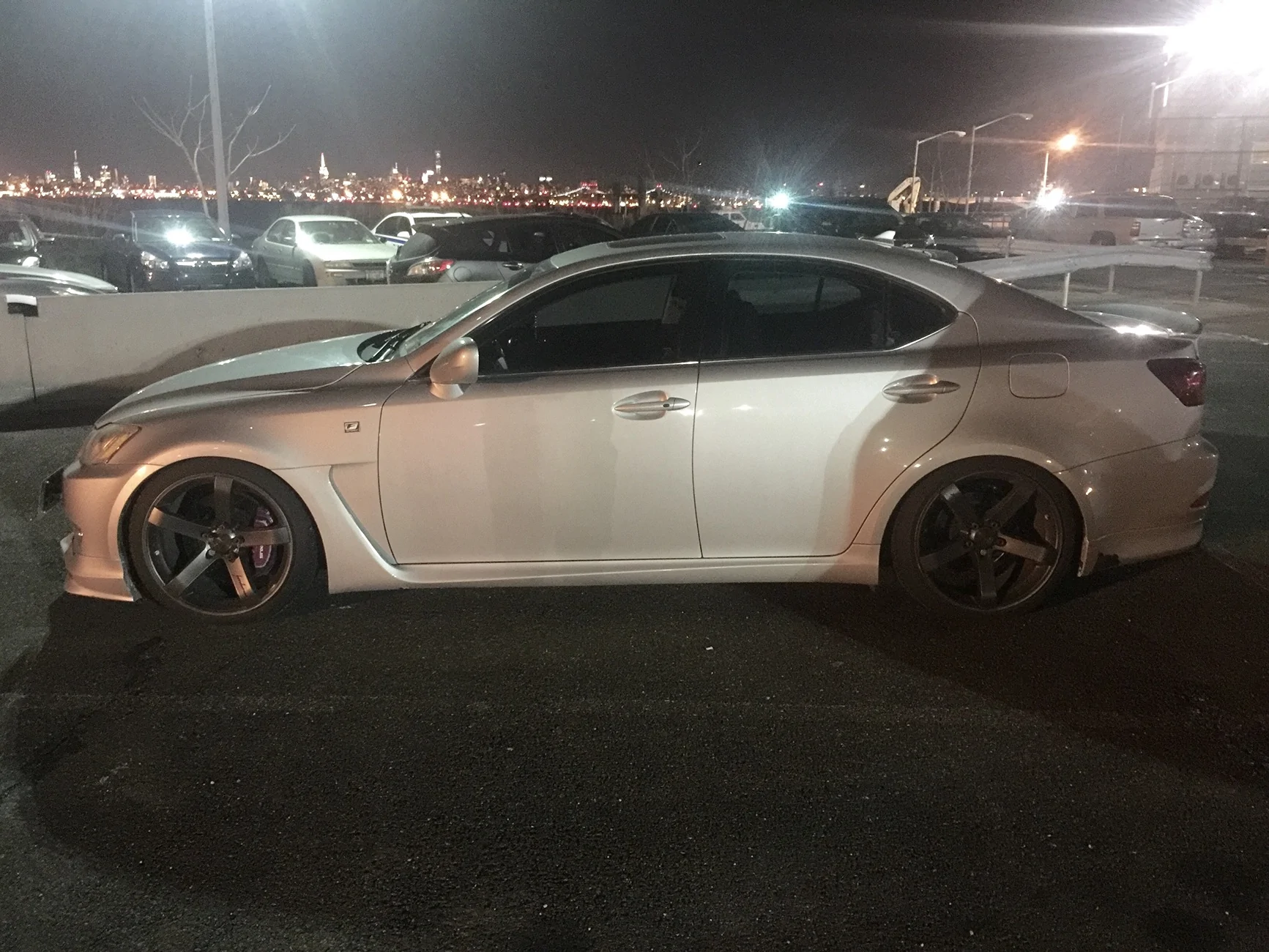

I totally agree with you, on different points of view on flushness, but if i tell you how I used to drive my cars Vs now you wouldn’t believe me unless I showed you. I ran all types of adjustments and heights on all my cars. From fully customized controls arms and coilovers, just to get the wheels as flush as possible. If i were to run springs with more of a drop, then I would’ve definitely installed my 20mm spacer. Which Is what i first installed with the H&R Springs i have. I think it looks off to me given the drop. But like you said it’s really a matter of how it looks to you the owner.
here’s how i used to drive my daily cars 19yrs ago to present. In order from oldest to latest. As years and wasted Money went by, the cars Stance kept sitting higher and higher. Lol. all my cars have been on Coilovers except the FL5.
11th Gen Honda Civic Robo7's OEM+ FL5 Build Journal IMG_0092
11th Gen Honda Civic Robo7's OEM+ FL5 Build Journal IMG_1344
11th Gen Honda Civic Robo7's OEM+ FL5 Build Journal IMG_4575
11th Gen Honda Civic Robo7's OEM+ FL5 Build Journal IMG_1943
11th Gen Honda Civic Robo7's OEM+ FL5 Build Journal IMG_2998

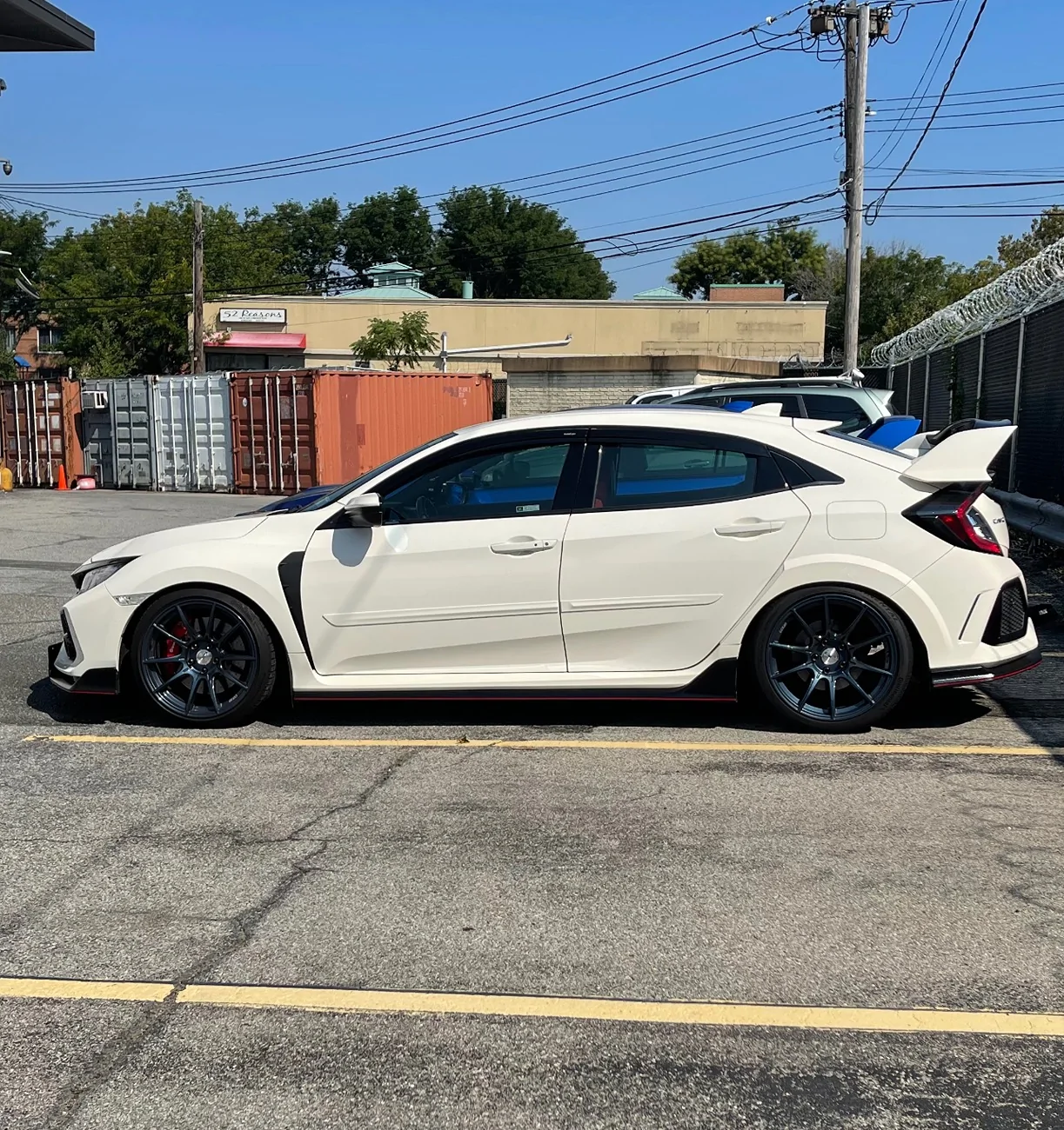

This was the turning point for me, with the whole Form over Function faze. I started going Function over Form.

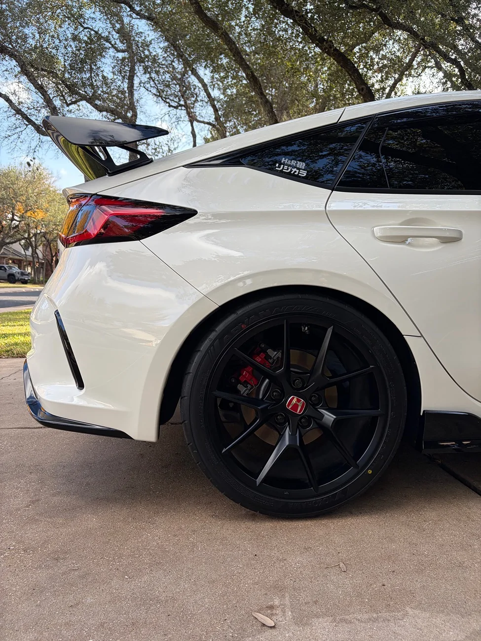

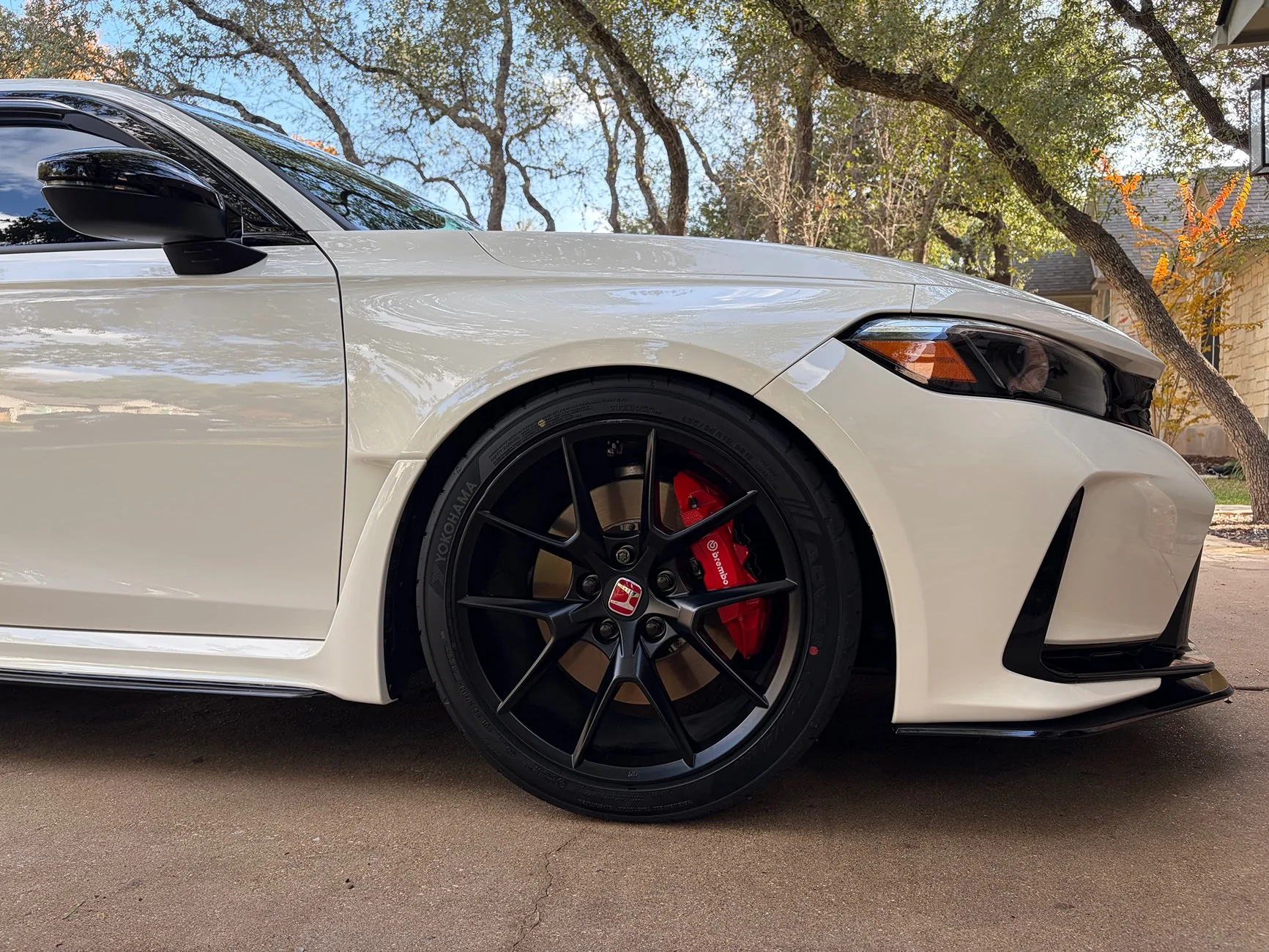

I thought I would list out my complaints about the car and what I did to remedy those issues for the perfect OEM+ car for me.

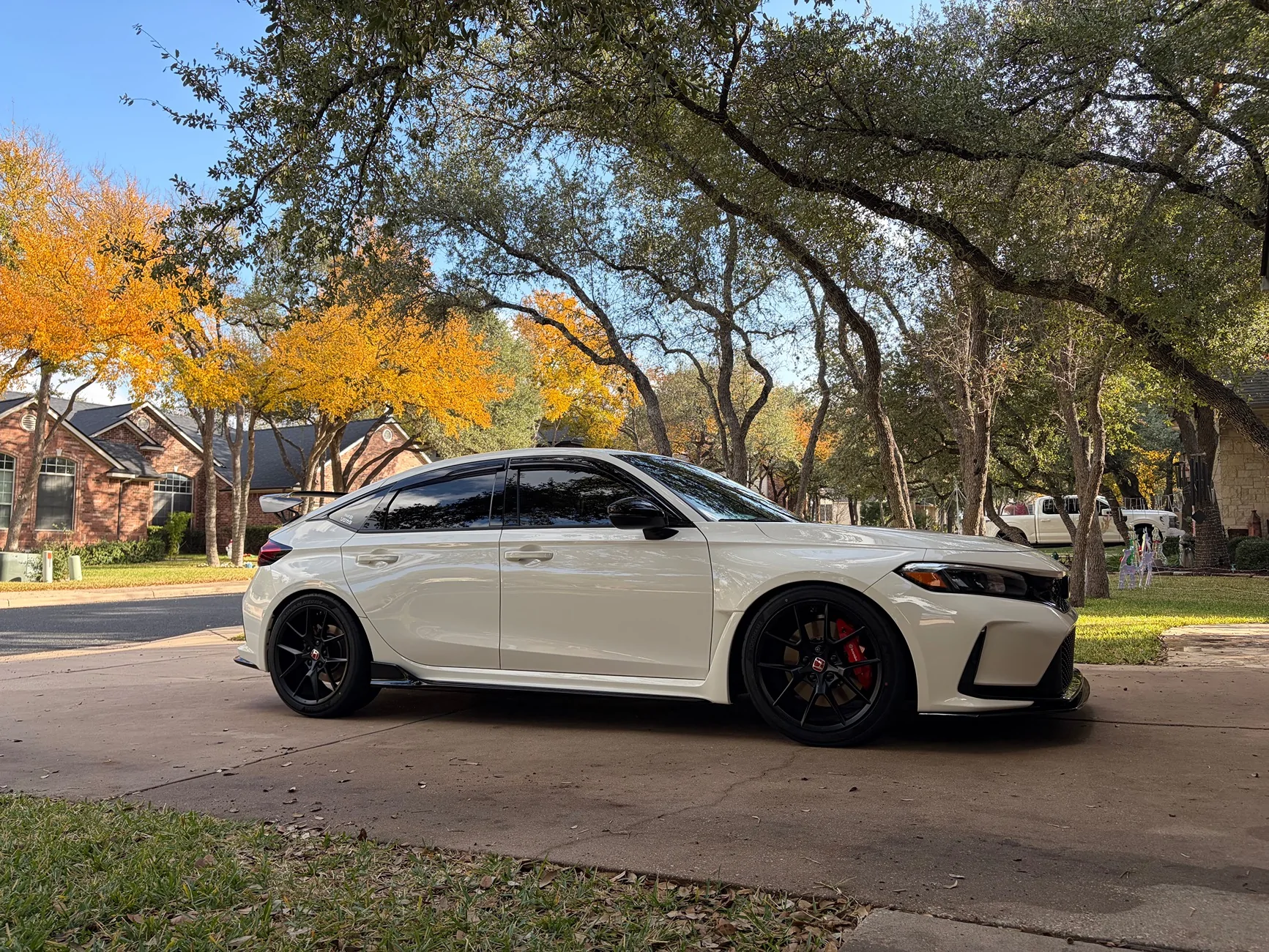

Issue 1 - Stance: I'm not a big stance guy, but I know that low and wide is a better look generally than inset and high. When I walked around the car at the dealership I knew right away I would need to add spacers and lowering springs to get the car to look right. I was torn though with making changes to the car that Honda's engineers designed to be this way. I didn't want to mess with the scrub radius, ride height, or somehow add back torque steer.
Solution: I tried to minimize the changes as much as possible. I decided to go with the smallest drop possible (H&R Springs which drop the car ~0.5") and then add a tire with a bigger sidewall (265/35 R19 which adds 0.5" back to the height). The result is perfect, the wheel gap decreased 1" while my ride height didn't change. I also added 20mm spacers to all four wheels to get the wheels flush with the fenders. The H&R springs ride a little softer than stock so the ride isn't as harsh, but it's also not quite as sporty feeling. It still feels good, but I preferred the feel of the stock springs if I'm being honest. The increased tire sidewall cushions big bumps slightly. I also added Spoon Rigid Collars but had them installed with the springs so I can't speak to how they changed the feel of the car. The result of these changes is that the car is much more comfortable to use (good since this is my daily) and still feels and drives great. I will say the spacers added a hint of torque steer, but it went from a 0 to a 1 out of 10.
Mod Grade = A-. If I did it over I might try the Spoon springs instead as they have a similar drop and I hear they maintain the sporty characteristics that the stock springs have. Overall though I'm very happy with these mods though.
11th Gen Honda Civic Robo7's OEM+ FL5 Build Journal IMG_1474
11th Gen Honda Civic Robo7's OEM+ FL5 Build Journal IMG_1475

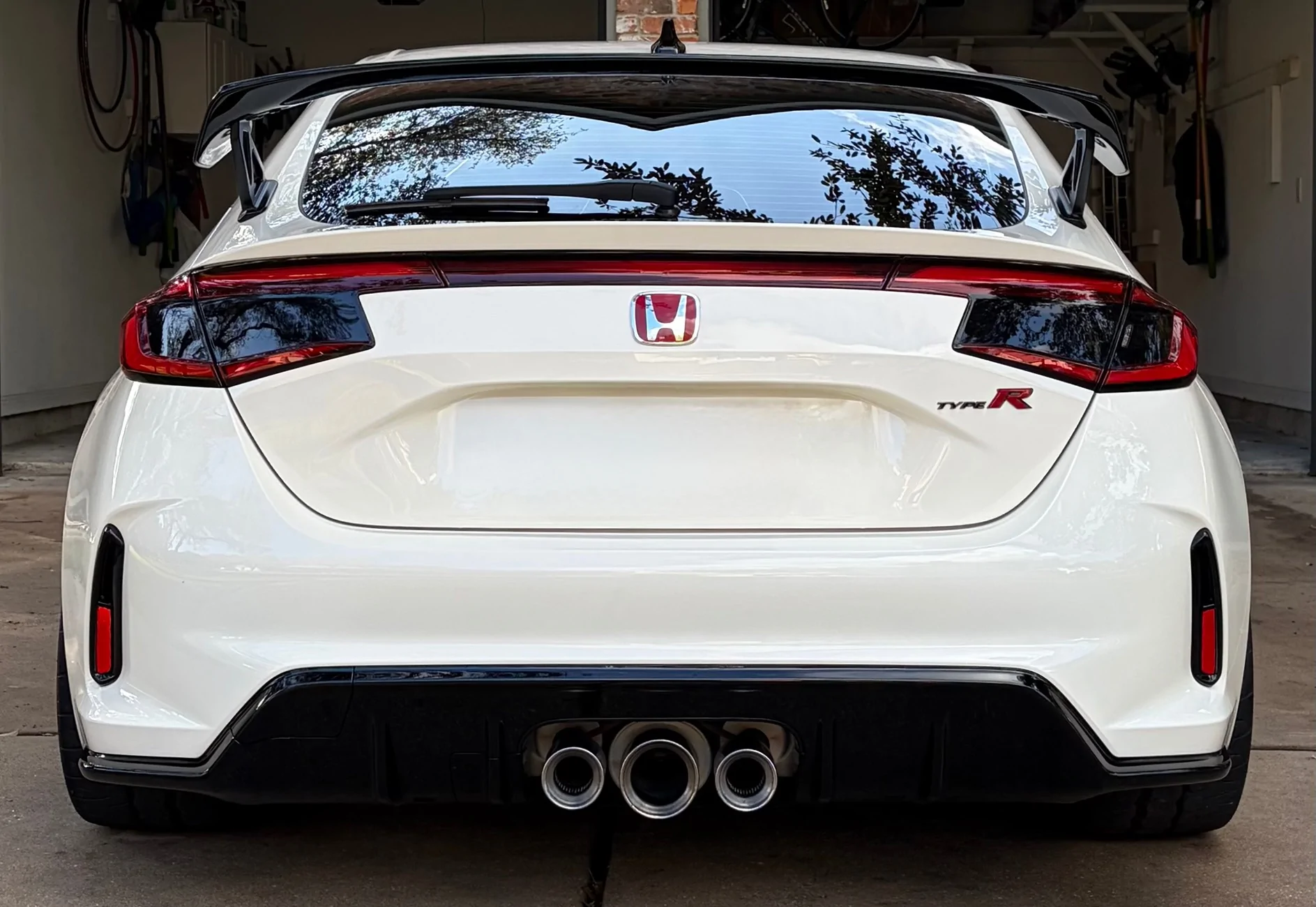

Issue 2 - Lights & Lip: I'm a bit OCD about things that maybe others wouldn't car about. For me though I found it insane that a nearly $50k car was using incandescent light bulbs in the rear taillights and in some of the interior lights. Also, the rear taillights looked cheap. I get it's a Honda Civic, but at this price it irked me that Honda didn't create a better looking LED taillight for this trim. Finally, the front of the car just always looked like it was missing a front lip. The car has this highly contrasted black rear diffuser and side skirts, but no front lip to go with it. To me it looked unfinished.
Solution: I replaced all the incandescent bulbs with Lasfit LEDs, I added tint overlays to the rear tail lights so it doesn't look like an incandescent fixture with LEDs plugged in, and installed the Project Aero front lip.
Mod Grade = A+. The taillights and lip look excellent. The car should have looked like this from the factory. I will say I had my lip sanded and painted professionally. From Project Aero the lip comes wavy and with some hard lines. Nothing else on the car looks like that so I had my paint shop sand it down until it looked smooth and the hard edges were gone. It's painted piano black and now matches perfectly with the side skirts and rear diffuser.

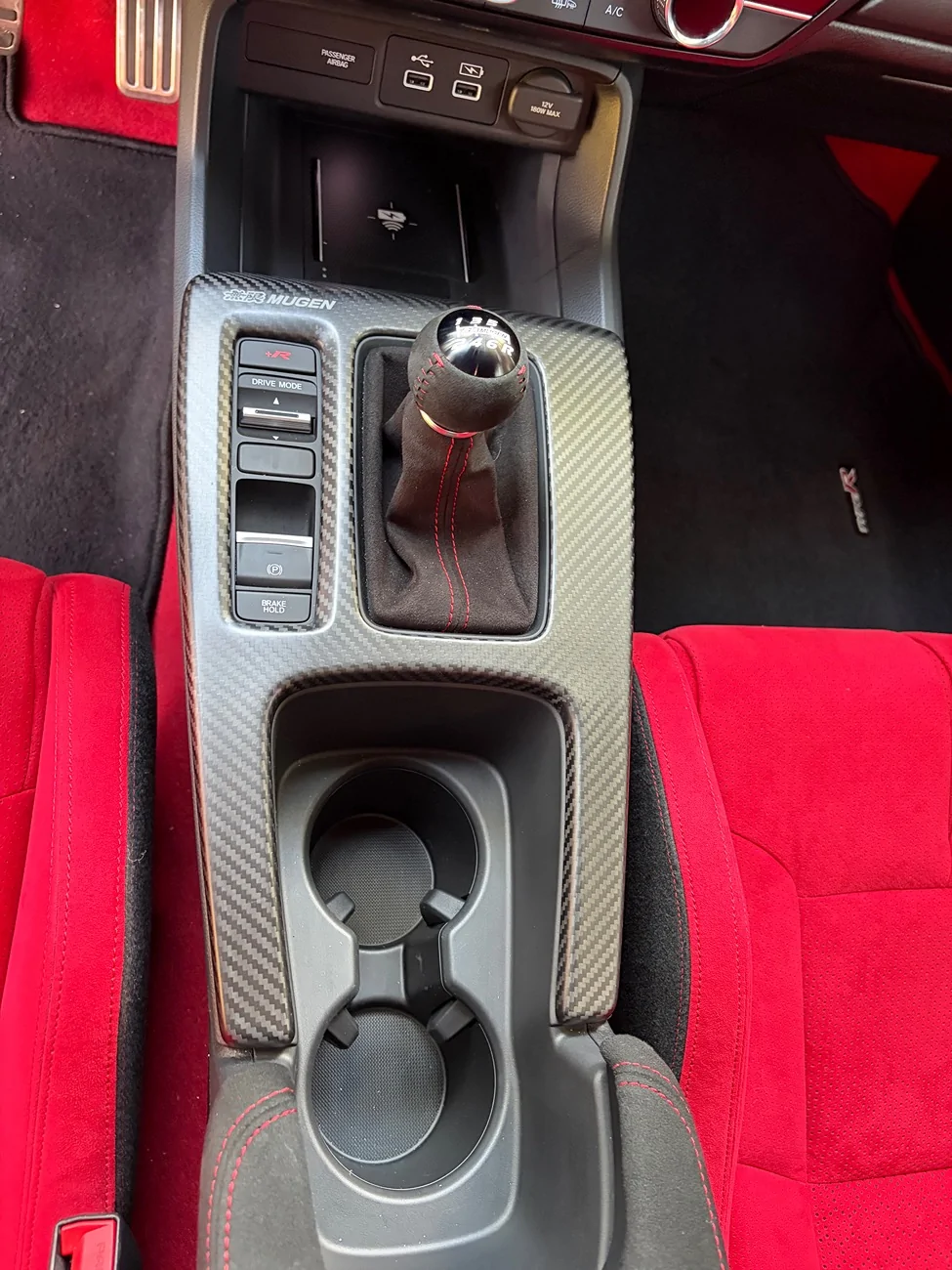

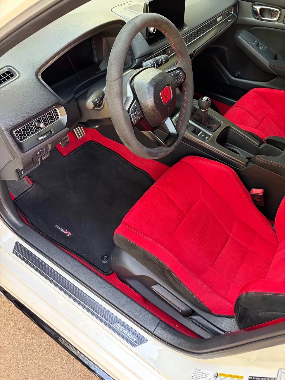

Issue 3 - Interior: I don't know why Honda thinks the US has to have fake feeling leather on the steering wheel and shift boot. The stock shift knob looked nice, but it burned my hand in the summer and froze it in the winter. And my biggest complaint was with the silver faux aluminum center console cover that didn't match anything else in the interior. Lastly, I love red, but wow, that stock interior. So much red.
Solution: I swapped to the OEM Alcantara steering wheel, the JDM Alcantara shift boot, Mugen Alcantara shift knob, Mugen carbon fiber center console, and Mugen carbon fiber looking door sill scuff plates.
Mod Grade = A+. The Alcantara wheel and shift knob feel so much better and don't feel cold to the touch in the winter. The dark matte carbon fiber center console looks incredible, though I had to get the matching scuff plates so I have some other carbon fiber looking elements in the interior. Finally, the OEM high wall mats break up all the red a bit. I love how the interior looks now and don't plan on changing anything else.

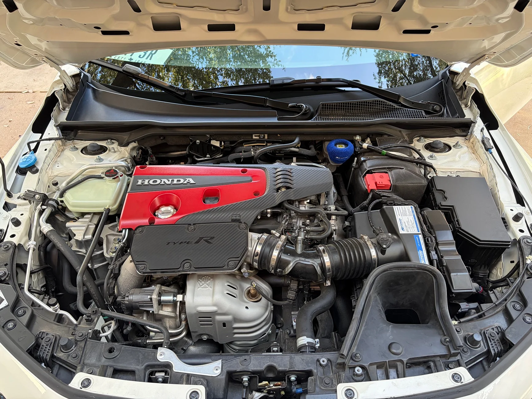

I don't have a photo of the RMM installed, but here is one of the Spoon accessories I stuck on. I don't plan on changing anything with the drivetrain other than a Hondata tune after my warranty expires (if I can wait that long).

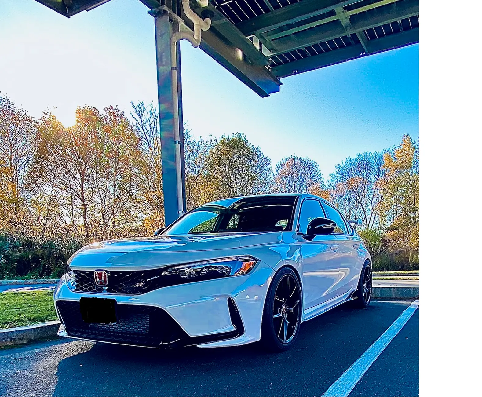

Good angle showing a 265/35/19 on H&R's with +20(fr) & +25(r) spacer set up.
