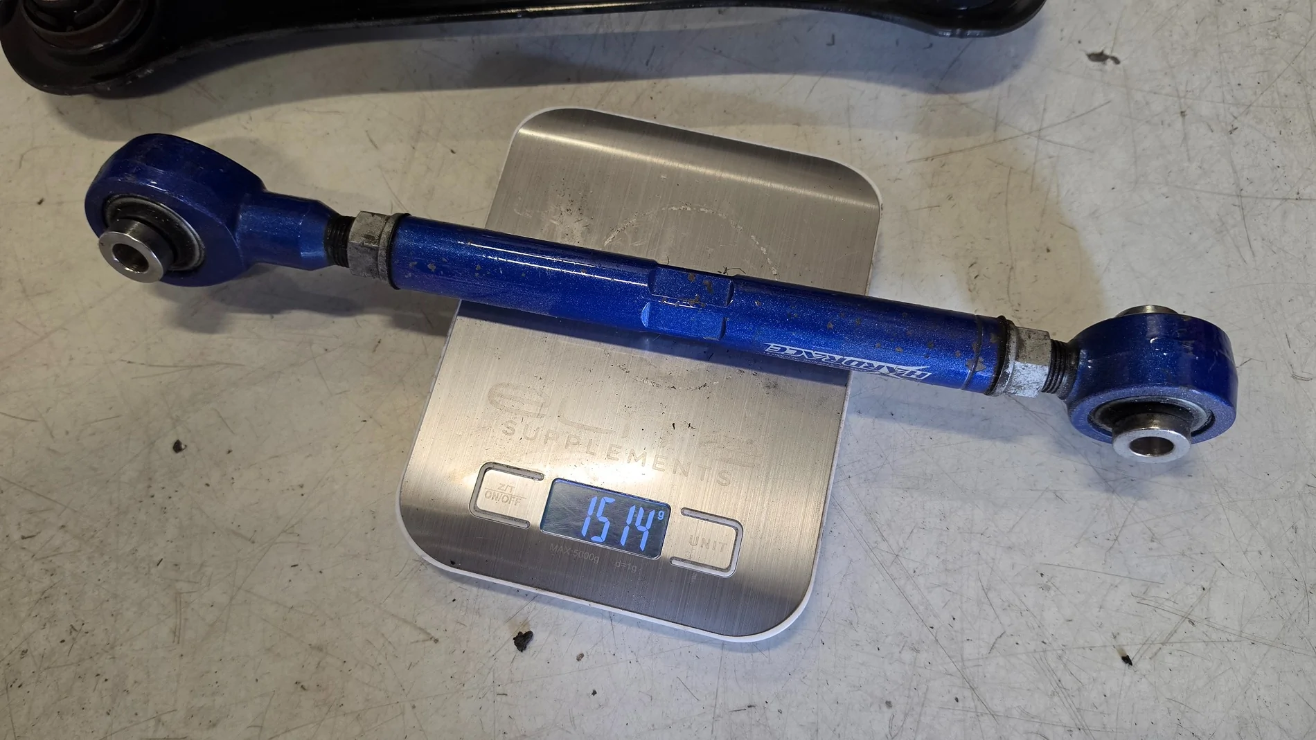

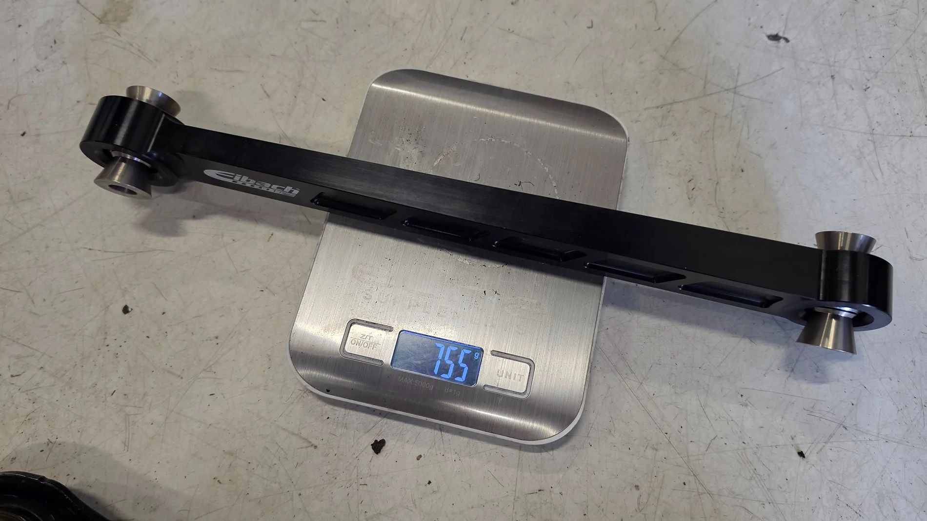

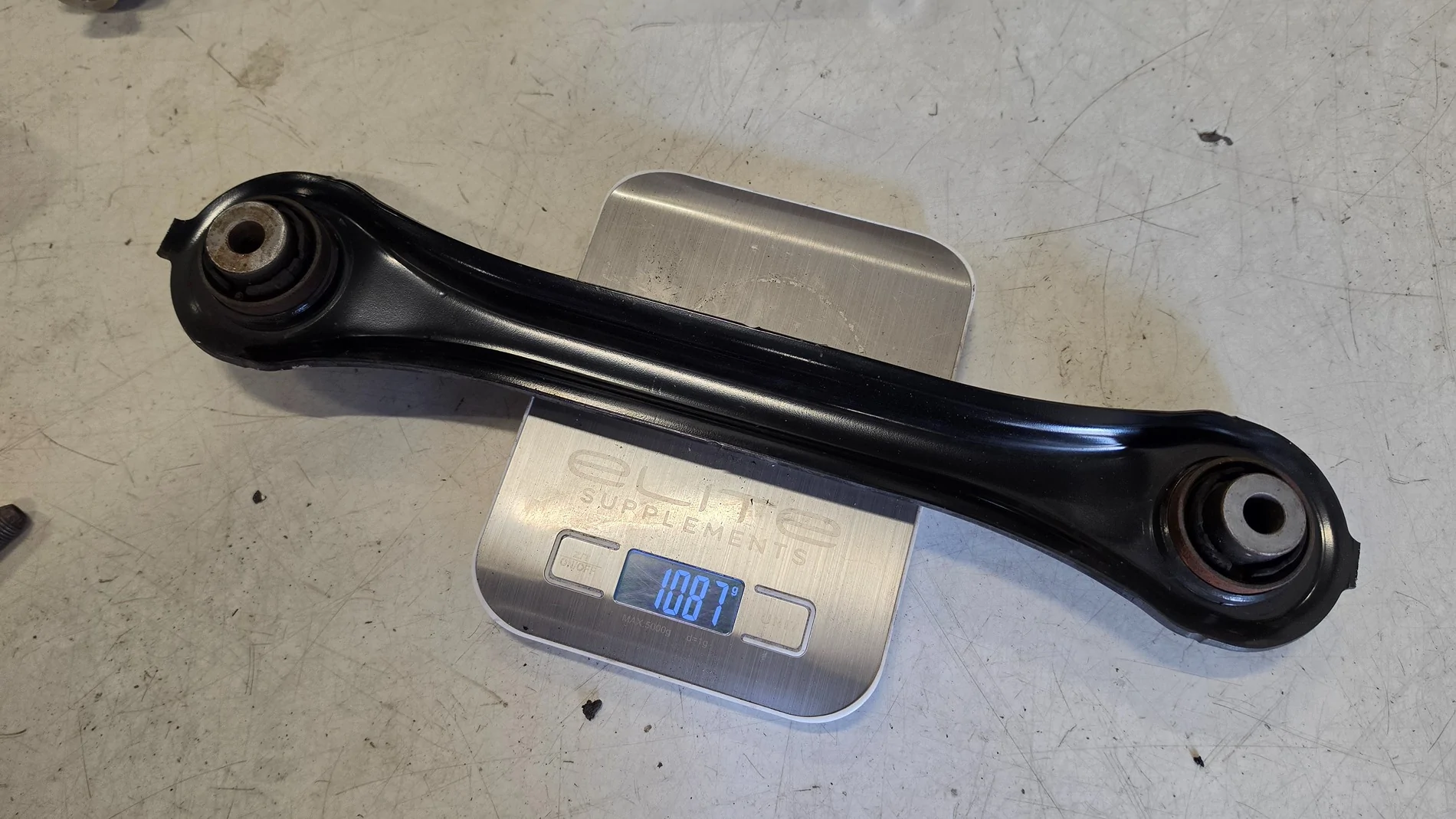

Eibach rear lower A arms are nearly half the weight of the Hardrace version.
Since I don't need the adjustability of the a arm at this stage (adjusting from the b arm for now), I'll fit the Eibach πŸ‘

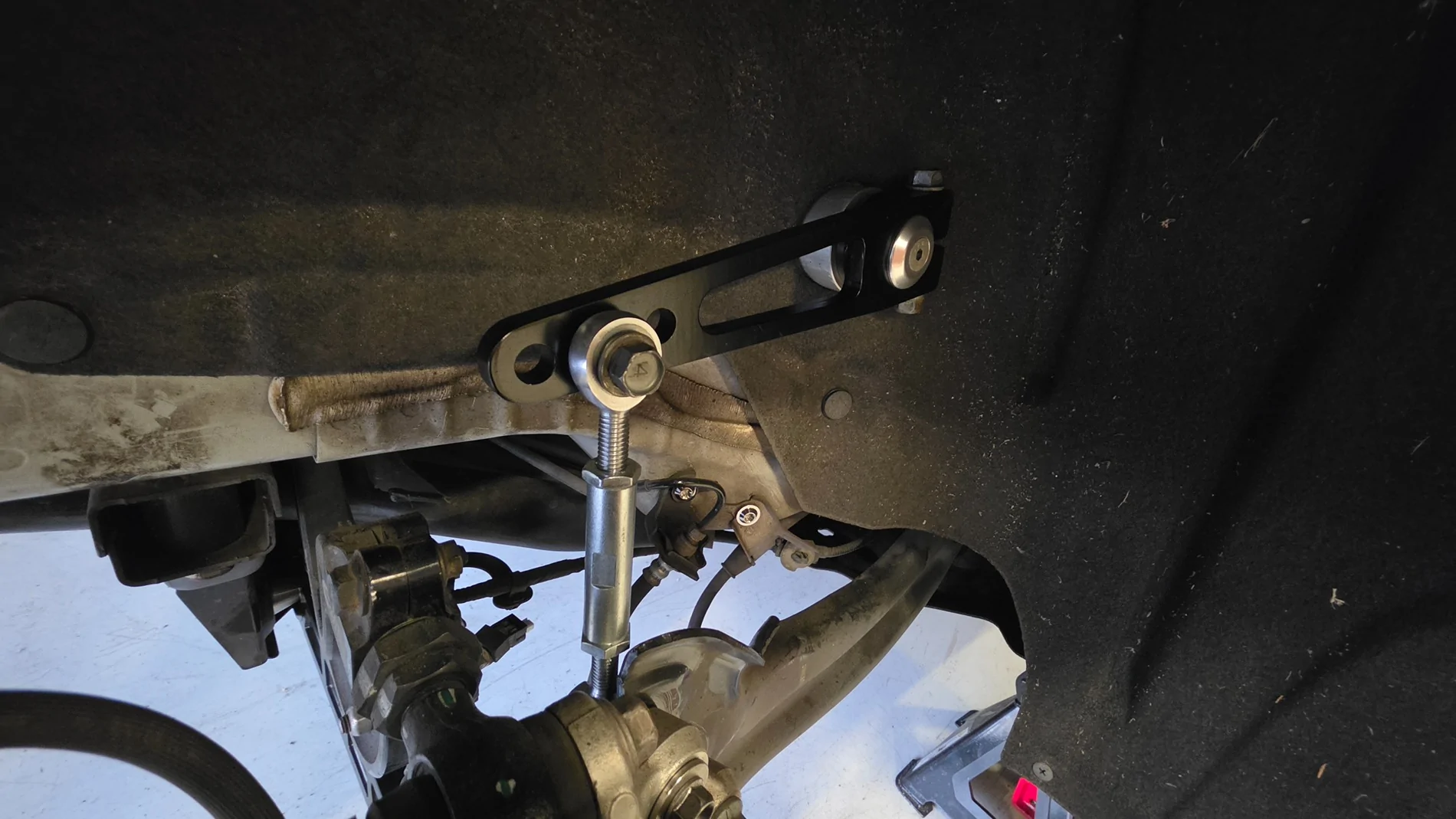

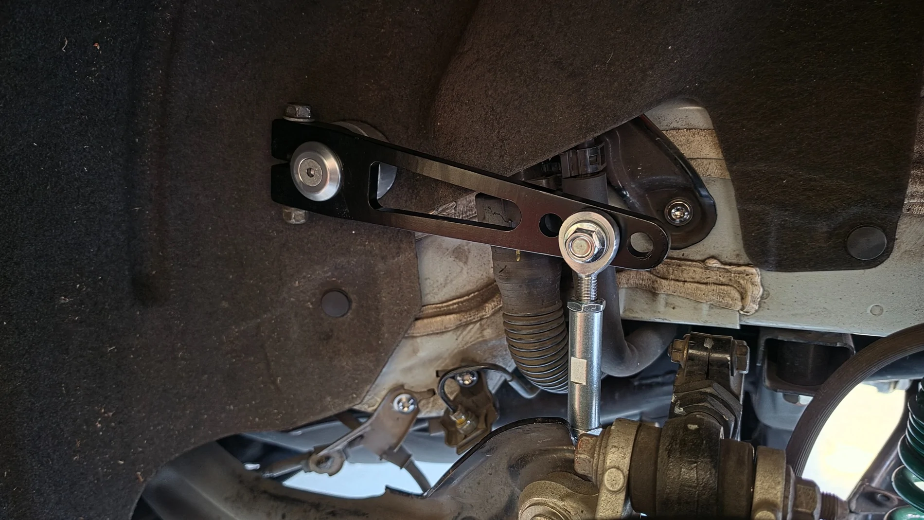

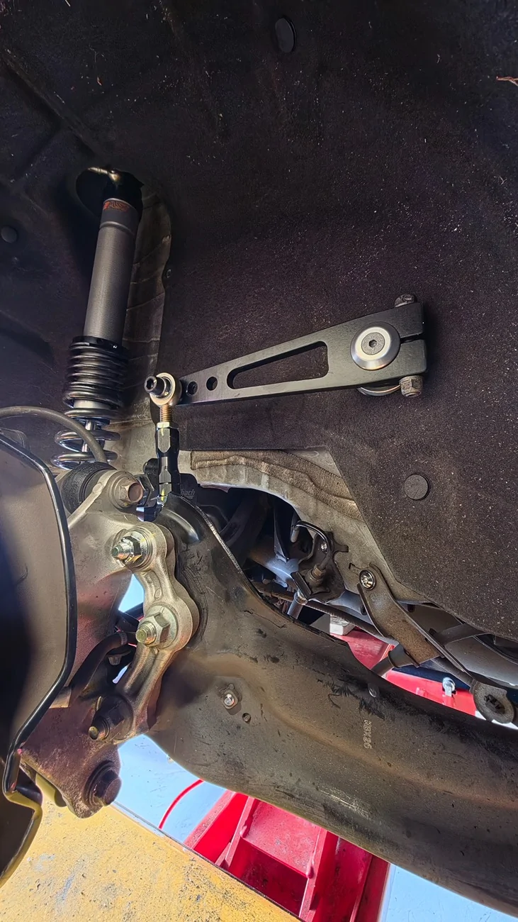

RSR/TCR style rear sway bar system fabbed up and installed. Can now do easier/quicker rear roll stiffness adjustments at the track, with a wider adjustment window than on a bar in the OEM location. Many hours of measuring, cutting and swearing but the adjustability should be worth it.
