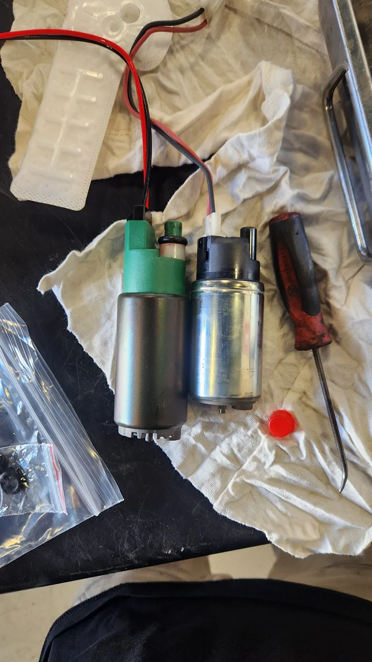

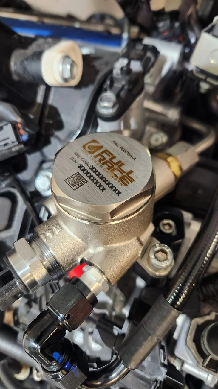

Full Race HPFP ✅
AEM LPFP ✅

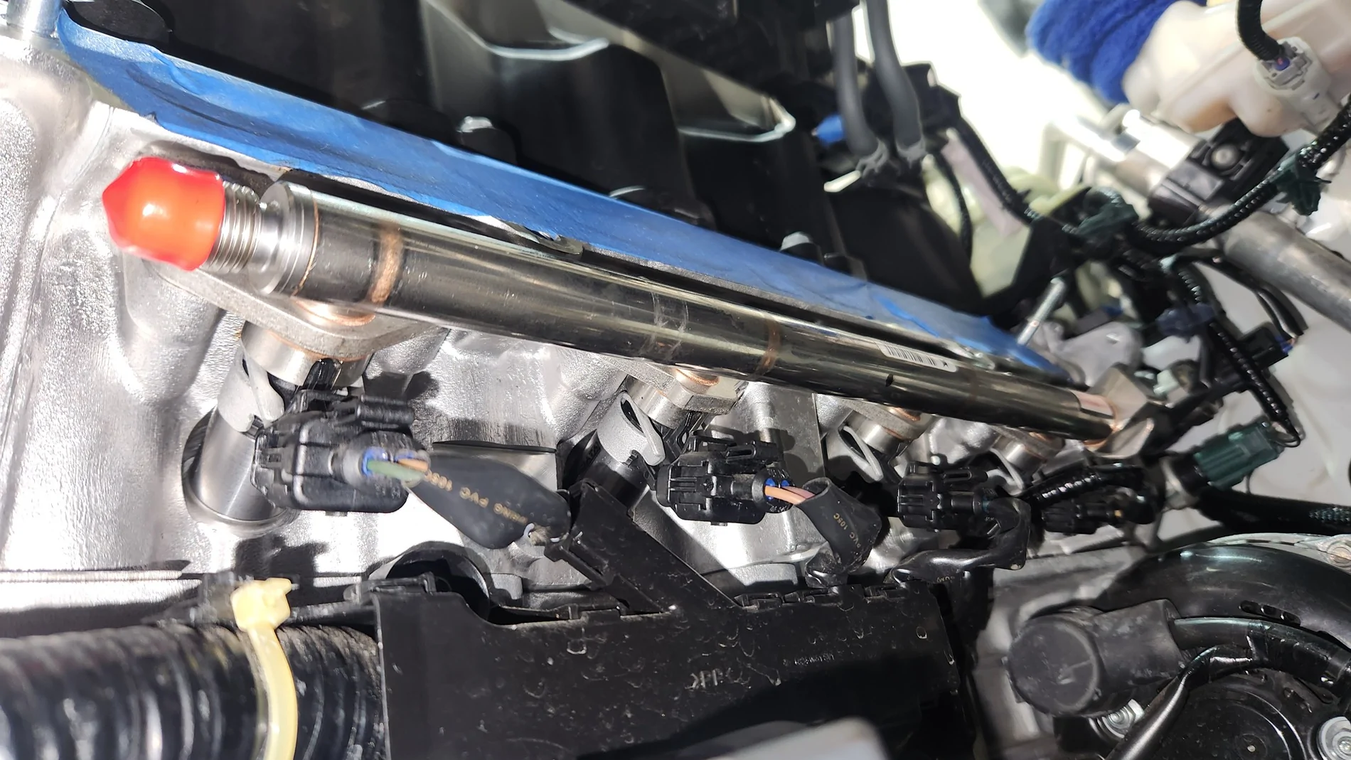

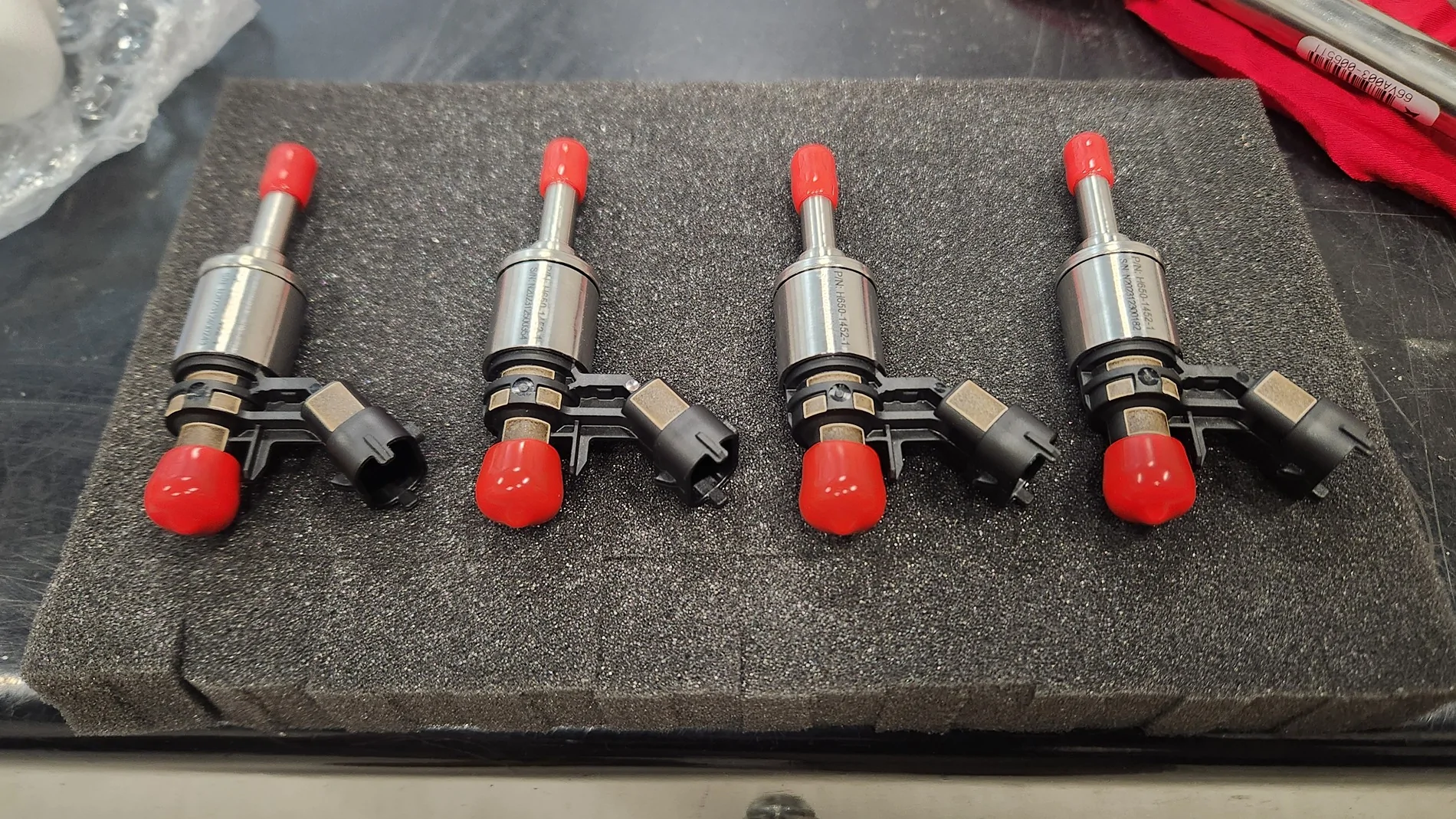

Hondata 1530cc Injectors (bought the whole fuel system just to get these injectors ☠) ✅
Hondata Can Flex ✅

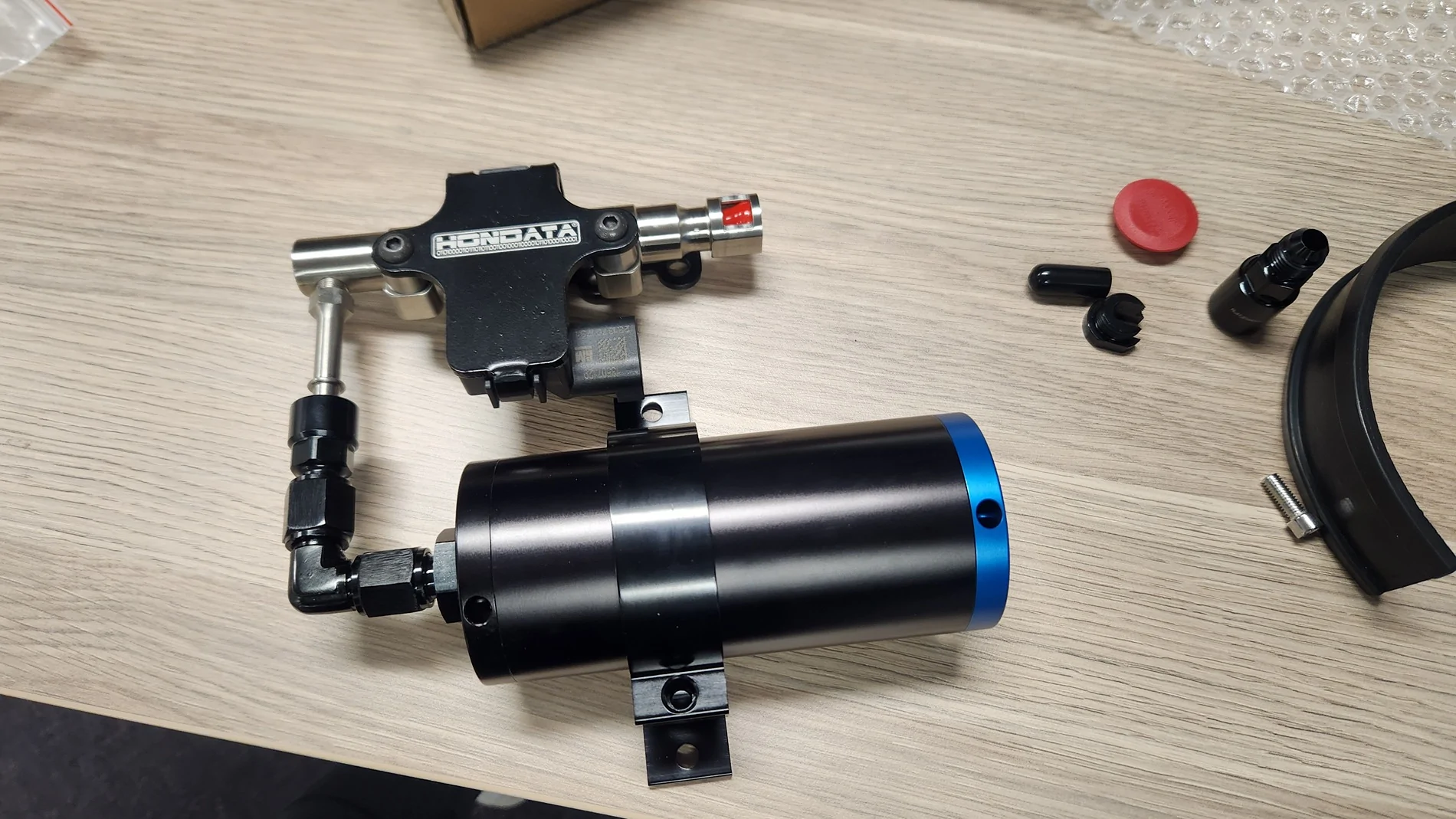

Injector Dynamics in-line fuel filter (still trying to figure out the plumbing/mounting location of the filter) ✅

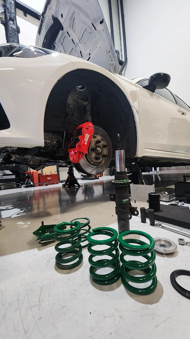

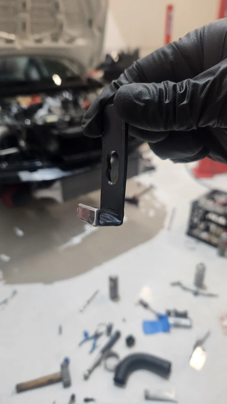

• Fabbed up a bracket to hold my intake pipe to the body, it's one of those types that go under the hose clamps of the silicone joiner. The ones commercially available are cheese (last one broke).

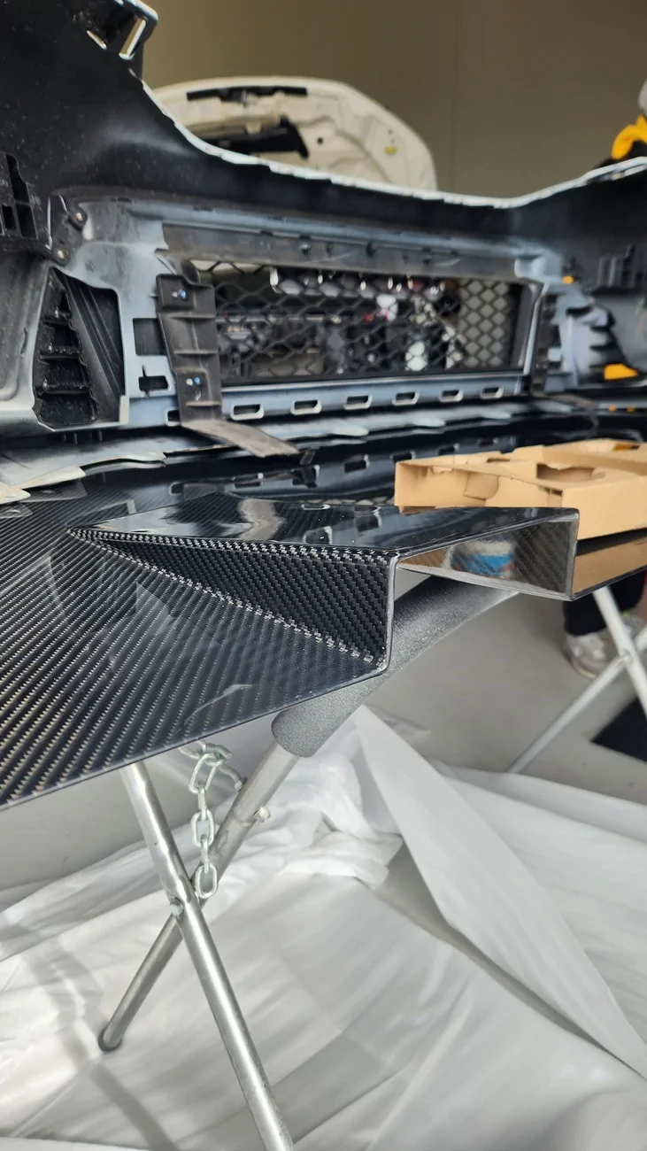

• Increased spring rates going on to deal with the extra load from the new aero package.
• Race car shiz

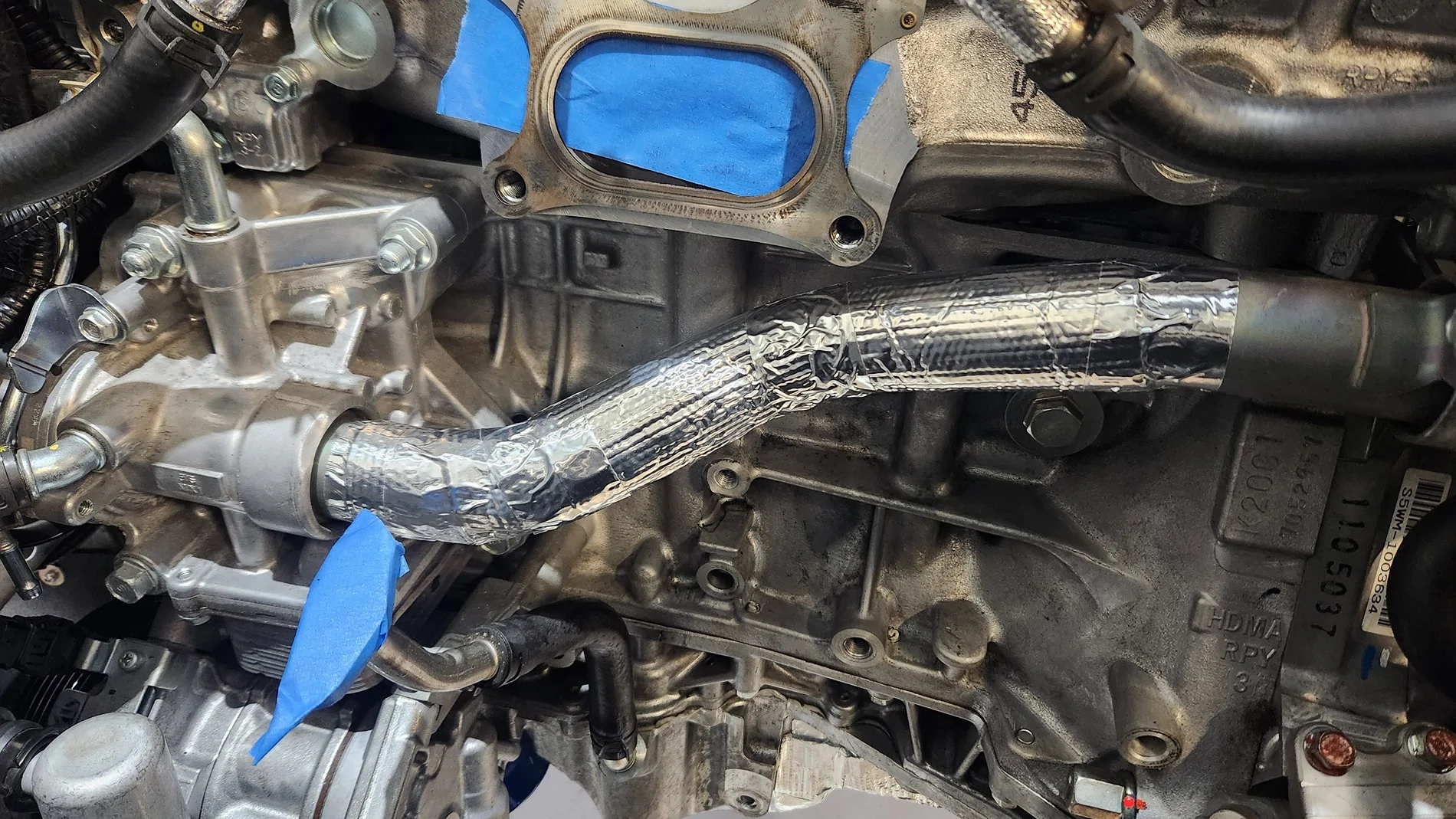

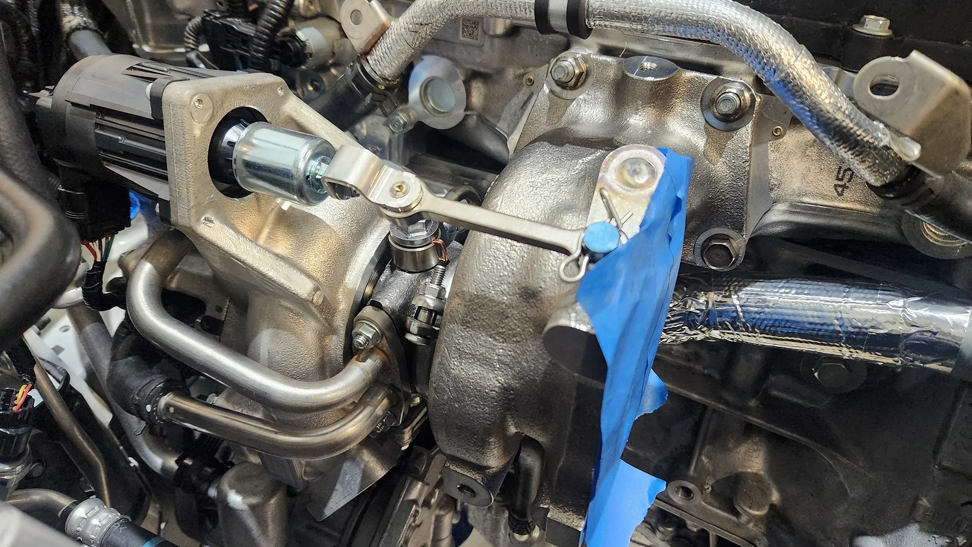

MHI in ✅
Main coolant pipe heat wrapped ✅

Nope, ran OEM and now upgraded to MHI

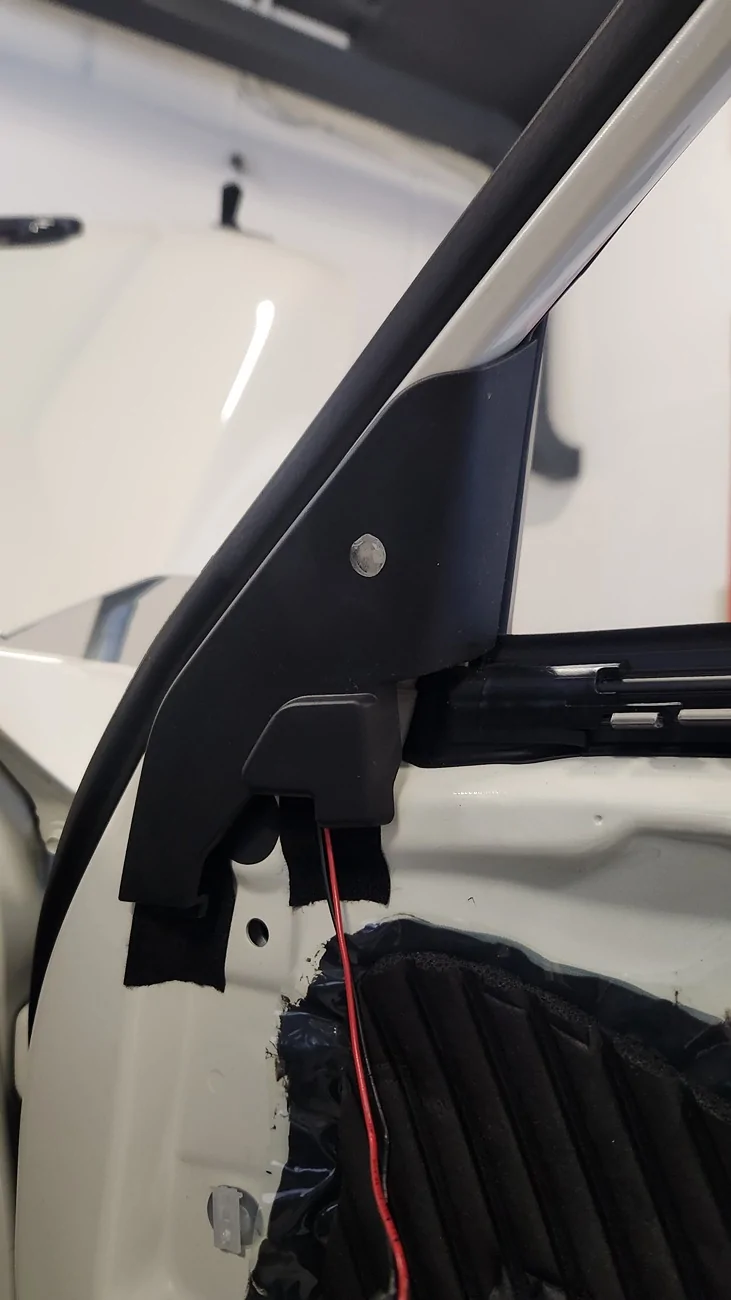

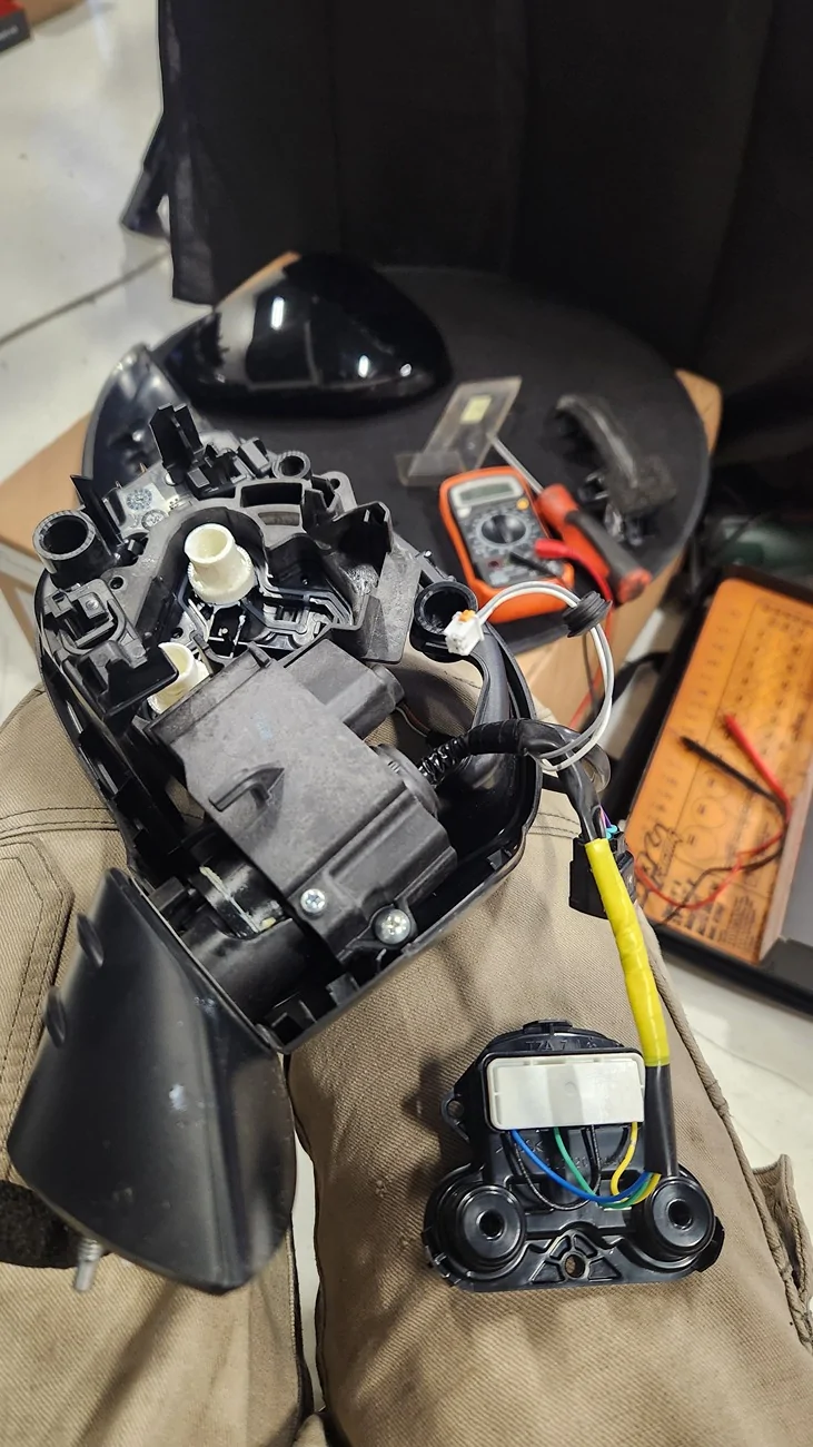

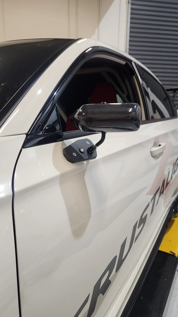

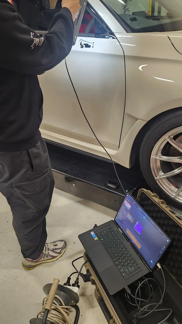

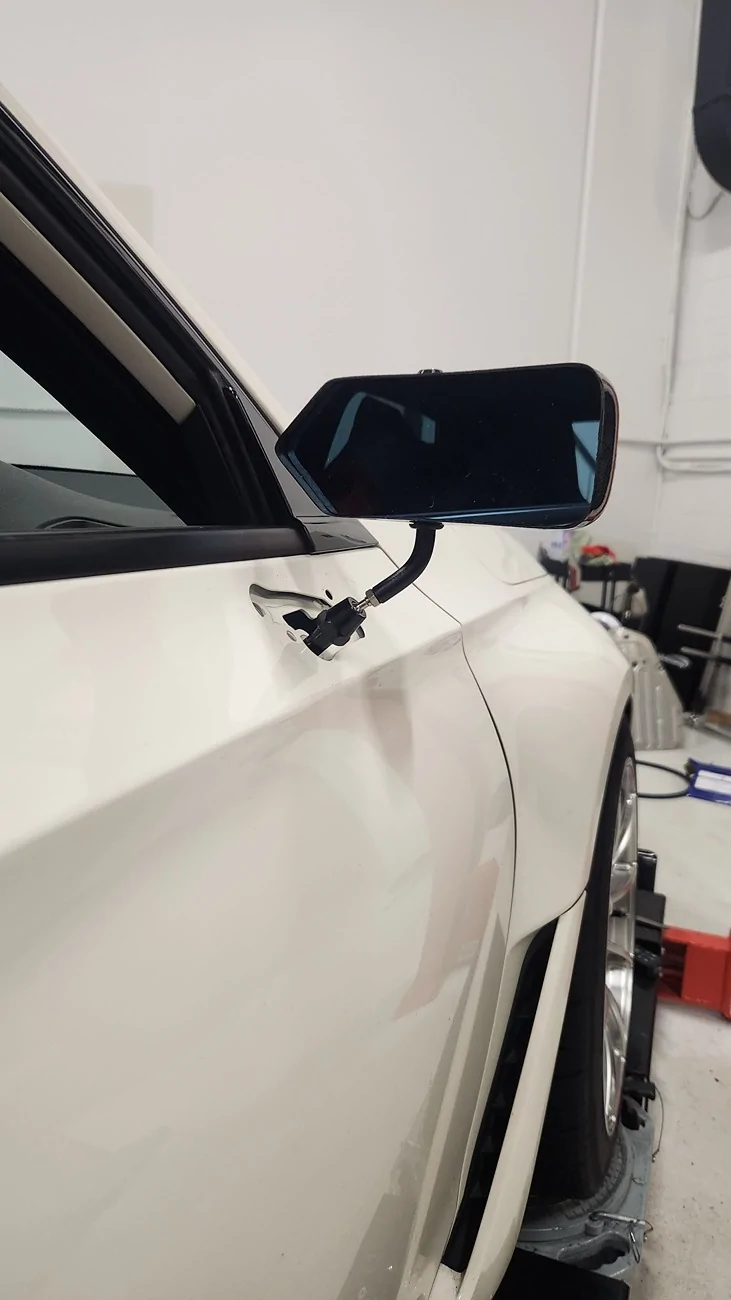

Mounting up some craft square replica mirrors, 3D scanning the door to design a mounting plate. Also reverse engineering the BSM system and relocating the warning light into the door so it still works with the new mirrors.

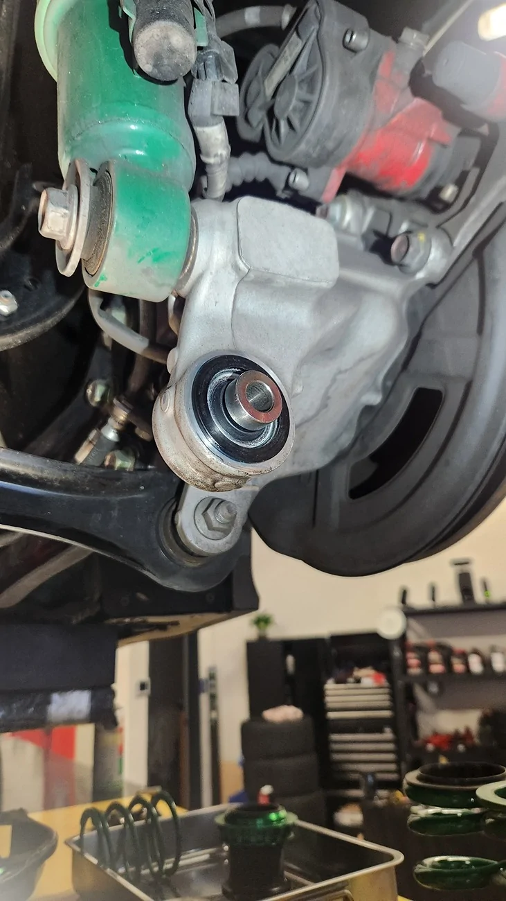

Hardrace pillow ball rear B arm upright bushing fitted in place of the OE rubber one ✅

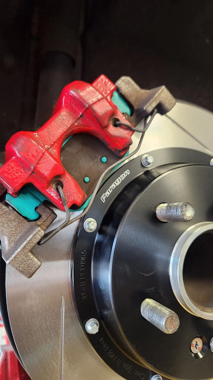

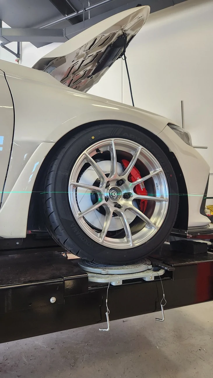

Project Mu type PS rear pads + Paragon 2 PC discs fitted.
May be worth noting that the hat is 1.5mm thicker than the OE disc. This will result in the wheel sitting 1.5mm further out (effecting a decrease in wheel offset) ✅
11th Gen Honda Civic 🚀 TRUSTALIGN - Time Attack FL5 Build Journal 20250827_103554

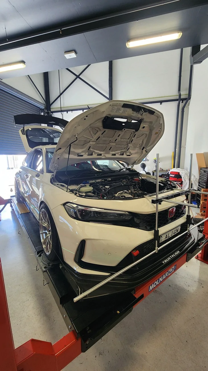

Aligned by yours truly

Craft Square replica mirrors mounted up
Side Indicator functional
Blind Spot monitor system functional (relocated on the inside of door)

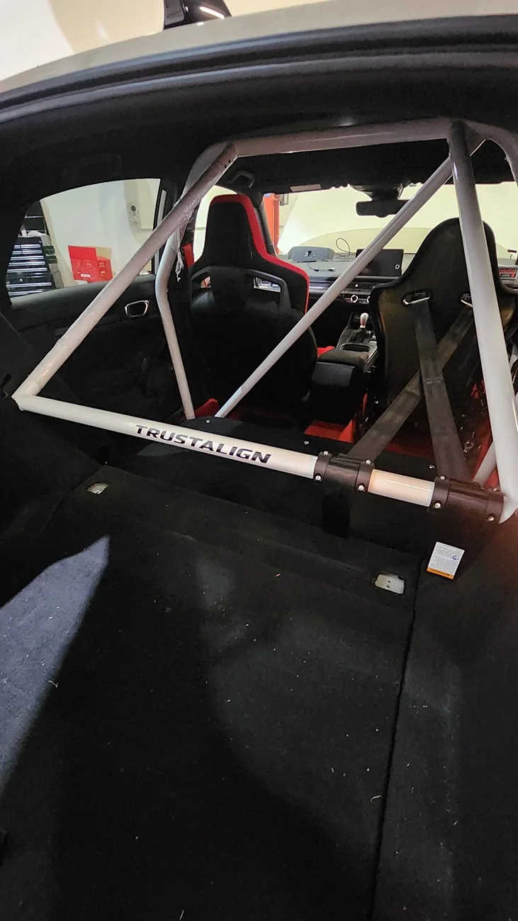

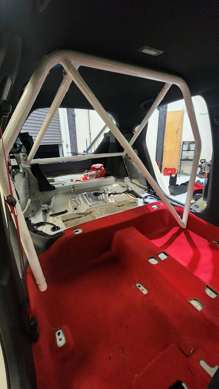

TRUSTALIGN schedule J cage in
11th Gen Honda Civic 🚀 TRUSTALIGN - Time Attack FL5 Build Journal 20250830_180605

BSM relocation

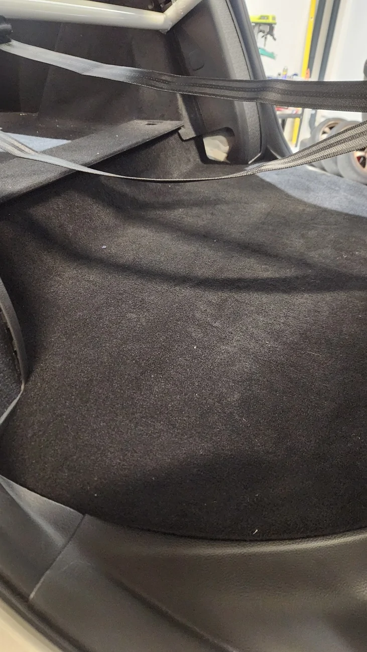

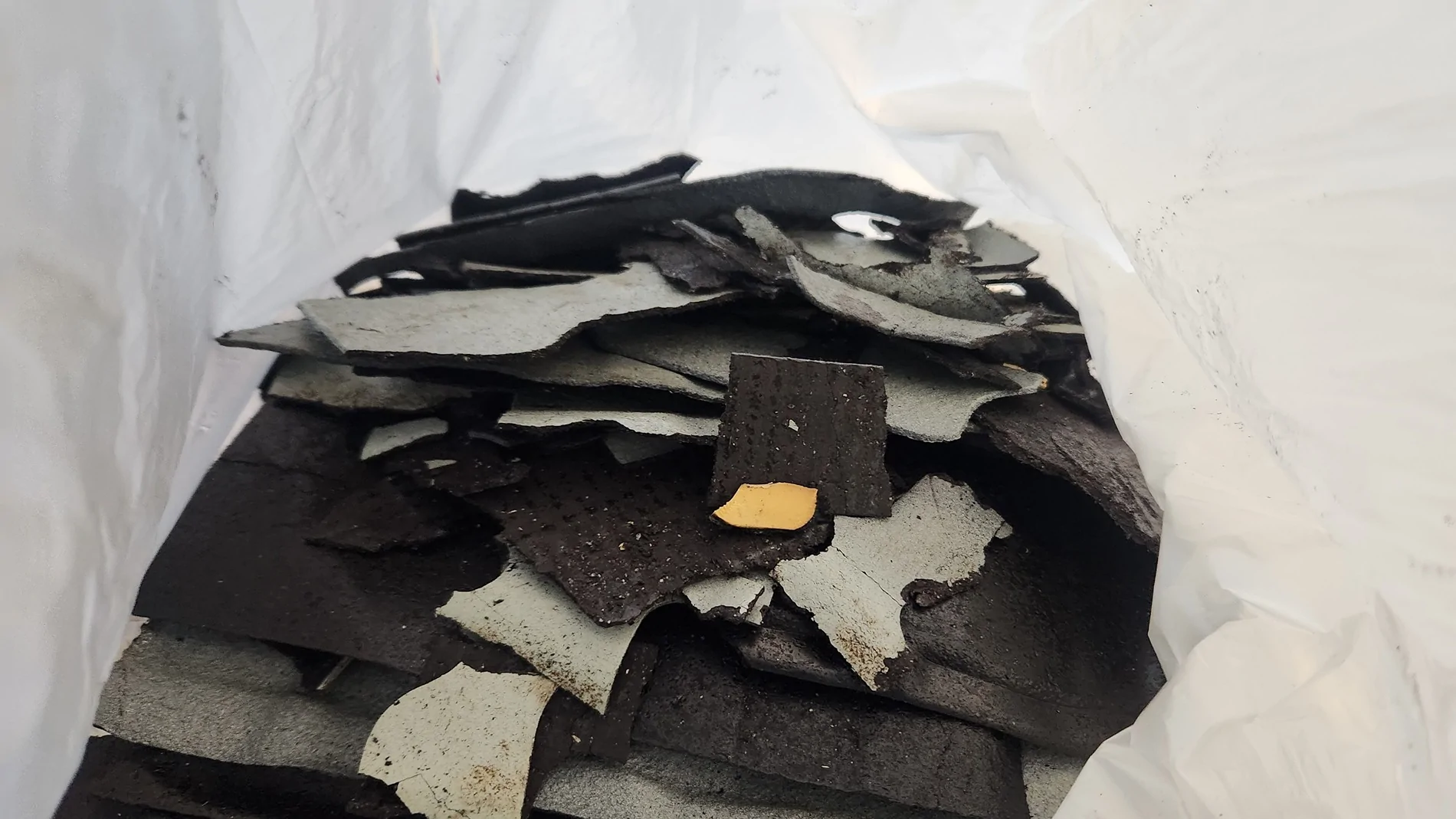

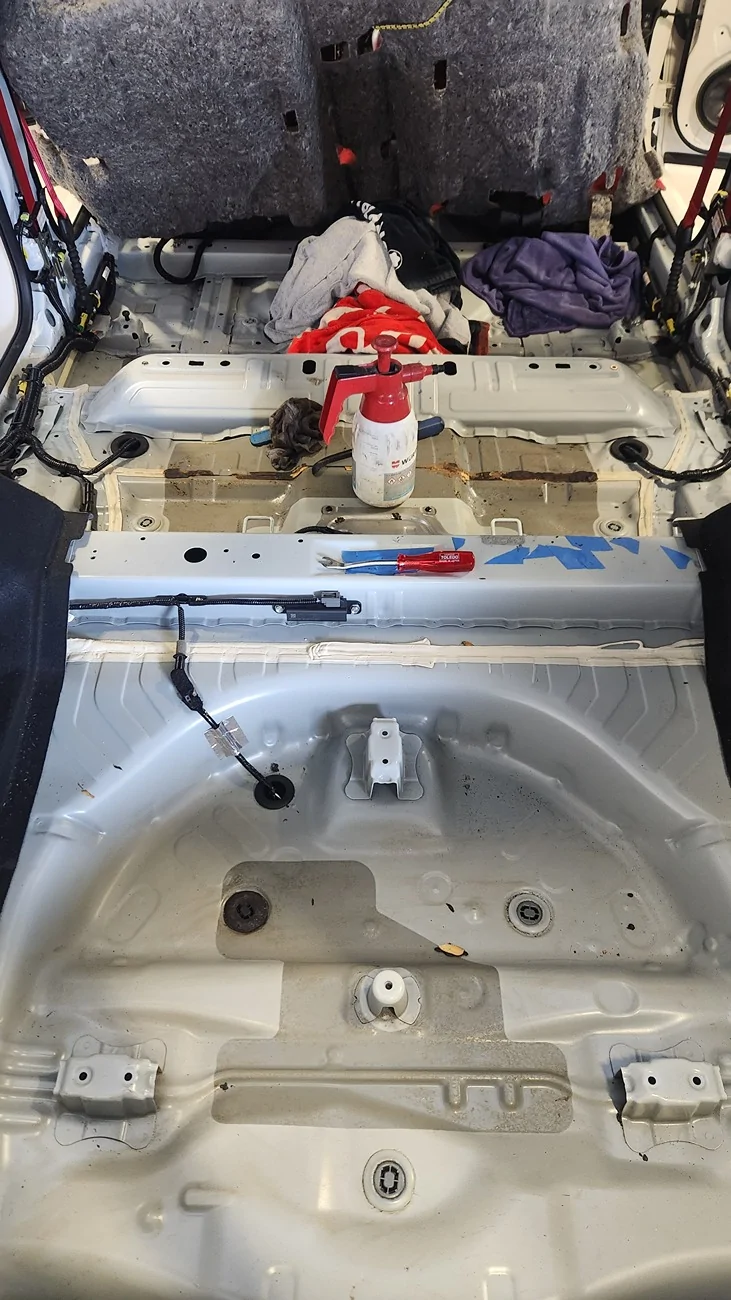

Sound Deadening removed - Honda didn't put much in
Only 2kg saved

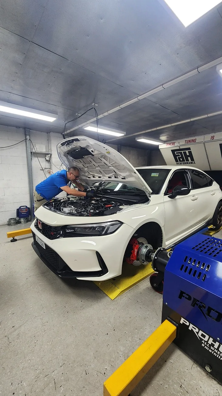

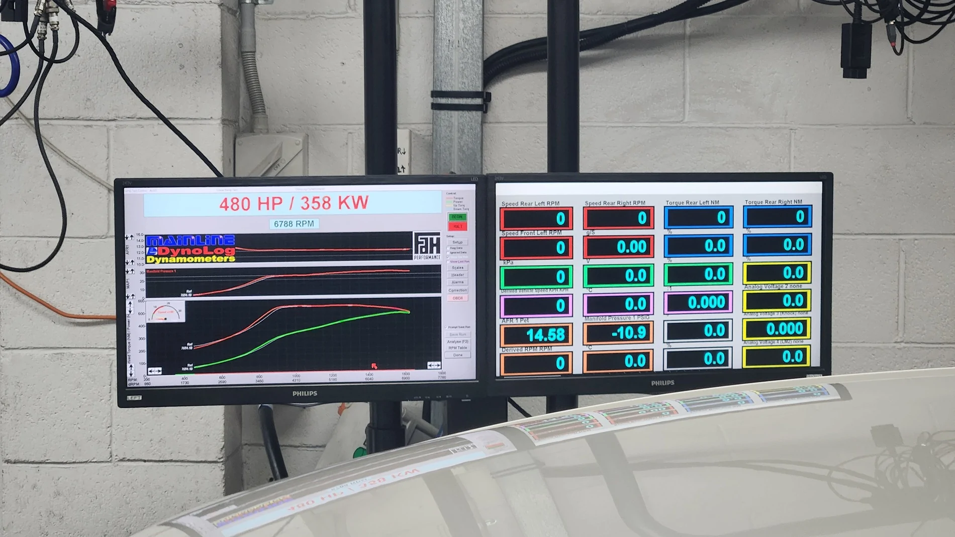

Tuned to 480hp at the hubs

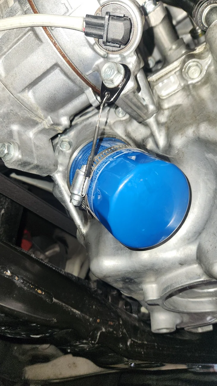

*Slaps oil filter...That ain't goin' nowhere.
Now it's safe!
