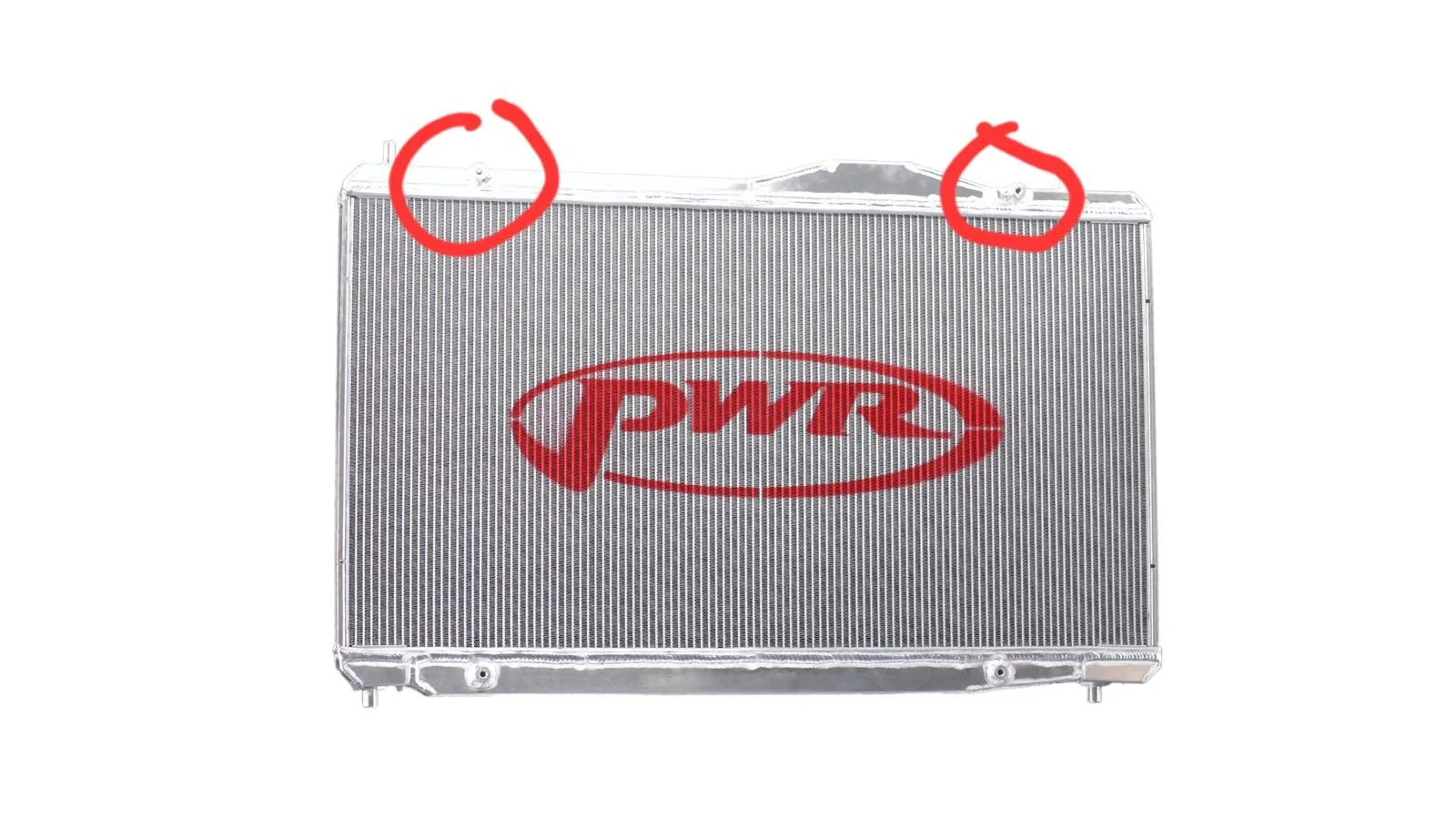

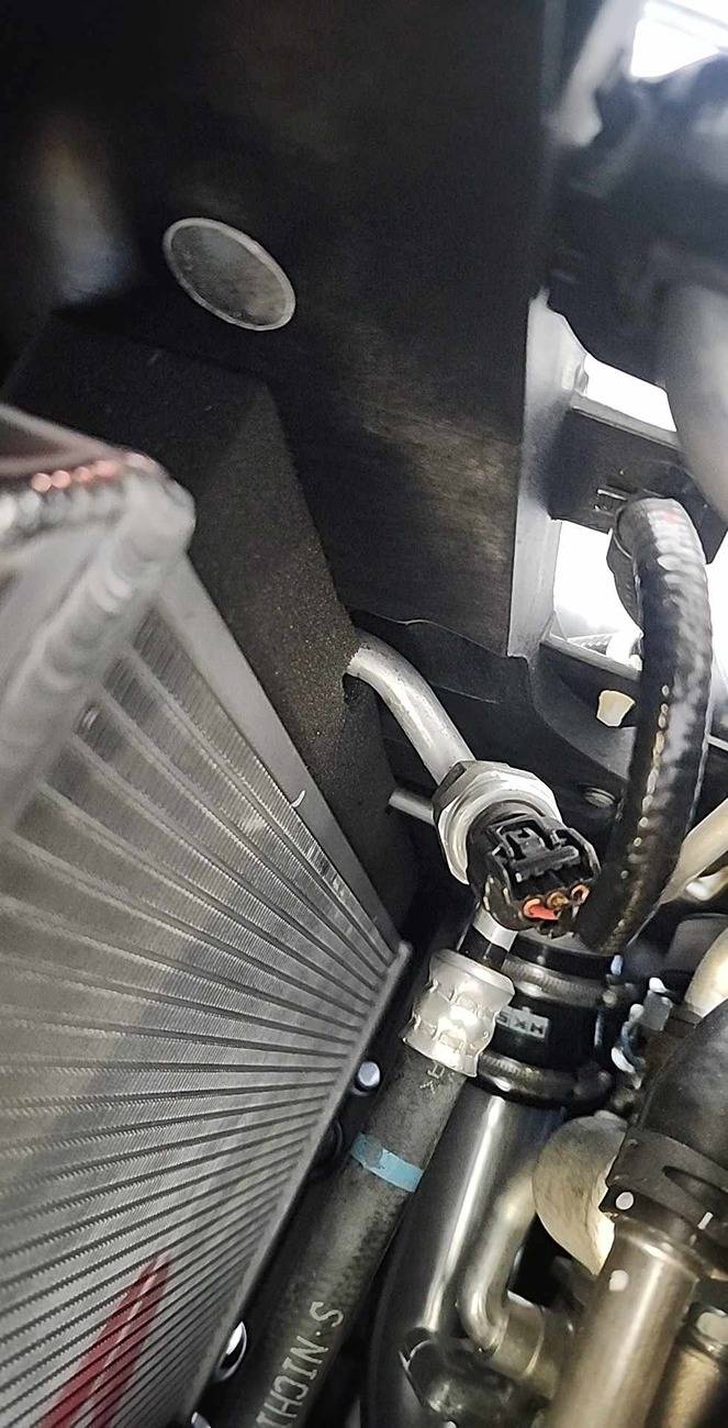

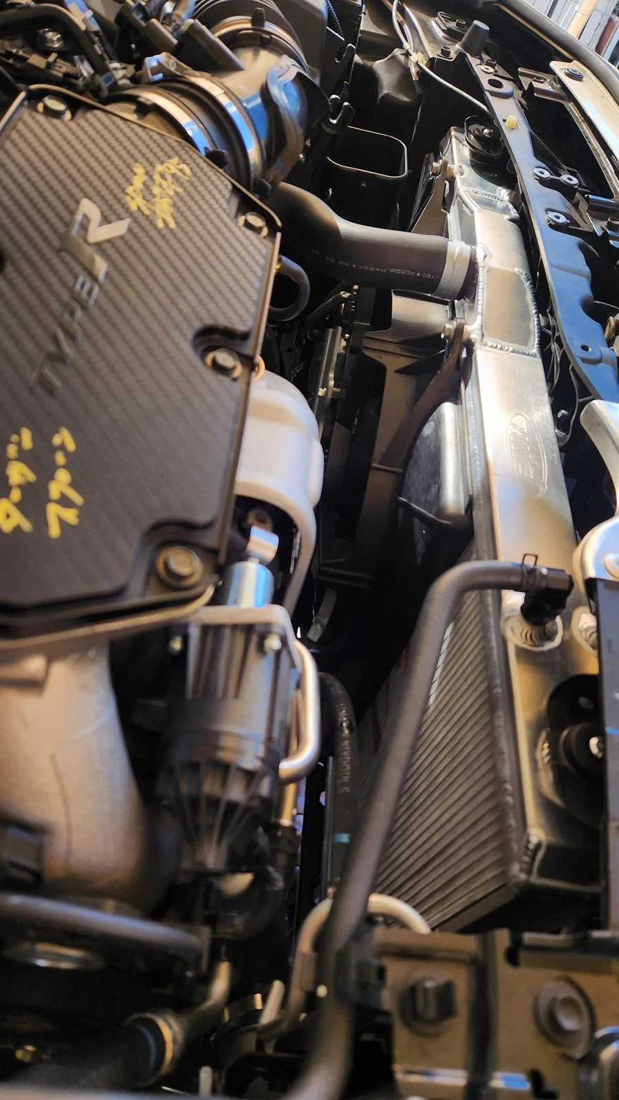

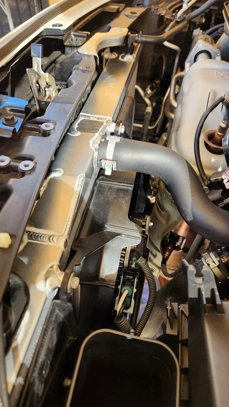

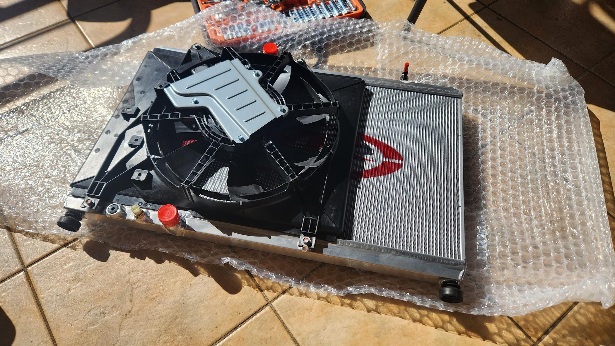

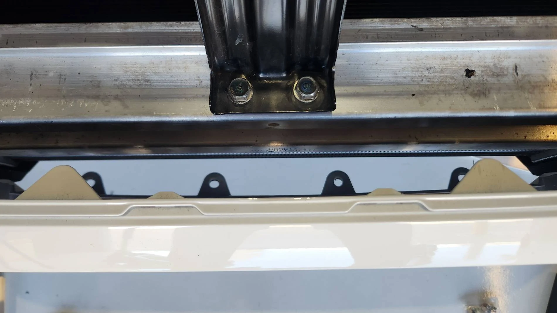

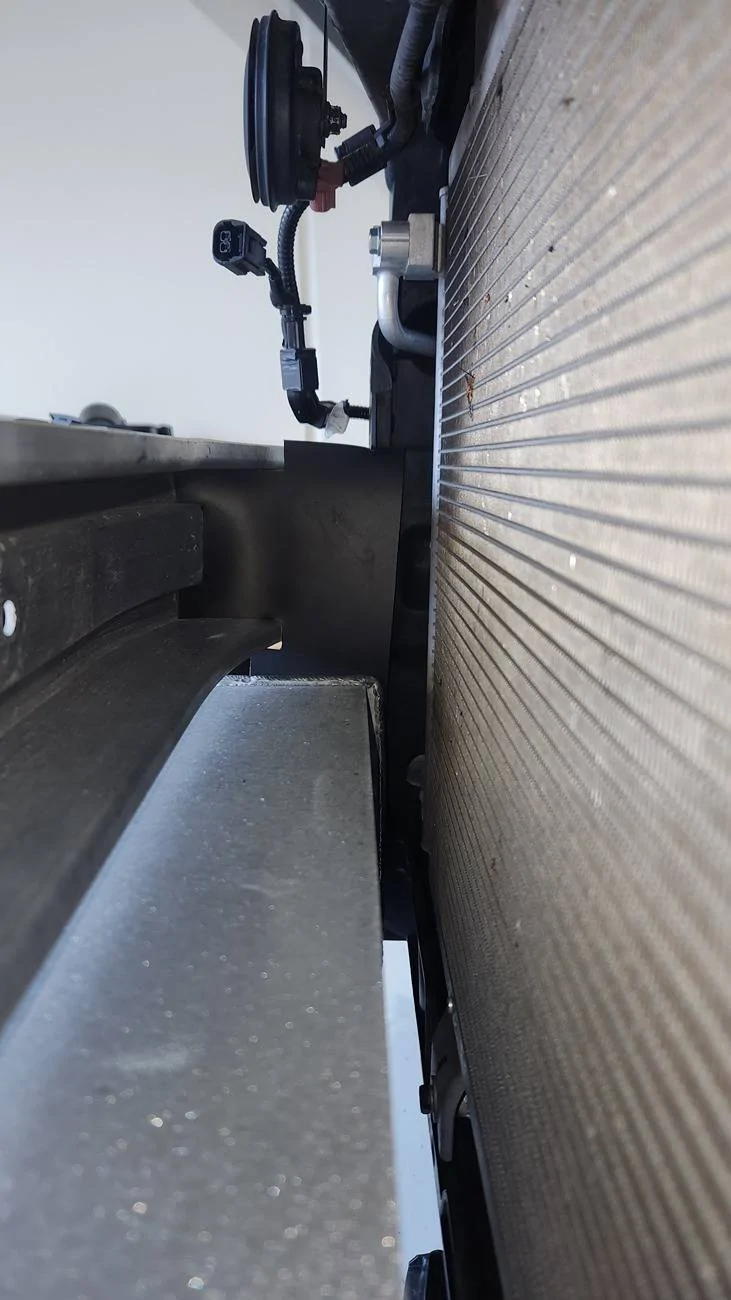

PWR elite radiator in.
No need to pull the front bar off to fit.
Airbox out, and loosen and rotate the cast aluminium airbox bracket under the ECU out of the way will make life much easier.
Then remove the big under panel trim attached to the bottom of the front bumper and you'll have access to the 2x M6 lower condenser bolts.
I also recommend snipping about 5mm off the end of the upper radiator hose which I didn't do, but plan on doing when I have some time cause I don't like how it's kinda kinked due to the extra thickness of the PWR over OEM.
One very important thing to note is that the oem top bolts (x2) holding the condenser to the radiator are too long and will bottom out onto the radiator before clamping the condenser brackets, so you need to cut these down, or run shorter bolts/more washers. Location circled in red in the last pic.
Will report back with data logs on track to see if the extra weight is worth it ?

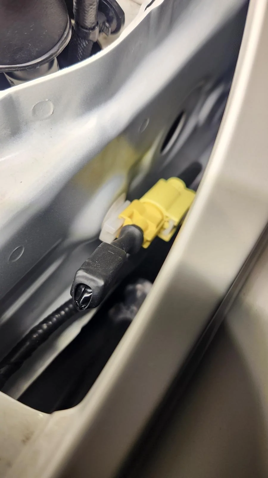

Made my own pop-up hood delete kit.
Basically comprising of 2.2ohm 5w resistors and the 2 pin SRS plug.
False activation of the pop-up hood on aggressive kerb mounting was a problem on Nissan's, not yet been reported on the Honda's but it's nice to save some weight and it's one less thing to replace (the hood hinges and the actuators) if something was to go a little pear shaped on track.

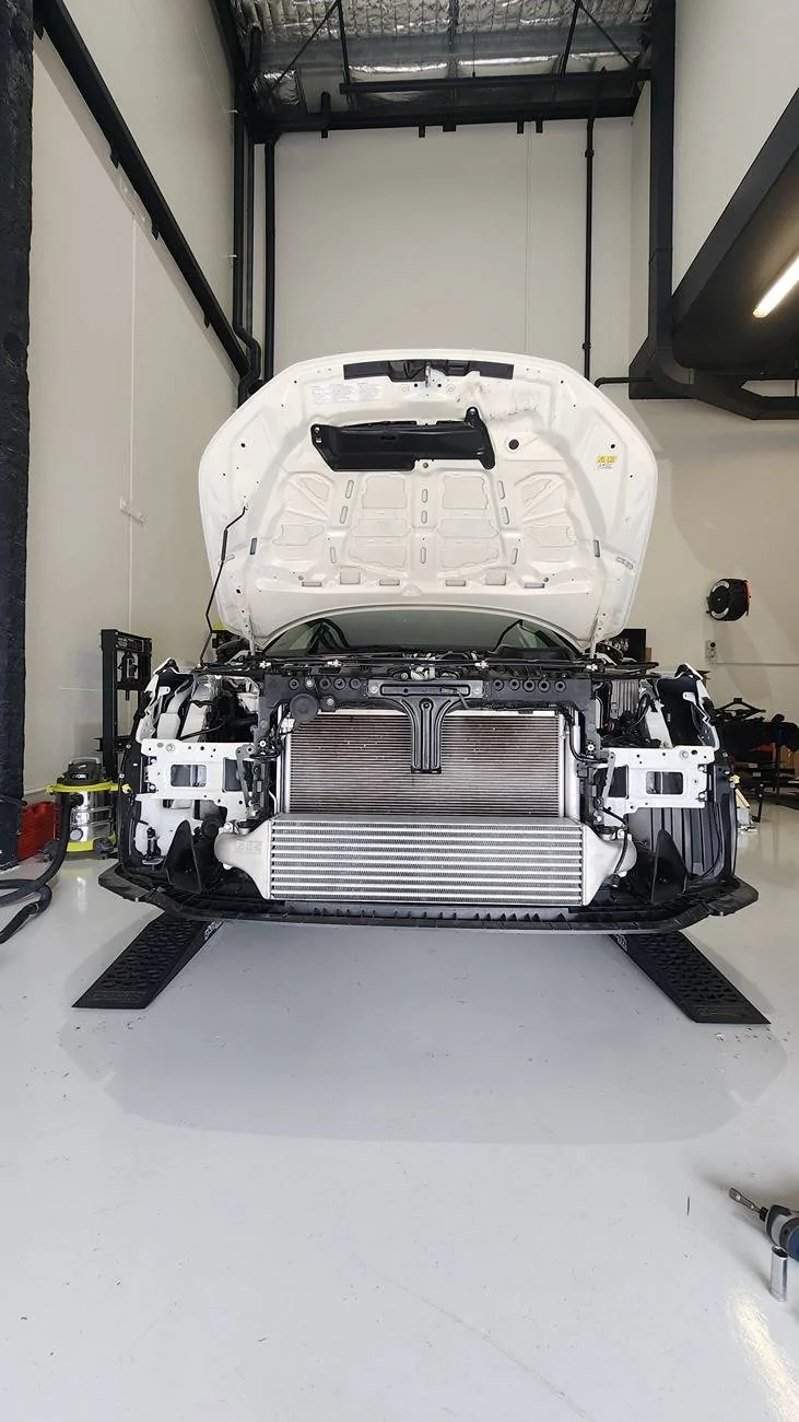

Apologies for the lack of updates. Life has been full on since starting up my own alignment shop. The car continues to evolve and the lap times keep coming down.
Latest updates:
HJS catted downpipe (sounds epic)
HKS IC with Piping Kit
Hondata Flashpro + Jester Tuned 98 Octane (equivalent to US 93)

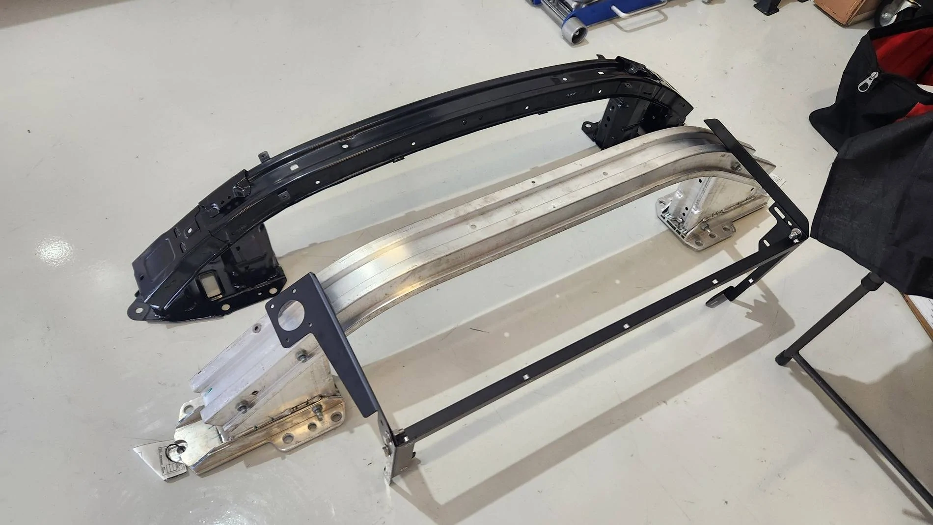

Aero in development - Battle Aero front splitter mounts do not work with the JDM/AUDM steel crash bar, so I got the USDM crash bar instead.
Turns out the aluminium USDM crash bar is heavier than the steel JDM by 2kg! The USDM bar is far more substantial, and extremely beefy, which serves as the ideal mounting point for the splitter. However it is not without its challenges, the USDM crash bar is a completely different profile. Which means the pop up hood actuating system (plastic thing sitting in front of the crash bar) also doesn't work, which then changes the front cooling channels completely as not running it opens up otherwise filled gaps between the bumper and the intercooler/condenser/radiator.

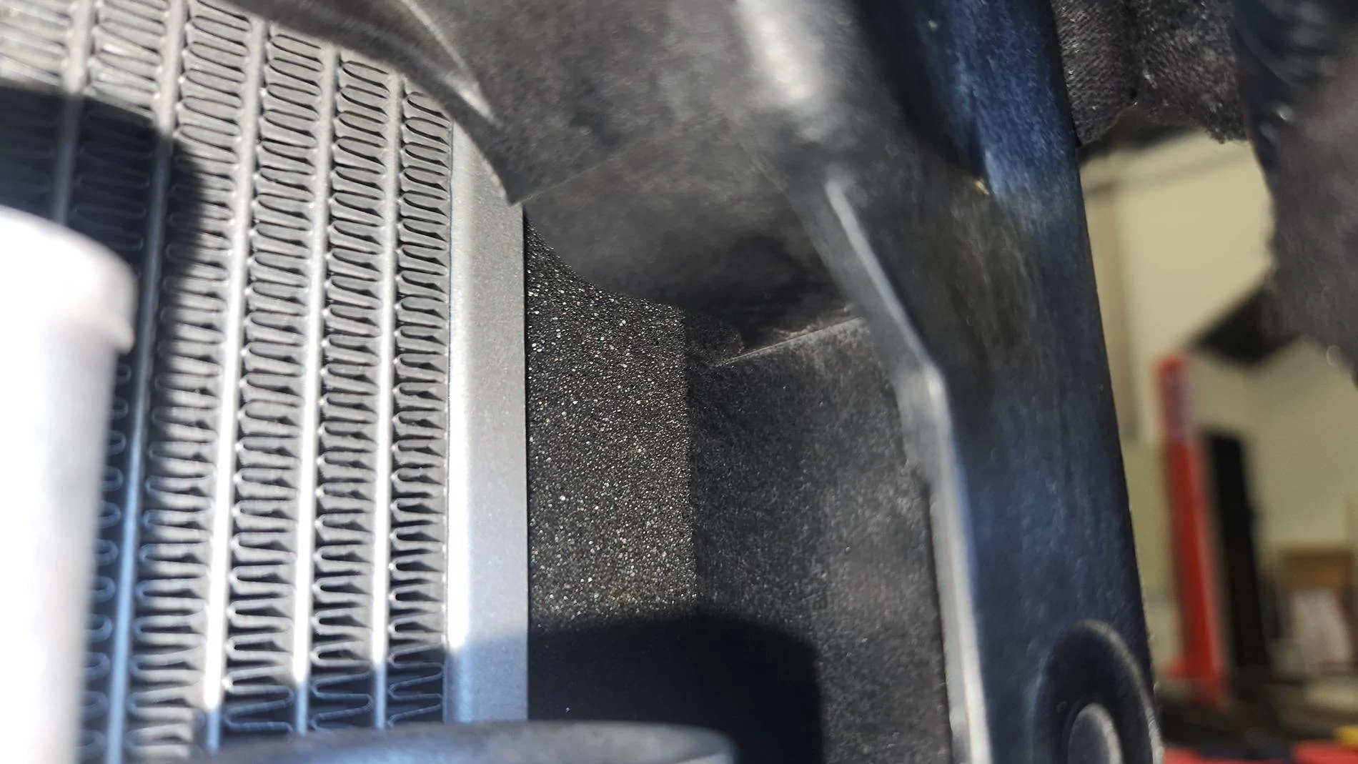

Currently working to close all those gaps to improve the efficiency of the cooling system, air just wants to travel the path of least resistance, so closing up all the gaps is absolute key maximise the volume of air going through the exchangers, and not around them through the gaps!
There are two very large gaps between the OEM glass fibre reinforced plastic radiator support panel and the radiator. So I've now sealed those off as best as possible with 30x30mm thick closed cell foam.
More updates to come.

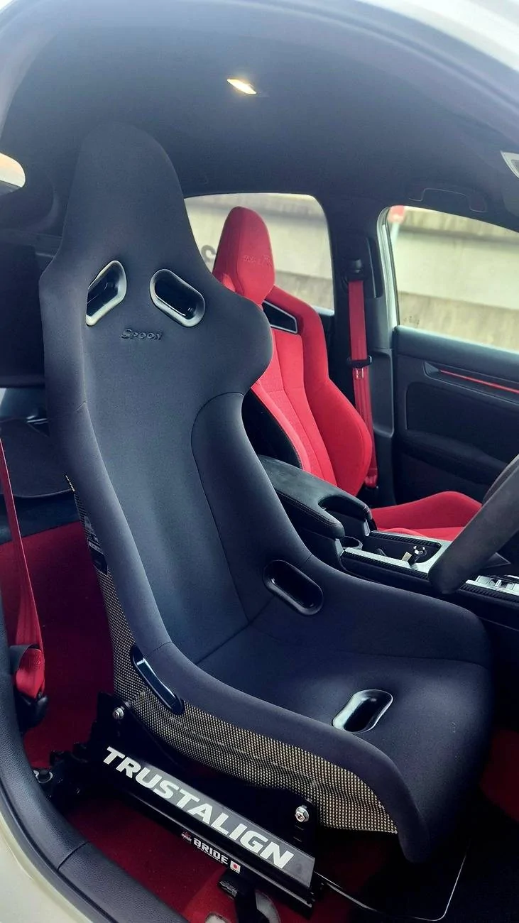

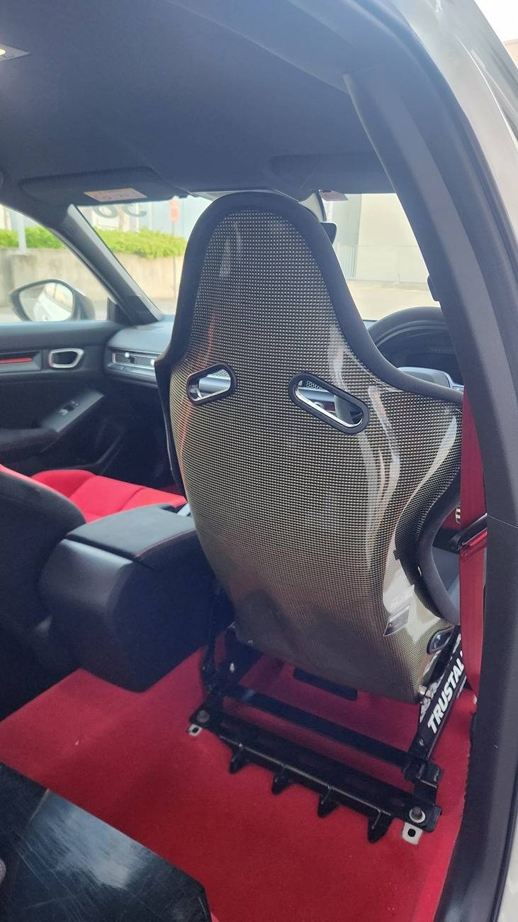

Spoon Kevlar seat in, saved 7kg over the stock seat.
Bride Type FO rails are quite heavy so I might pull them back out and mill out some unnecessary material.
If you're taller than 5'7" I recommend the super low version of the Type FO.
6 point harness system to come ?

How come you went with the HKS IC instead of the PWR?
Tougefl5
Banned
Banned
Jun 1, 2024
947
896
PWR don't make charge pipes. They told me it's design to work with stock parts. Sort of dumb when selling a big money part not to have supporting pieces.
