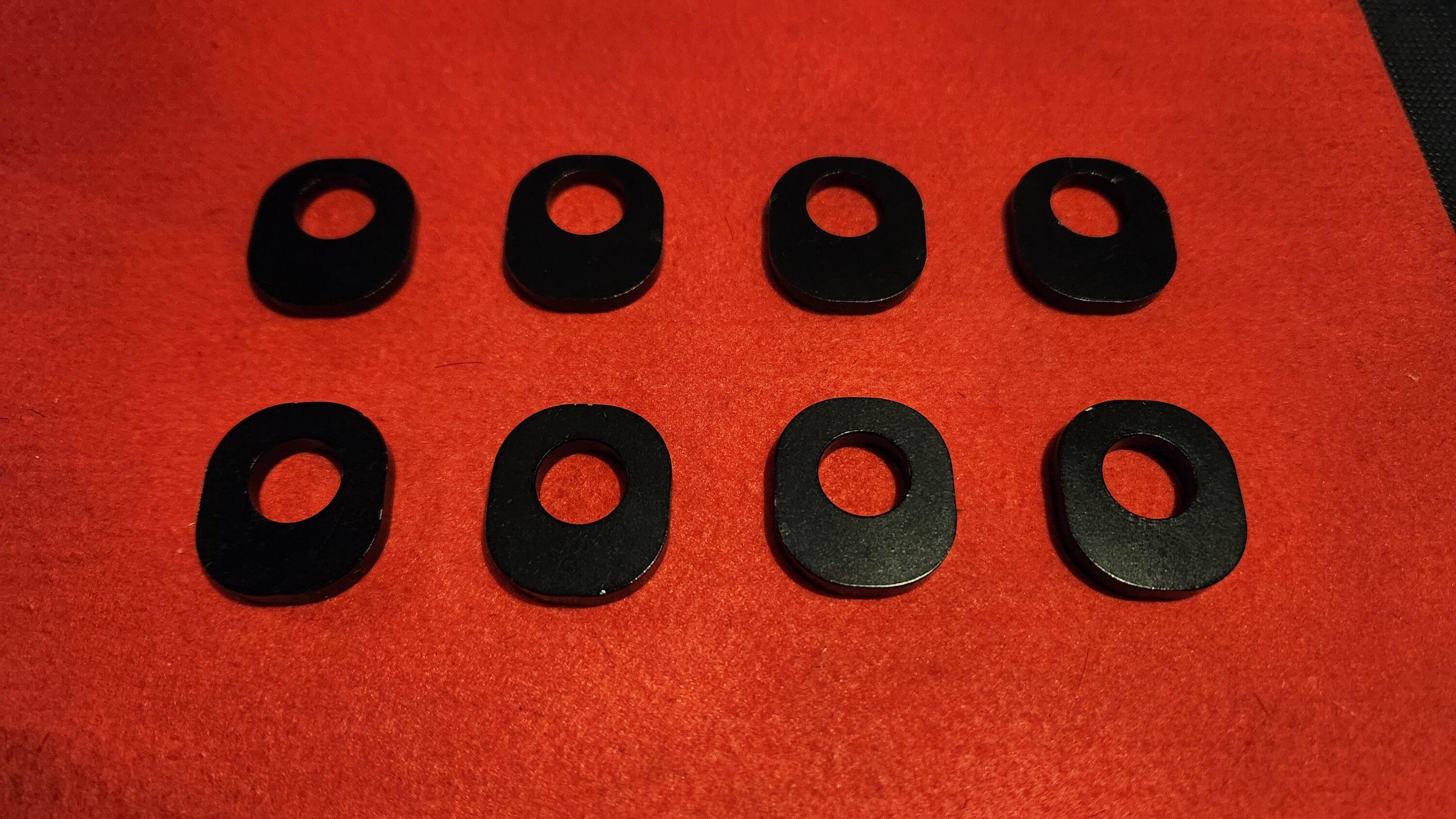

Progress has been a bit slow due to other commitments and life things.
But a small development I've worked with a local engineering shop to produce is custom offset flip chips for the Hardrace front camber ball joints.
The ball joints as they come from Hardrace offer full degree increments to camber adjustments ie. 0°, -1°, -2°.
The ones in the upper row are the 0/-2° pieces compared to the -1.5° custom made pieces on the bottom row.
This should allow me to run -3.2° front camber while keeping the strut positioned all the way in to maximise tyre to fender clearance.

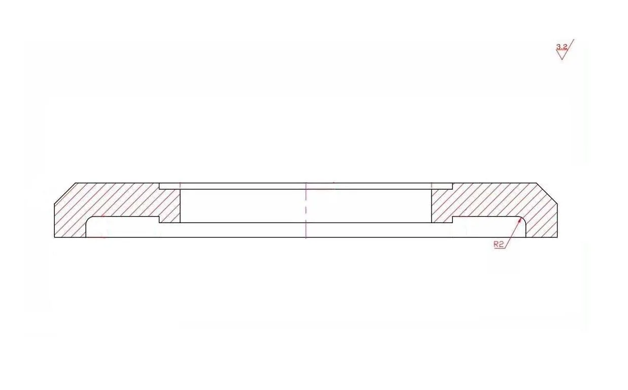

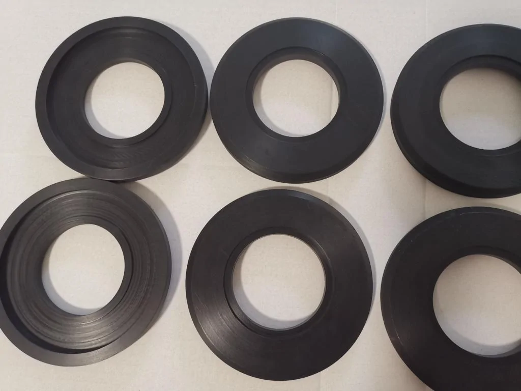

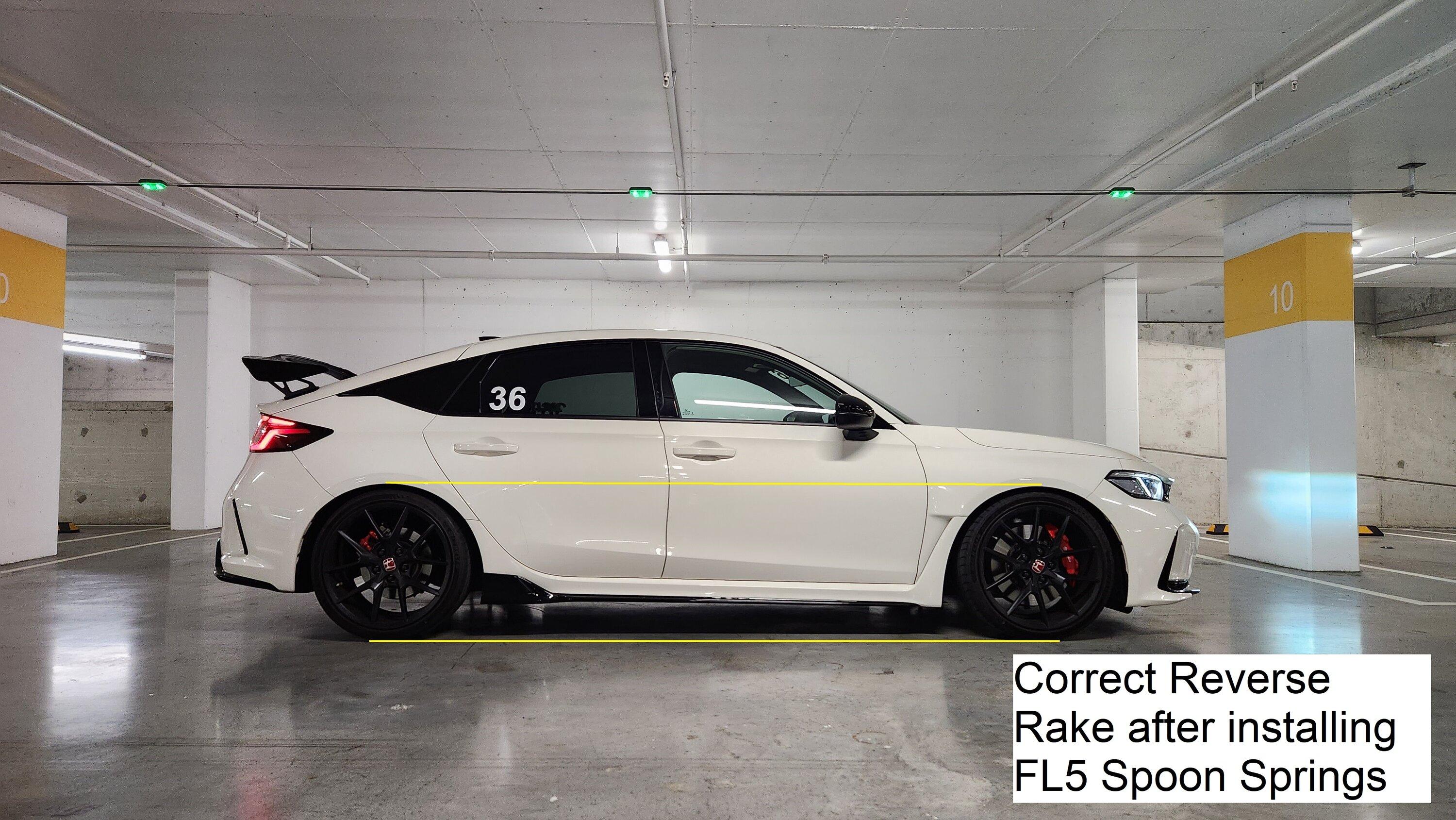

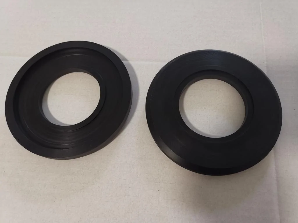

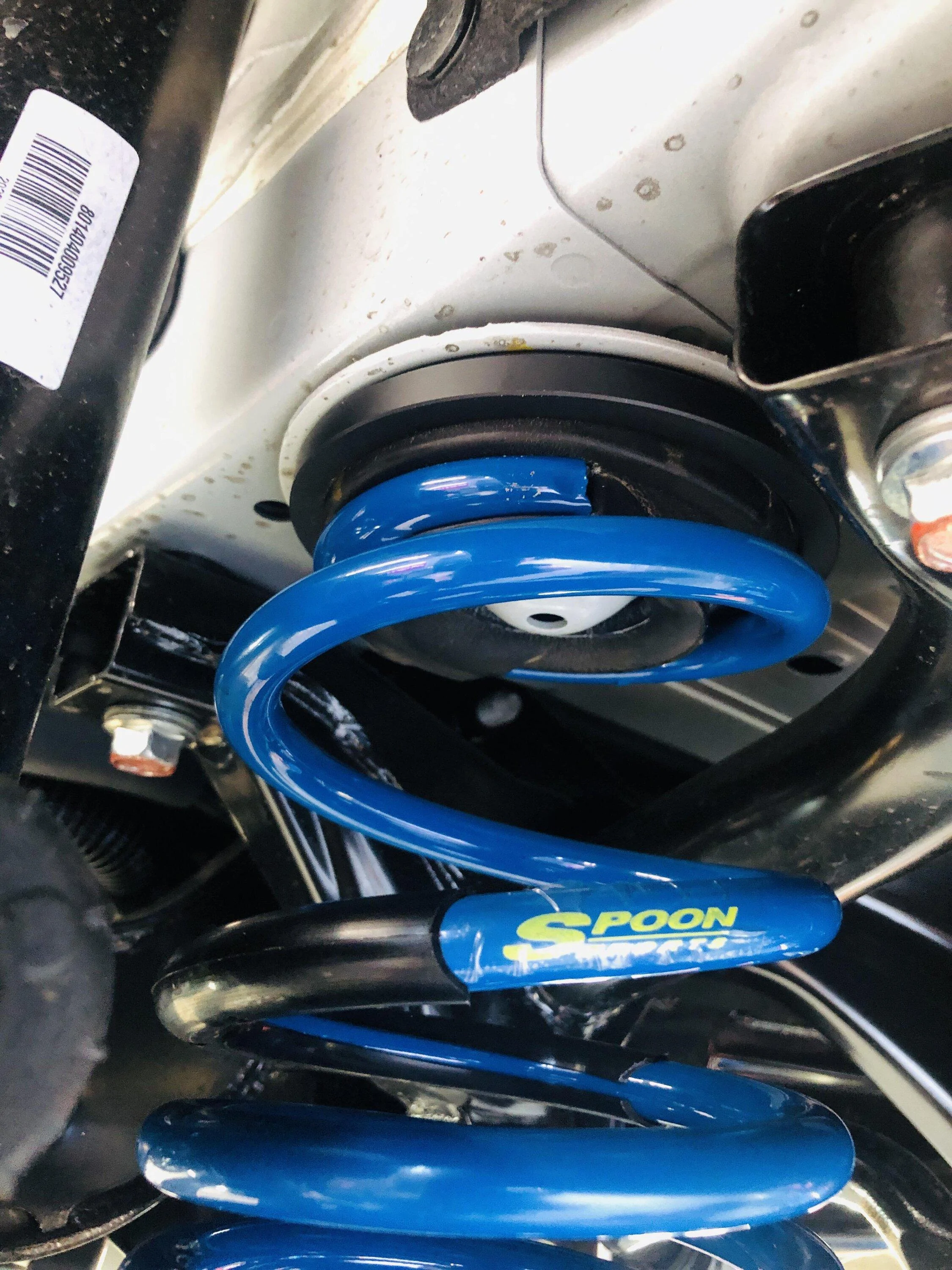

Additionally, the Spoon spring spacers have been officially developed.
Fitting them results in a perfectly level wheel arch gap on all FL5's with the Spoon springs.
Send me a DM if you wish to purchase a pair, thankfully they are very light weight so international shipping should be reasonably priced.
