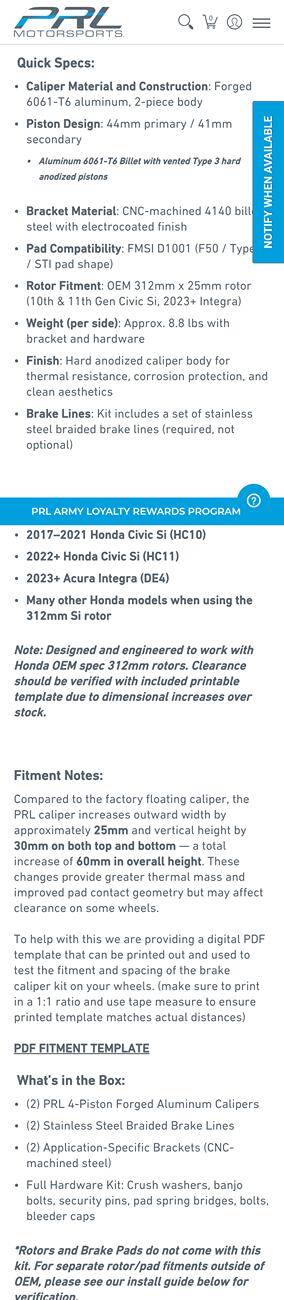

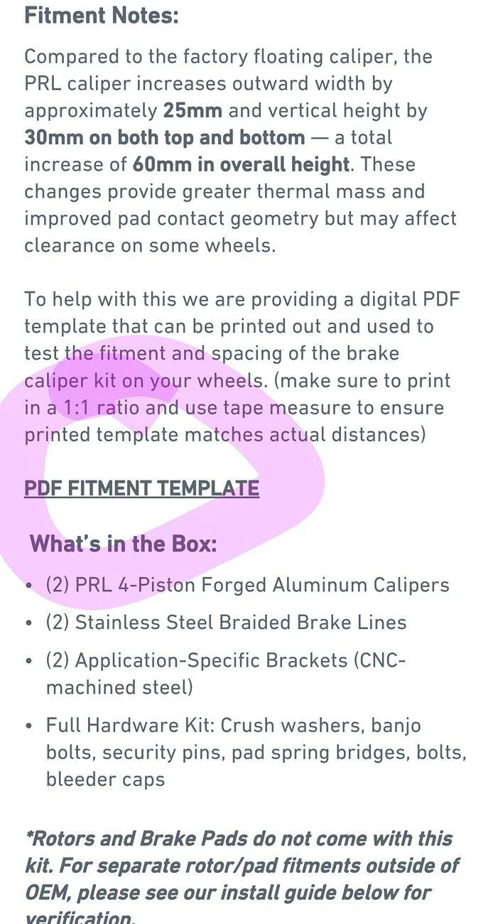

Interesting, I wonder if this will work with OEM SI wheels without a spacer. Can't find anything in the instructions.
There's a link to a PDF fitment template on the information page
