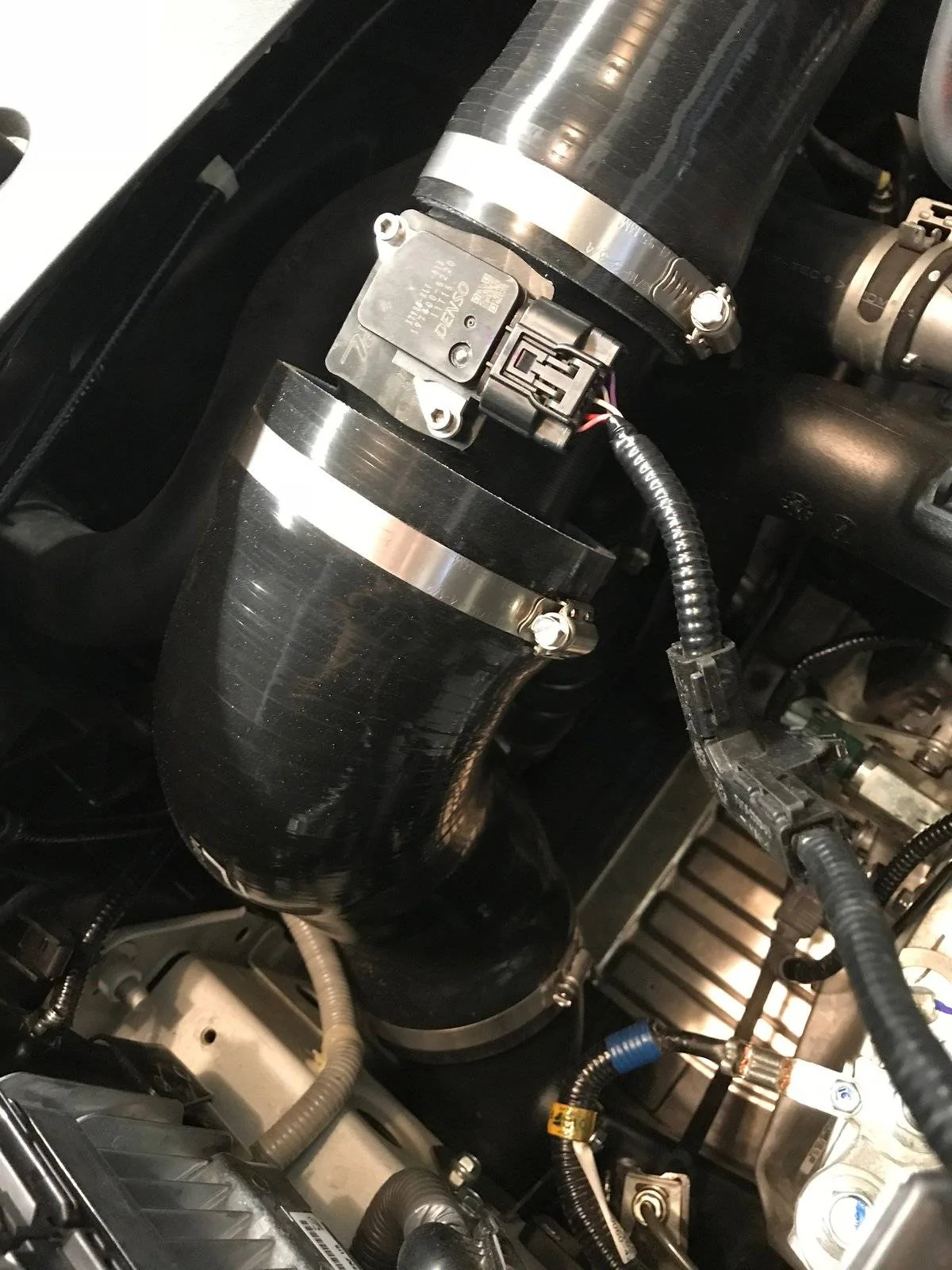

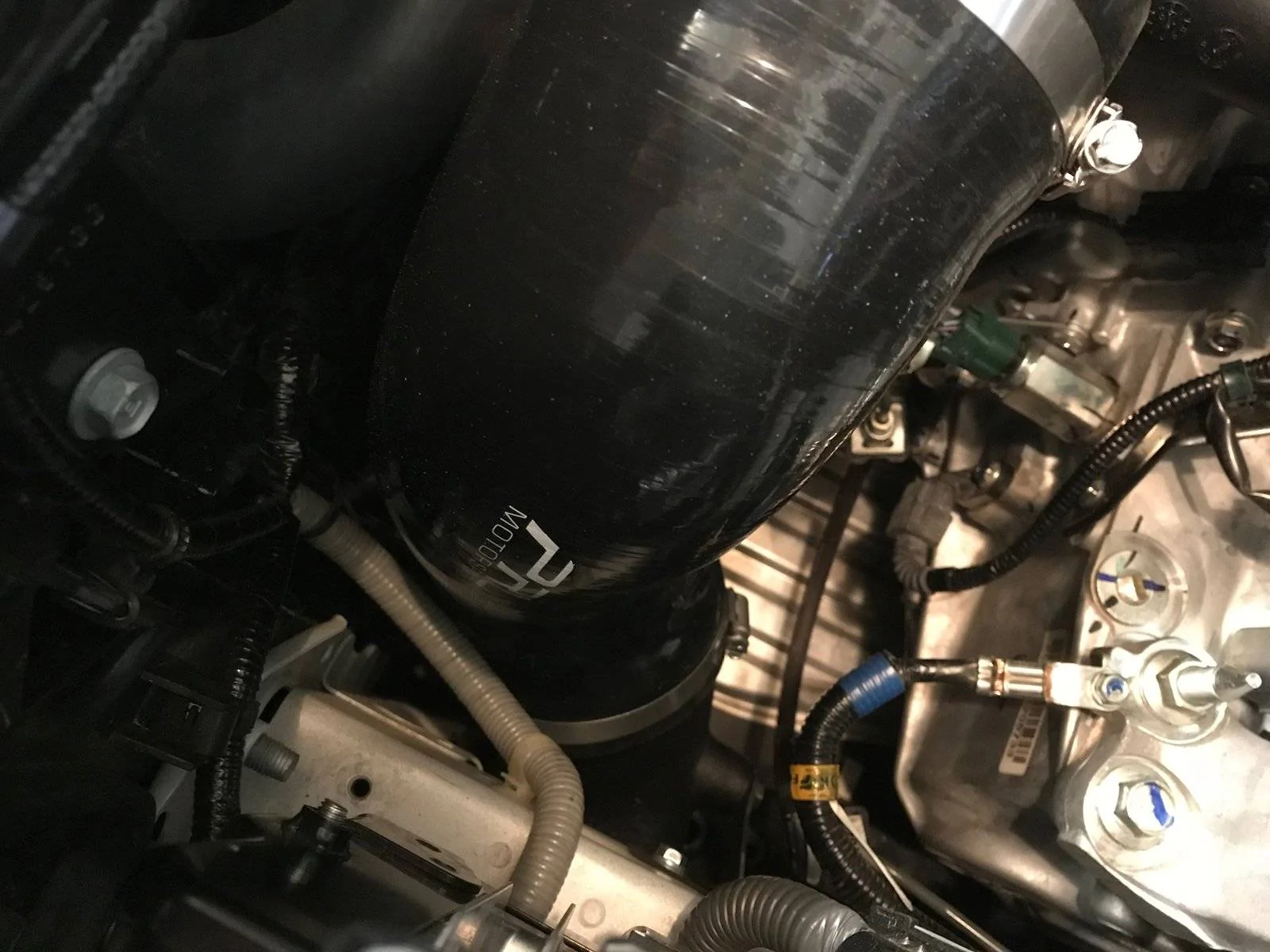

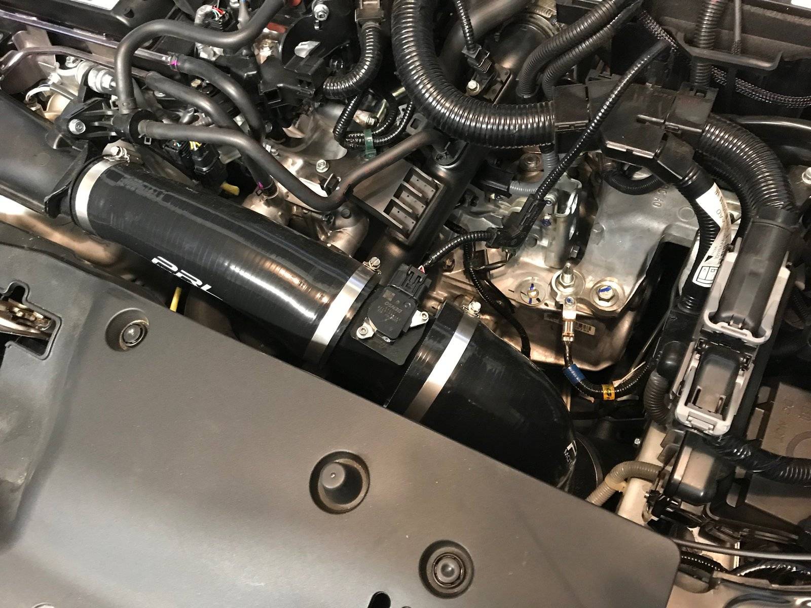

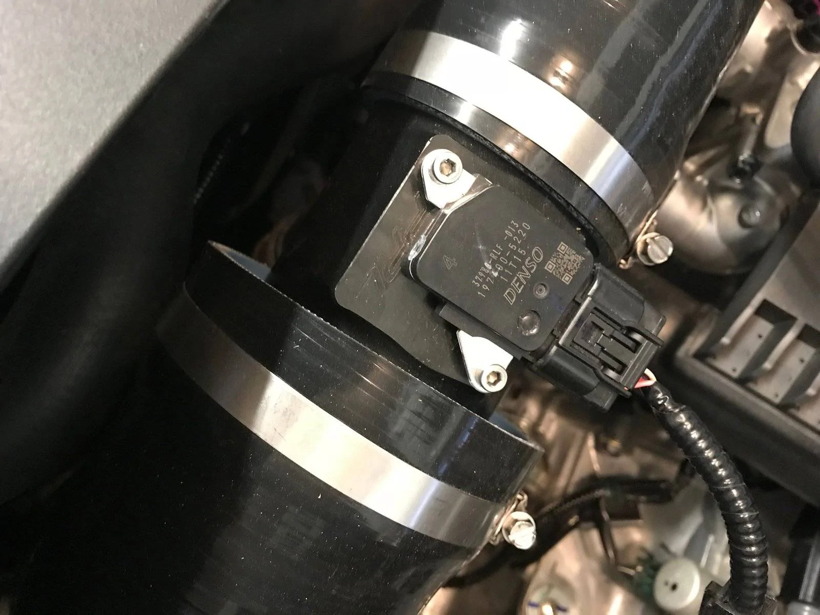

Here are some photos of it installed in my Sport hatchback. I went with the Race MAF housing and am finishing up tuning for it. I have some benchmark testing (vs the OEM intake) planned and will follow up later with results. Early signs regarding a measurable street performance gain are looking good! :thumbsup:
