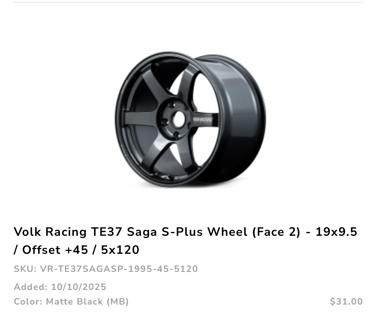

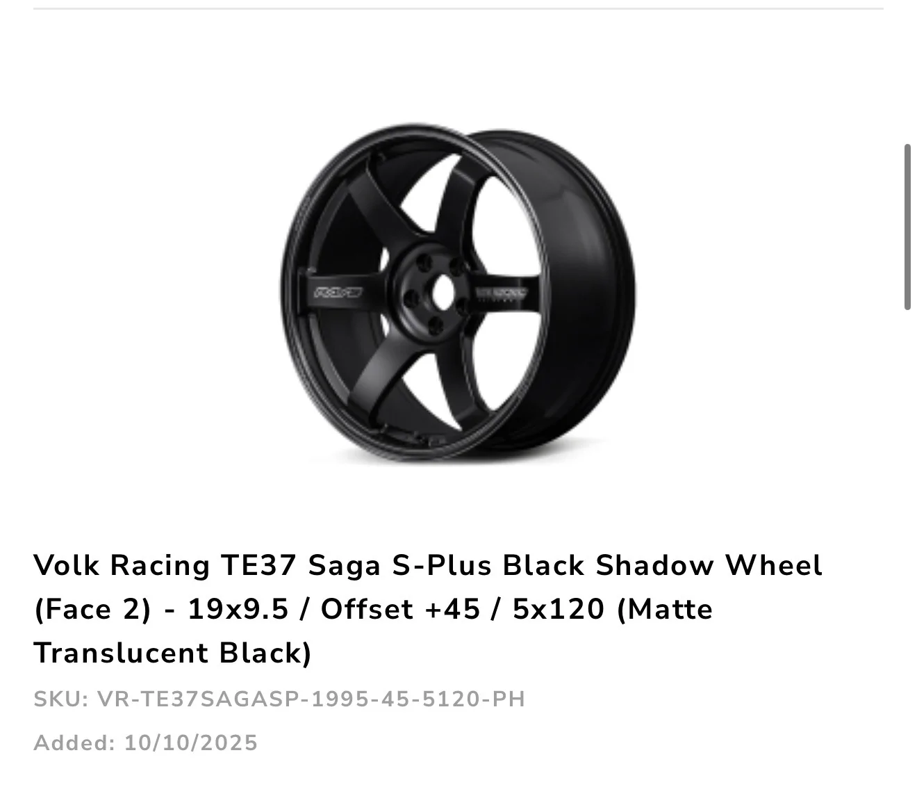

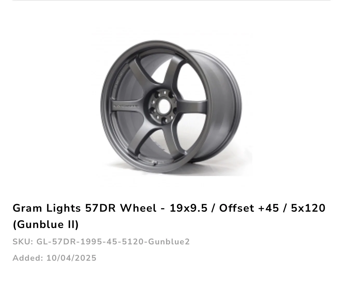

I was looking at Evasive Motorsports and they have a few options. There’s the Gram Light 57DR 19x9.5+45 gunmetal blue, the Te 37 19x9.5+45 on matte translucent black and matte black, and one of them says “face2.” I don’t understand what that means.
I’ll stick to 19-inch wheels with 265/30/19 Michelin tires. On 18-inch wheels, I’d probably have more tire choices, but I don’t like the look of them. They’ll also be lower, probably on H&R, which is the one that lowers the car the most, but not too much. The other option is the Fortune Auto 1k coil sleeve, which would lower the car 1/4 inch to 1/2 inch. I don’t think it’s worth the premium for me.
Will I have rubbing issues on the stock ride height? Or will I have rubbing issues with the .75F/.60R tires from H&R while running +45 on the car?

And as far as the "face2" that just means the face profile. Profiles determine the spoke (face concavity) and wheel hub thickness which is majority of the way wheels can be made to adjust offset. More concave face usually starts at face 3 and 4 on Volk wheels (including gramlights). Face 2 has a slight concavity. Face 1 is effectively flat and sometimes look convex.
You shouldnt have any issues with stock tire size on 9.5 +45 even with a slight drop.
