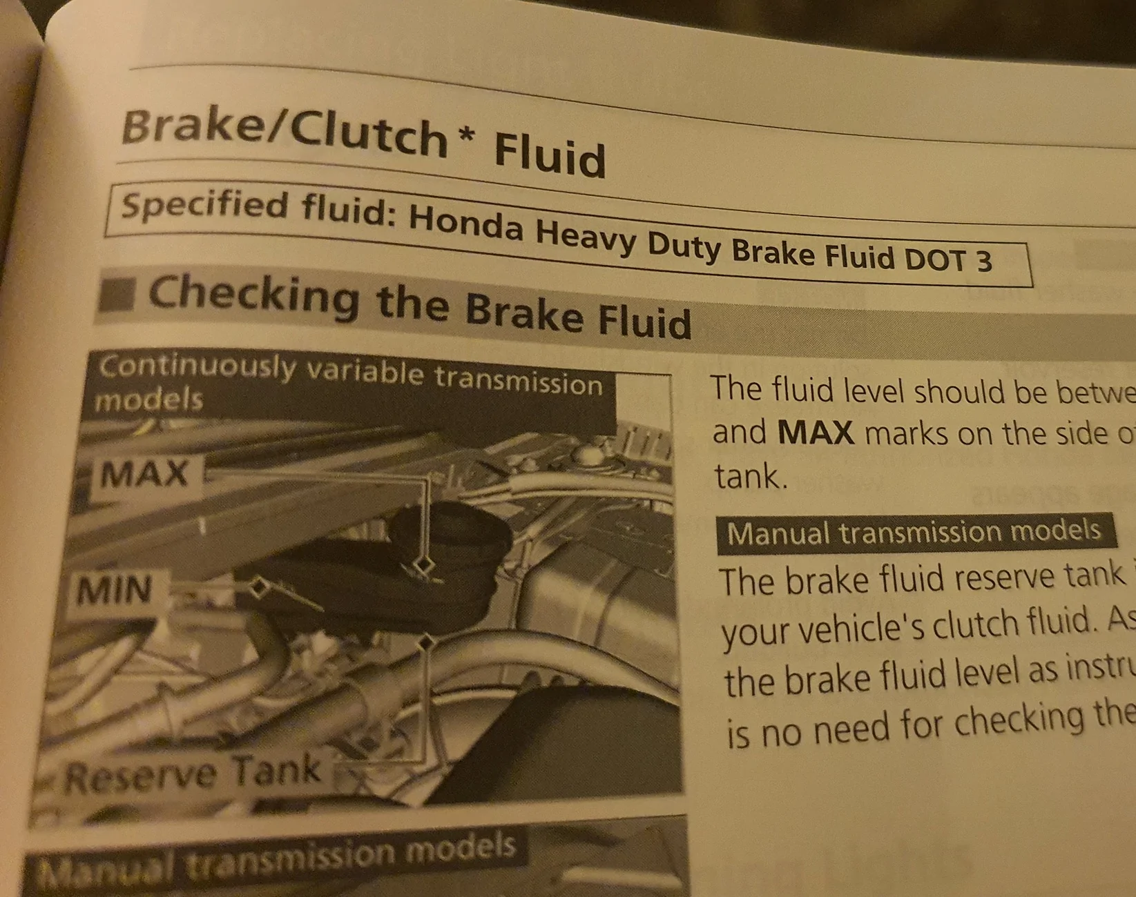

FWIW - Honda cautions against using DOT 5
"Brake fluid marked DOT 5 is not compatible with your vehicle's braking system and can cause extensive damage."
May or may not have to deal with sharing a common reservoir with the clutch system
FWIW, DOT 5 is not DOT 5.1.
DOT 5 is not recommended for any brake system that wasn't originally equipped with it, because it's a completely different chemistry from DOT 3/4/5.1
DOT 5.1 was created to give DOT 5 performance in a chemistry compatible with DOT 3/4.
DOT 5.1 should have been called DOT 6, but here we are.
DOT 5 is NOT compatible with any other DOT. It does not have to do with the common reservoir. it has to do with the chemistry of DOT 5
however, DOT 5.1 is compatible with DOT 3 and DOT 4
DOT 3, DOT 4, and DOT 5.1 are all glycol-ether based fluids
DOT 5 is silicone-based, typically containing at least 70 percent diorgano polysiloxane by weight.
This makes DOT 5 hydrophobic, meaning it repels water and does not absorb moisture like glycol fluids do.
In contrast, glycol-based fluids are hygroscopic and designed to integrate water into the mixture to maintain performance.
