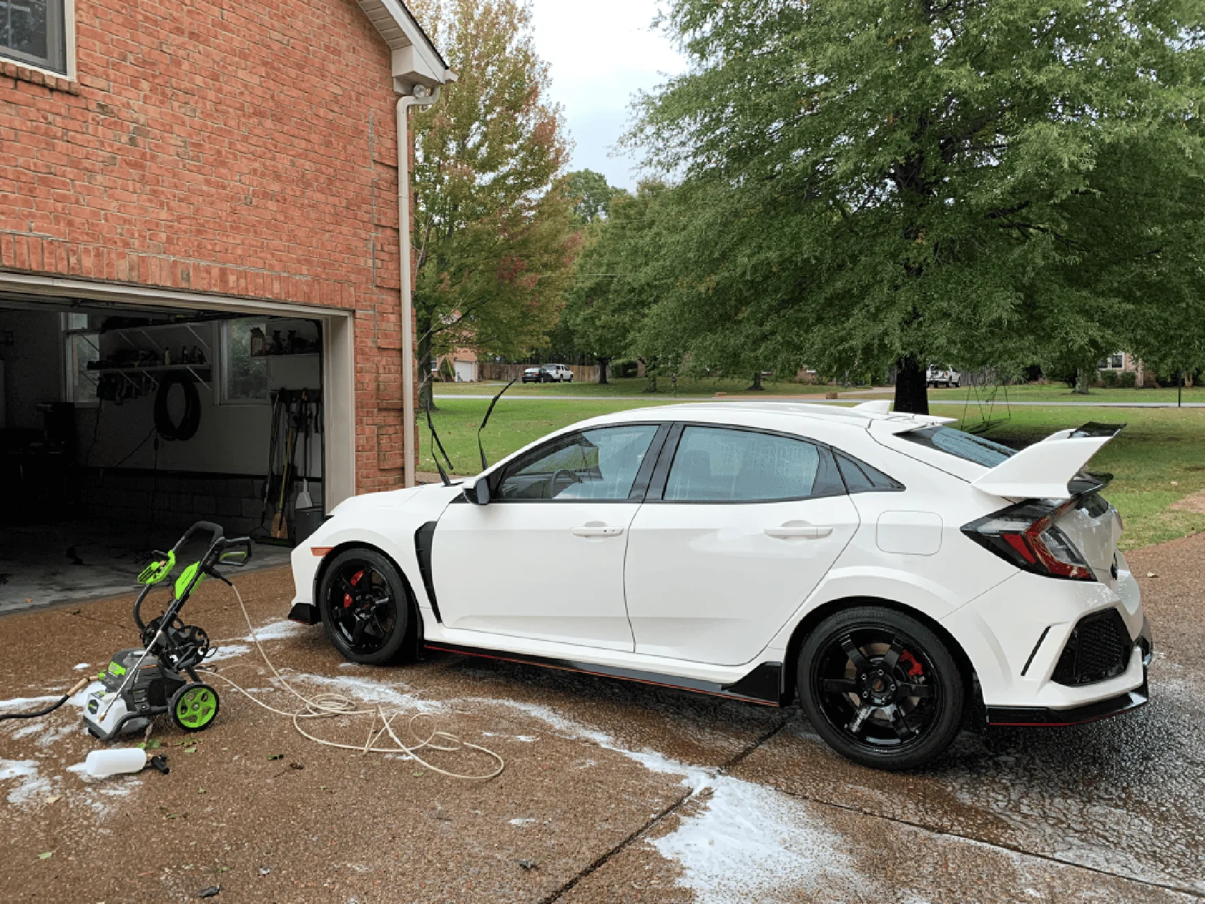

This is my stock height FK8 on 18x9.5 +45 SAGA with 255/40/18.
11th Gen Honda Civic Rchive- An FL5 ownership journal IMG_0796

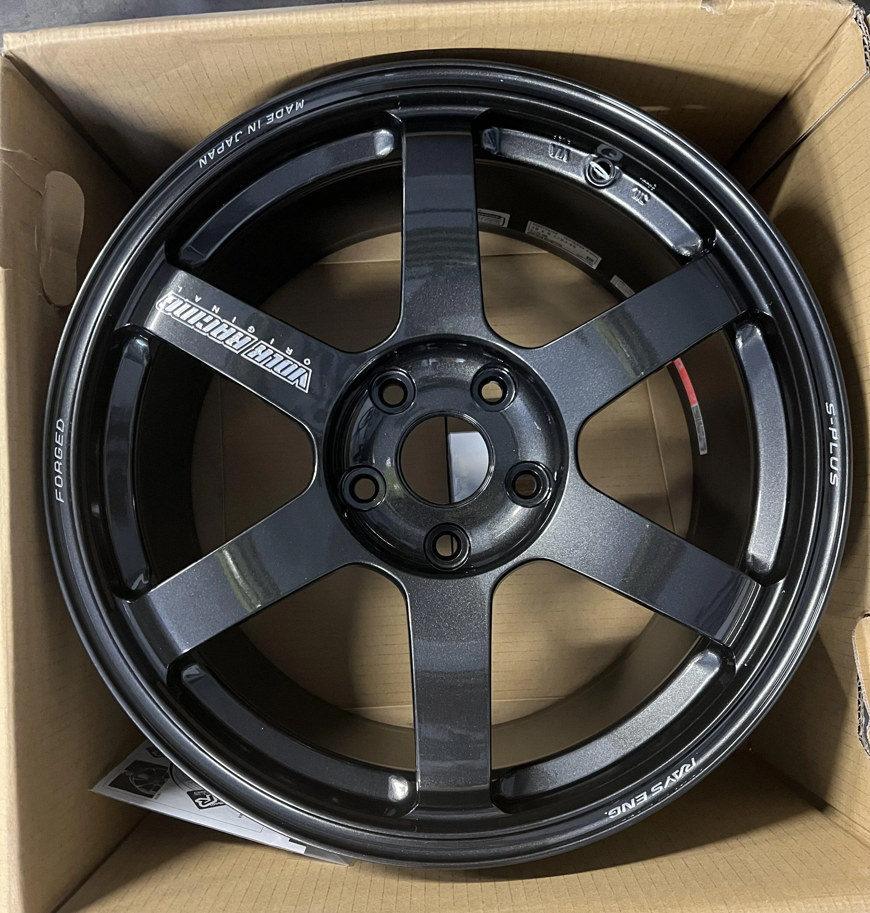

In my typical theme of doing opposite what I say, I ordered 18s this afternoon, haha! I got TE37 Saga S-Plus in the same size as my FK8 above, but in Diamond Dark.
There are several reasons why.
The biggest reason, though, is Austin Smith from Vivid Racing. They have a few extra sets of TE37s, and are unloading them at berserk clearance pricing, which I couldn’t say no to. Austin worked his ass off for me, was so patient with my questions and his time.
I might eventually get Ohlins, but in the interim, I’ll run these SAGAs on 200TW tires to get the lateral grip up to where I want.
And that’s another thing, aesthetics can take a backseat to performance when I want/need the grip. The main issue here is there isn’t diddly squat for options in the stock tire size. 18s are a fraction of the cost with every popular 200TW choice available for the taking.
You could get away with not lowering an FK8. And some of the reason why is the stock tire was .5” taller than the FL5 tire.
So I’m trying to find similar math height difference to my FK8. People regularly ran 245/35/20 stocks on that car.
This makes me think I can get away with 265/40/18, which is the 18” conversion of an equivalent upsize of 265/35/19.
With very dark wheels, the visual line cutoff of the wheel to tire is somewhat blurry and eye tricking as seen above.

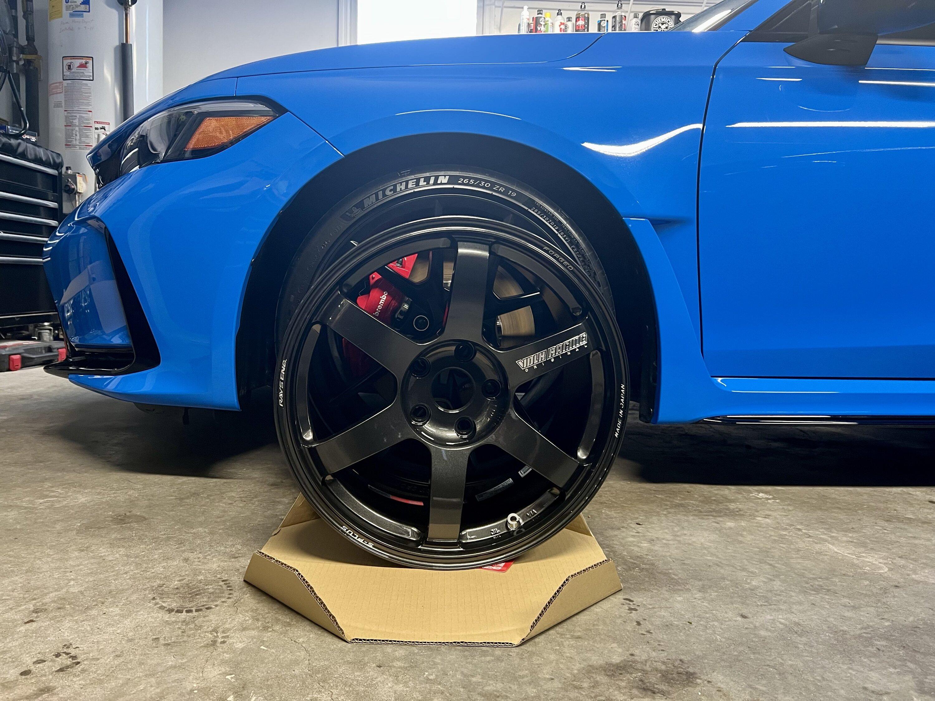

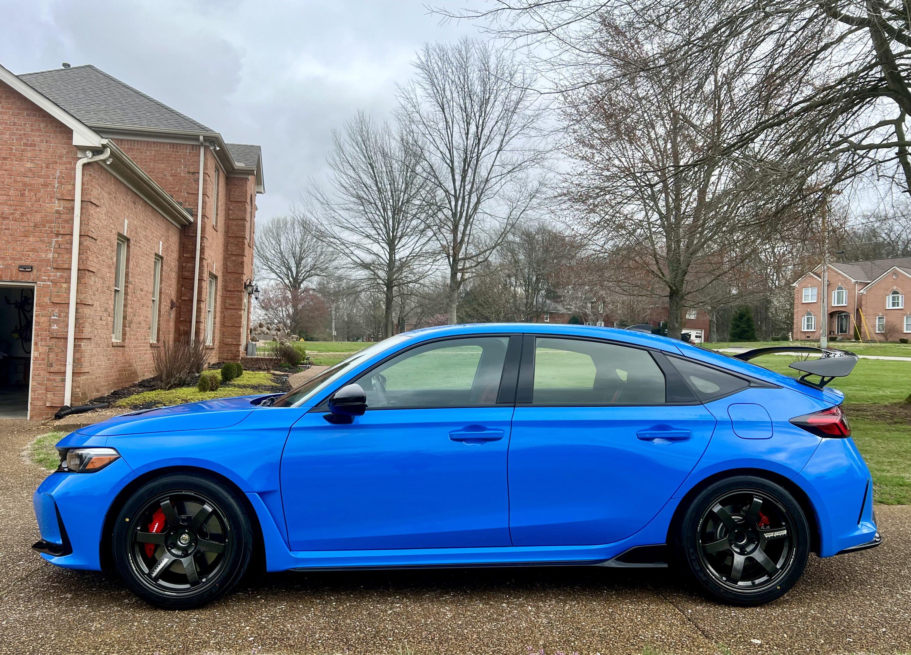

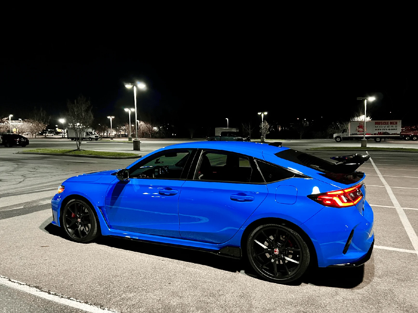

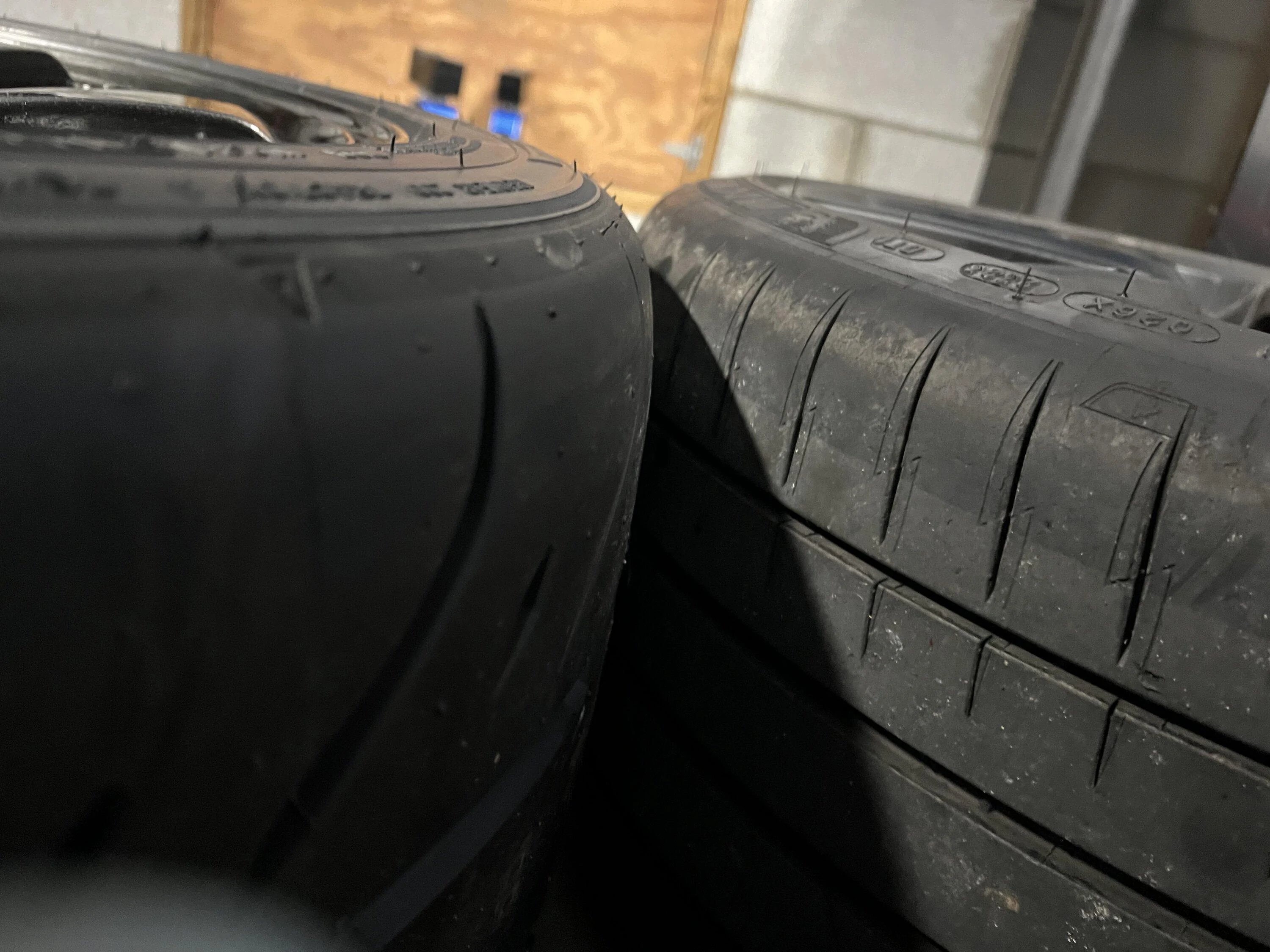

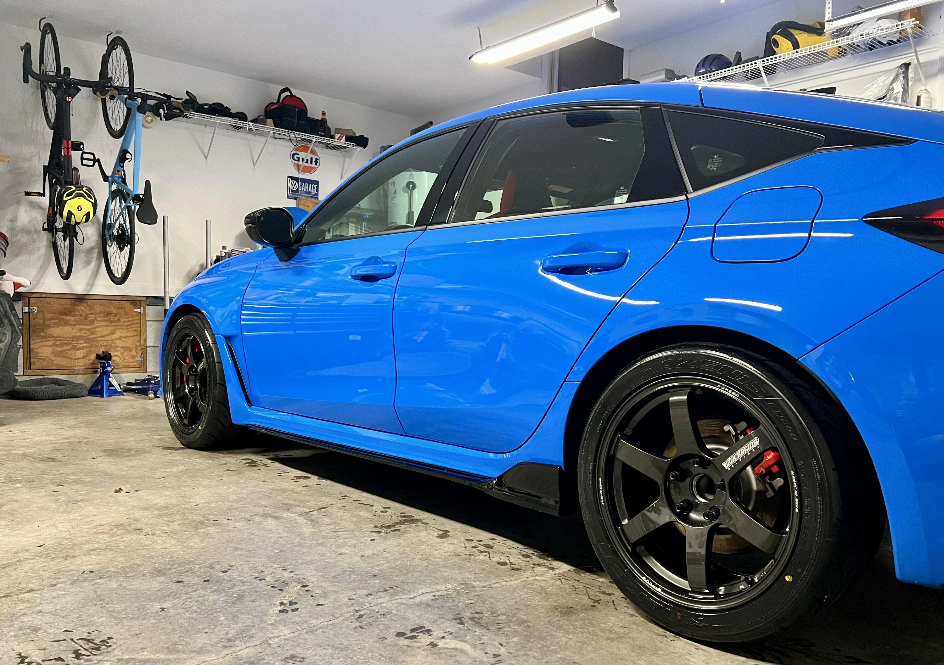

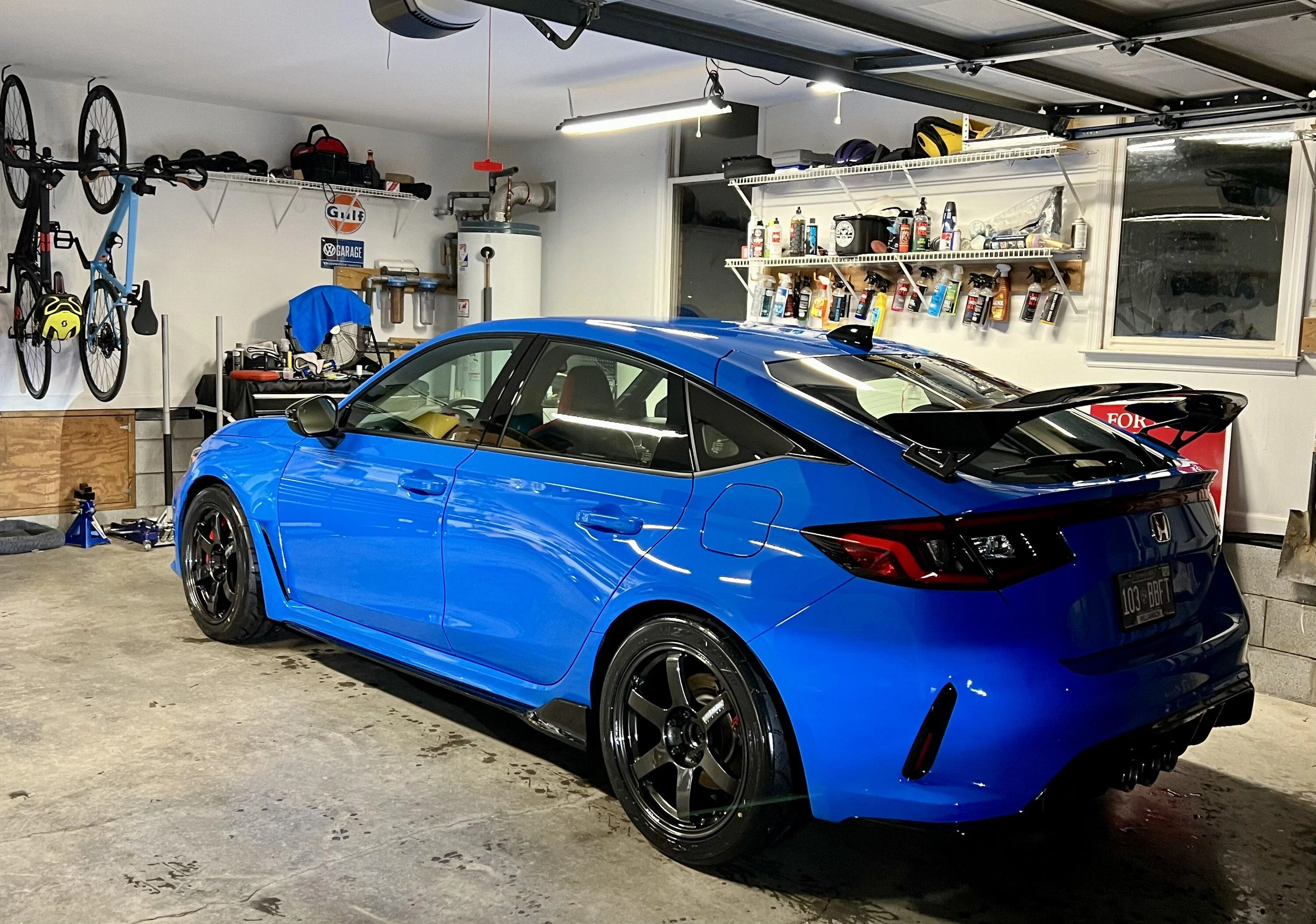

Installed.
Stock wheel/tire combo is 52 lbs even on my bathroom scale.
This combo is 47.2 lbs each on the scale. For the sake of convenience, I'm calling that a 20 lb loss in unsprung weight.
255w tires listed above are Azenis RT660, which run wide, and look as wide as the stock 265w rubber.
Visually, I am really happy with the decision to run this size and not to lower it. It's the best compromise I could come up with to not lose my linear springs feel, not induce extra impact harshness, and still keep my ground clearance.

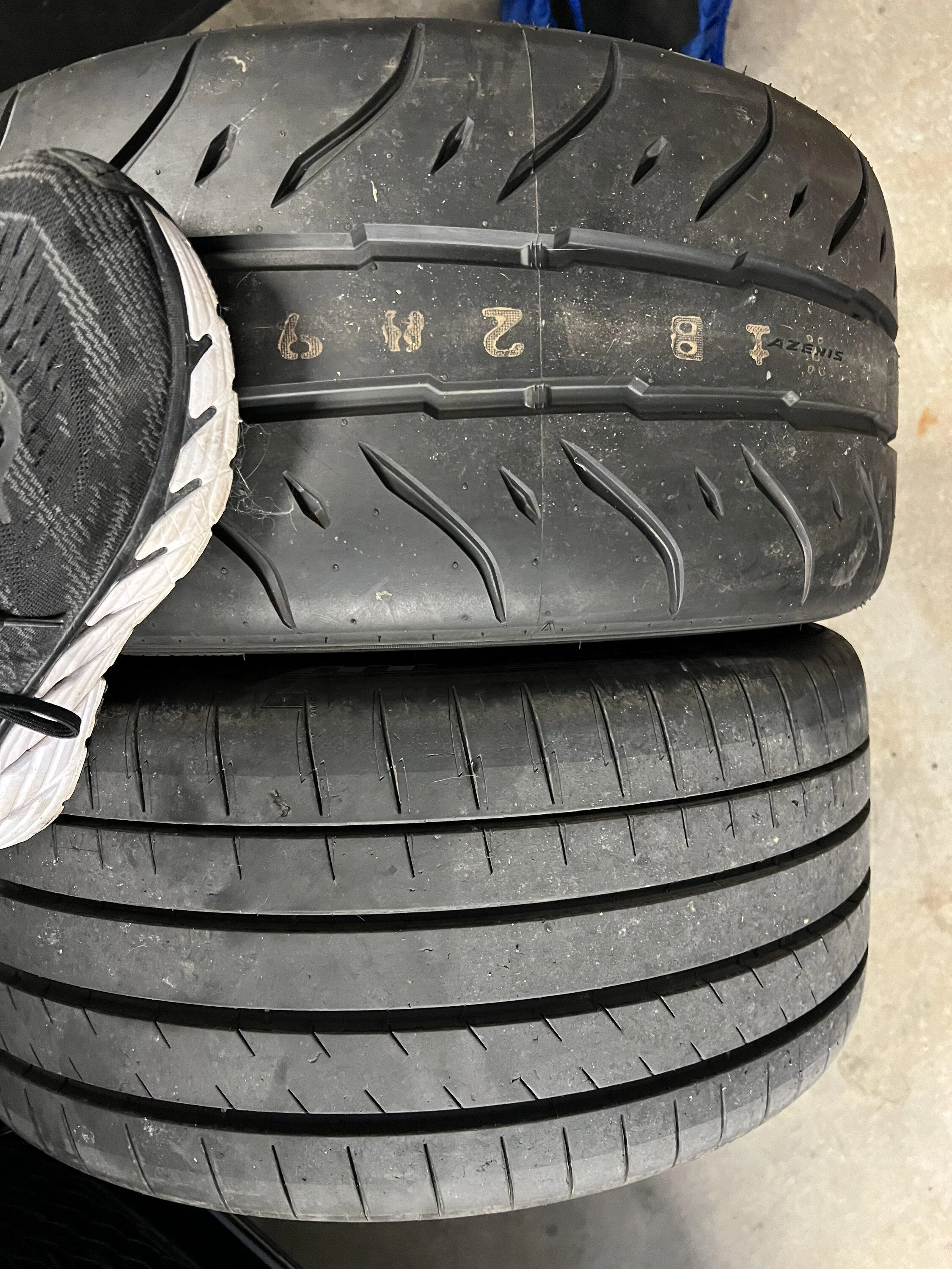

I took it for a lengthy drive this morning, some highway, then back on super curvy backroads. I was gentle on it at first, because sometimes new tires can be scary with squirminess or sudden loss of control from the mold release compound. Fortunately, that was not the case here.
Let's get the negatives out of the way here first. Just like the FK8, going from a +60 to a +45 alters the scrub radius to some degree, and you'll feel some torque steer. It's not a huge amount, nothing like FWD cars from the 90s, but in certain scenarios, you're going to have to use a bit more muscle on the wheel. The other thing you'll notice with 18s is the amount of cushioning between the wheel and the road that gives some isolation, or I daresay a loss of sharpness and feedback. This is not a loss of control- quite the opposite with these tires- but a numbing of communication. Think a handshake with a thin glove.
Lateral grip for days and days was achieved. Good grief, the biggest part of this whole exercise is that these cars need or deserve 200TW tires. I think they were designed with them in mind. The car is a grip monster, and they match the chassis so much better. The Azenis, like any other 200TW tire, are louder than the PS4S. Not to a big degree, but they are odd at certain times. They have an interesting sound when you cross over painted road lines that normal tires do not. But my goodness, they are perfect for turn in accuracy and maintaining preposterous grip, even with a 40 series sidewall. To me, a loss of feedback for a huge gain in grip is a worthwhile tradeoff. I want my car to BE fast, not just FEEL fast.
One great thing about the extra isolation is that you can wick up the setting on the suspension. I drove a twisty road in +R, and could tolerate it without issue. On the stock rubber, it was mostly unusable.
Some people say TE37s are used excessively. I can't argue with that, why mess with a proven formula? I bought my first set in 2000 for my 2000 Honda Prelude, and have been a repeat customer ever since. But you know what is used even more excessively? Freaking Y spoke wheels. They are like 90% of wheels on the market, and such a tired design to me. TE37s are super lightweight, and easy as can be to clean.
