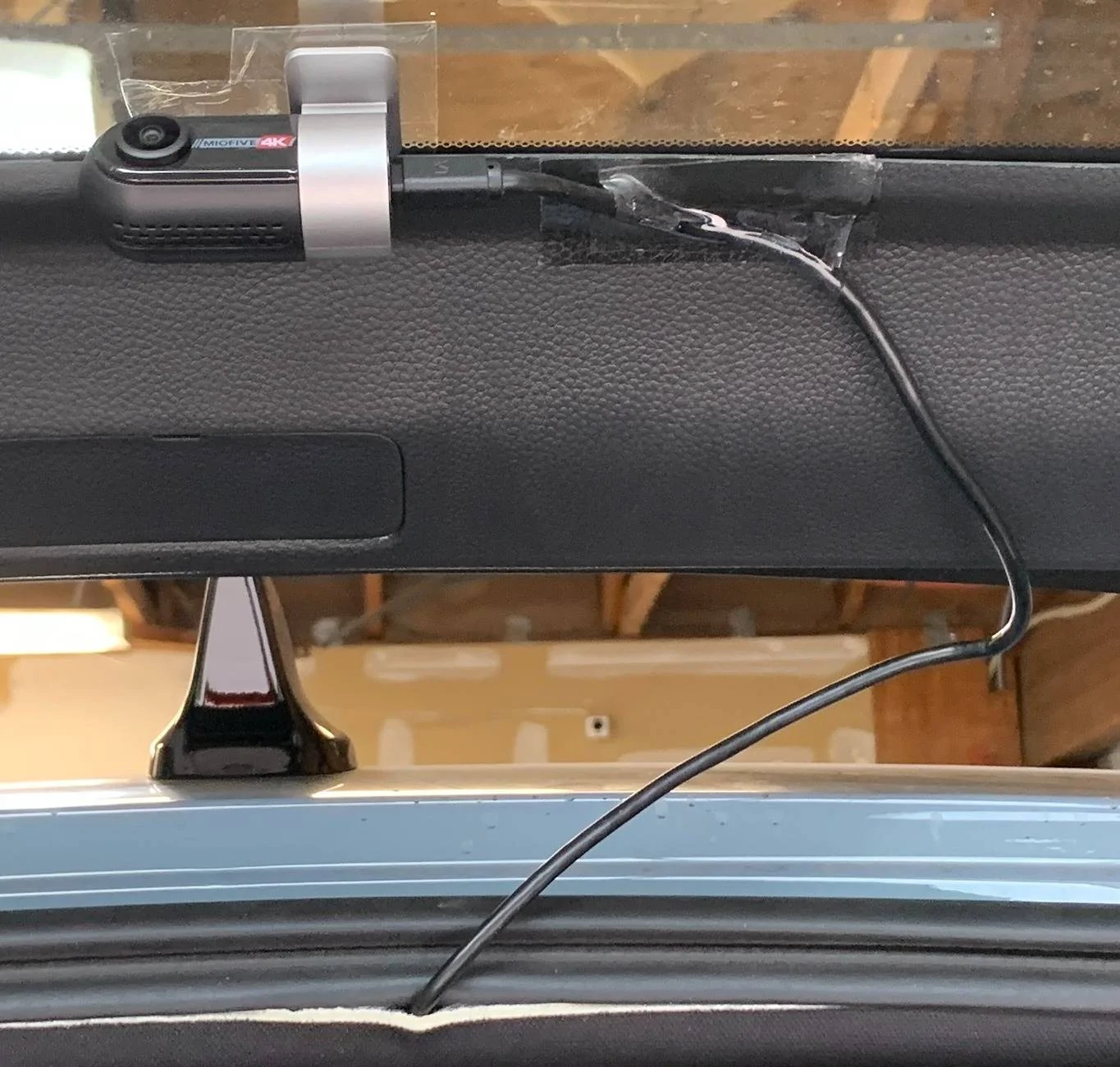

This is what I have done. routed the cable along the top of the passenger side, under the trim, so no visible wires inside.
when I reached the center of the hatch, I formed a "Z" with a sharp kink/crease on the cable, and taped it with double sided clear tape, so that when the hatch is open the "Z" opens up, and when closed is folds up horizontally.
though now I regret that I did not watch the video and followed it, much cleaner, I might eventually re-do it.

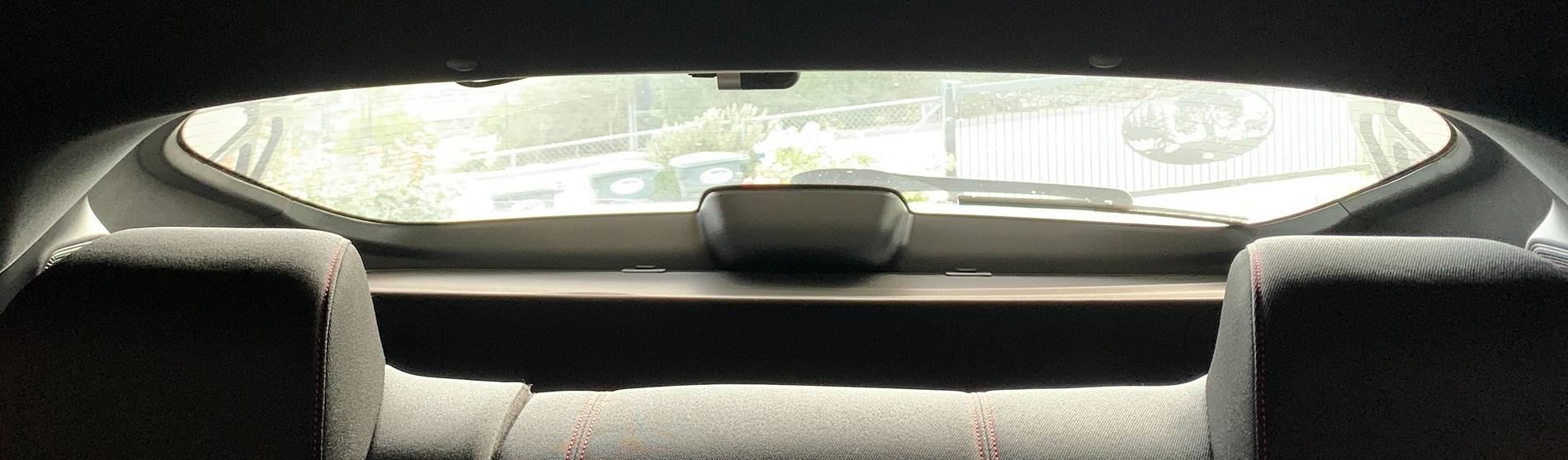

this is what it looks like closed from the inside looking backwards

closed from the rear outside:

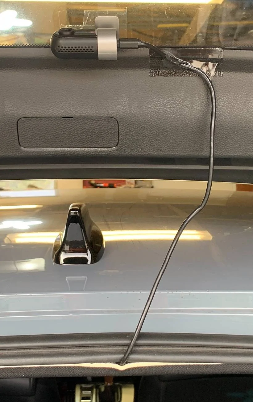

wide open hatch:

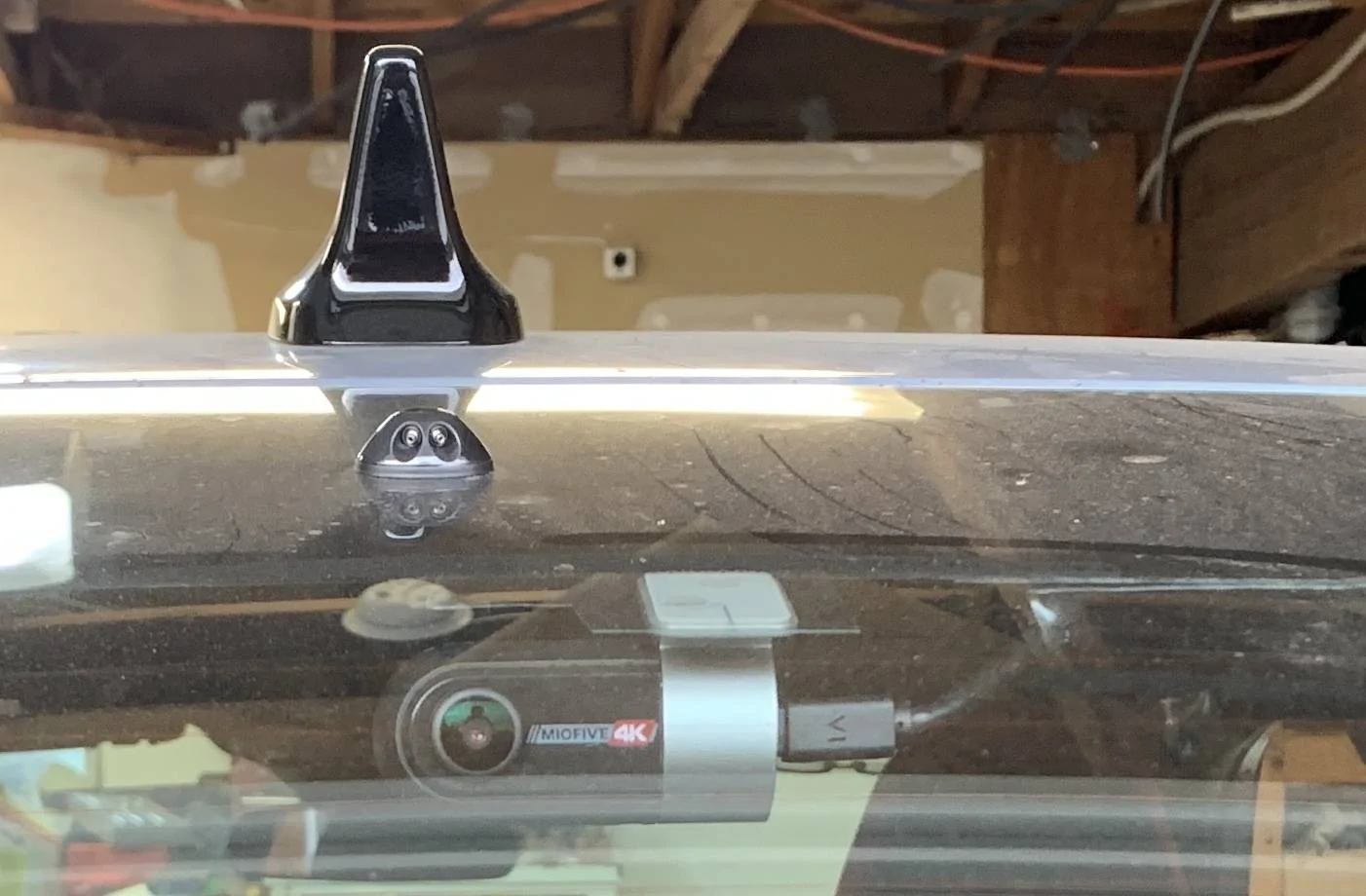

and half open, starting to fold from inside the hatch:

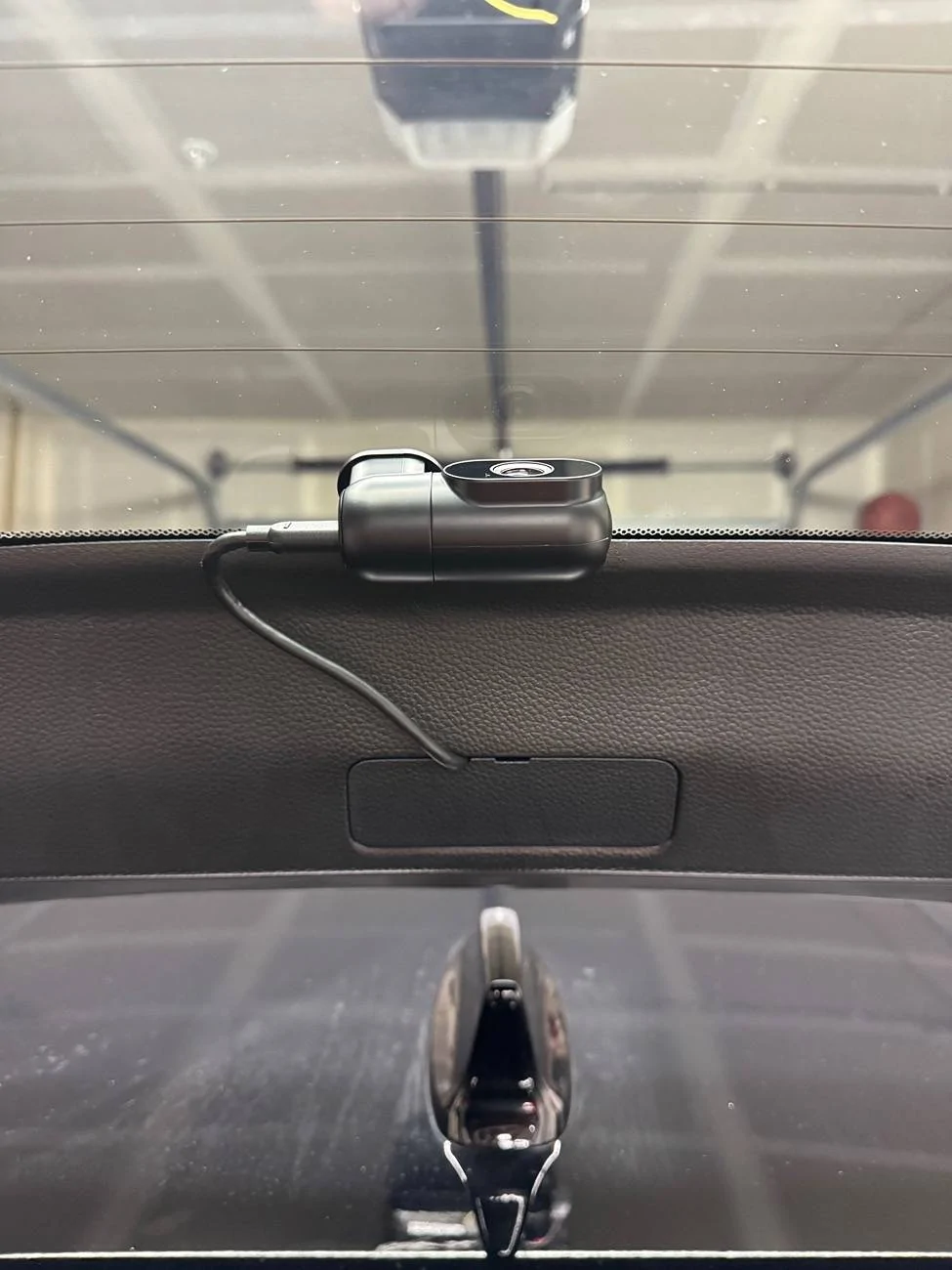

I did the same but didnt glue down the cable at the hatch like that and it wasnt a pain at all. Took like an hour to do the front and rear cams and the only visible cable is the 6-10" at the hatch hinge.
I dont plan on using parking mode so routed the front cam along the passenger side windshield and under the dash to a 12v splitter at the center console
Hardest part was at the base of the windshield where it meets the dash but even that was easy with the provided wedge tool the cam came with
