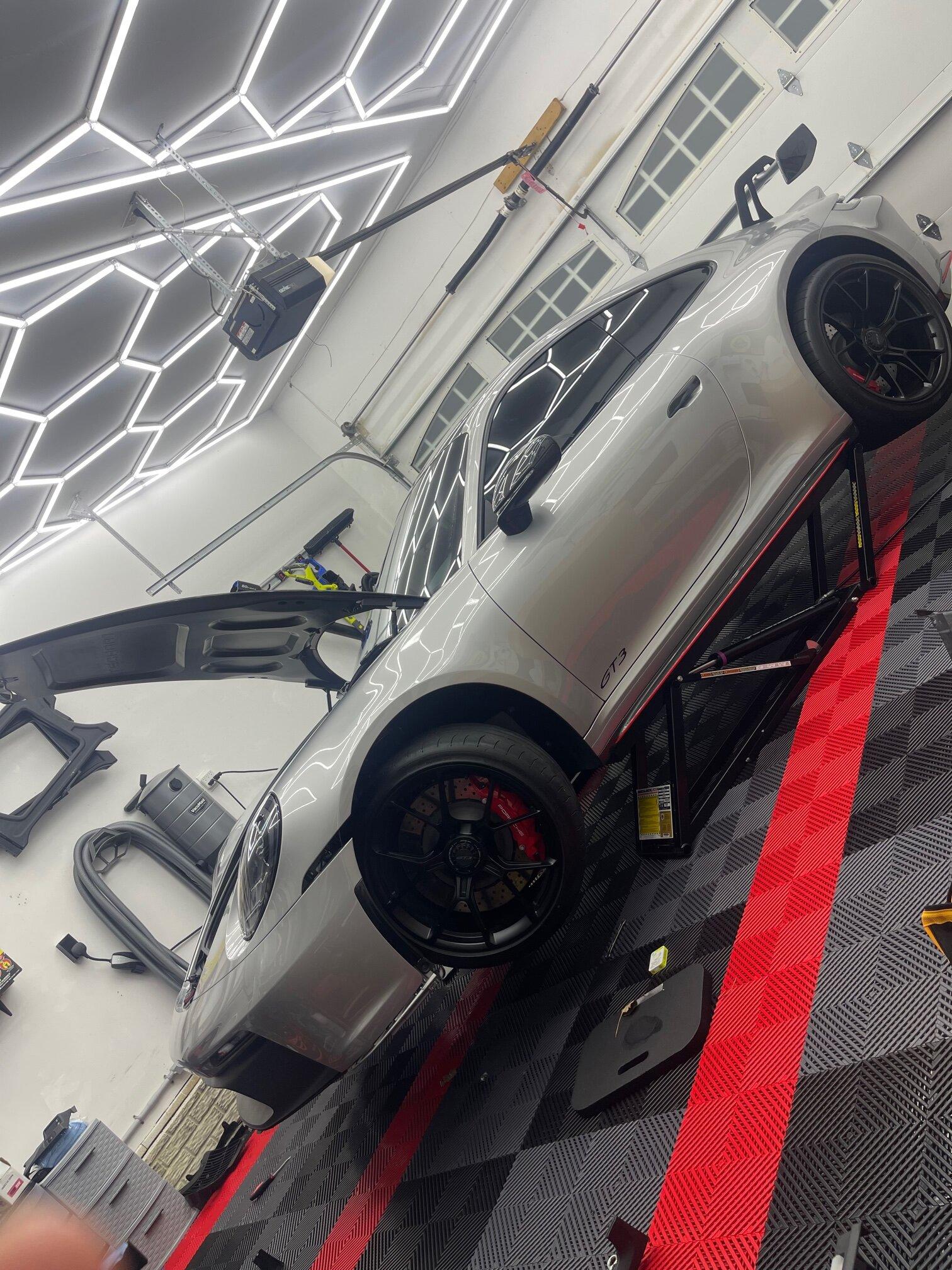

Now we got power, but even with the car off.. I gave up for the night. VERY frustrating.. Back to putting carbon on the 992... No idea what i'm doing here since there's nothing online at all on the 992 bumper removal. It's gonna be a long night!

7 hours later the carbon on the GT3 is done.. And have constant power on the #9 fuse.. I'm doing something wrong. Please help :)
