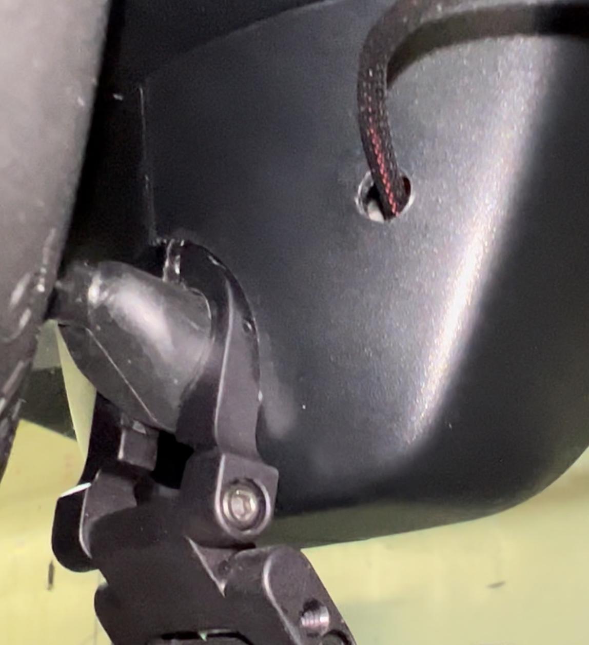

I recommend the Blendmount for the front Blackvue cam.
Interestingly, Blendmount will not work on the FL5 due to the mirror style. I spoke to them yesterday and they confirmed they tried and gave up. :( (same for the Si, I believe, likely other 11th gens as well)
Darn that sucks. Would have been nice if it worked. The standard adhesive bracket should be fine as long as the temperatures don't get too hot in the summer.
I did some experimenting this afternoon and may have found something that works! Just need to make sure it doesn't come off.
