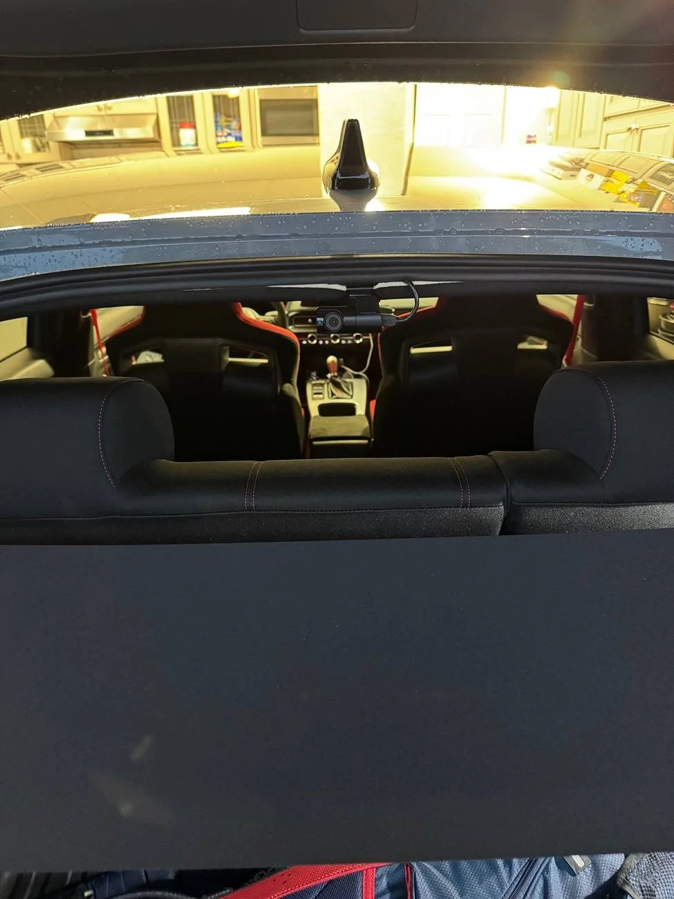

how does it look with these mounts? I’m not in love with the idea of undoing all this trim and weather stripping. I feel like it’s a recipe for future rattles tbh. I’m more interested in function vs form.
Here you go:
11th Gen Honda Civic Rear dash cam installation? IMG_3668
