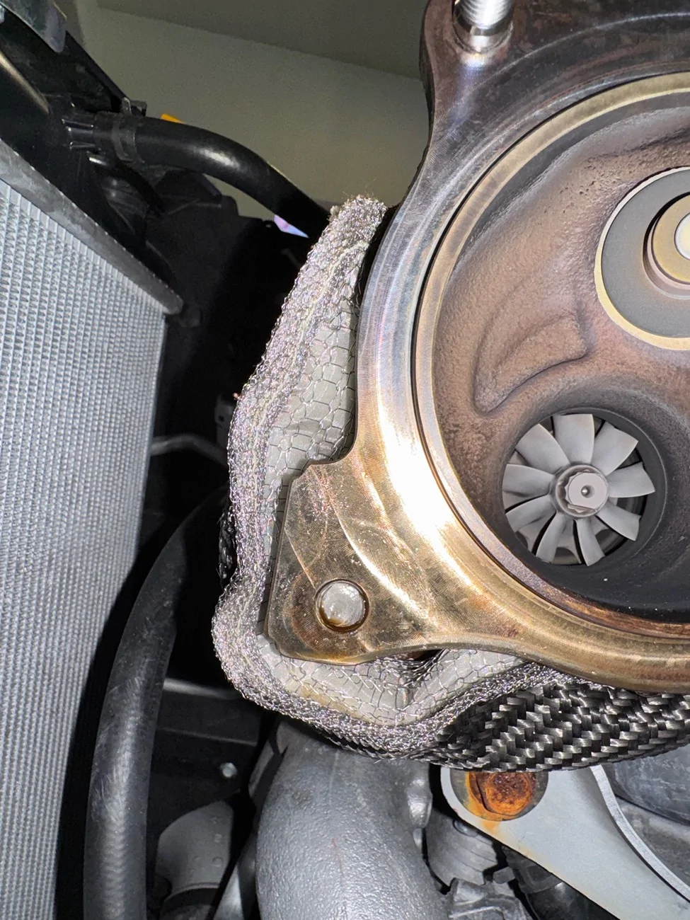

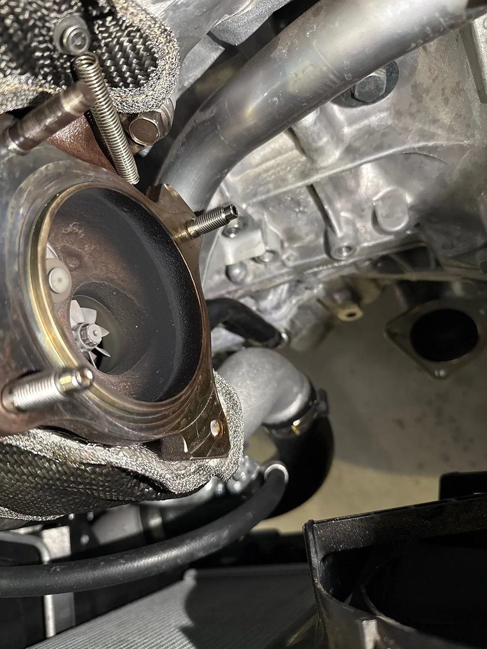

This happened on my 4900 mile de5, even after soaking. I hired one of my techs to extract and it took awhile to get it out( in chassis) without damaging any threads.

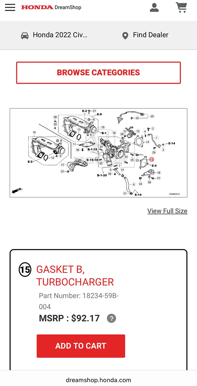

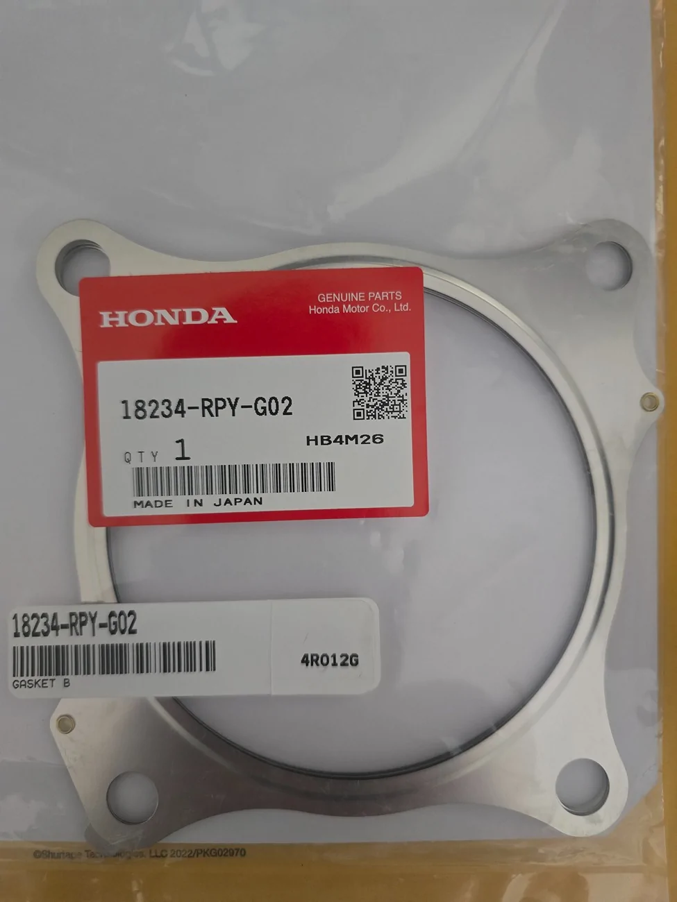

I have a gasket in hand if you need one. Shoot me a msg!
😭 which penetrating fluid did you use and how long did it soak? I’m hoping for the best at this point
MR_O’s_DE5
SHANE
Aug 9, 2025
29
Colorado
2008 acura tl type s and a 2024 ITS
Goddamn! Did you use an impact to try to remove the hardware or a breaker bar before the stud snapped?
I used a hand wrench and the nut got stuck about 3/4 way off. Had to cut the nut off and then tried to use a stud extractor on the stud and that is when it snapped.
