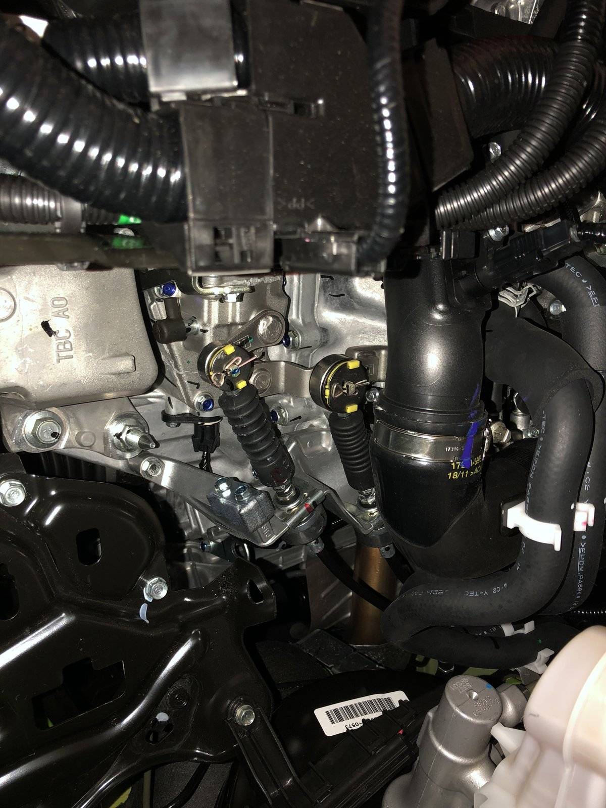

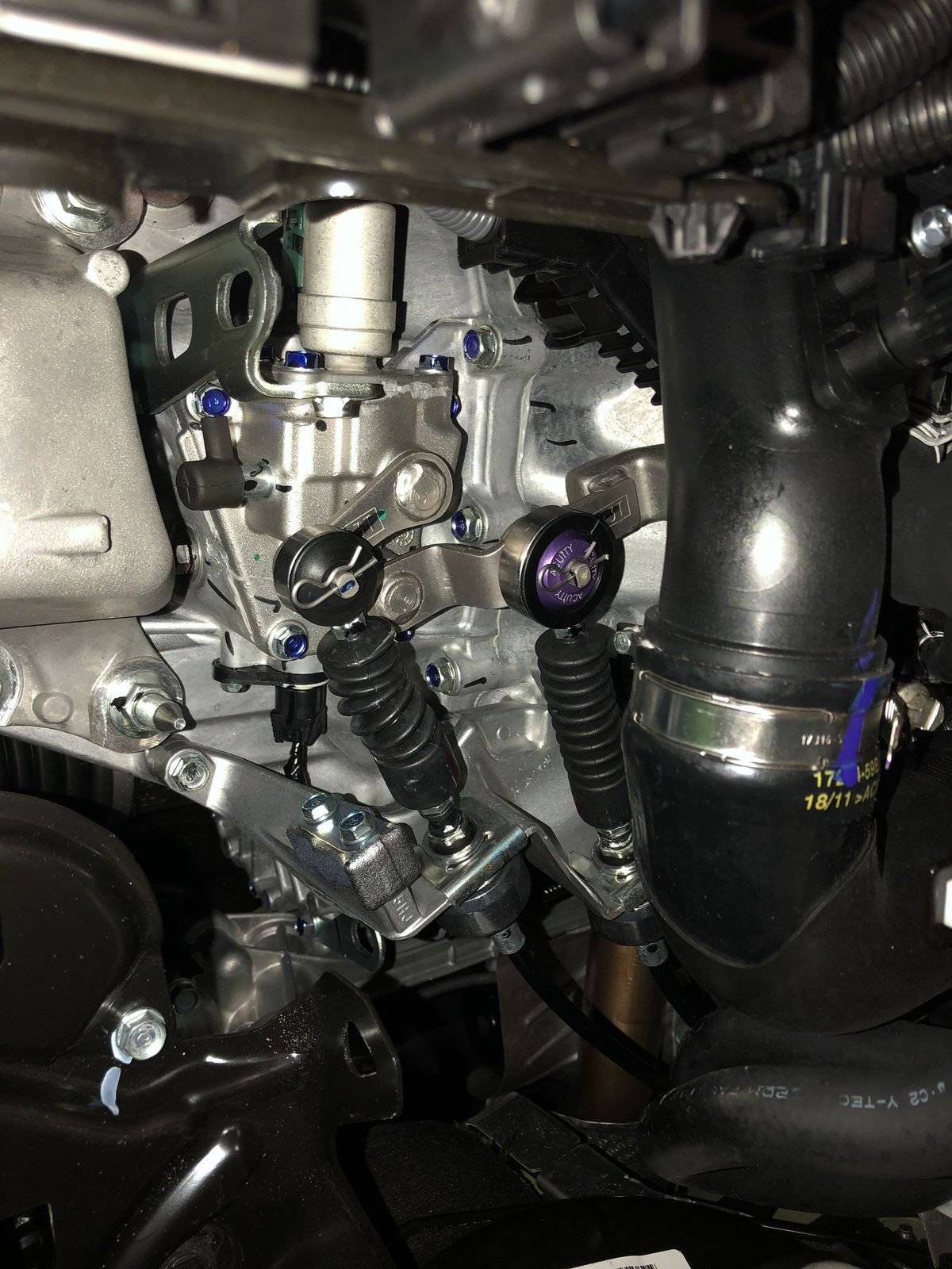

Feels so much nicer, a lot more solid. Hardest part of install for me was getting the C clips off that hold the cables to the bracket.
When I did it I couldn’t budge those C clips so just skipped that part.
