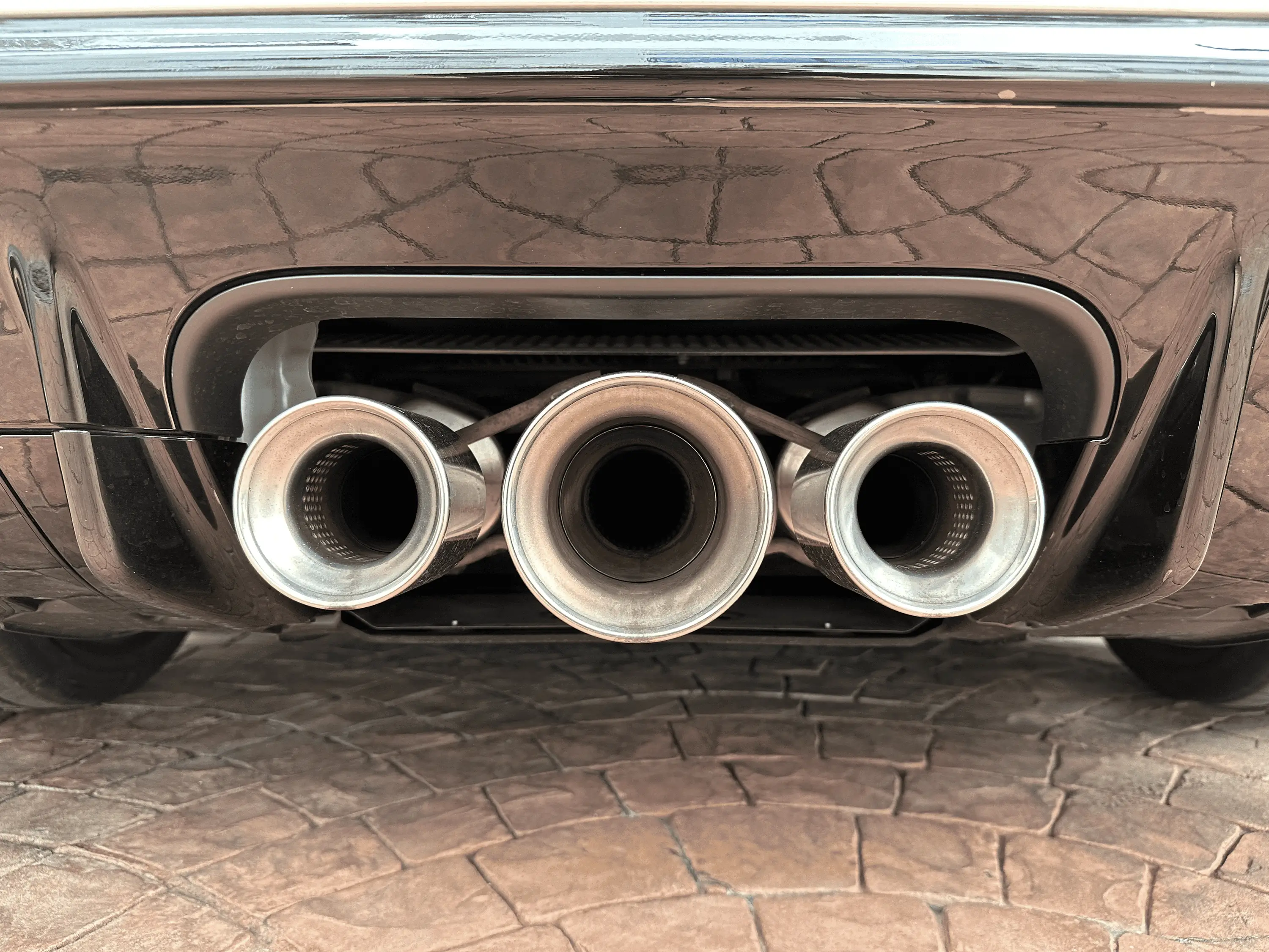

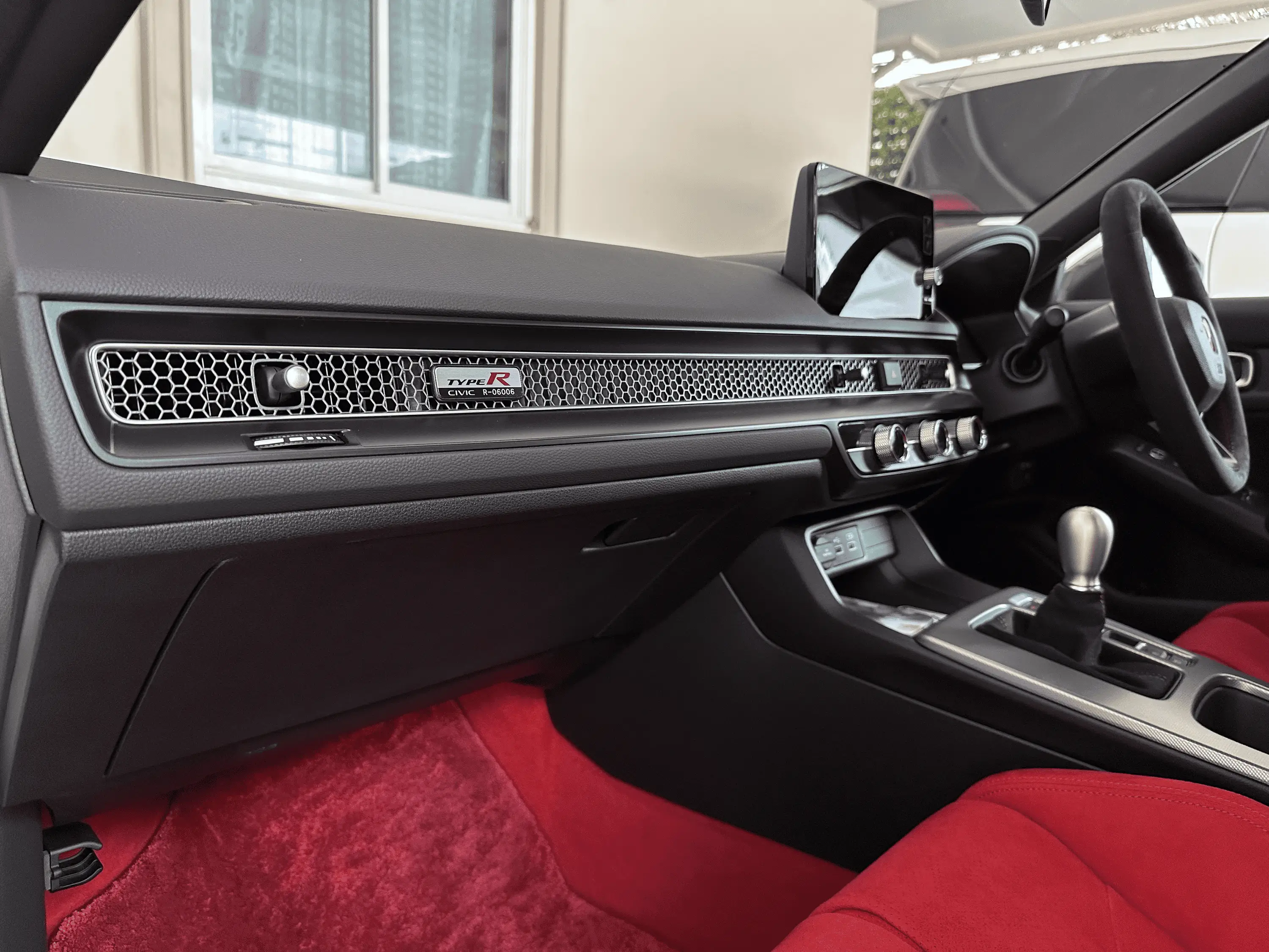

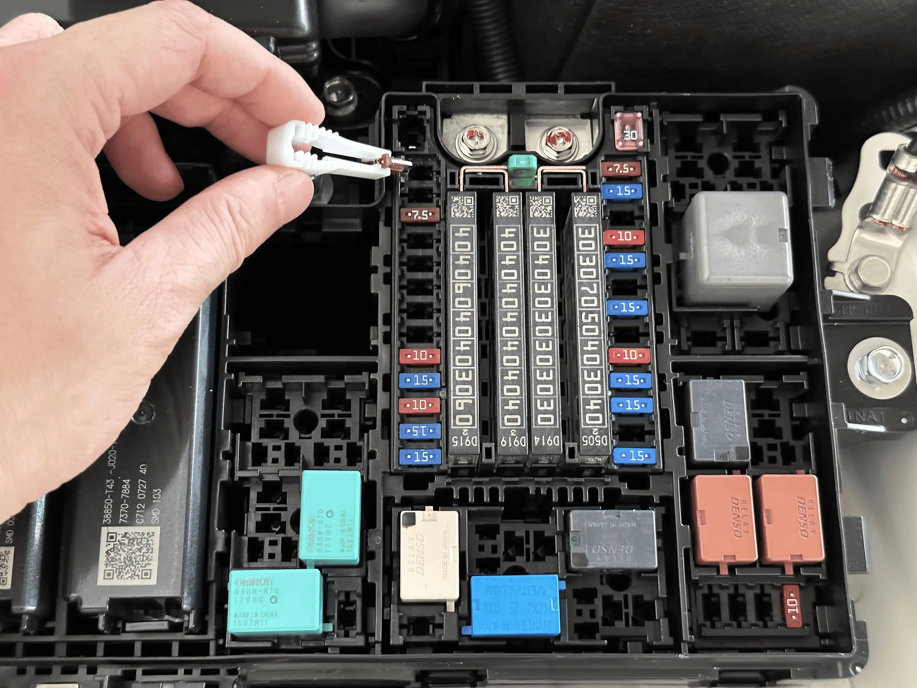

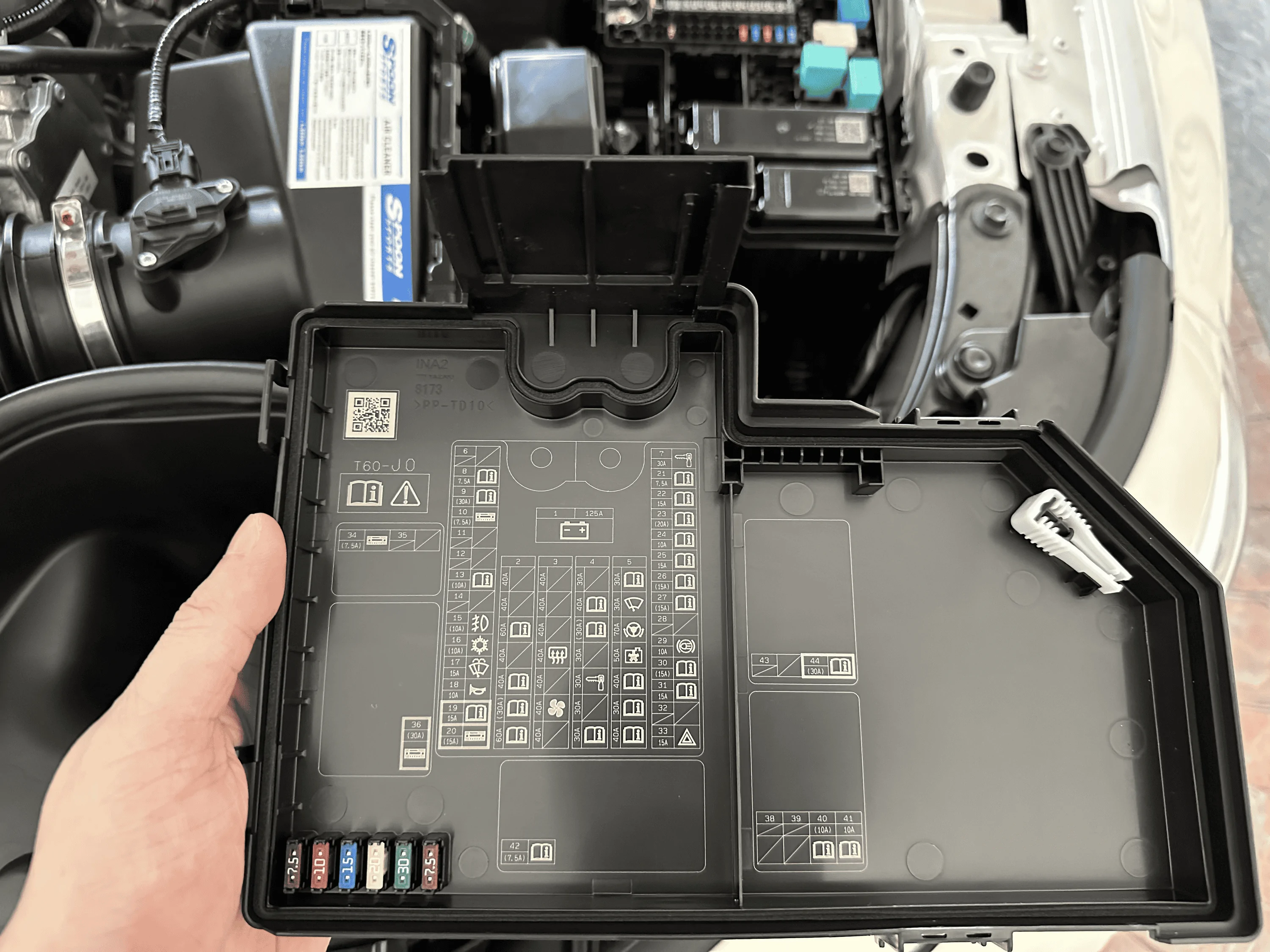

About the surprise after removing the exhaust valve fuse, it's not just the sound. After removing the fuse, the exhaust valve is fully open every day. I was pleasantly surprised to find that the problems that bothered me before disappeared, the instrument panel no longer makes abnormal noises, and the engine does not vibrate so much. Before 4000 revolutions, the instrument panel would beep and the engine vibrated obviously. I guess it was because the computer controlled the valve to open after 4000 revolutions, which caused the engine to be unable to completely exhaust the vibration caused by the gas, which affected everything in the car. . Now everything is smooth and the revs are picking up pretty fast. If you also have this problem, trust me, unplug the fuse of the exhaust valve. will solve these problems.

Here’s the original fuse pull thread by Topher: https://www.civicxi.com/forum/threa...ulled-always-open-exterior-sound-clips.51819/
It has been speculated that the valve is there to provide some back pressure during start-up and low idle. Read in this thread. AWE did some in-depth R&D. The valve activates based on throttle %. https://www.civicxi.com/forum/threa...e-for-the-honda-fl5-civic-type-r.52308/page-3
I put my fuse back in after running it for months without the fuse, as I really find zero difference in overall performance nor sound. It has a little more low grumble on startup, but that’s about all. I am not an exhaust expert, but if Honda feels some back pressure is needed, then there’s likely a good reason.
Without enough back pressure, I think it’s possible to gunk up the catalytic converter sooner than later. Again, this is speculation. I suggest trying it for a few weeks without the fuse, then put the fuse back and see what you think.
