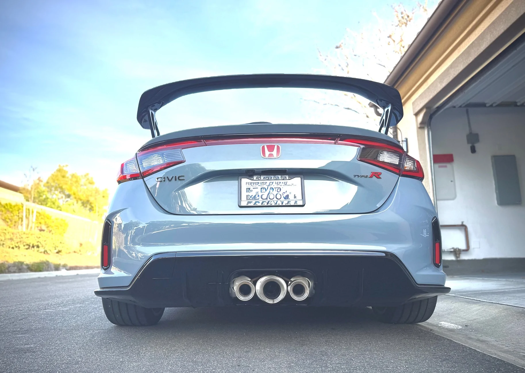

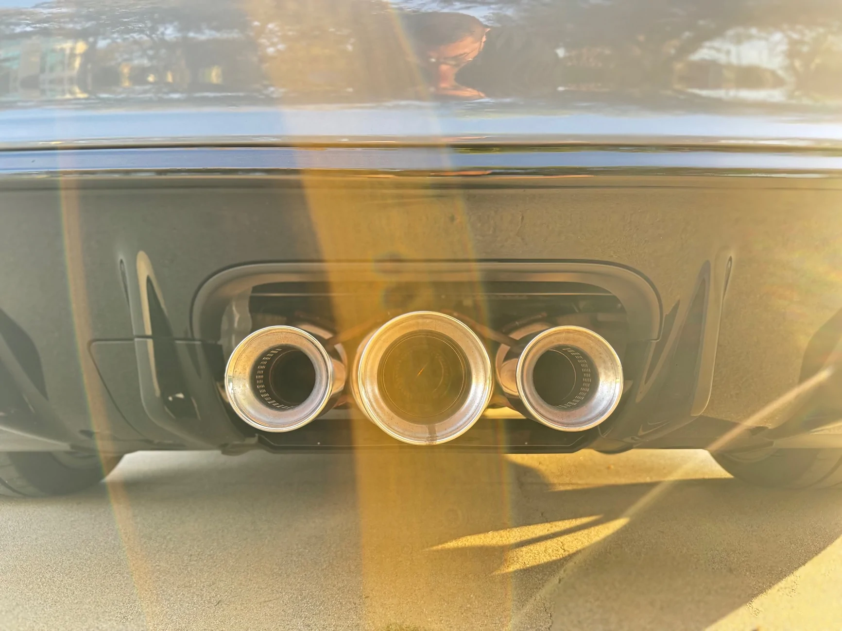

Hello, I just did this mod on my 25 ctr, one question - the valve on the center exhaust is now open, are there valves that close and open on the two smaller exhausts on either side of the big middle exhaust? I dont see the valves on the two small exhausts.
zumbooruk
Oct 19, 2024
690
651
Ventura CA
I believe that only the center exhaust has the valve.
