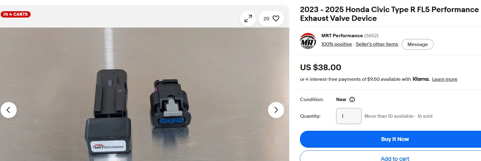

Mine threw a code P16EB.
I first pulled the fuse but with the connector in place. Later I modified the exhaust and so the connector is no longer plugged in. It took a while but threw the code. Autozone couldn't read it or reset it. Honda didn't like the modification and told me that the car will be out of warranty if I don't put it back to stock. He also said if it's tuned, I'll void the warranty. They reset the code for no charge.
There is a plug in that is on Amazon and Ebay that supposedly makes it look like the valve is connected and working. I wonder if it is effective? Has anyone here tried one of these?
