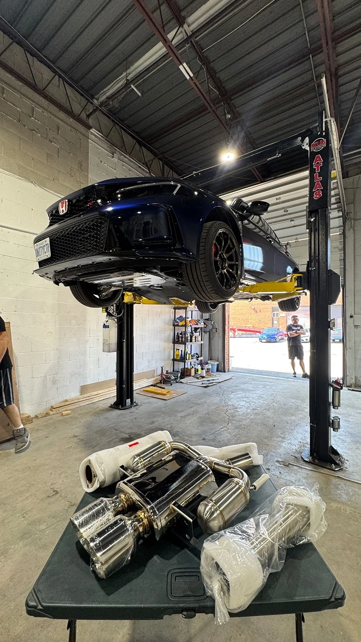

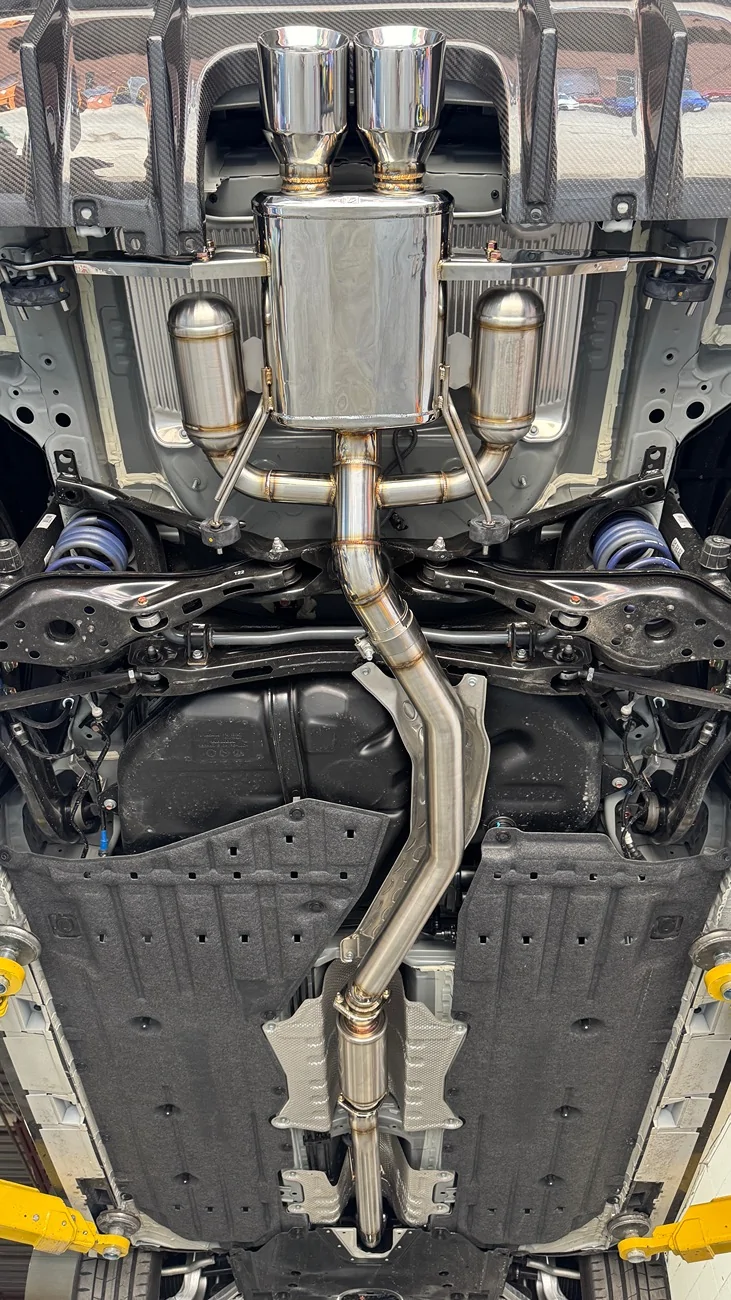

ARK Catback Exhaust installed, and I’ve been living with it for the past two weeks.
Between my FK8 and FL5, I’ve had about 10 different exhaust setups, and this one is definitely up there when it comes to delivering a really smooth, deep tone.
Construction is beautiful. It uses flanged joints throughout, except at the muffler, which I’m assuming was done to allow for some adjustment. I still would’ve preferred flanges all the way through, but I understand the reasoning.
I specifically asked ARK for both the resonated and straight-pipe center sections, since they’re easily swappable. I’ve been running the resonated version to start, and I’ll switch over to the non-resonated section sometime in the next month.
I was hoping the resonated version would keep the volume close to the MXP, but without a valve, it is just a bit louder than that. Nowhere near obnoxious, and still completely manageable for most people. If I were to rate the Hybrid and MXP exhausts as mild, I’d put this one in the medium range. I'd say it's as loud as AWE Touring, and a tad lower than HKS Hi-Power.
When I’m driving by myself, the windows are usually down and I’m just enjoying the tone from inside the car. If I’m on the highway with my wife, I’m a little more mindful of certain RPM ranges and throttle inputs to keep things tamed. There is some hum in the cabin after 70mph, although part of that can likely be attributed to the stiffer motor mounts as well.
If you’re looking for a medium-volume exhaust without a valve, with a nice deep tone, the ARK is definitely worth adding to your short list.
Full video will be posted on YouTube next month :)
