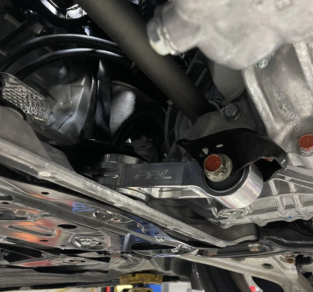

The best first mod is the Hondata base Octane 93 tune, but the best “bang for your buck mod” is the PRL rear motor mount. Why?.. because it has improved the driving experience overall.
- the car feels more stiff
- significantly less jerk while shifting gears
- significantly less wheel hop
- no more rattles from the infotainment system
- significantly less rattles from seatbelt retainers

I'm confused as to why a stiffer RMM would result in less rattles. I would've thought it'd be the other way around?

I'm not very car-savvy, but why upgrade the RMM before installing rigid collars?
I haven't read anything negative about the collars, but I've definitely read about problems with the RMM, mostly that it can be too stiff, and transfer more vibration and noise than desired.
I thought it would be rigid collars, then springs or something similar, before motor mounts.
Rigid collars and RMM serve different purposes.
Rigid collars are meant to perfectly center, and prevent movement in, the front and/or rear subframes. This reportedly makes the car feel stiffer overall and should help maintain a proper alignment.
The RMM limits fore and aft movement of the drivetrain. This mainly helps to eliminate slop in the drivetrain which can lead to wheel hop under hard acceleration and vague shifter feel.
