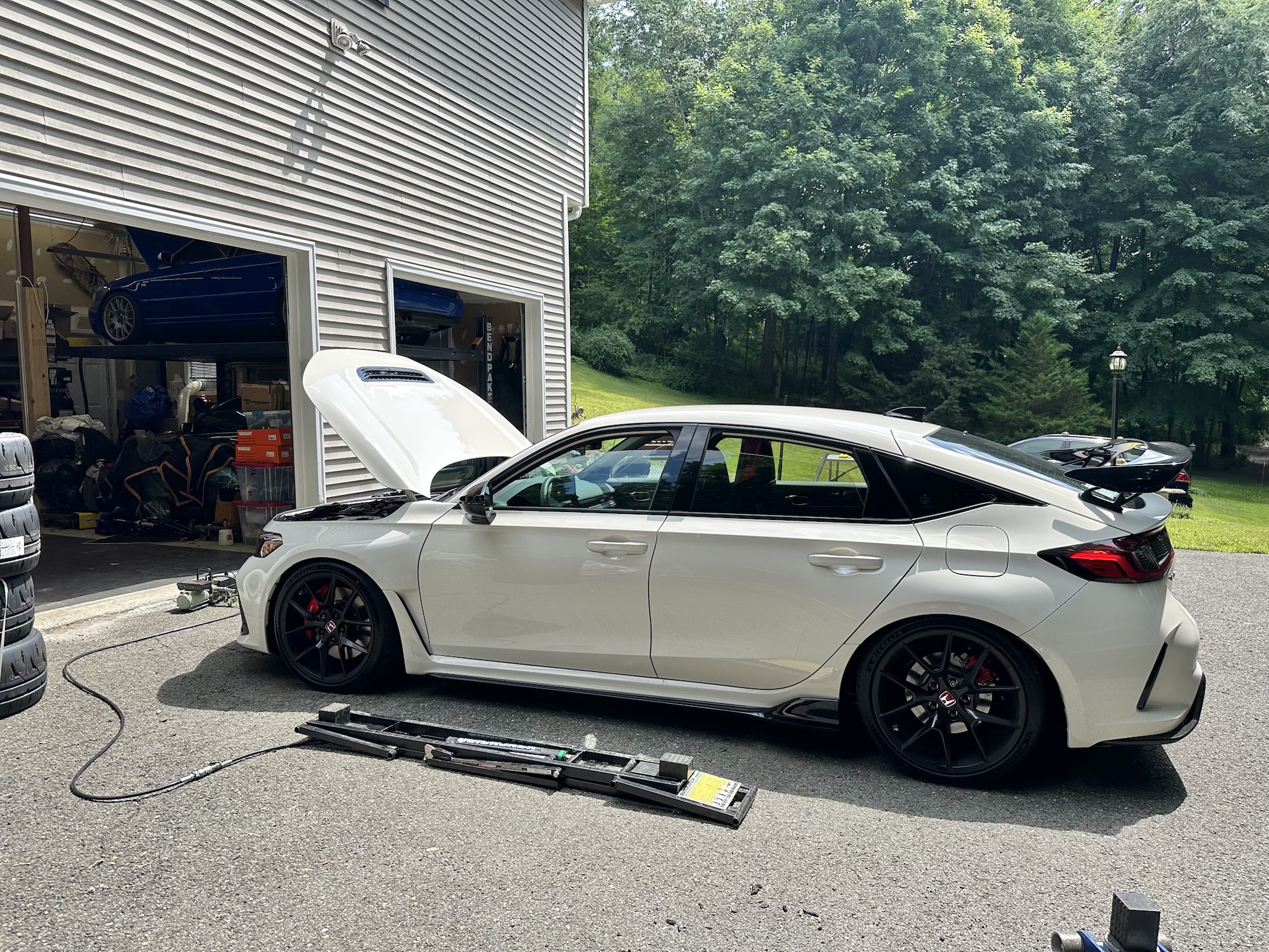

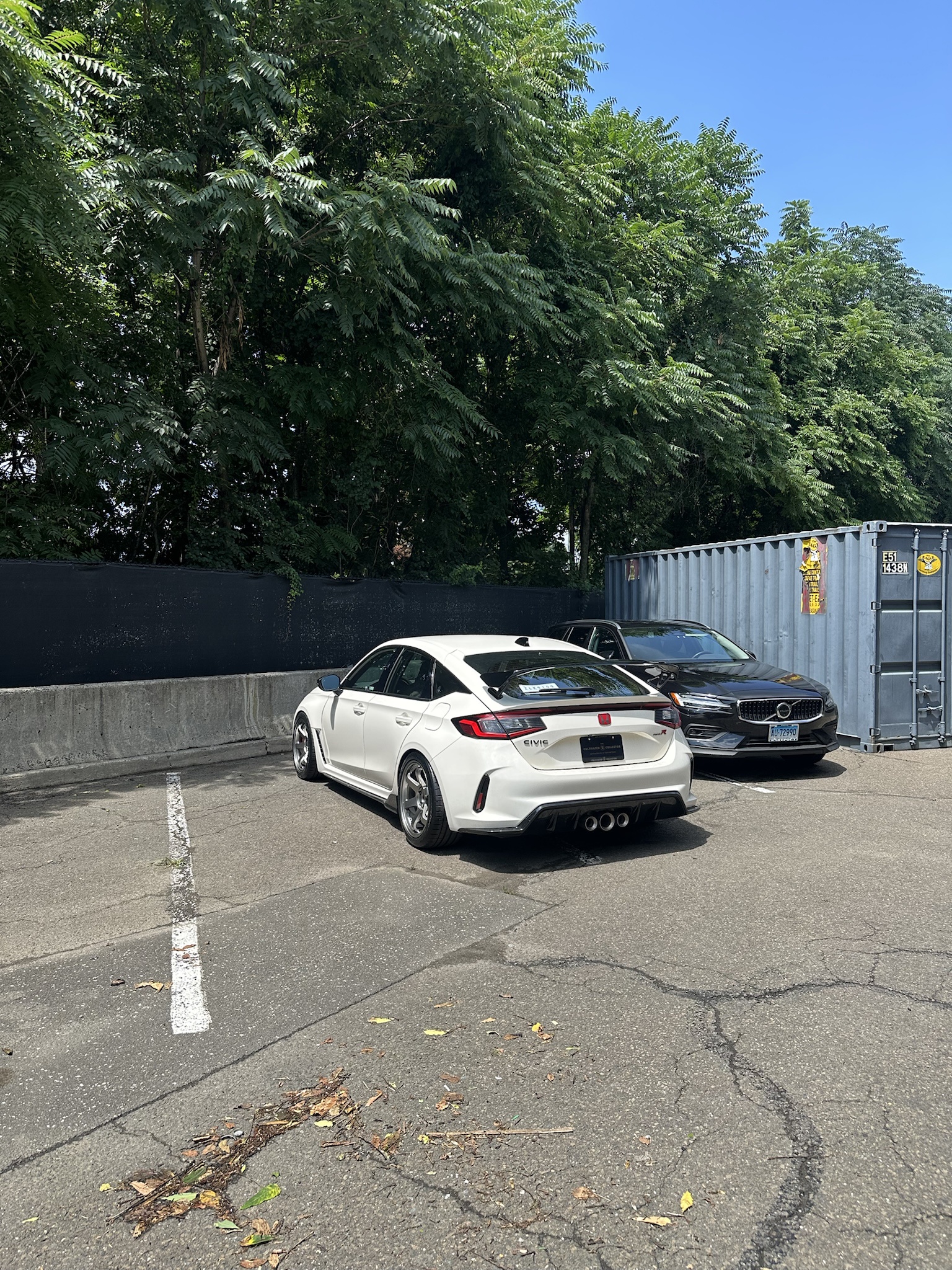

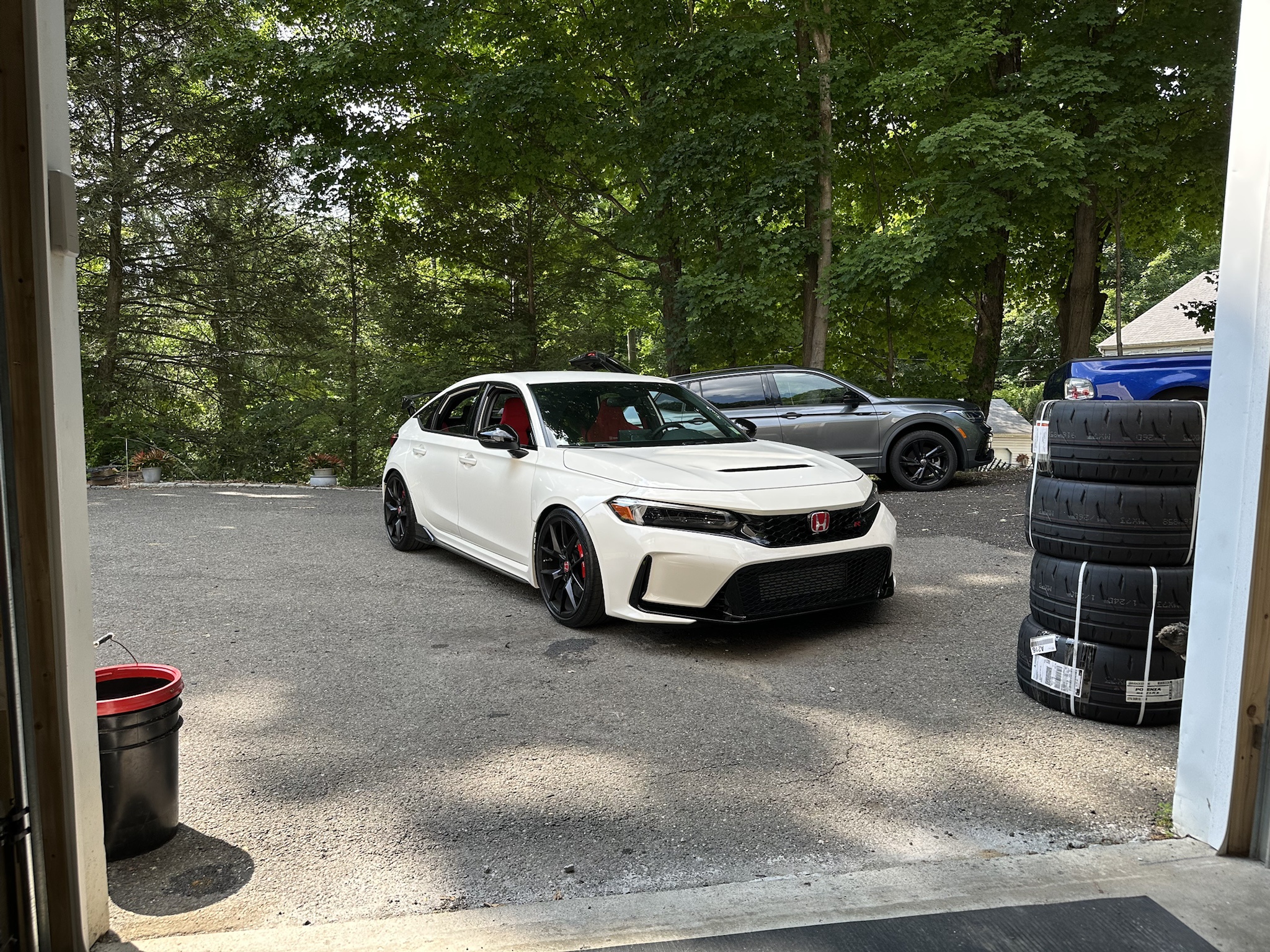

I didn't really see anyone posting or running these on the forums. I wanted to give them a shot for their even ~1'" drop F/R with spring rates similar to Eibach, and I also like their products for the Skyline GT-R.
Spring Rate: 5.61 kg/mm (front), 5.10 kg/mm (rear)
Drop: Front -20mm to -25mm | Rear -25mm to -30mm
I ordered these from Hybrid Racing on Monday afternoon and they arrived Tuesday afternoon - comically fast shipping. Install was super easy, a friend and I were able to take our time with the front driver's side and wrapped the whole project up in ~2.5 hours. As of posting this thread, I've paired the springs with 15mm spacers on the OEM wheels.
Initial driving impressions:
- Rides great in all suspension dampening settings. Great on back road, great on freeway
- A tiny bit softer than OEM I think
- A tiny bit bouncier than OEM
- Doesn't feel stiff whatsoever
- Perfect ride height
All in all, awesome experience so far and I'd encourage people shopping the Eibach springs who want a more even drop from front to rear (ie. no rake) to give these a shot.

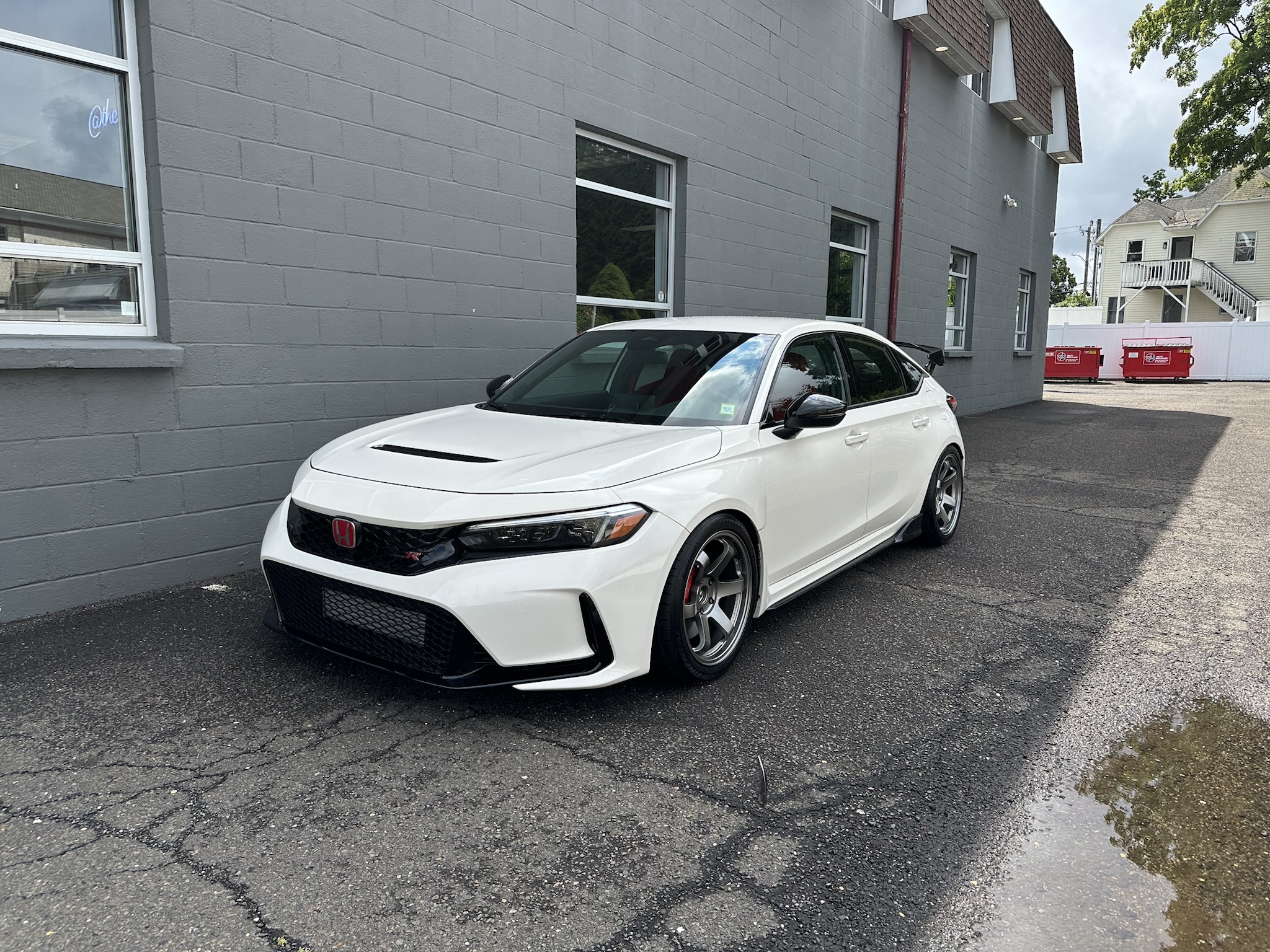

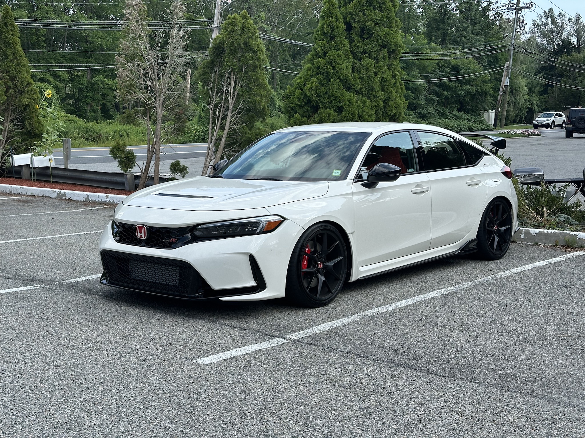

The drop amount is just right for a daily IMO. Not too low where you're constantly worried about possibly hitting things, yet still low enough where it can look real flossy with the right wheel fitment.
Small update since I made the OP. Swapped out the OEM wheels and spacers for a set of 18x9.5 et38 Rota Grids wearing 275/35 Conti EC Sport02s. Rides really really nice now with the smaller wheel diameter and larger sidewall combined with the RSR Springs.

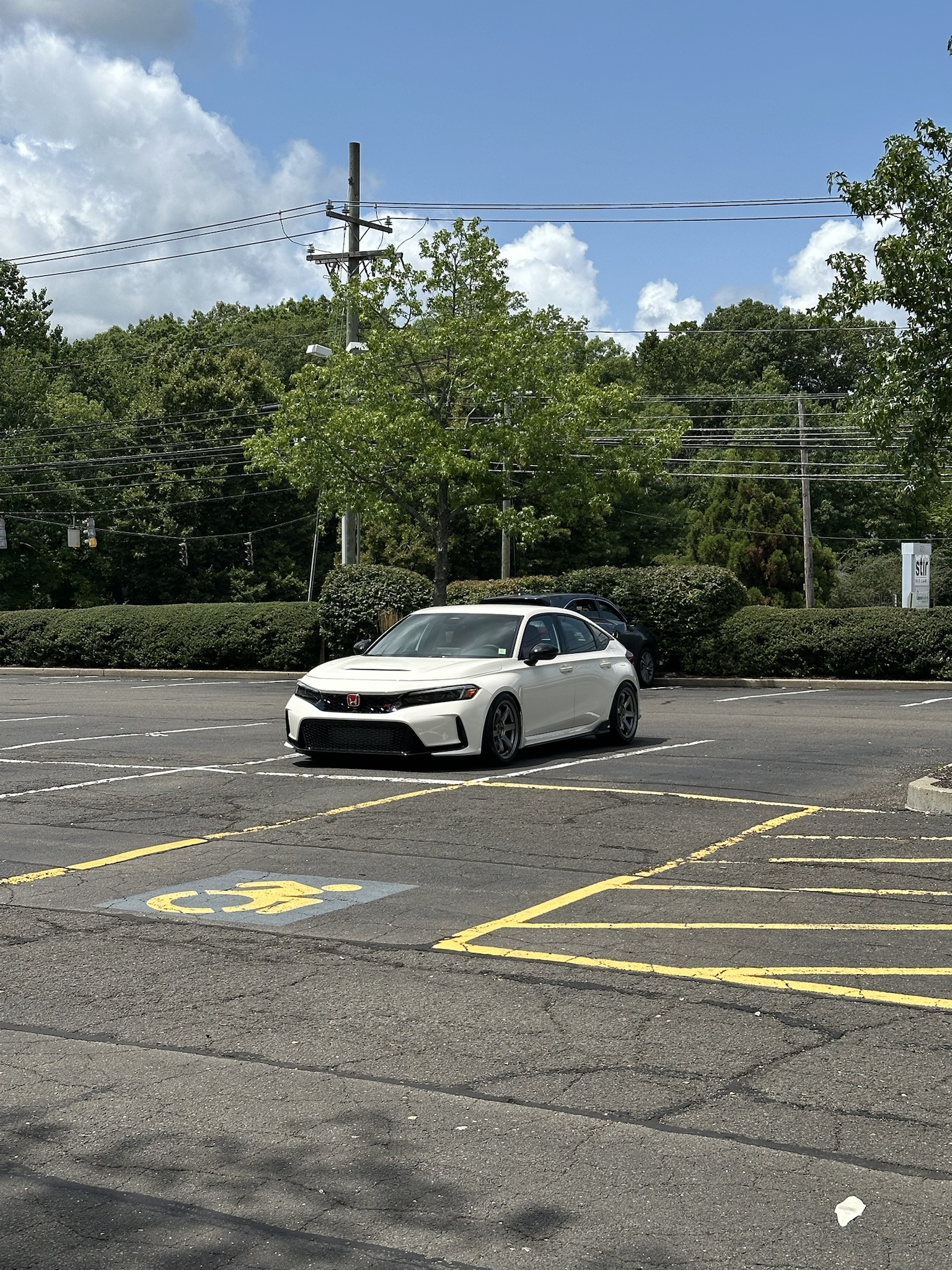

How has clearance been on driveways and such? Thats my only concern with lowering the car, I have no clue how low the undertrays and frame rails sit on this car. Otherwise looks killer!
I've been pleasantly surprised by the front clearance has been with the springs. That said, I've been dealing with lowered cars for the better part of 20 years now so I'm probably over aware of how I approach driveways, entrances, sidewalks, bumps etc.
Since installing the springs I've rubbed the front lip once on the ground coming out of a parking lot into a main road, and that was because I rushed myself when I had no need to rush, and even then the rub was super super minor.

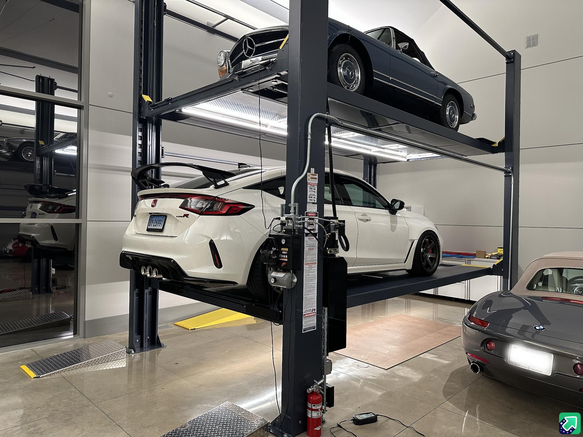

Over the last 2-3 weeks my car developed a "pop" noise from the rear suspension that I believe was/is related to the rear sway bar end links. It would happen mostly at 0-25 mph and regardless of if I was turning or going straight.
I finally had some time to get the car up on my 4 post lift and poke around with the suspension while it was "under load". No bolts were loose, and nothing visually looked out of the ordinary. I slightly loosened and then retorqued the bolts that I removed for the install...and magically that seems to have soled my noise issue. I will report back in a few days when I have more than 2 test miles.
That said, my passenger rear spring alignment nub popped out of it's hole in the lower control arm so I'll need to re-seat the spring when I have time to take the wheel off and pull the spring out to reorient it. Doesn't seem to have any impact on ride handling/quality/response. I assume this happened when I angle approach entered a suuuuuuper steep driveway that I frequent. I swear the driveway meets the road at like a 30+ degree angle lol
