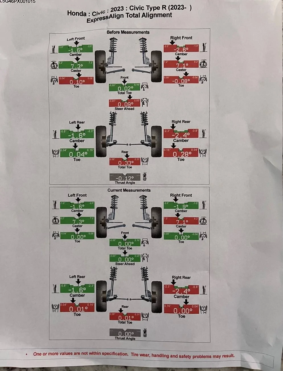

I will post my before-after numbers Friday after my alignment. All I’ve done have been springs (eibach pro), rigid collars, and pins pulled.
once you do springs, alignment is definitely needed

to get this back on track....OP did you get the alignment done yet?
I'm getting it done on the 15th then taking a nice lil road trip. I'll report back my alignment numbers, my driving impressions, and hopefully some cool Type R in the mountains pictures

I had my alignment today after eibach ProKit springs, rigid collars, and pin pulled. Kind of shocked to see how much camber I had on one side versus other with pins pulled.
I did just order camber arms for the rear after seeing how crappy my right rear camber is.
Will likely pick up a roll center adjustment kit to throw in the front just to correct the geometry, also.
surprised the camber is not even after the rigid collars. usually it makes it very symmetrical.

I think the pin pulling + springs made everything extra wacky. My rear camber arms will be here Tuesday so I’ll likely get another alignment in one week.
i did springs, pin pull and camber ball joints, and they were within a tenth of each other after alignment, and that's without rigid collars
